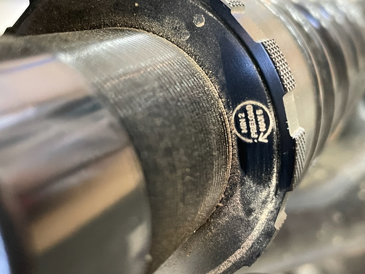

Why do you think that Rockshox have a minimum of at least two turns of preload?
Multiple Sram manuals have the procedure listed as step 1, add two turns, then go up to 5, no more.
Also it’s even printed on the preload collar.
Could this be if they are expecting the spring to settle in a bit and/or trying the get enough tension on the threaded collar so it doesn’t want to move under use? (RS has no collar retention?)

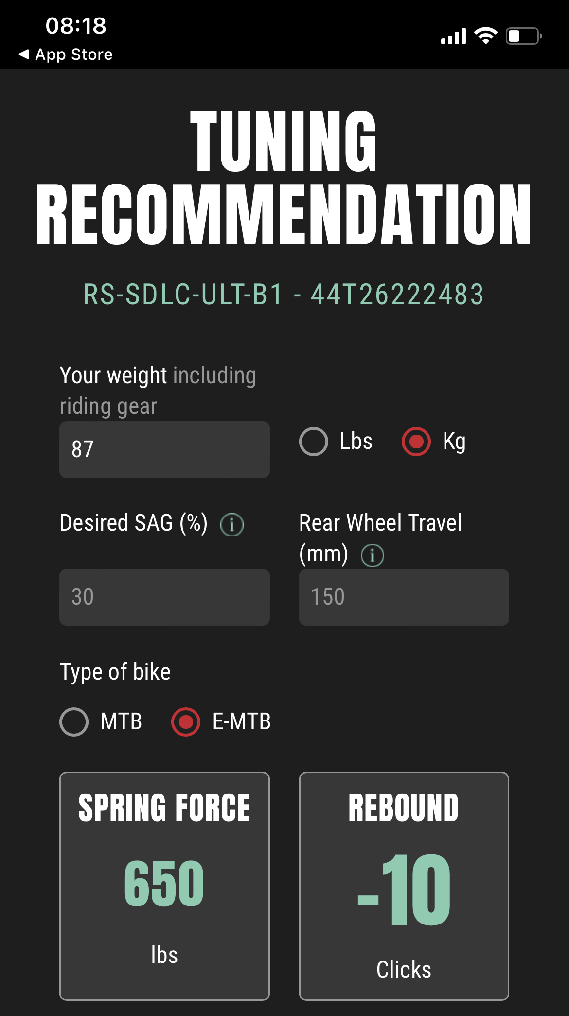

I entered a serial number for this shock in the Rock Shox Trailhead App for a 190lb rider at 30% sag, Ebike and it recommends a 600lb spring for the starting point. 28% sag spring increases to a 650lb spring.
Download the app and enter this serial # and click on the tuning tab to see what I’m looking at. 44T26222483

This is what Trailhead recommends for me. 😳
One thing missing from this app is the type of linkage.

Yes….It seems that calculator does not take into account the leverage ratio of the rear suspension as you don’t enter bike type or shock stroke.
