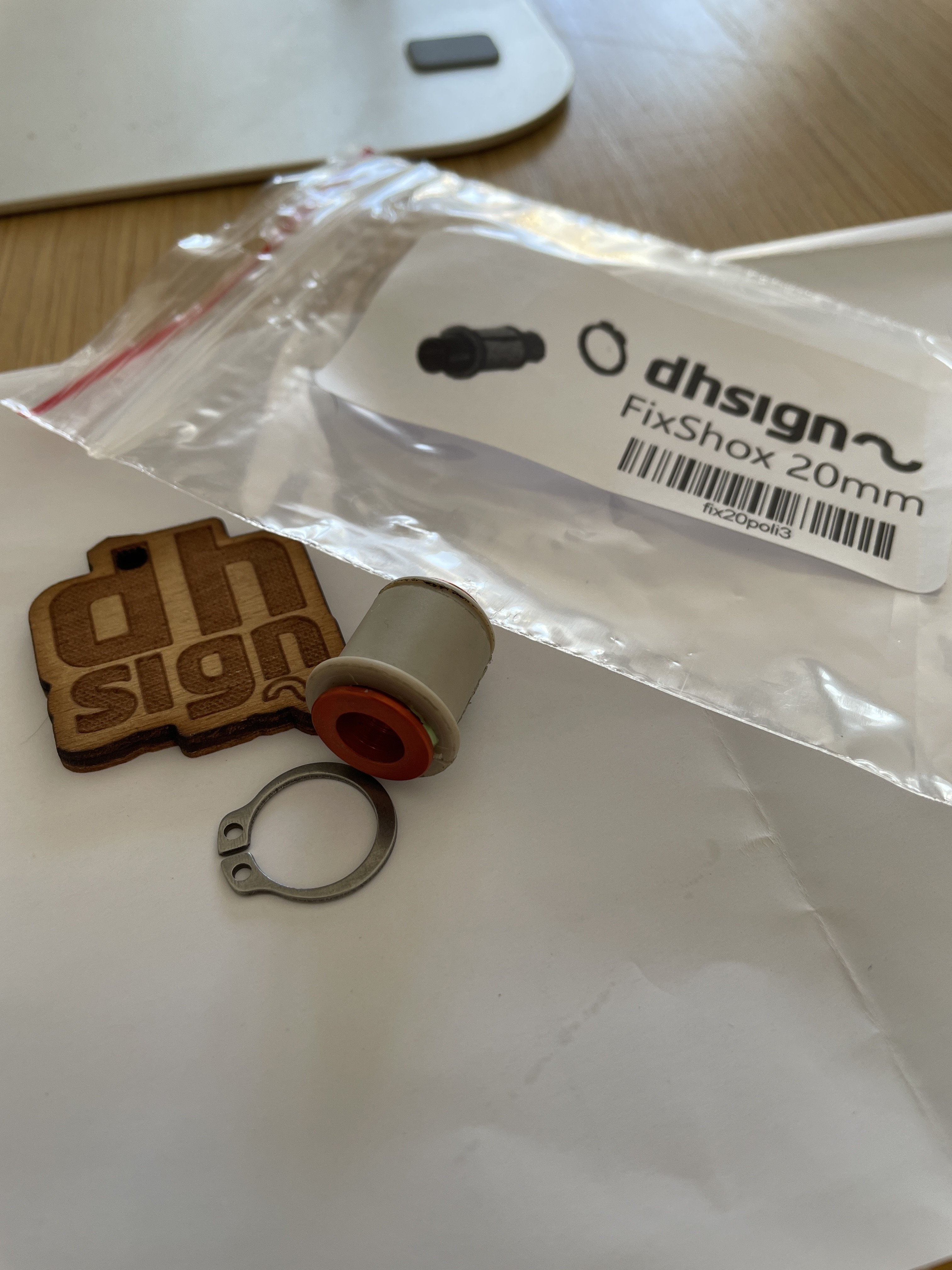

I also fitted one of these

It’s a ball joint, so allows some twist for the shock.
Thats a really interesting bushing for yoke based bikes @Dave_B . I've just been reading about it before the dhsign site went down.
How much rotation is available? Do you notice it at all with any flex/give feedback through the bike?
