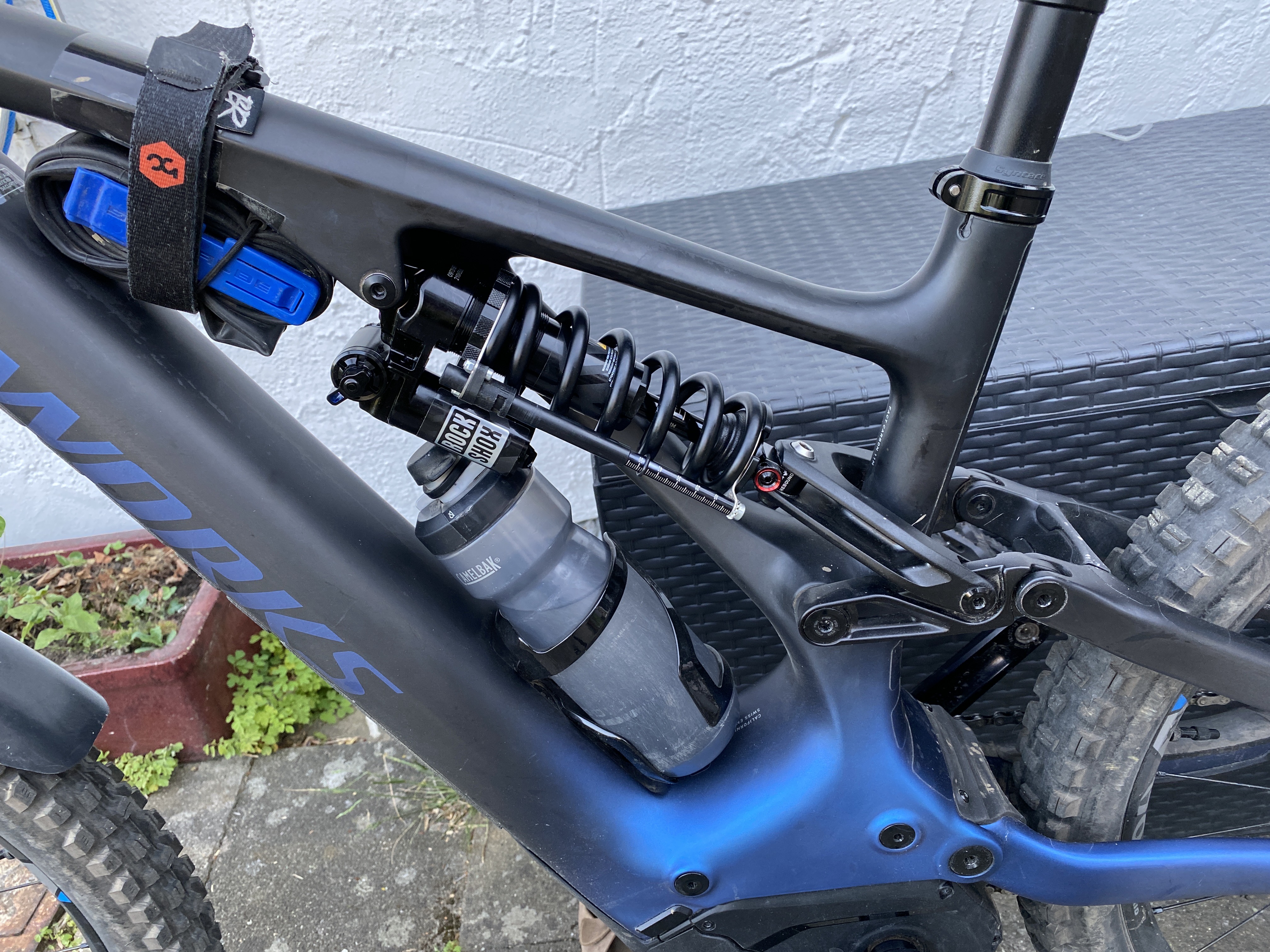

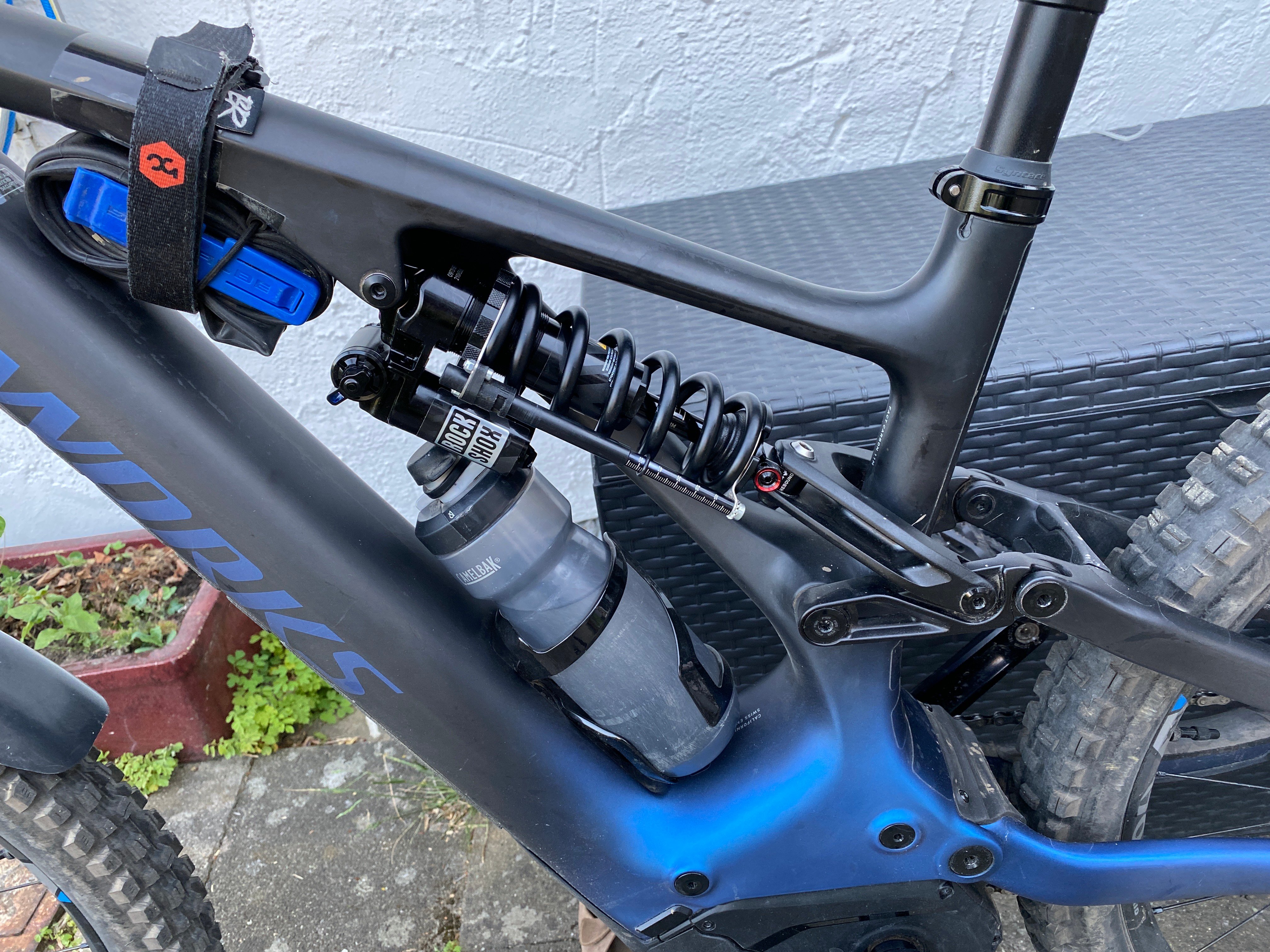

I recently fitted a RS coil shock on my bike. I found that the MRP spring rate calculator gave me the best results. Better (more precise) than Tftuned in my opinion. My desired sag (25%) was spot on.
