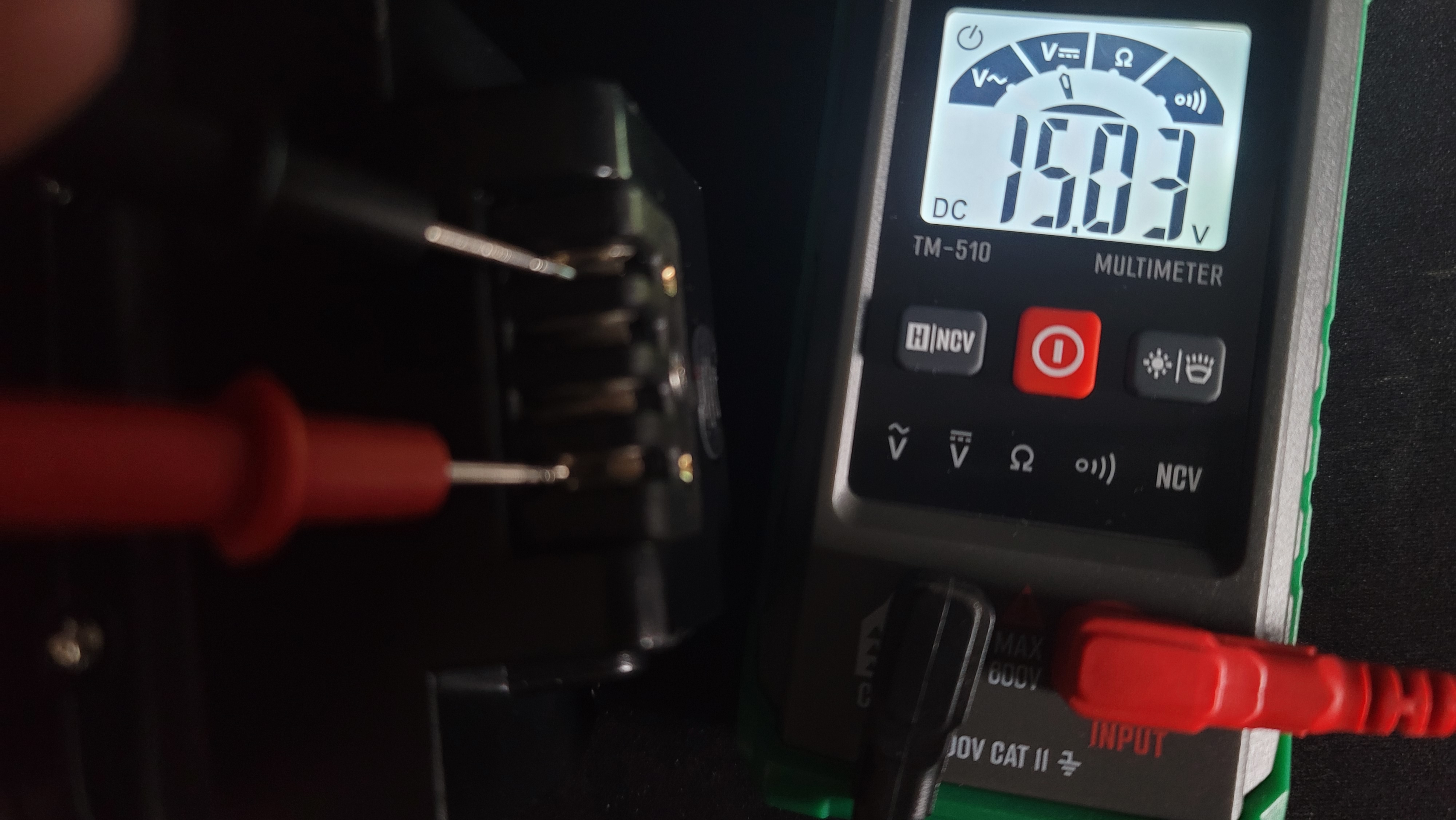

Is this measurement correct? The battery is 48V fully charged.

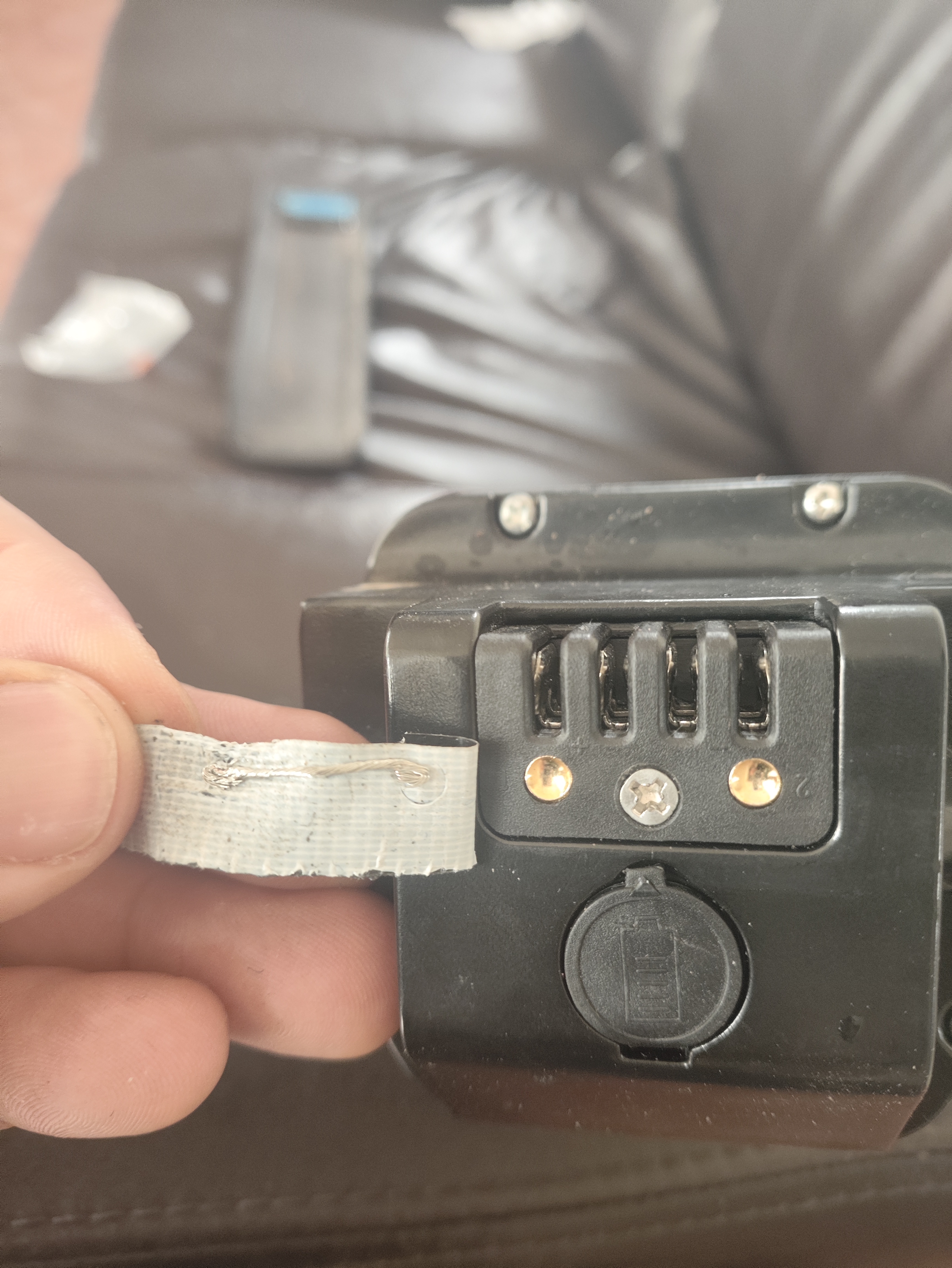

Yes, or as I sugested, connect their counterpart terminals at the battery, which seemed easier to me as they are flat (the ones on the mount protrude), and because I didn't have to take the battery mount off of the frame, which you already did

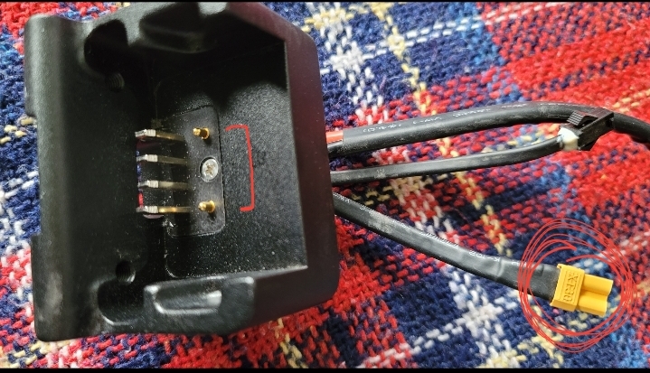

Isn't it better to remove the battery and make an internal bridge?

I do remove the battery, but I don't modify any of its internals, neither modify the wiring of the mount. Here's a picture the I hope clarifies:
I will eventually commit to a permanent modification, but for now this works just fine
Thanks for the clarification in the Photo.
The problem is not in the power button. I checked and it works fine.
The reason for the problem is that these two Pins do not make an internal connection.
I'm thinking about buying a new battery bracket, but I don't know if it will cause the same problem in the future.
Do a bridge inside the battery may be the best solution in the long term.
Any more suggestions?

Just to be clear, have you bridged those terminals and simultaneously measure voltage on the power terminals?
Yes, the battery gave the expected voltage about 54V after bridging.
The problem is the bad battery bracket.
I fixed it and now everything works, even the power button works.
I didn't expect this to be my first major problem with Dengfu build. I had to disassemble the motor and a lot of parts to fix the problem.
Thank you and everyone who helped me too.

Open battery (4 screws on connector side). Locate 2 red cables going to that golden pins, cut them and short.
Your solution wont be working for long and on bumps you can have shut downs.
Yeah, I know I'll eventually will have to go bridge the actual wires. However you would be surprised by how much this solution holds up. I've cruised rockgardens and mid sized jumps an not a problem. The tape only holds the jumper in place until the spring terminals of the holder mechanically press it

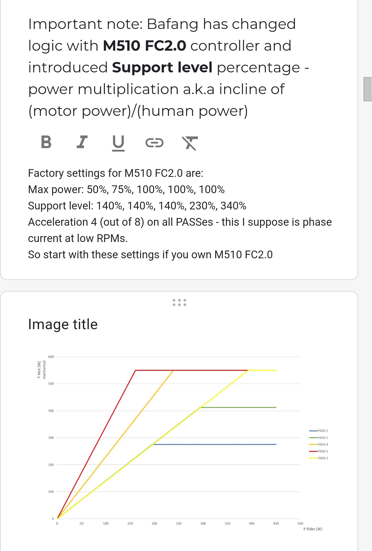

This should explain why. I suppose u have FC2.0 so Support level is now in a game.
And default is 50% - 350W max at PAS1 (aka E)
I did note in a thread somewhere all the peaks I saw in each level, can't remember which thread it was in now though.... or what the peaks were :)
It's the M510 FC2.0 - but remember it's the Vitus firmware so the settings are all different. I hope when I get Go+ I can see what all the settings are.
Zimmer, could u check on Vitus, when starts power limitation?
