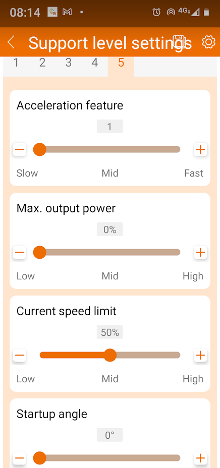

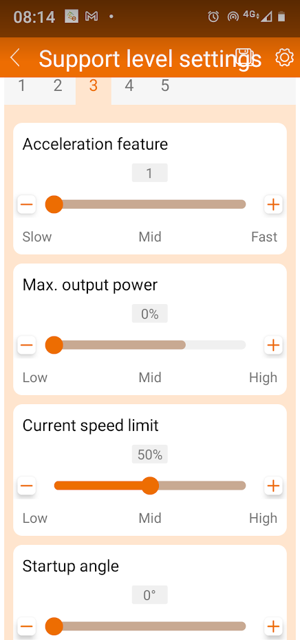

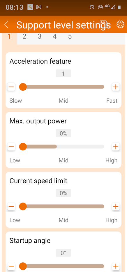

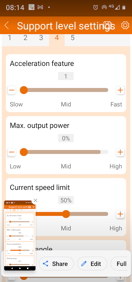

Just swapped the forks/stem/bars ...
Quick test ride - no assistance. Walk mode works. Battery out and in. Still no assistance. Ran "Go" Torque sensor was working correctly.
Swapped the V2 display to the V3 display - no assistance.
Yes ..... It's the Devils Kilometres and @Waynemarlow's Karma ...
Remembering that the figures from Go+ all looked wonky (all left sliders) I tried setting the sliders to the right - acceleration, speed limit (all these now showed 0) Max output power and set startup angle to 1% instead of 0.
Saved the settings. Re-started the bike.
I have assistance again. I just need to work out what the settings all should be !
So beware, for some reason it's possible that in some instances (like mine) GO+ will wipe all your settings to some weird zero default.

Tried various settings.
It's interesting how long the overrun is in the top two modes on the Vitus when you run repeated back to back tests !
In the end.
Startup angle 0.
Acceleration 1 - feels like it gives a really long delay before feeding the power, 3 or 4 are better.
1 - 15% , 2 - 35% , 3 - 65% , 4 - 85%, 5 - 100% - feels ok, but 3 is lacking from what it was previously.
Fits as a kind of usable blend from Spesh's Eco/Trail/Turbo and Bosch's Eco/Tour/EMTB/Turbo.

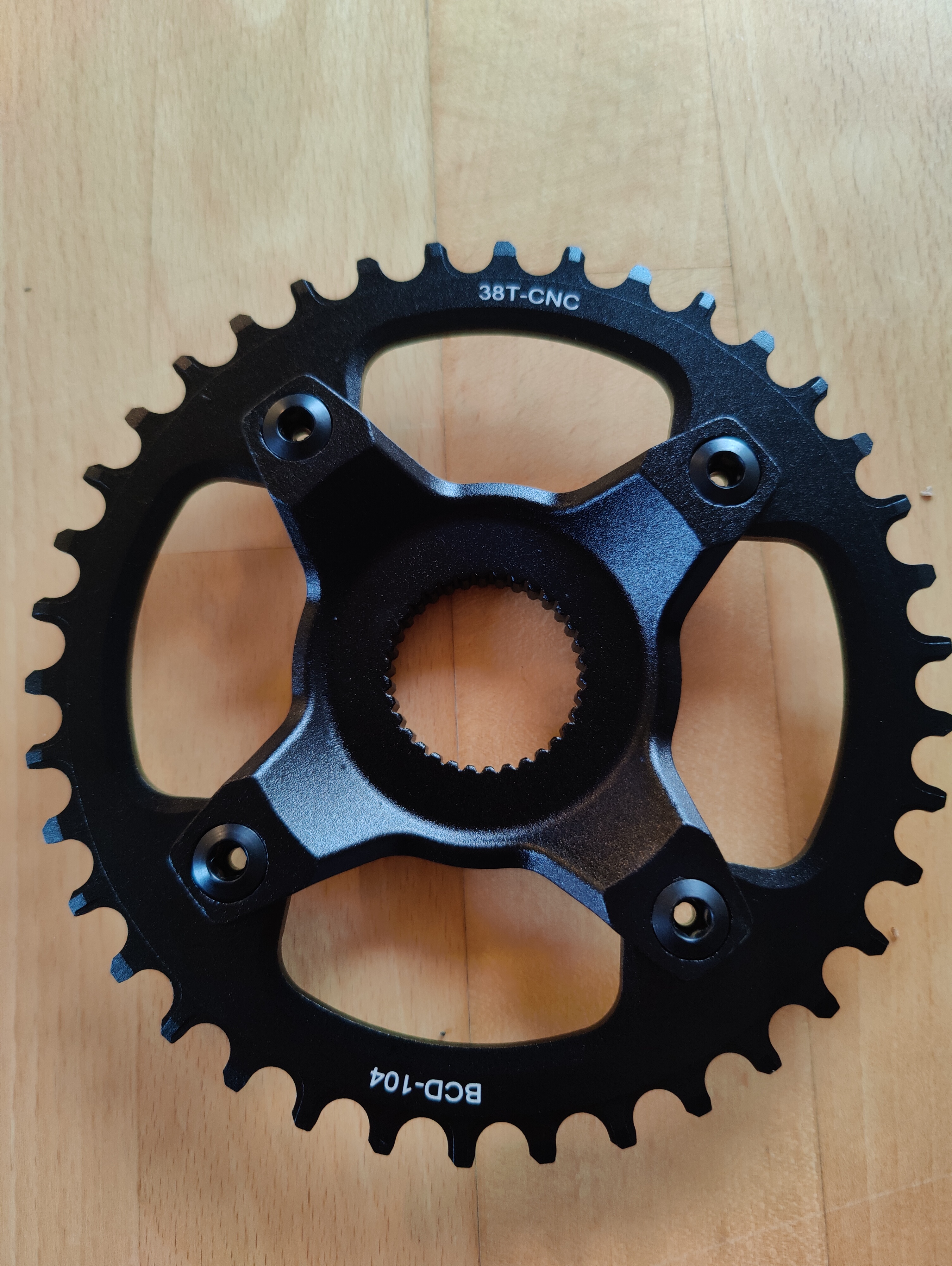

Guys, Bafang is shipping now new chainring and spider with M510. CNCed. ;)
It is 180g vs 260g (old steel chainring).
