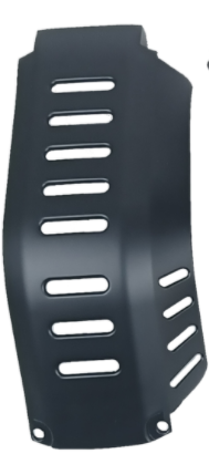

The default sump guard seems pretty flimsy, does anyone know of a third party aluminium one ??
Looks like wiggle/chain reaction will have replacements in stock and not stupidly priced : (£9.99)
Also interesting is that Chain Reaction now have various M510 Parts like top and bottom battery mounts, wiring loom, display,charger, speed sensor and even the nicer cranks are cheap !!

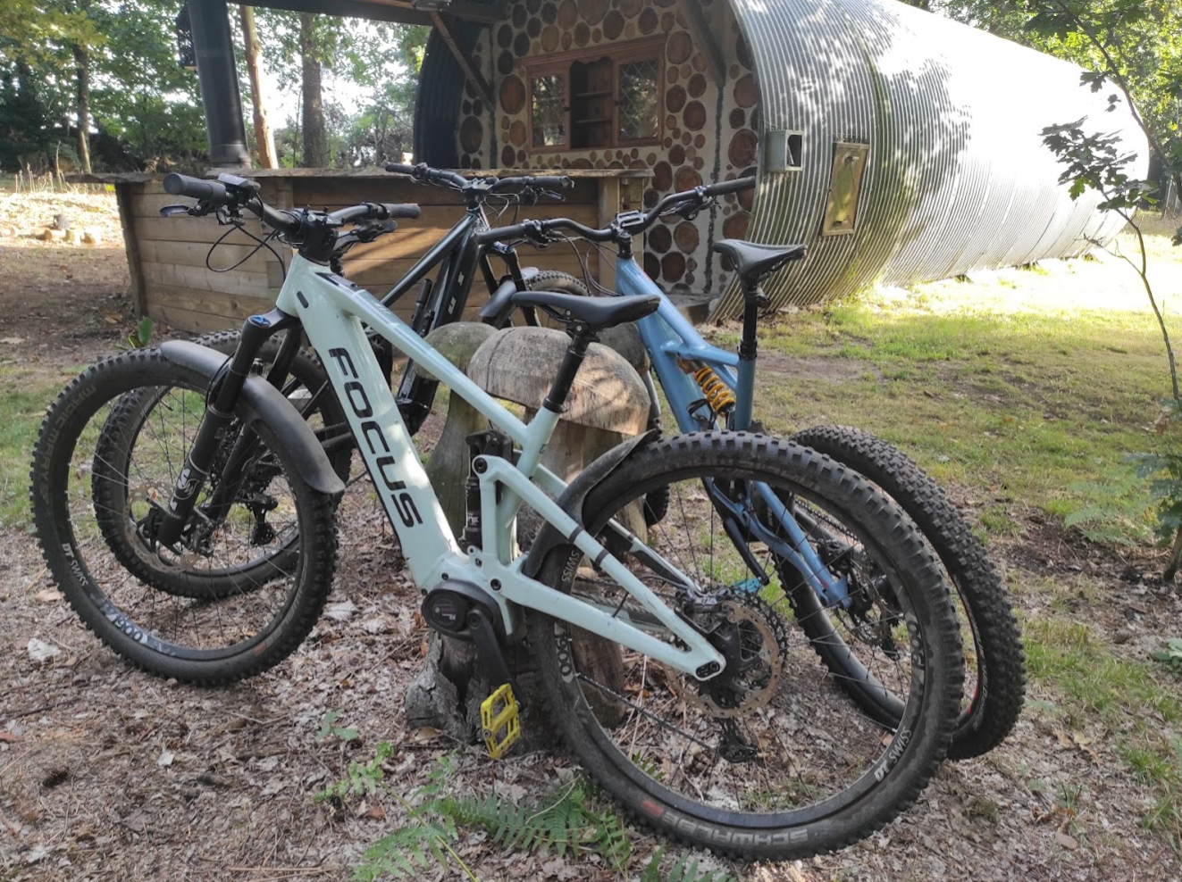

For me ... it's early days.
From the perspective of the actual motor, how it feels, performance I'm really impressed with it.
I also went the unusual route and purchased a bike with the motor installed (Vitus E-Mythique) so didn't go through the experiences or ordering which most people have.
Documentation seems to vary between excellent and none existent (can't find anything on my battery).
If/when I have issues ..... I might feel very differently !!

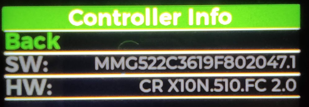

Finally, they woke up and hardcoded power limitation from 10% (why not selectable in BESST is a question). Anyway cut off voltage is still high, so lot of energy staying still in battery.
Zimmer try to get your firmware file from seller. Made up something you accidentally re-flash to original Bafang firm when u was playing with BESST. ;))
Karamba, latest original is v8.1 for 36V. Zimmer has a custom firmware compiled for Vitus.
You can flash your motor, set parameters or calibrate over K1 Flash. Firmwares included on SD card.
