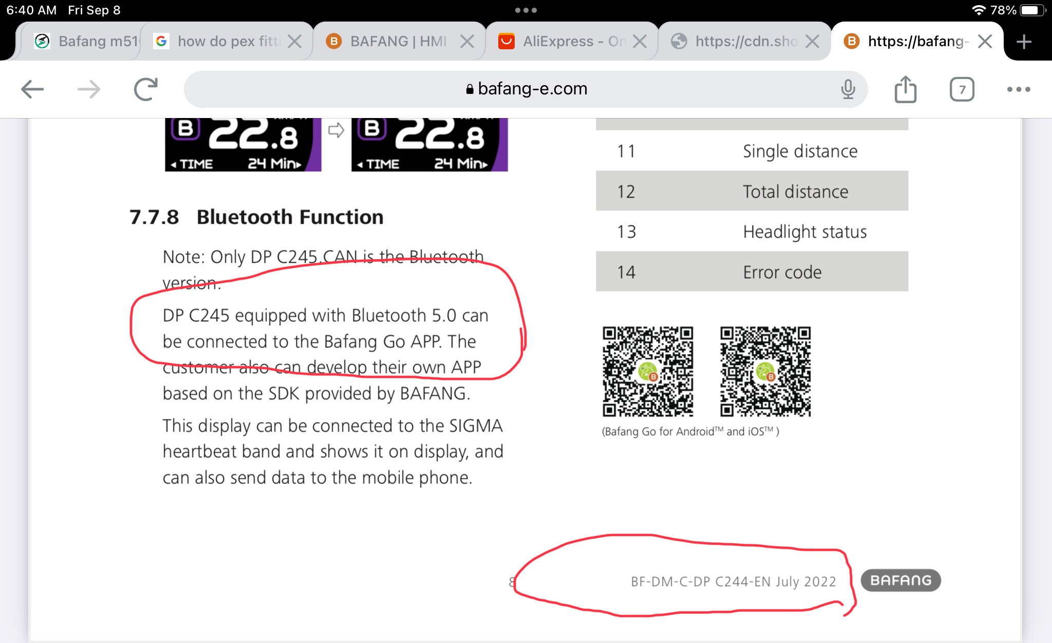

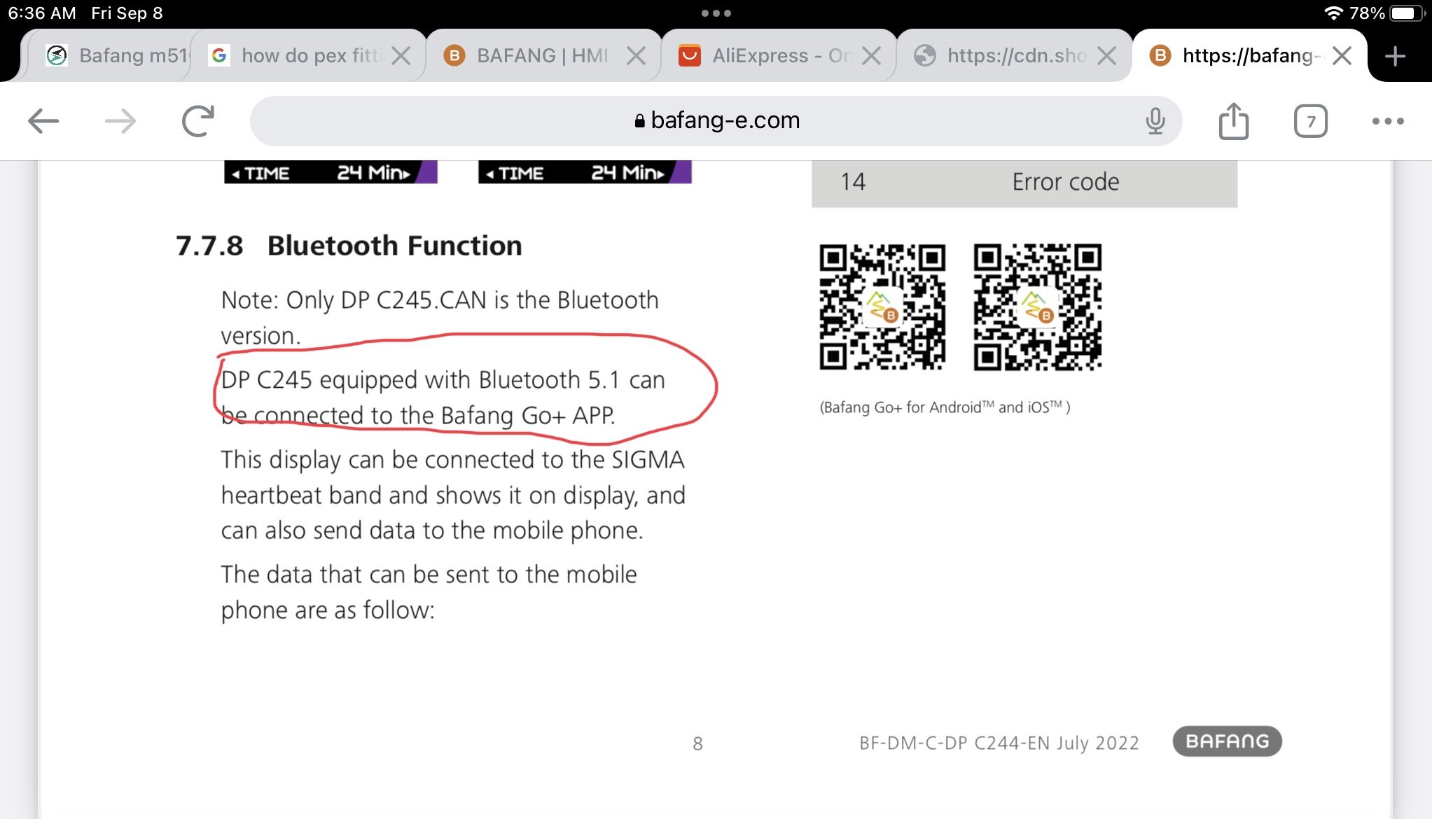

BTW: this is what Fieldebikes told me when I asked whether the 245 I was getting was BT5.1 so it could connect to the Bafang Go+ app
"DPC245 Bluetooth display can work with bafang go ,not bafang Go+
Their website has some errors. bafang Go + serves the IOT system and also has Bluetooth. If the two Bluetooth signals are used together, there will be interference."
Bafang has 2 manuals online for the DPC245: one supporting Bluetooth 5.0 and woks with the Go app, and one that supports Bluetooth 5.1 and works with the Go+ app. The later being referred to as Version 3.
I can’t find any Bafang displays that are Bluetooth 5.1 !! Anyone with thoughts on that?
View attachment 124379 View attachment 124380
The DP C245 V2.0 is Bluetooth 5.0
The DP C245 V3.0 is Bluetooth 5.1

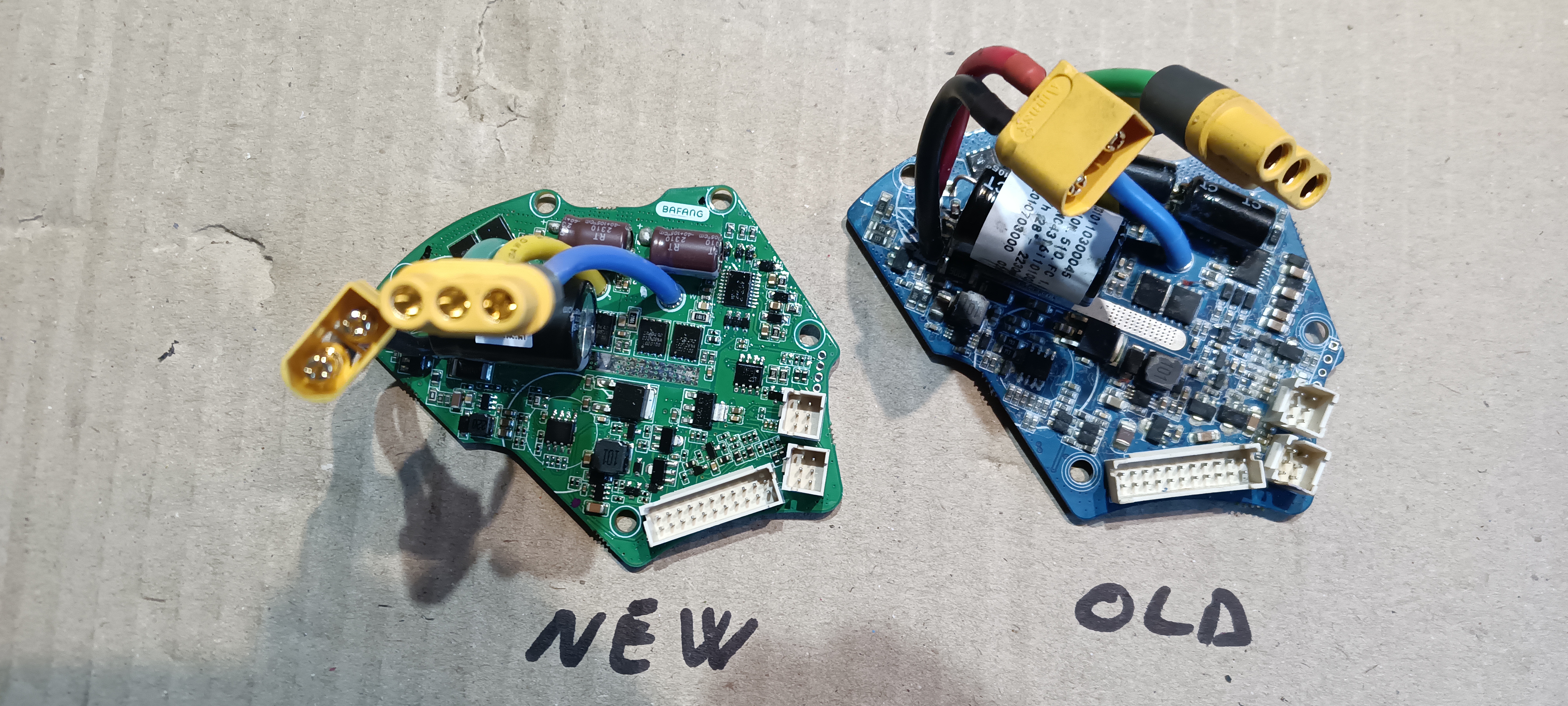

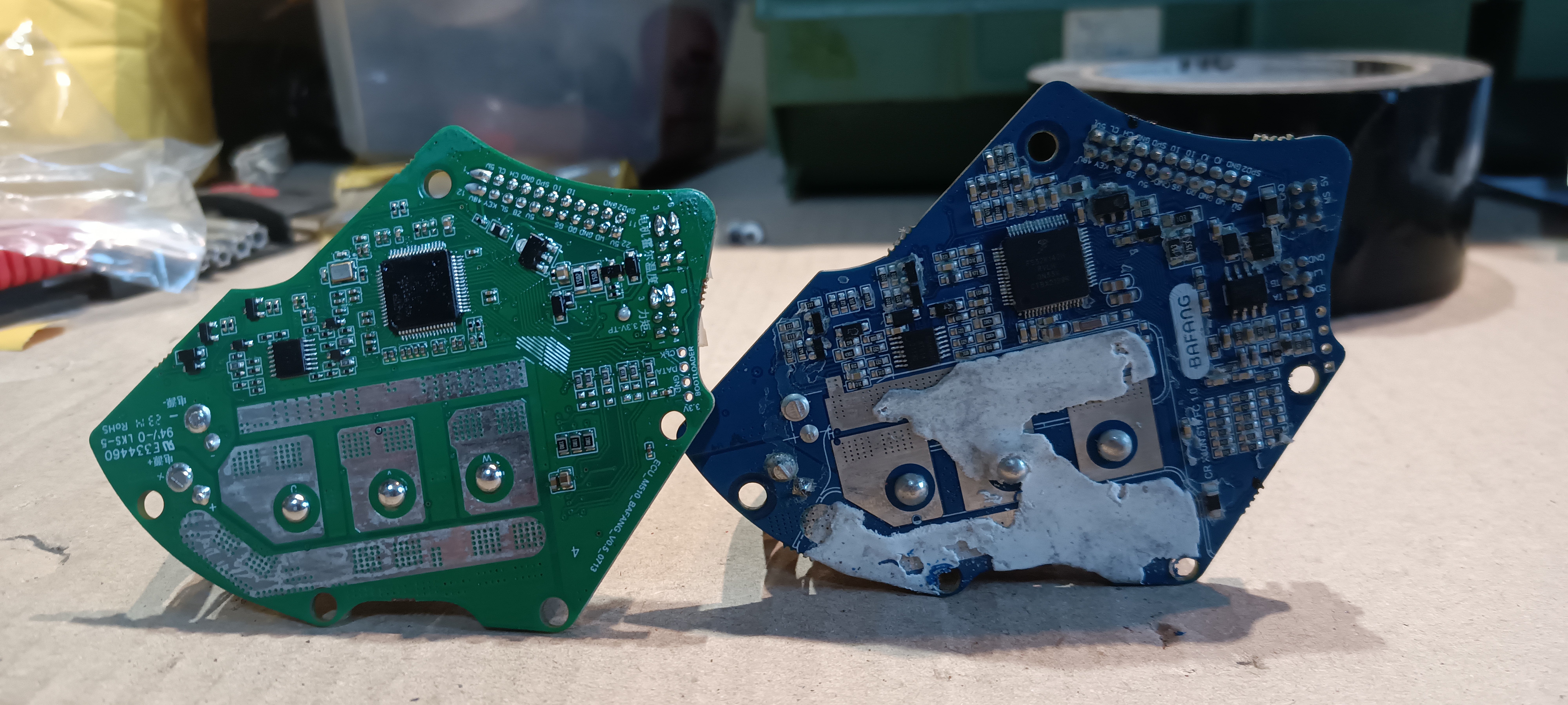

I just received a new controller under warranty after my m510 FC1.0 crashed, (I attach photos of the old and new one). I had pointed out that I had read on the internet about the incompatibility between the FC1.0 engine and the FC2.0 controller, I was told that they would send the right one for my engine. After having mounted it, er08 (Hall Sensor Fault) appears on the display. Should the engine be calibrated? Can you tell from the photo whether it's a fc2 or fc1 controller?
View attachment 124585 View attachment 124586
Yes, after the controller change you will need to do torque and position sensor calibration with Besst tool.

I connected the motor with the new controller and using Besst pro it seems to be an FC2.0 (see software MMG522C4814F802040.1 v. hardware CR X10N.510.FC 2.0) so I think if bafang sent it for an m510 motor it should go well, I can't mount it on the bike yet because I'm waiting for the fork, in the meantime I've assembled an alternative e10 bike with a new fc2.0 engine and I have to say after a short 60 km test that it goes really well, silent and high-performance, i almost always went with the eco level but it's too powerful, i fixed the various levels with besst but i haven't tried it yet
