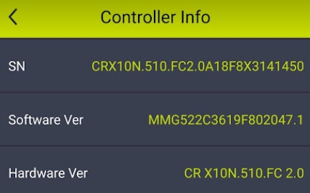

i have last revision on FC1
14,115
20,928

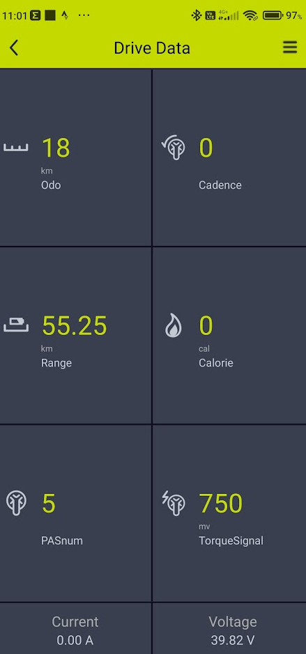

Not sure if this is all exactly the same as the hardware/software numbers everyone else has, but this is the M510 in the Vitus E-Mythique.

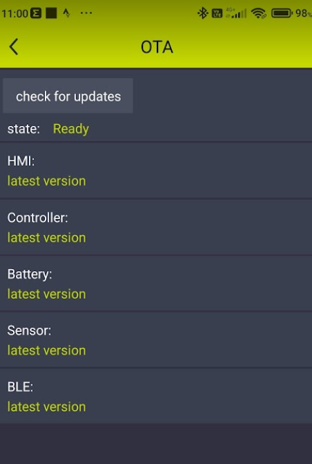

Grabbed those from in Bafang Go. I think it's had a makeover. I tried Go+, which connected but said it was incompatible (I have the DPC245V2.0 - so Bluetooth 5.0 and not the V3.0 which had Bluetooth 5.1 which Go+ needs.
Go seemed to actually connect fine and work fine, gave access to lots of info and the live data screen seems to work. There was even a page to update firmwares over the air or locally (No idea if that page actually works or if it's just for show :

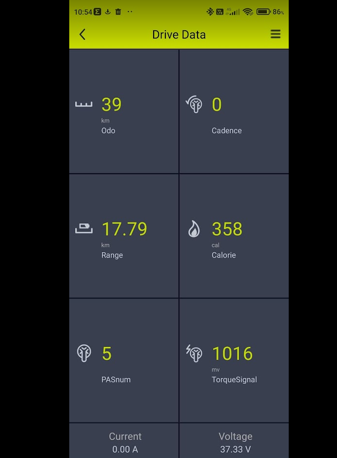

There was another page :
Not sure what PASnum is or the millivolts Torque Signal, maybe could be useful for diagnostics ?
14,115
20,928
The Torque signal is live and seems to show the force on the torque sensor from 750 as no force to :
Foot Resting on Pedal
A bit of pressure
Harder
Fairly hard

You dont know what is PAS? ;) And yes, it is volts output from torque sensor, why are you surprised?
I'm surprised because it works ! Which given the general feelings towards the go app, is unexpected.
Where as knowing what pas generally refers to as an acronym- pedal assist level - doesn't mean its the same here as it doesn't seem to correspond to the assistance mode, whereas that is displayed correctly on the go main display.
