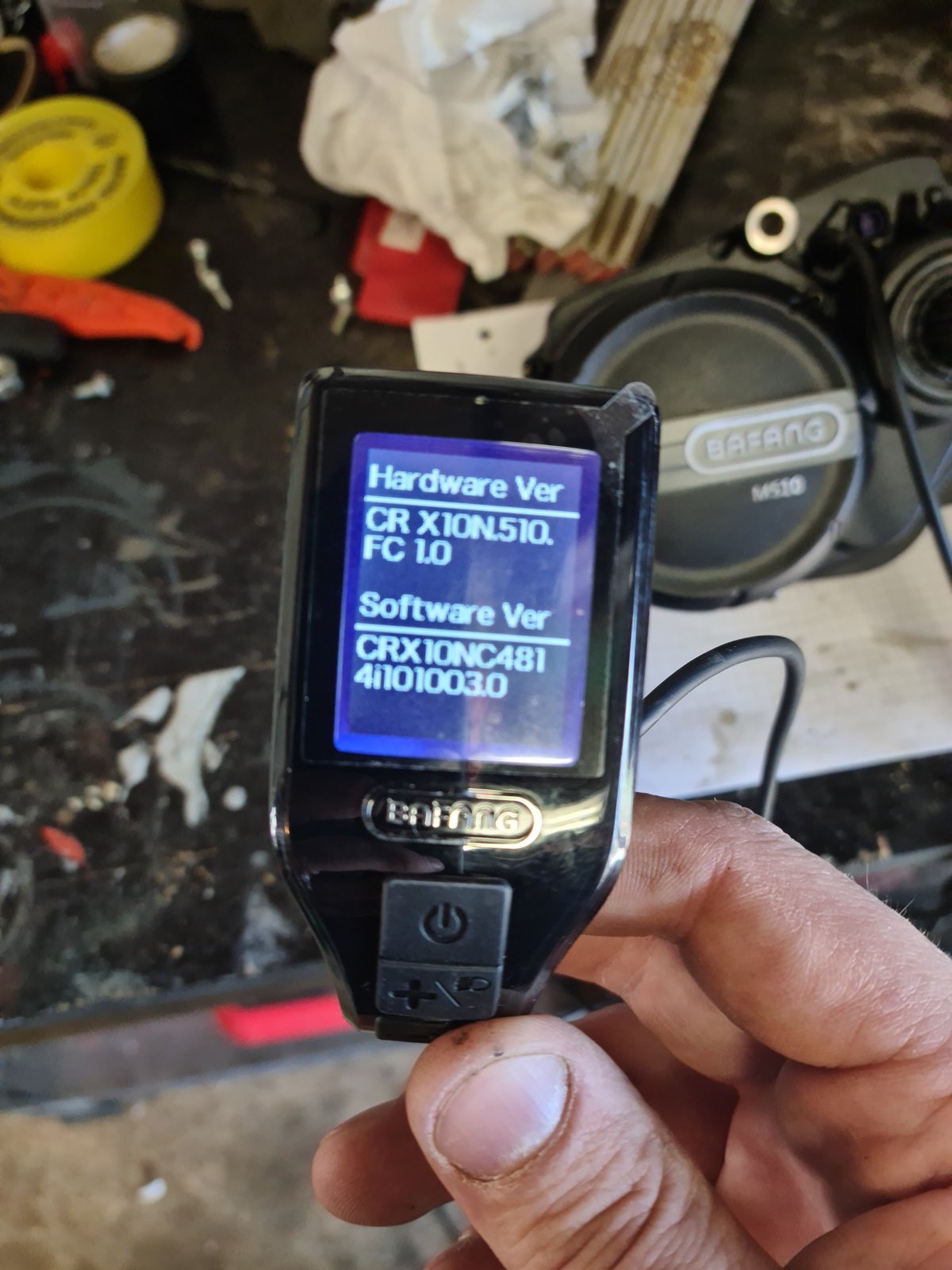

Nicole from Mayebikes ask BAFANG on monday to send me the 48V firmware.

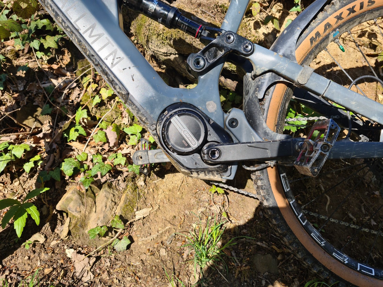

Hello everyone. m510 arrived. built-in and tested. a faster engine reaction is immediately felt. stronger power supply on uphills. if some details are still being worked out, let's hope so. on some hills it even delivers too much power at low revs. but you need to get used to it. at some moments 2 and 3 level the engine stops at low cadences when there is no load, when going from uphill to straight. but for the most part there is an improvement and a stronger supply of power on the hills. before on a hill quite steep m500 was the same 4 or 5 level. now the difference is felt. lower battery consumption! now shows in the application bafanggo and bms from the battery similar voltages. and they fixed that part. these are the impressions after the first run of 20 km and 1000m altitude. consumed 40% of the 480wh battery. I will write more comments after another ride.

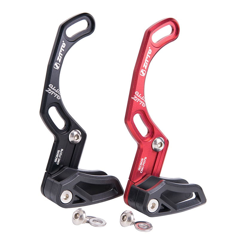

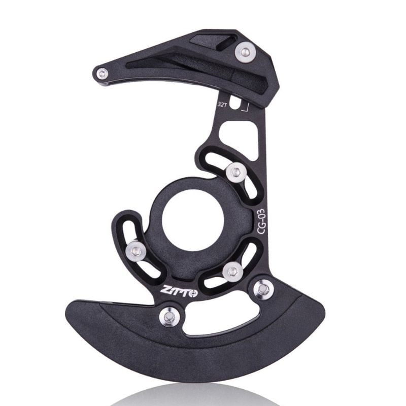

update. needs new chainguide, since m500 doesn't fit. the crankarms screw is M16, does not match the M500 M15
pictures of chainguide attached
