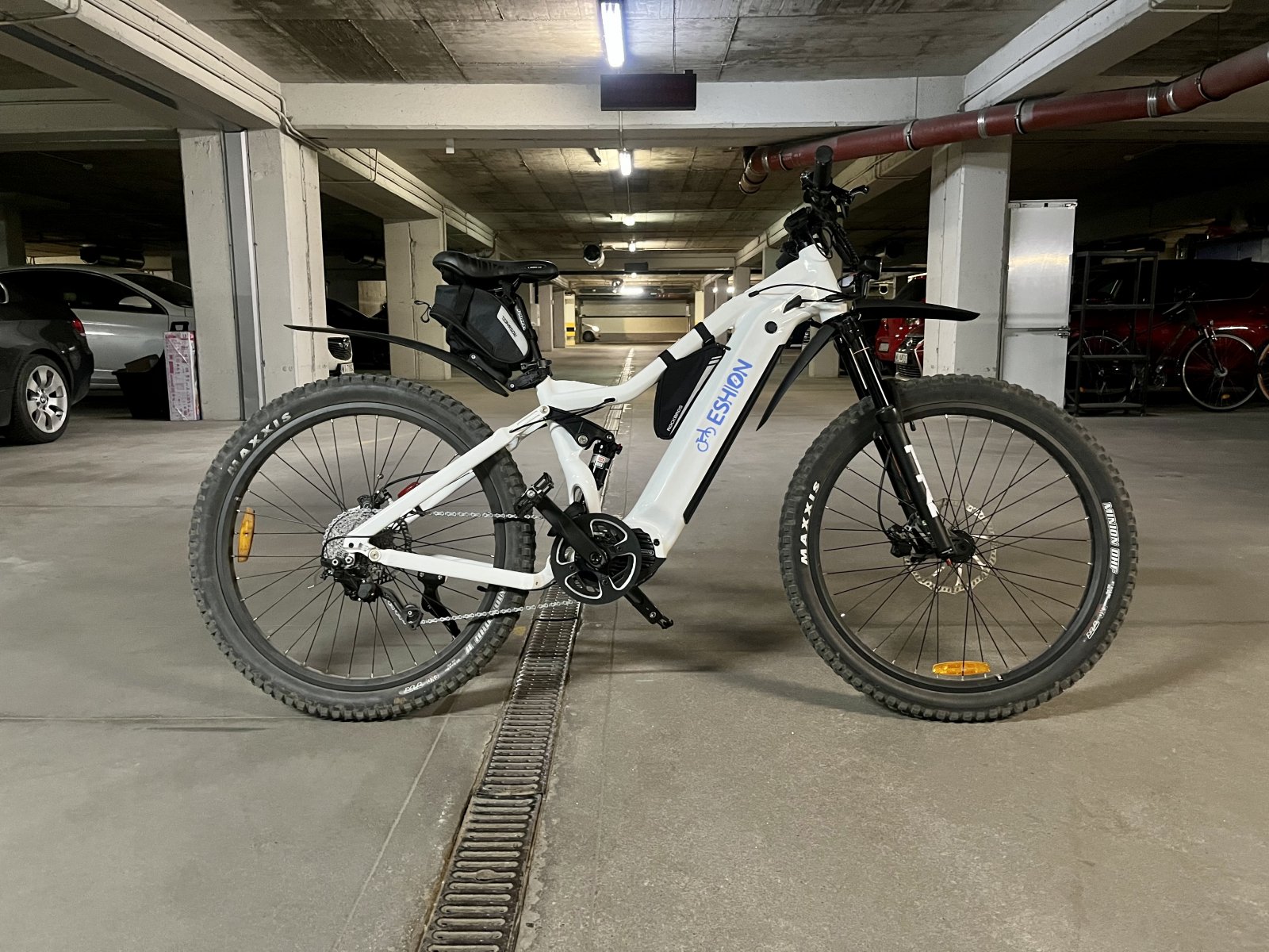

btw, photo with new slightly shorter rear damper, offset bushes, and head angle mod.
Went from 72 to 68HA.
