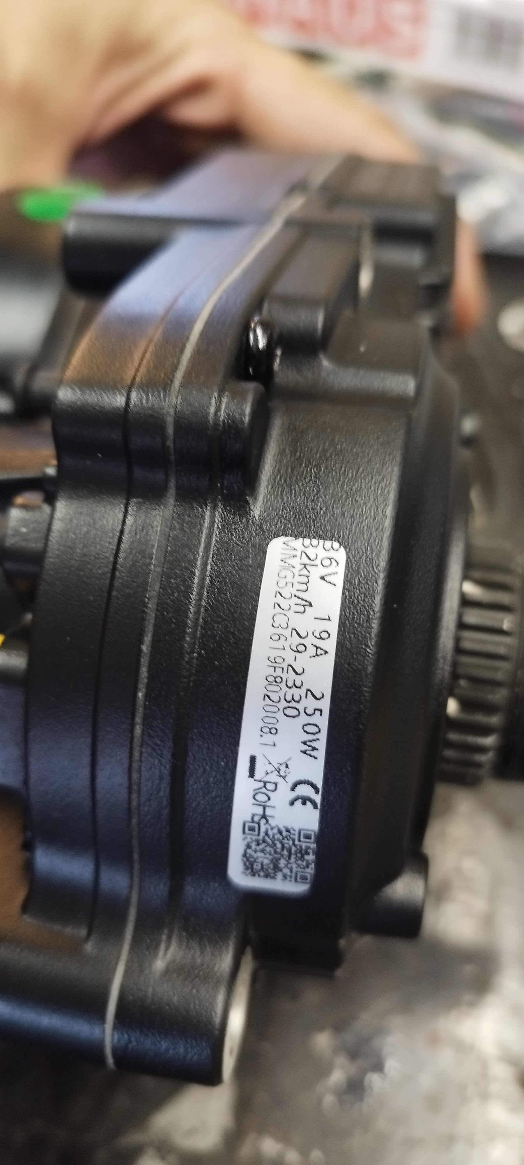

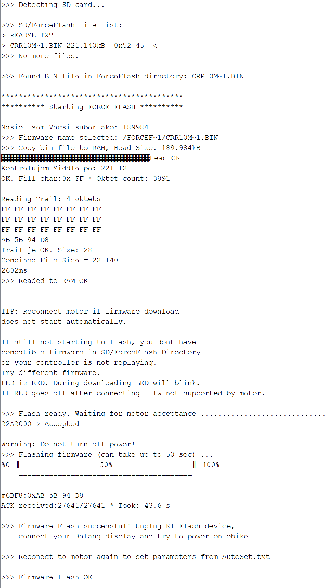

So here’s the latest 36V firmware from Chili.
@Dado: Could You please do me the favor to check if this suits my M510 FC1 Rev. „I“?
is this fw suitable for my engine?

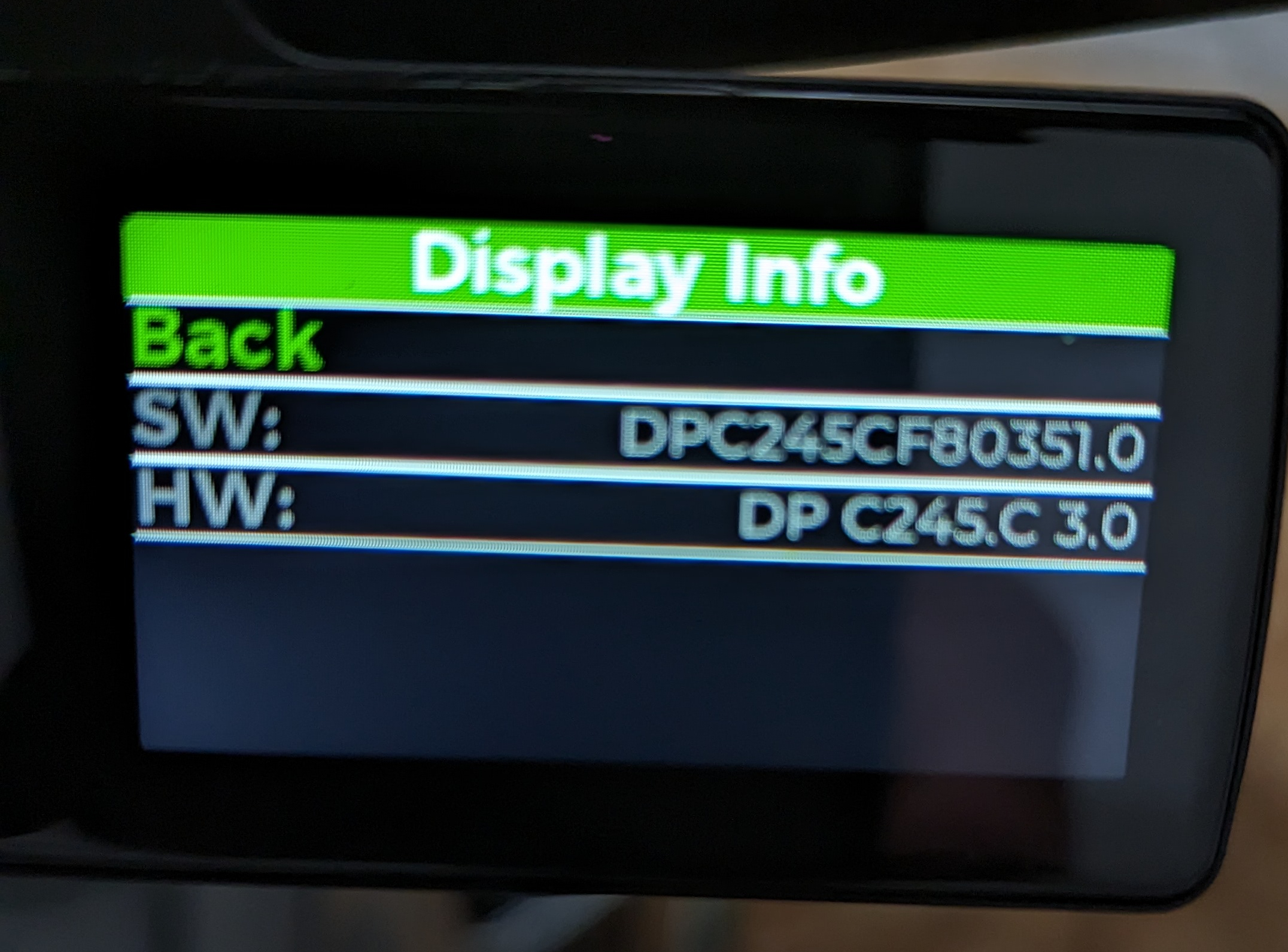

has anyone been able to adjust the engine parameters via the go+ app. I won't even connect the dpc245 and the application. some help, suggestion?
Dado
Jun 28, 2022
725
487
Bratislava
With version 80201.1 you can connect to Go App. But still not supporting power adjustments.
Check this:
Just yesterday did add M620 firmware flash support (so would work also with M300 and M420). Will complete it this week.

Hello. one question. is it still possible to load 48v firmware into a 36v motor? I intend to change the battery. well known bafang battery percentage.
Dado
Jun 28, 2022
725
487
Bratislava
Fico, that is possible. Not pissible to flash 43V into 36/48V motors.
Not sure why they did it. Maybe a precaution not to flash 43V and use 48V batt. I would guess 43V firmware would now refuse start with 48V batt. Which is making me sad. :) That was simple trick to get more power from motors.
