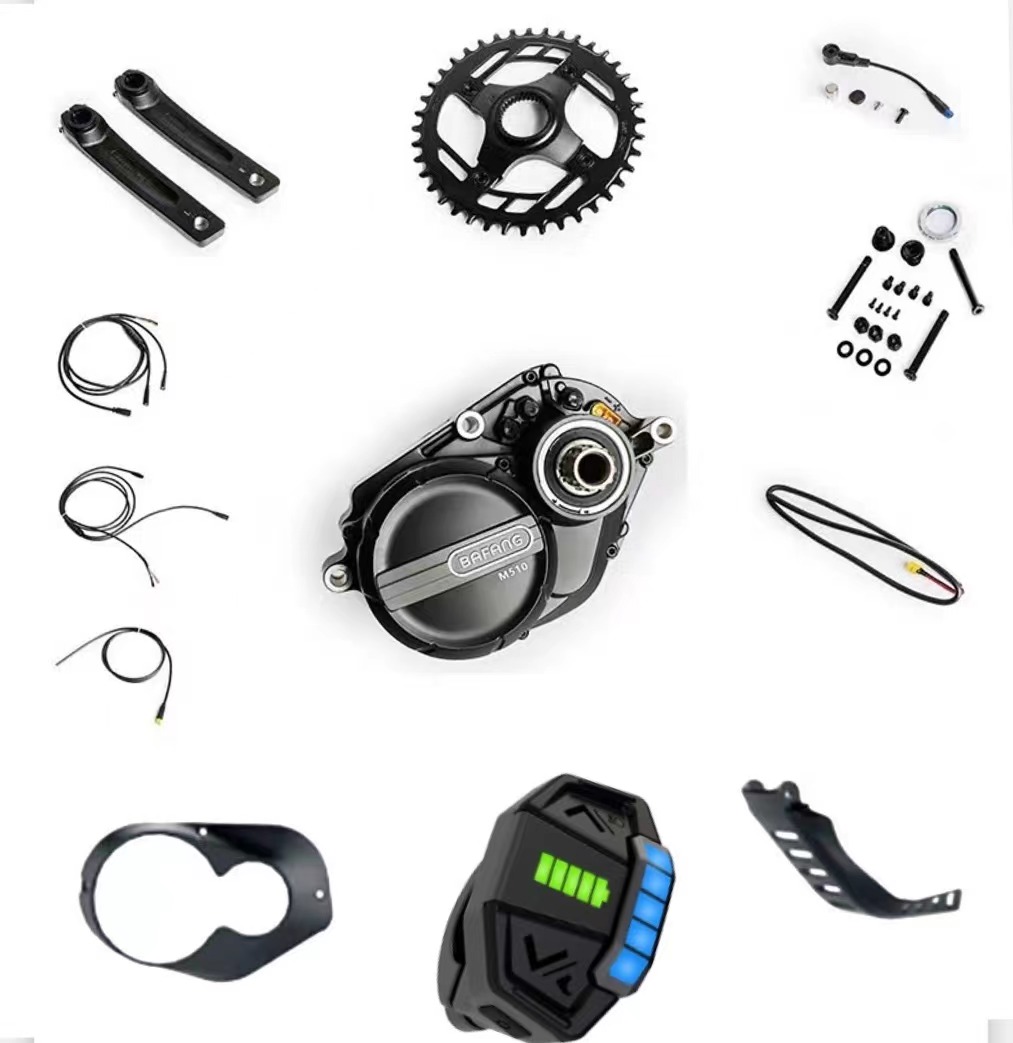

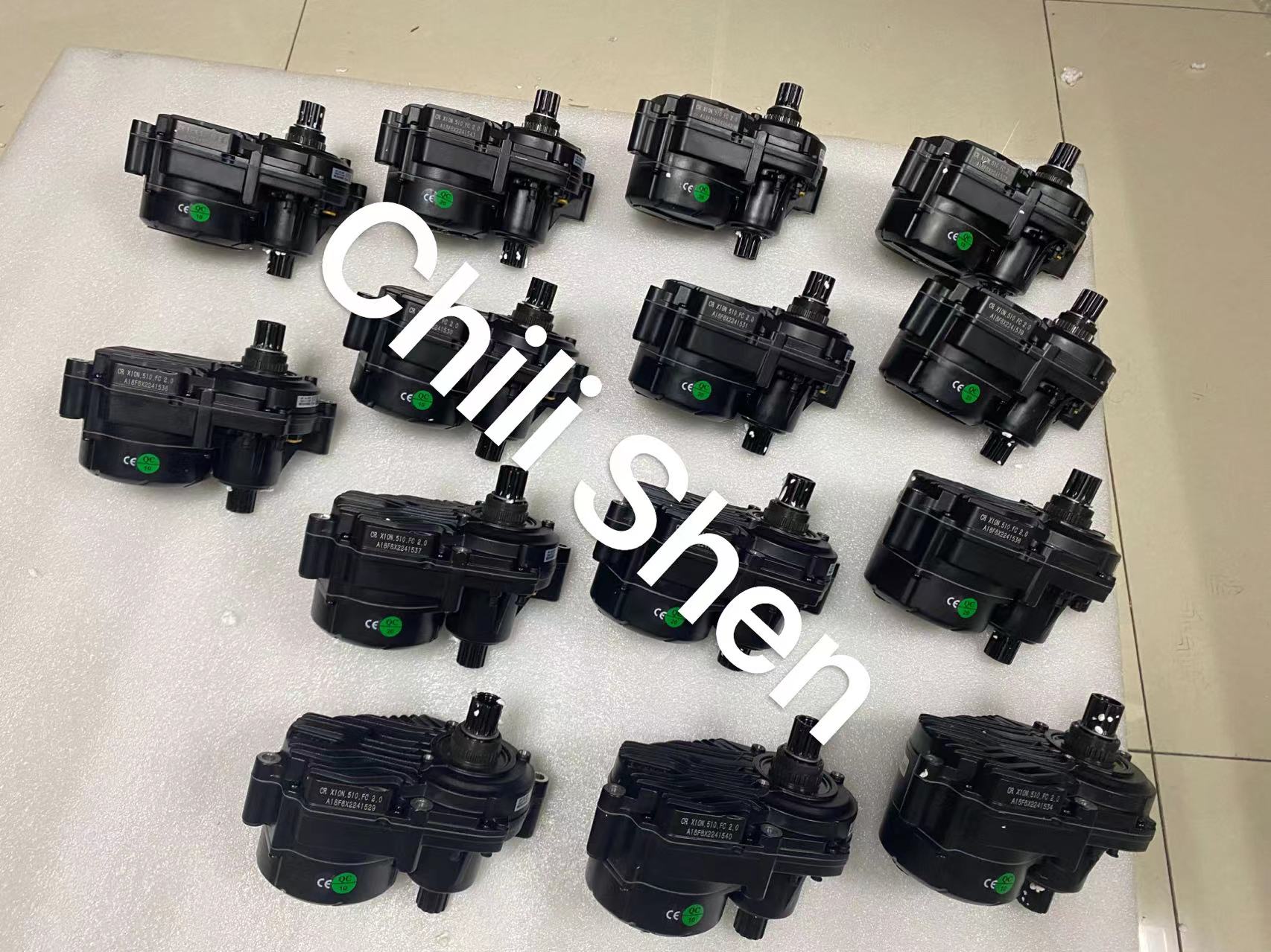

Hi, I just bought a M510 FC2.0 to Chili Shen, who's "Anna Shen" (Edited) on Alibaba :D
Should be shipped within 12 days...
Not yet decided which frame for the time being.
