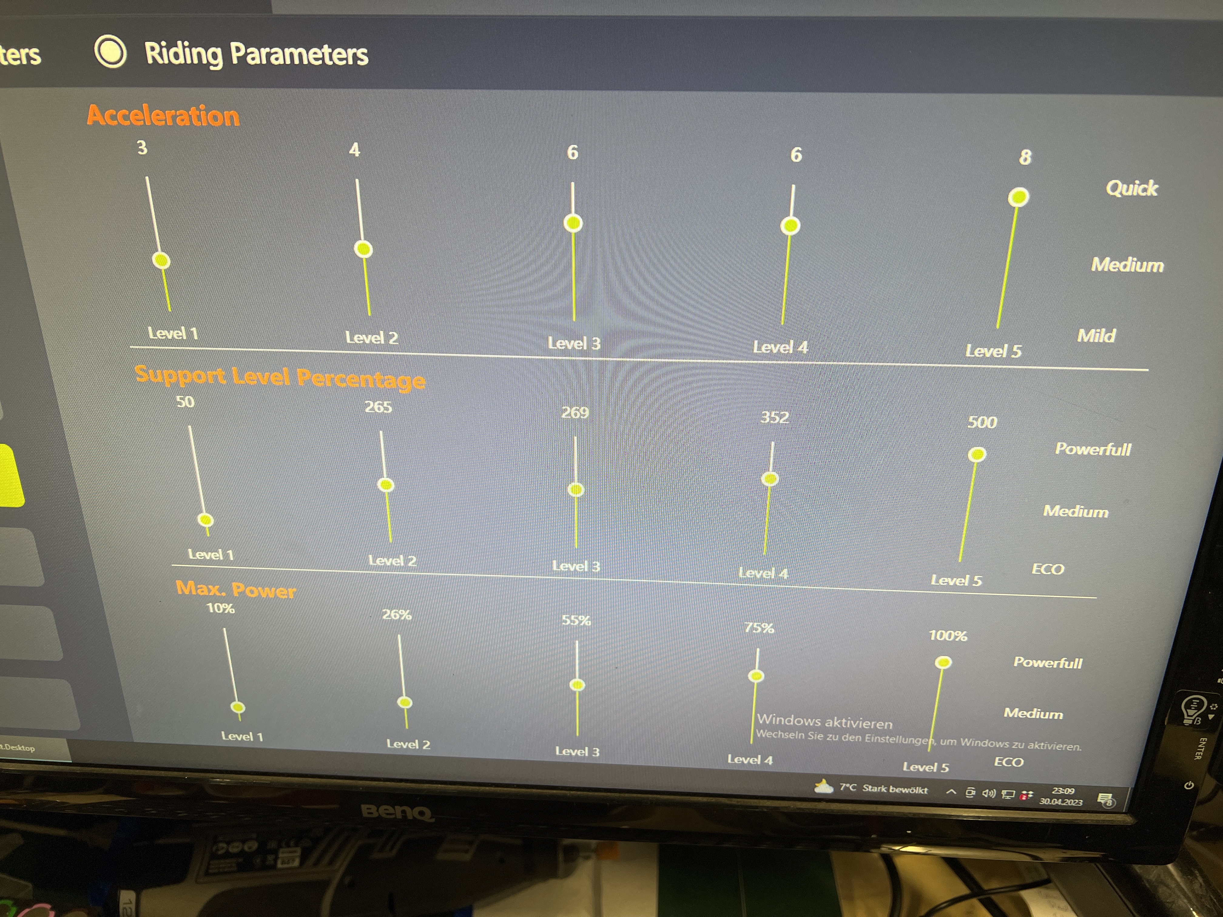

Hi Guys, can somebody explain me the setting support level percentage?

How I read it. ;)
Acceleration - self explanatory. It is about starting currents. How steep is ramp up curve.
Support level - sensitivity to pedalling. Or torque multiplication, how they call it in Bosch. More percent - you need less to push to pedals.
Max power - current limitation. So if you have 19A motor firmware and set to 50% - max DC current will be 9.5A (+- overshooting). I noticed BAfang has it quite high (50, 75, 100, 100, 100%) on FC2.0 - can work with correct support level settings though. For better ECO mode, I would set PAS 1 to 20%.

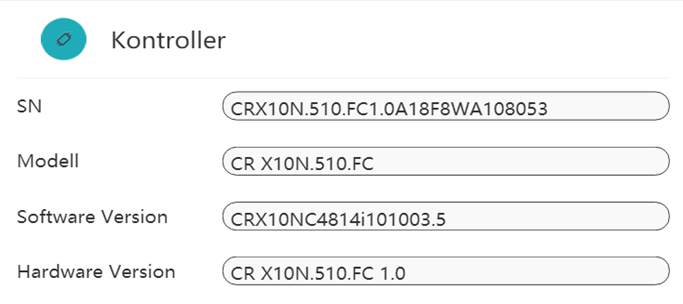

Thanks for Your kind support @Dado! I have a customer who wants to buy my M510FC1, but he needs 36V firmware. This is what all the trouble is coming from. Chili gives me great support, but Bafang is not really supportive. No solution yet.

Also dont have any 36V firmware for bootcode 0x90. :(
I guess, bafang not selling this controller any more.
Another solution for you: To buy 36V controller fc1.0 bootcode 0x91.
Not sure if takes also FC2.0 controller. That would be better option. Try ask Chili if she is selling also controllers.
