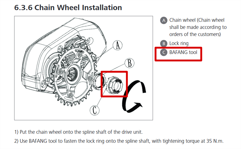

Hej,
What kind of tool is required for installation of chainring.
Is this propriety BAFANG tool, or can something standard be used?
