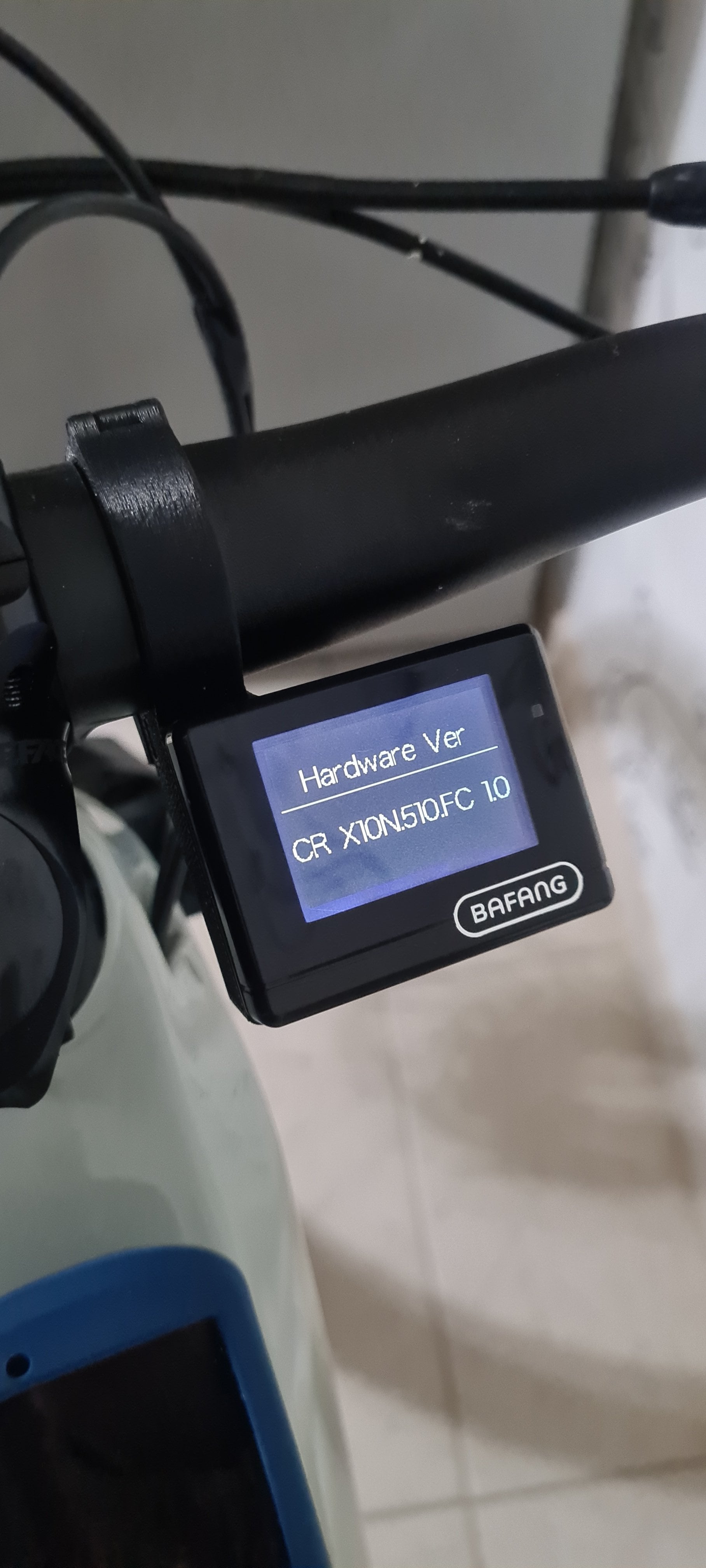

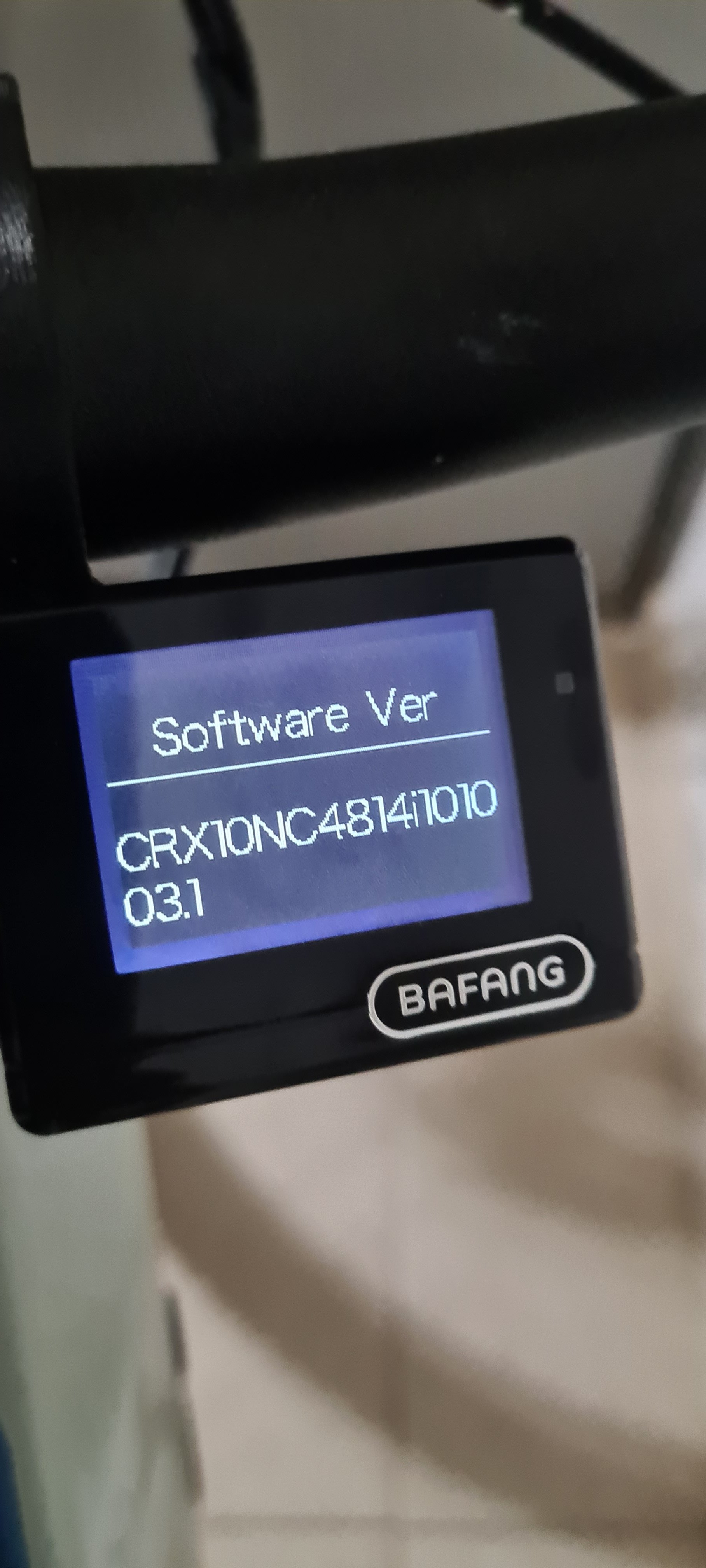

whta firmware u have installed on your M510?

Also, has anyone found a way to fix the motor turning off (for a second or fraction of a second) in mode 1 and 2 when riding flat or up a slight uphill. I read that the m510 takes a little longer (about a minute) to calibrate when turned on. But waiting more than a minute doesn't help remove the turn offs on my motor.
Many thanks!
enter in the HMI parameters (check procedure in line following your model). Display controller hardware version and press + to see software version
Thank you for the comment. I have these figures

Just to understand: Are You talking about controller rev „E“ or rev „I“ according to Github specifications? What firmware did You run before updating?
At this time the only firmware who i could upload are 3.2 and 3.1-CS from rev "I". My controller hardware is rev CR X10N.510.FC 1.0.

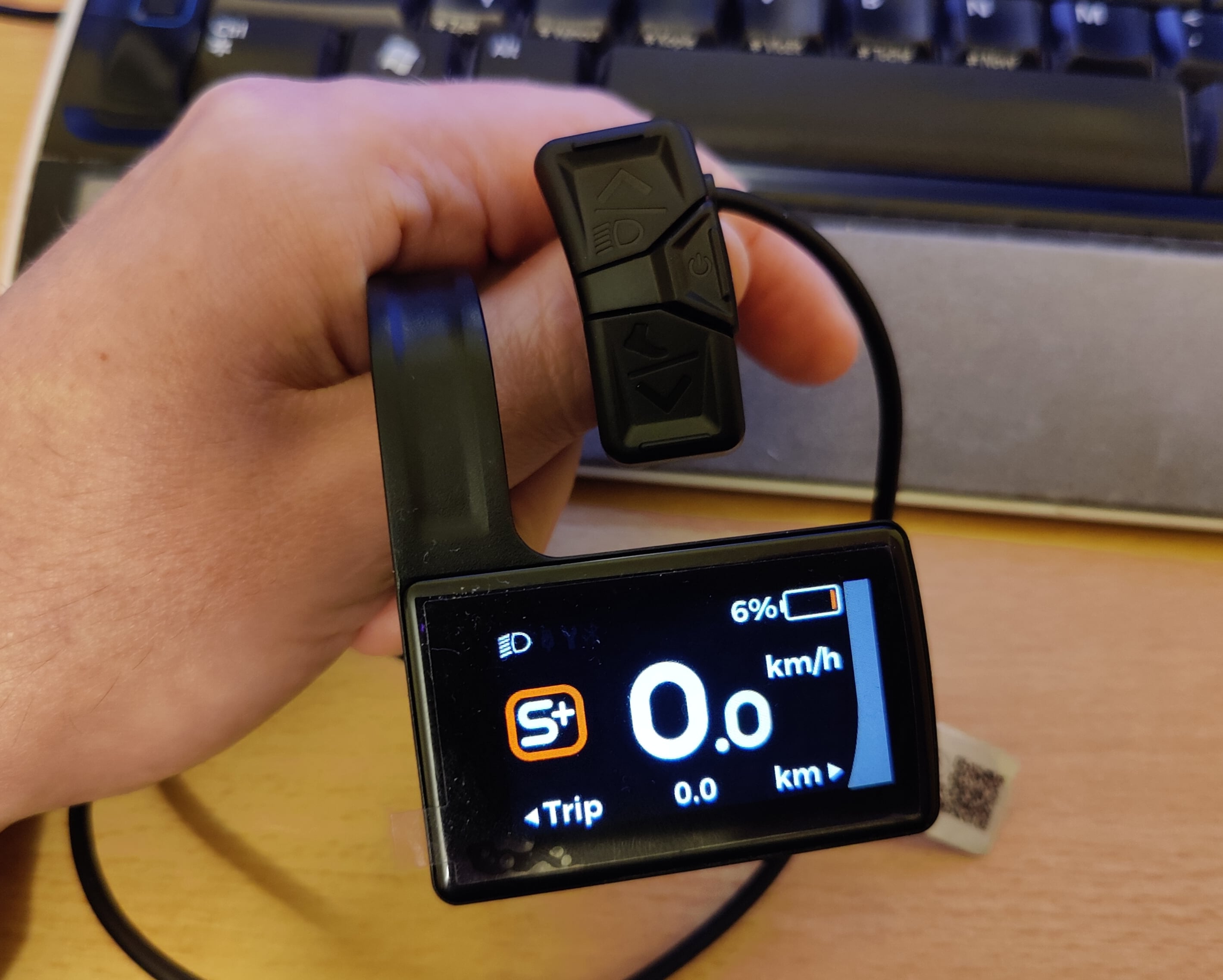

And got also new colour display DPC 245. Looks good, I like new smaller buttons. Just was changed PASS levels 0 1 2 3 4 5 to 0 E T S S+ B (I like more numbers, you can orient faster when u look at display). And looks like PASS level 3 and 9 is gone, new display has only 5 levels.
