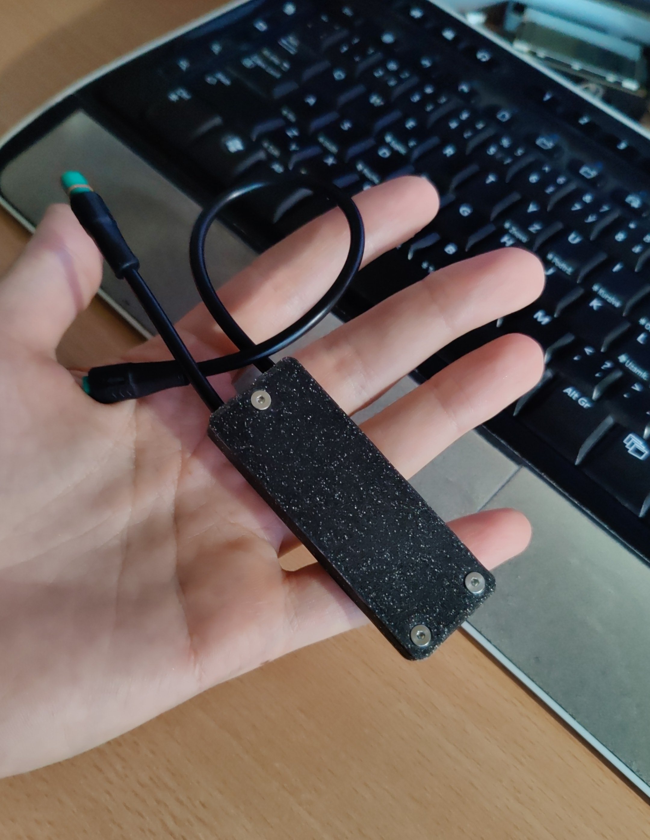

And this is new K1 speed unlocker, support also M510 power maps adjustments, Startup Angle and Acceleration. Also has an auto reset function to legal speed after power on. Can be installed inside frame or outside. Will be available soon for purchase.

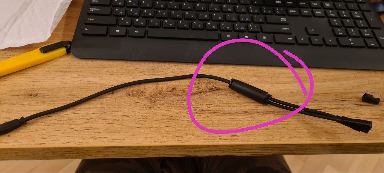

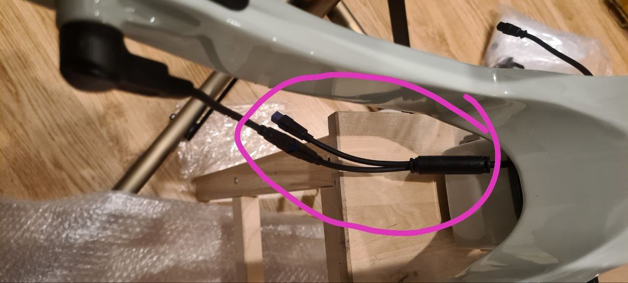

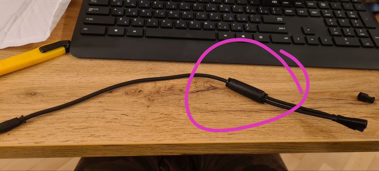

Hi guys. Pardonme for the rookie question. I'm trying to build Degfu e10 with an M510 motor. Motor comes with this wire for the speed sensor. It has a second purple output (probably a gearshift cable) but the plastic connector is exactly in the middle with the frame hole. Maybe I need to buy another wire or shorten this one? Thanks

Iscander you are right, let me explain.
M600 set was comming with a simple cable (one connector to motor, one to sensor) and shorter cable. Also sensor was with shorter cable and it fit perfectly with Dengfu frames.
Latest M510 sets is comming with more cables and front and back cable is split (to light cables, batrery CAN, shift sensor, brake sensors, and no throttle connector!). And as you writing, that rubber block on speed sensor now fit exactly in front of the hole and next to tire, which is really stupid.
1. I was asking Chili and they are somehow not willing to let me choose cables I need. Which I dont understand, what for politics is this (maybe in some default cable set its cheaper for them. With custom cables more expensive - but I dont care about this, I would pay for that cables.)
2. Yes you can shorten it and get rid completelly of that rubber block in the middle. Best solution - cut both cables and weld at the end of speed sensor connectir, which is going to motor ( you will get rid of middle connectors also).
The problem is, now I need to fix everything after Bafang and dengfu, which is a pain and takes quite lot of time (I shouldnt be fixing wrong cabling, wrong charging connector, Battery on/off to shorten inside, padding for battery - recently 1mm play, to put gasquet under battery cover, fix bolts with proper loctite, change headset, to buy extra charger - current one is shit. And this is the problem with Dengfu, they dont care about details. If you building only one ebike for you, it is ok. If you building them 10, it gonna sum up, cost me time and extra money.
What I did, I have bought that simple cables for speed sensor from Bafang including main cables with throttle connector.

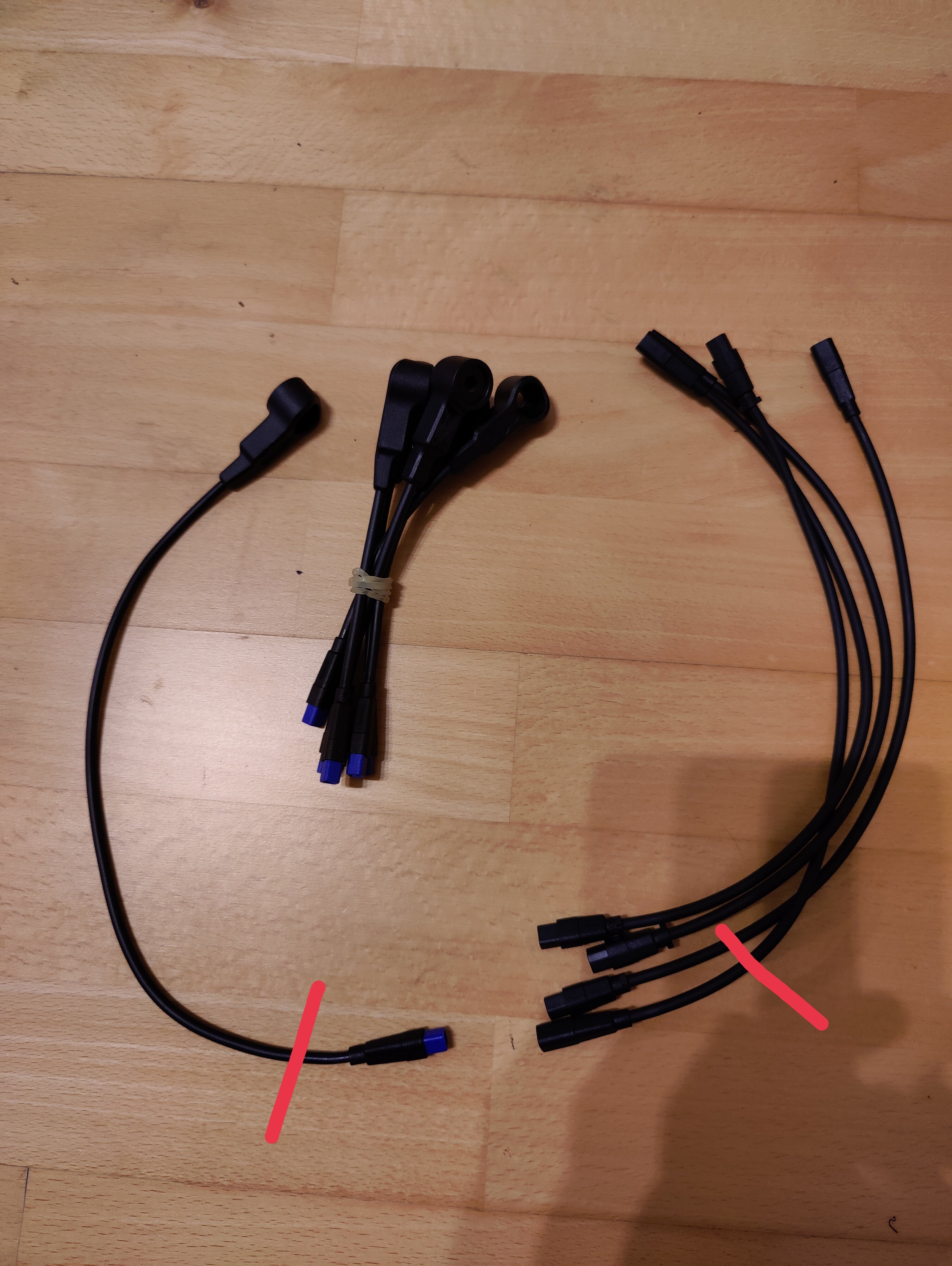

Thanks for your message. I saw on the bafang website 1t1 cable only one cable between the sensor and the motor. But I can't find it on aliexpress. Maybe I need to ask someone who sells bafang products. Without a spare cable, it's a little tricky to cut it.

You wont find it on Ali. :(
Why tricky? Just cut it as in picture and weld connector (the one which is plugging into motor) to end of cable with speed sensor. I think you wont need light cable and shift connector.
Notice, they have changed also length. Left sensors from M510, right cables from M600.

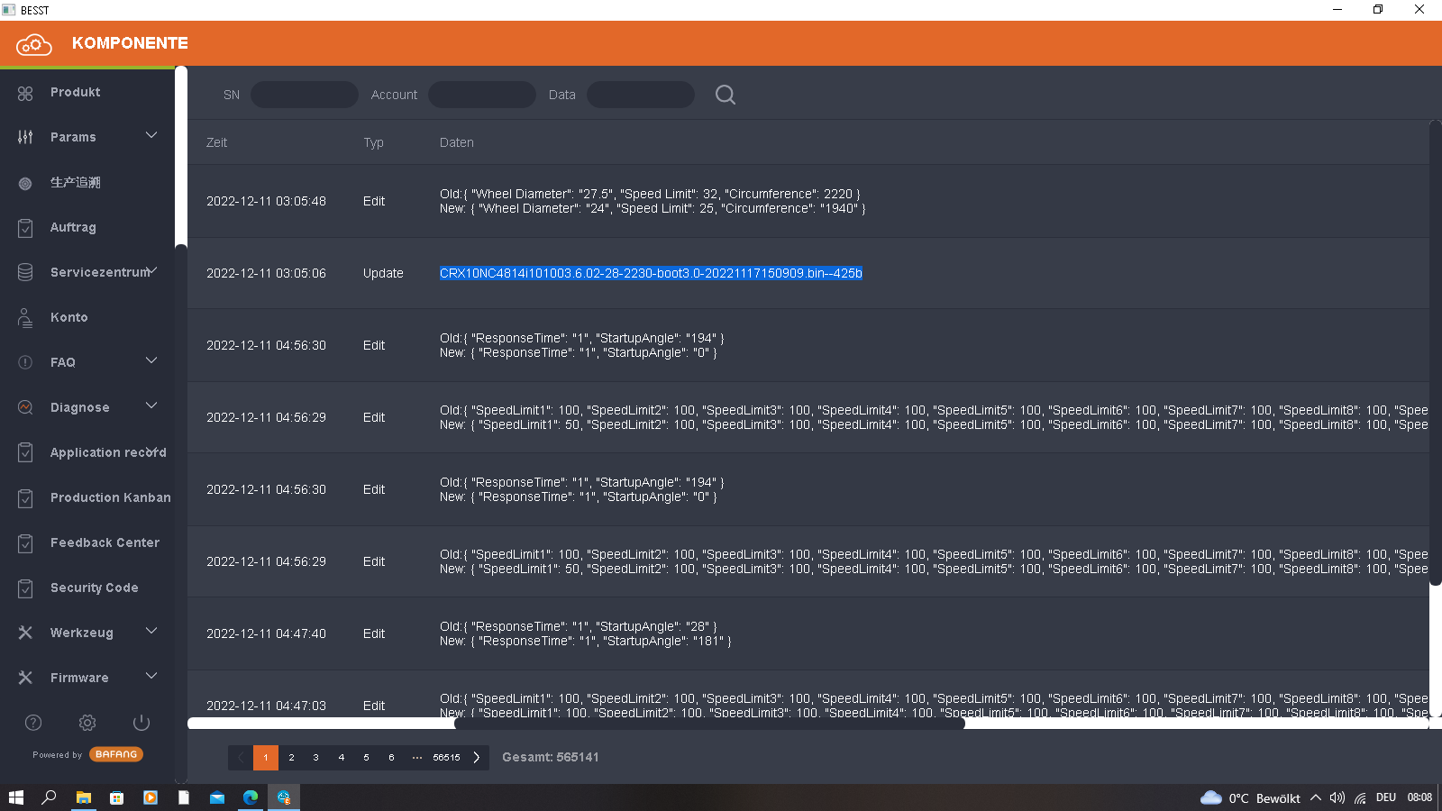

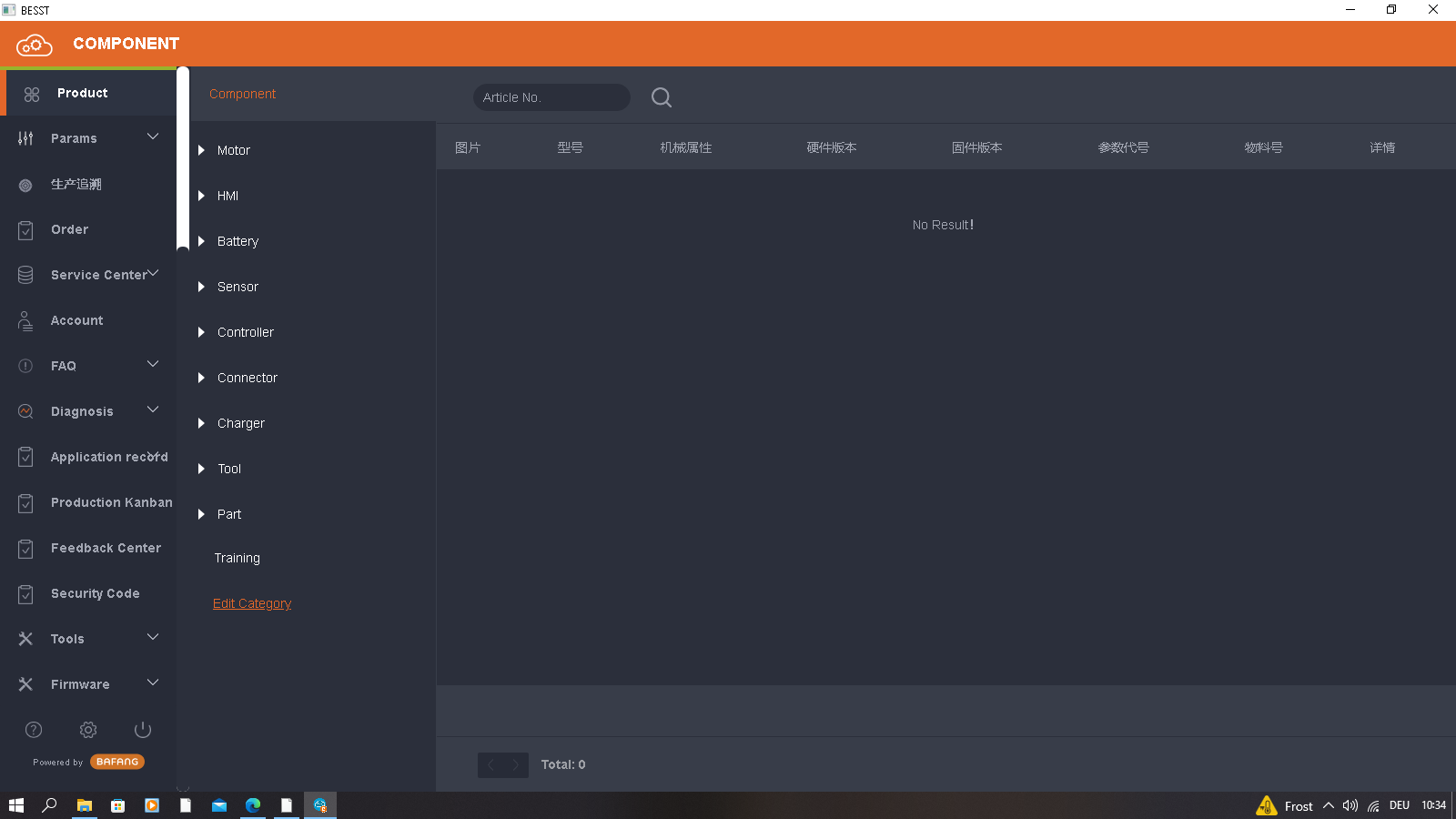

kennt jemand die Besst-Software und könnte mir helfen?
Es gibt eine neue Software für den M510, wie Sie auf dem Bild sehen können. Aber ich kann es nicht herunterladen, wenn ich den Motor anschließe und versuche, zu aktualisieren, sagt das System immer, dass kein Update verfügbar
ist. LG

does anyone know the Besst software and could help me?
There is new software for the M510 as you can see in the picture. But I can't download it, when I plug in the engine and try to update, the system always says no update available
is. LG

You see, you can write also the way we all understand!
There are 3 revisions now of this motor (and probably fourth on the way).
I suppose this version 3.6 will be the last revision (identification byte 0x91) and you dont have compatible controller for this version. Send me the bin file, I will check what version it is.
Bafang coded Besst very stupid, it wont tell you anything, no message, it just wont start to flash.
What version of firmware you have now in the motor? I would say, you will be able to flash version 3.2

I have component access and can therefore see many. Also who downloads updates what has just been ordered from Bafang and so on. But I haven't found out how to get the individual software updates yet, I've already found some, such as for the M300 and M400

36V firmeare v16.1 and would say it is 2nd revision of motor. Have you tried to flash v3.5 here?
There is also mess with version numbers. I have 3rd revision of motor with 36V 19A firmware and version is 7.5.
How come, you have such an access level into Besst? Are you a big dealer of Bafangs?
