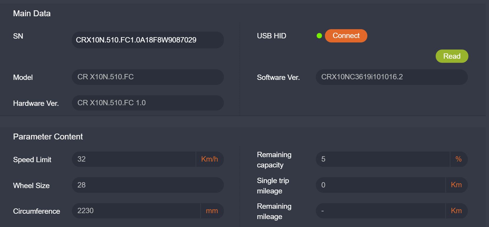

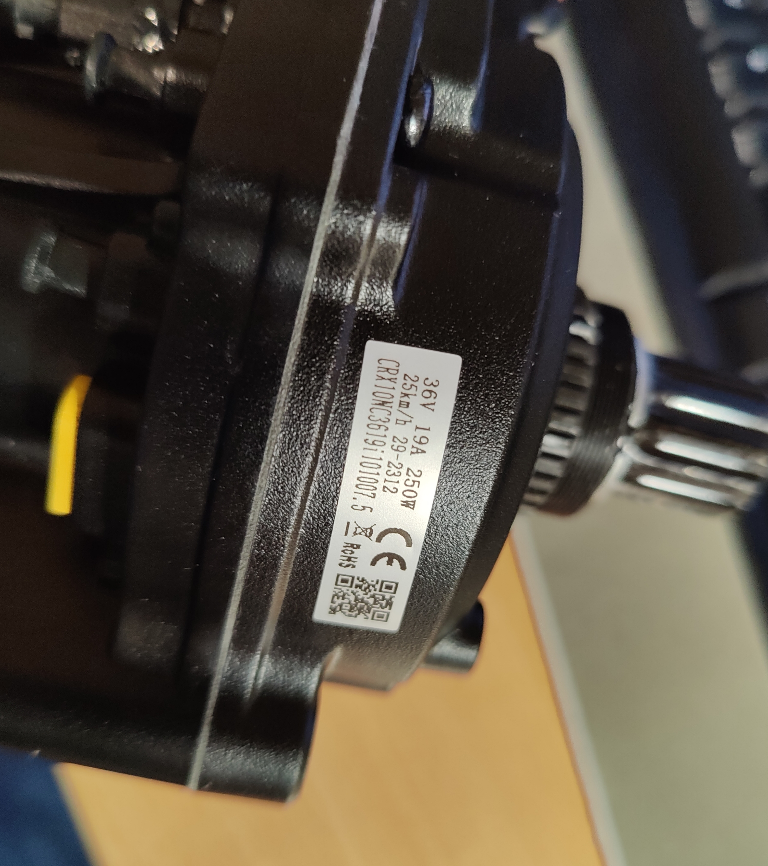

Hi
I change my speed limit 32km/h to 25km/h since 1 month. since this change i have cuttoff. I don't know how is it possible to come back to 32km/h

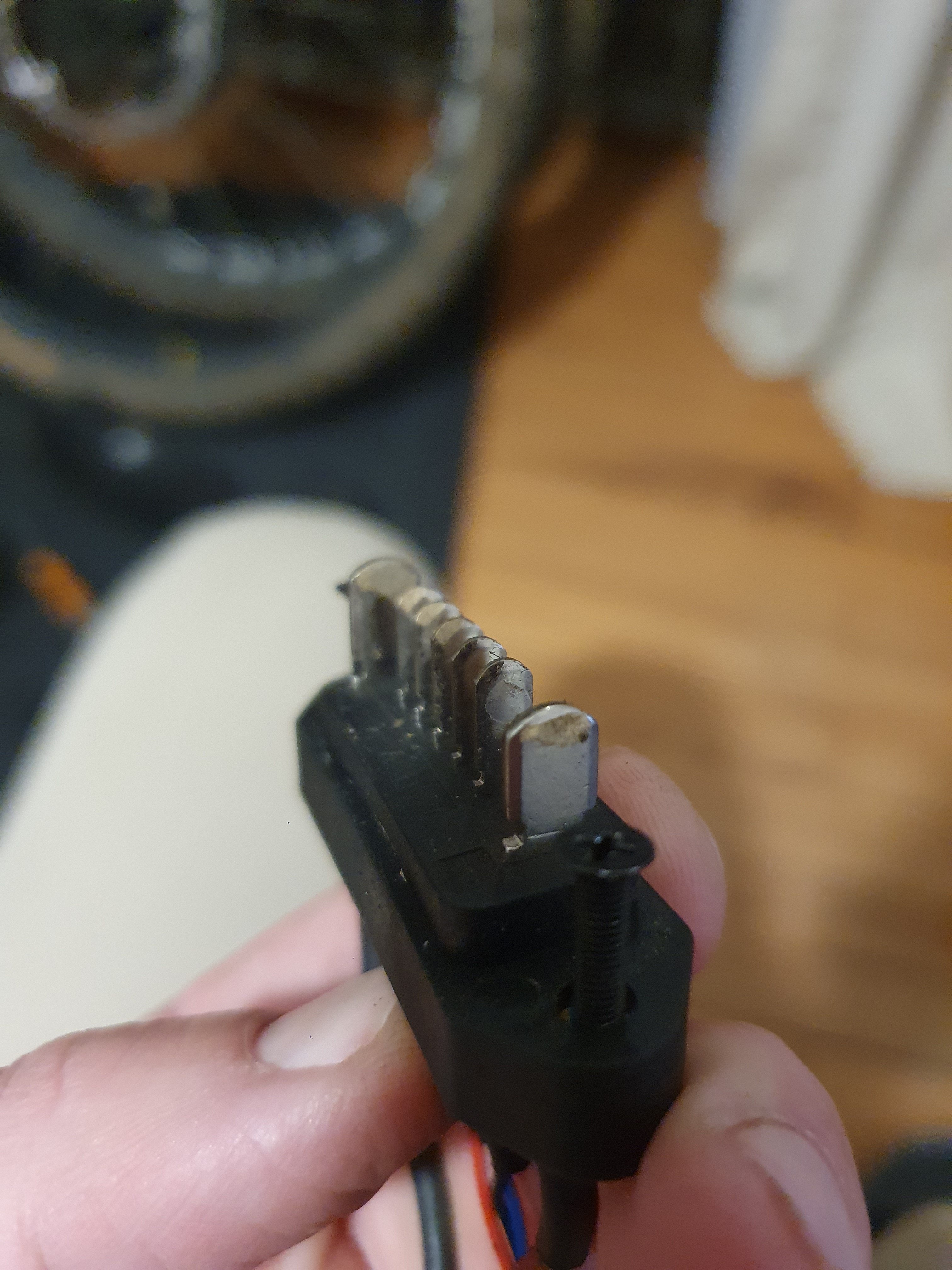

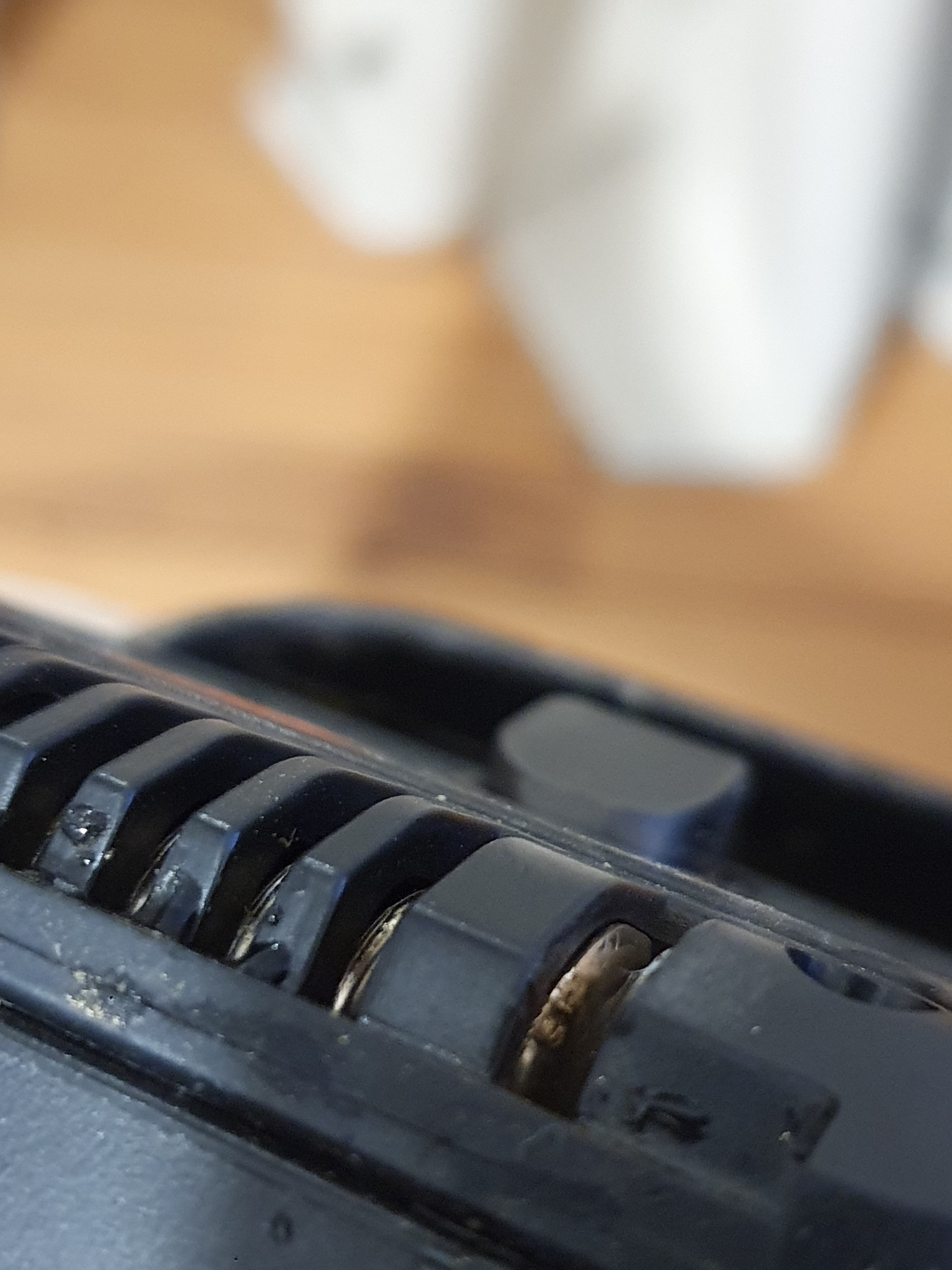

secondly, i remove my system and I see some electrical black area on battery and motor plug. on picture.
do you think this electrical black area could produce the cutoff?
thanks for your help

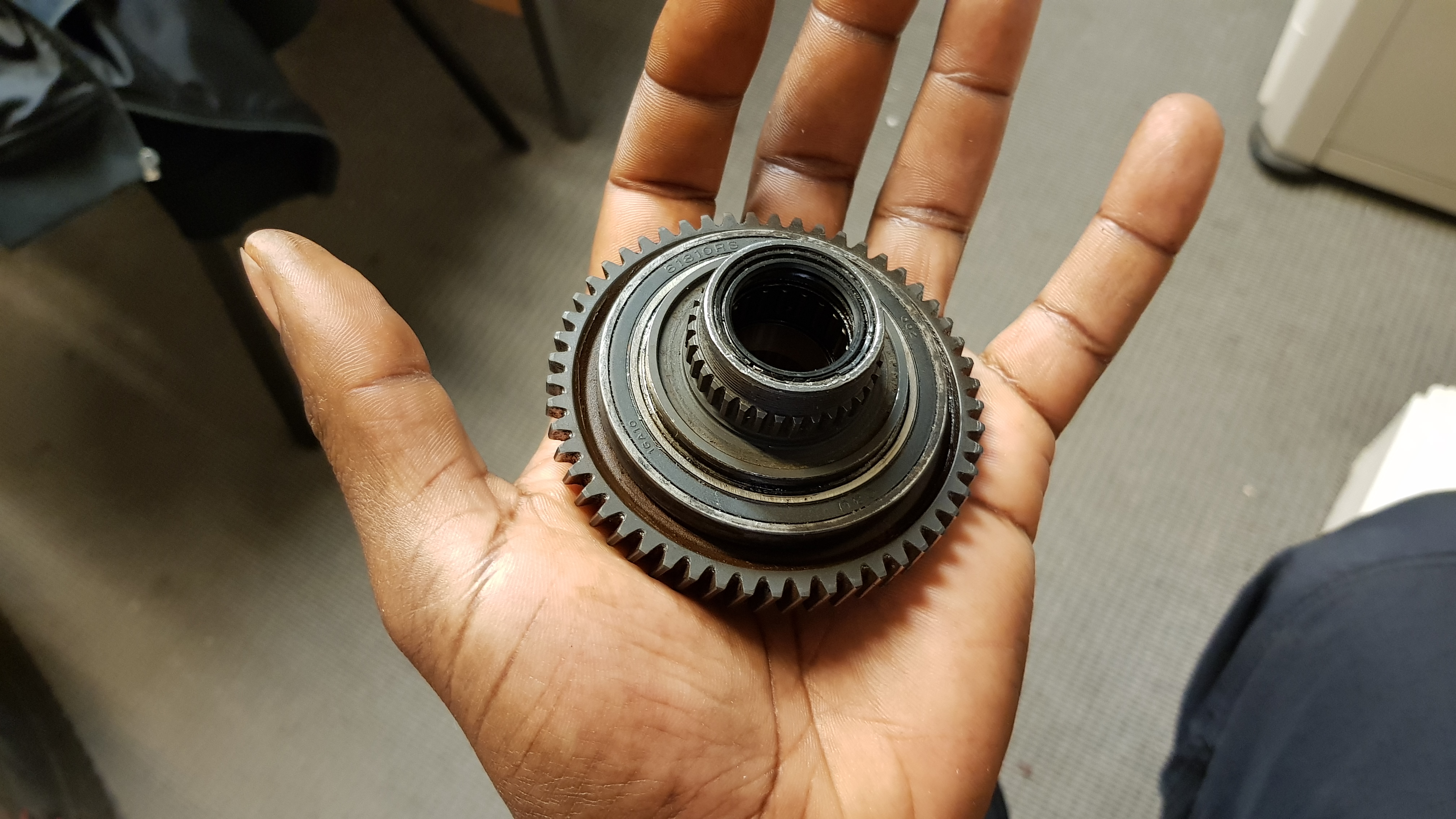

I'm pleased that you have the option to send the M510 motor back to LeaderFox for diagnosis @Acron. Hopefully, they'll simply swap it out for a new one.
Referring to our brief conversation, the seal which sits in between the main reduction gear 'may' have disintegrated which could explain the 1mm play for the crank spindle 👍🏿
