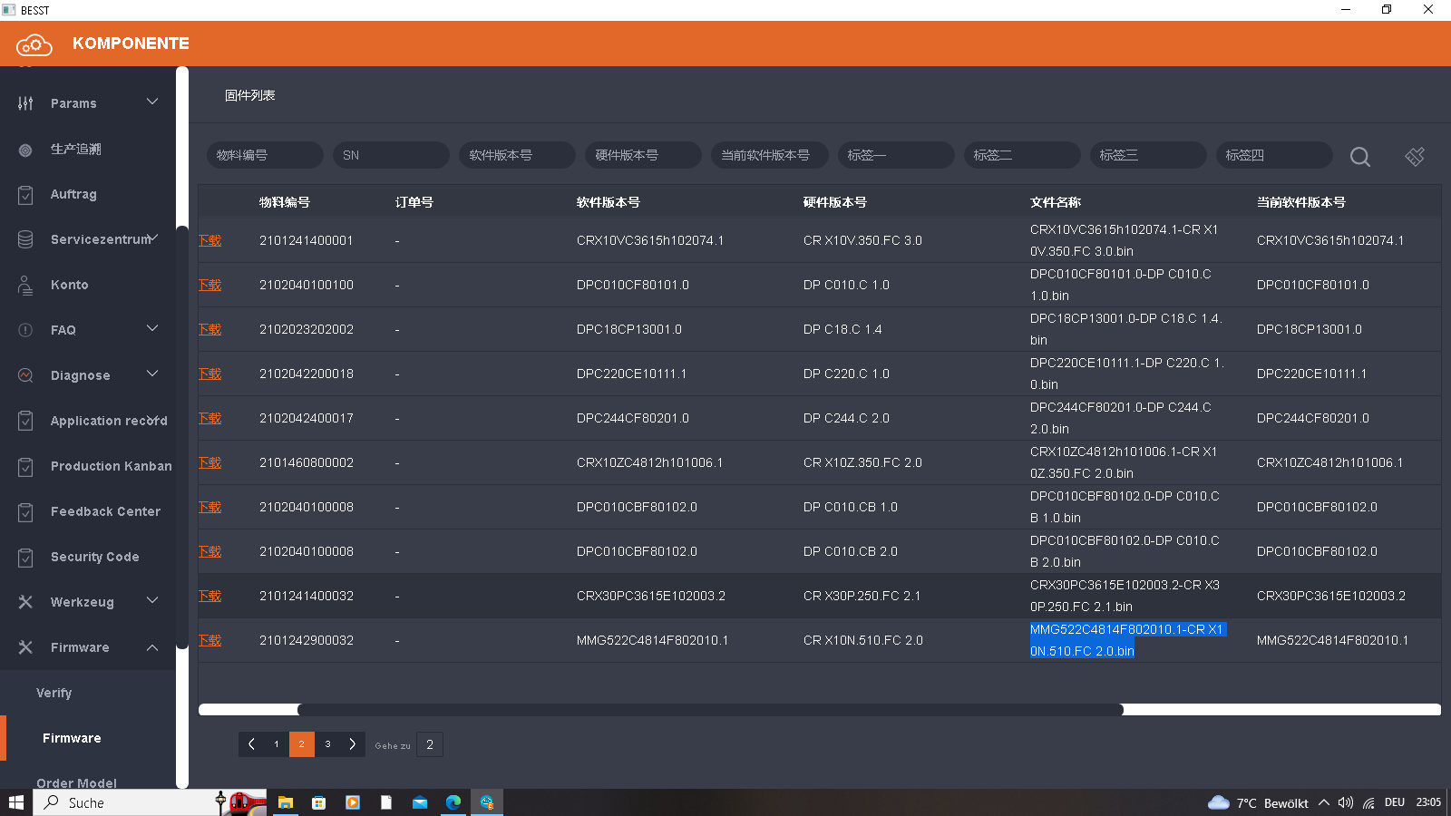

Hello guys.
Experimenting with M510 controller v2.0. And again getting sick of it. ;)
There are some new settings, just BESST Pro is not storing setup (I have only python login script for BESST Pro).
But what is worse it is defaulting into ridiculous power levels - 50% 75% 100% 100% 100%
If somebody has real login credential, can somebody share to try if this is just another bafang bug or if would work with real login?

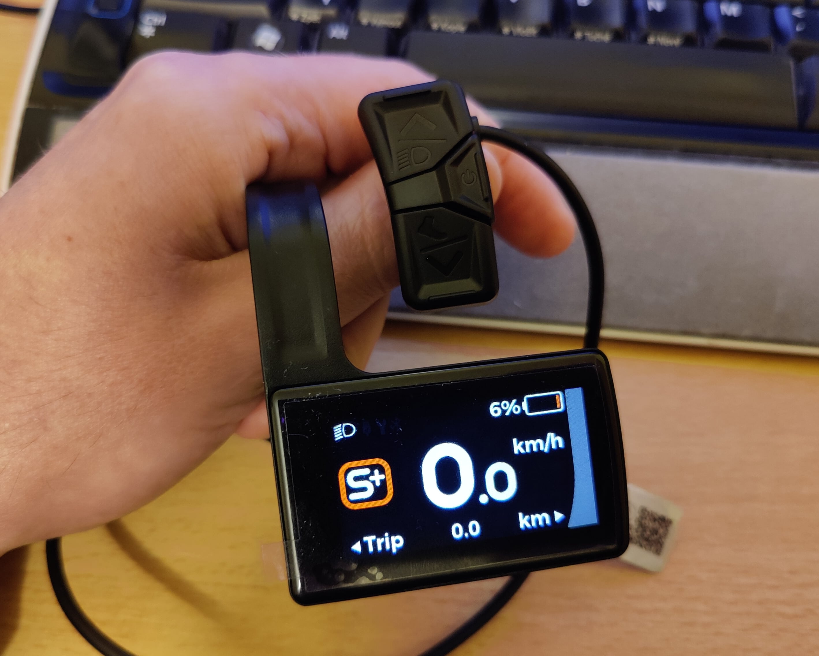

And got also new colour display DPC 245. Looks good, I like new smaller buttons. Just was changed PASS levels 0 1 2 3 4 5 to 0 E T S S+ B (I like more numbers, you can orient faster when u look at display). And looks like PASS level 3 and 9 is gone, new display has only 5 levels.

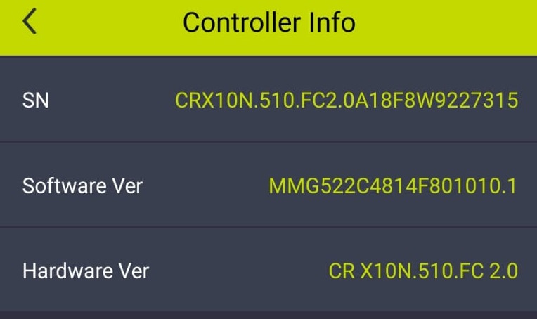

I still have these

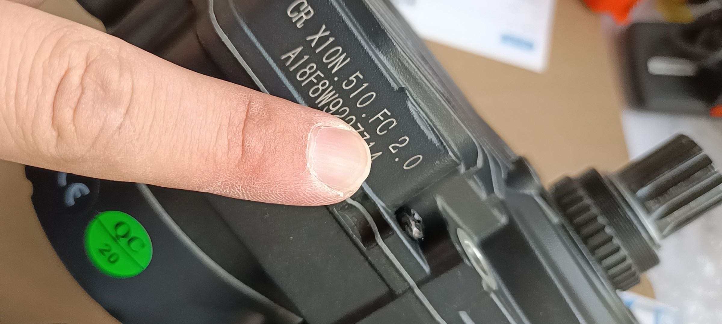

this is software for M510 ? ok i see they are for controller hardware rev 2.0.
It will be beeter to take care before share software, may be it's better to share software who had been "really" upload to avoid confuse and breakdown

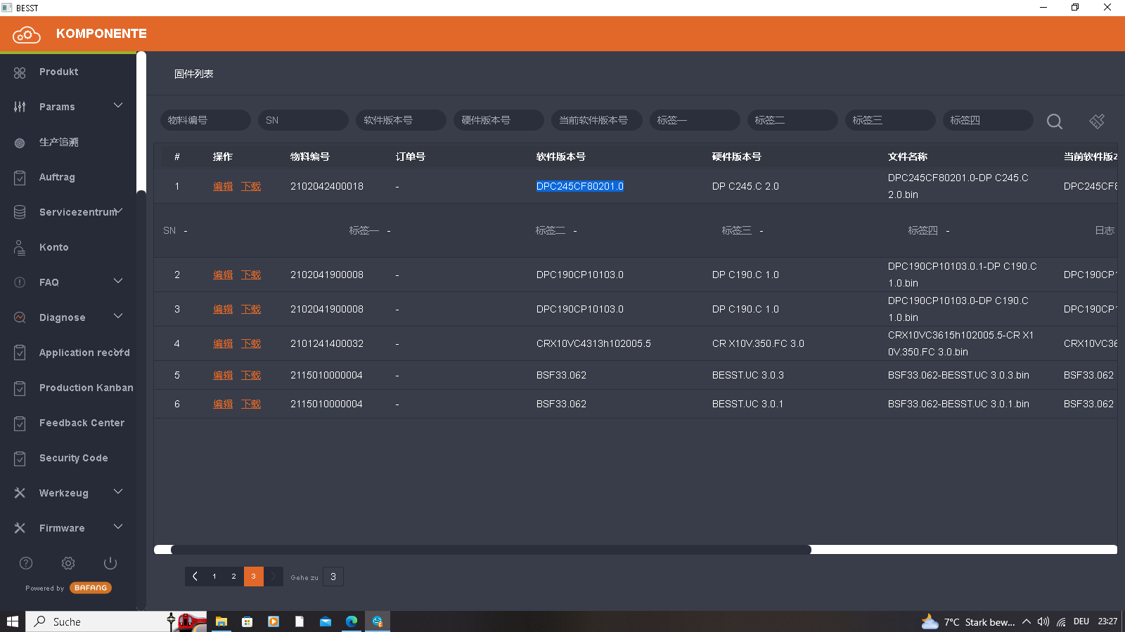

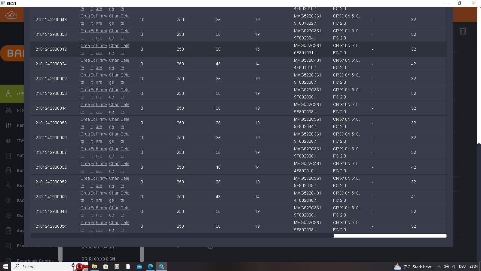

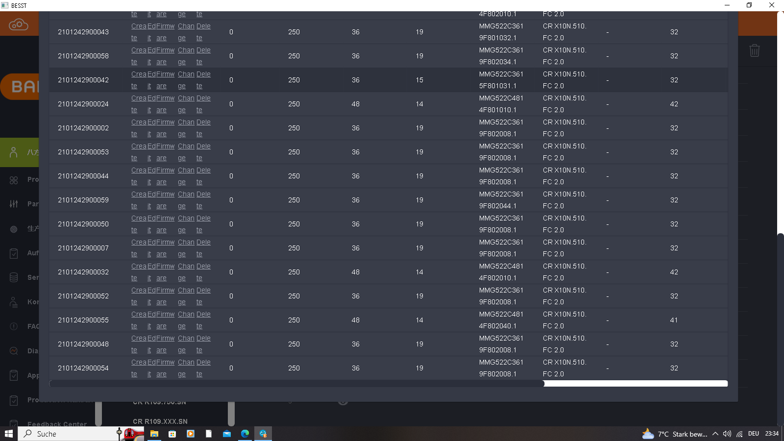

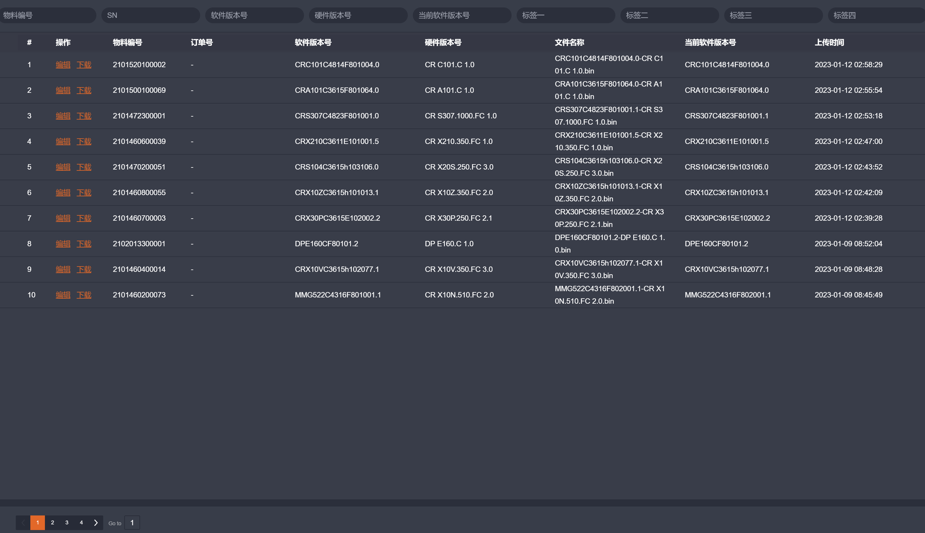

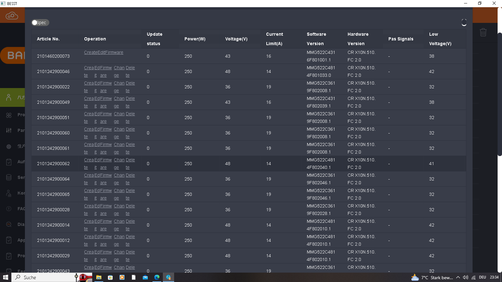

Hi The software is originally downloaded from Bafang if you look at the accompanying photos you can see it. That's why I uploaded the photos so that you can recognize this

@Catweazle OT > How you gent an access here? I have a besst and bafang account but cannot see the firmware tab.

Hi Access is not the same as access, the higher you are classified at Bafang, the more authorizations you have and can work with this program
Could you check the last avaiable firmwares for M500 and M600?
Mate, there are not all the firmwares. There is a menu item, where are some firmwares to motors and display to download.

Hello, I have a new M510 engine, how can I know if it is the F2 version, thanks.
