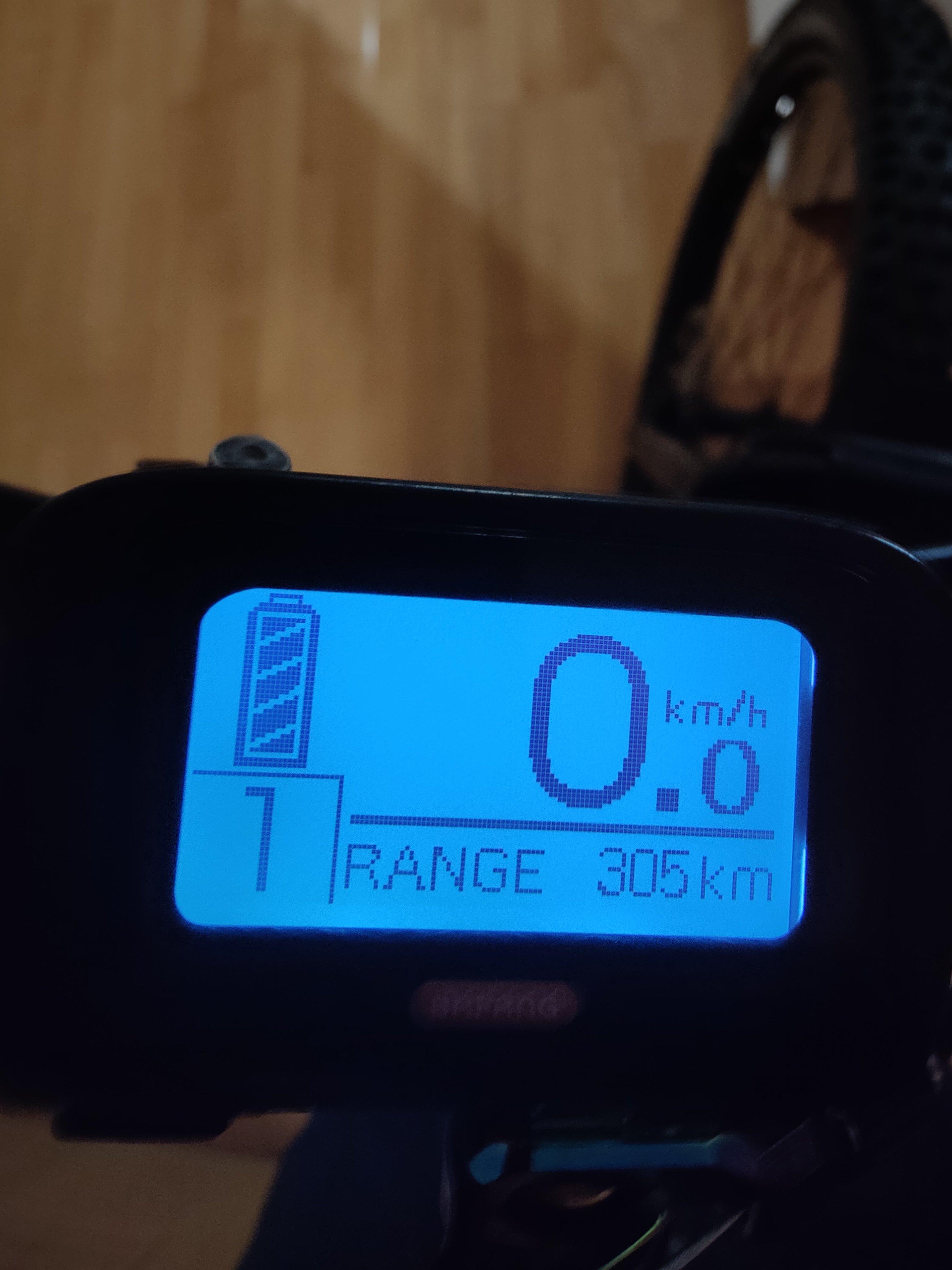

M510 with firmware 8.1 finally works - after a year of start selling of this motor! Can be set max power, also acceleration is working. Now I dont see any difference in startup angle. Heres calculated range with 14% max power on pass 1 (max 120W which is finally reasonable). Anyway it is a bullshit, as I dont know where to set battery capacity. You can see some aditional parameters (including battery capacity) in latest BESST, but can not be changed.
And the default Bafang settings of max power: 50%, 75%, 100%, 100%, 100% - I dont understand what that engineers and testers are doing there.

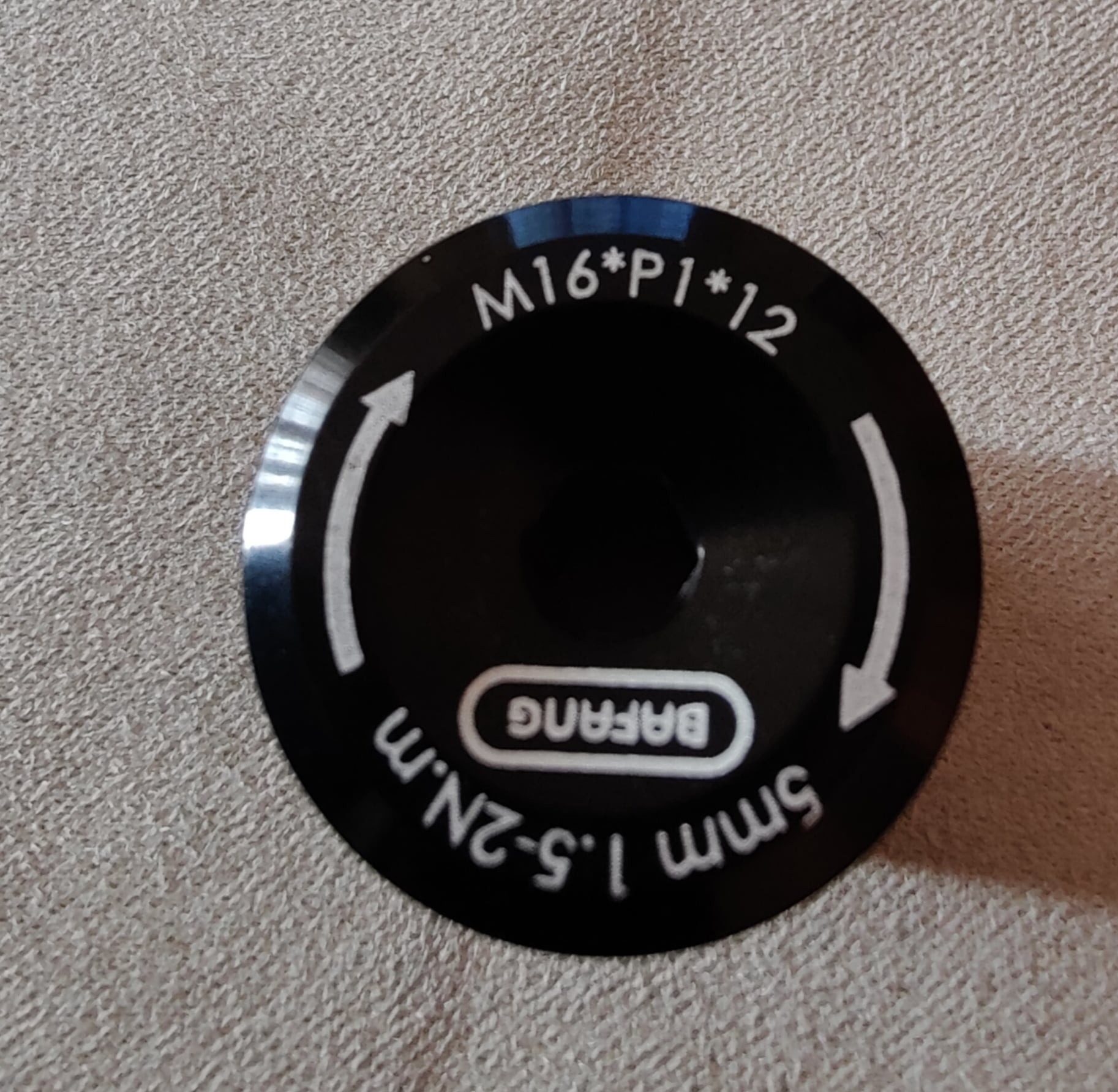

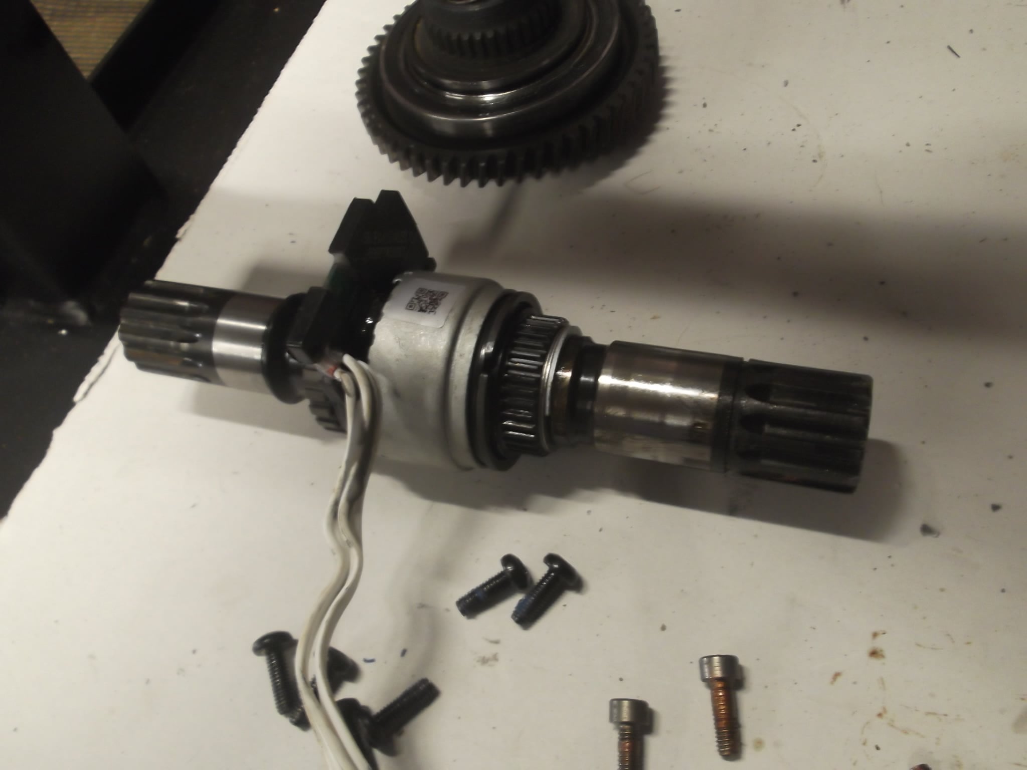

Shaft is different and I also see from your picture locking mechanism is different. Electronics would be the same.

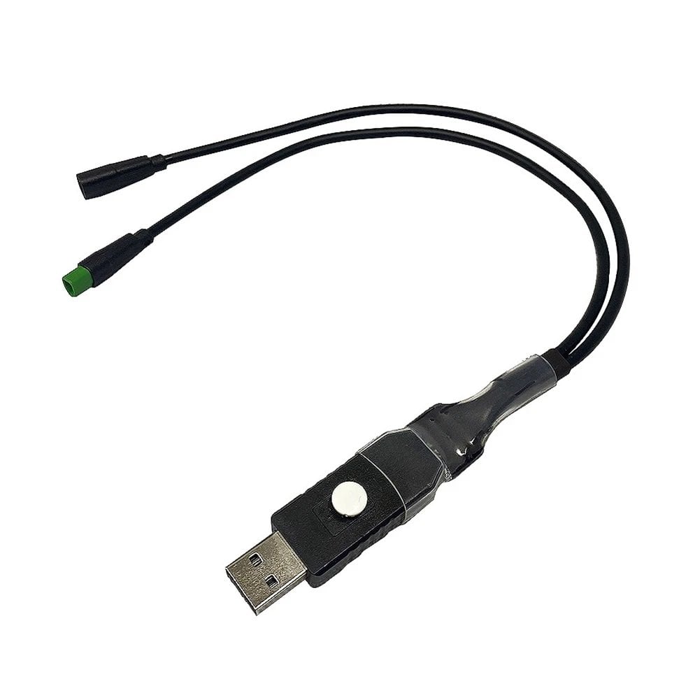

Hi thaeber, i just swapped my M500 for the M510 :)rolleyes:), i was able to derestric using programing cable, like i did on my original M500, just awesome... , cable is cheap and simple to use, i´ve updated speed limit to 60km/h and change now and then between 29er or 27.5 ,,,,,, yes i have 2 back wheels, 29er for XC and 27.5 for the bike park, MX wheel setup is awesome on E10 but not so confortable when riding long hours like 29er.
So big question mark is really about the power delivery when comparing to the older version, How does this firmware performs in relation to ON/OFF situation when the motor engages to the pressure applied to the pedals? M500 feels much better when comparing to the M510, much more subtle and smooth. I have FC 0.1 original firmware on my M510, i was hoping that maybe flashing a newer firmware would solve that, maybe? Did you change the wheel magnet?
Your thoughts and advice have worked great for me in the past, so i would like to hear from you again on that.
Thanks!!
Thanks!!

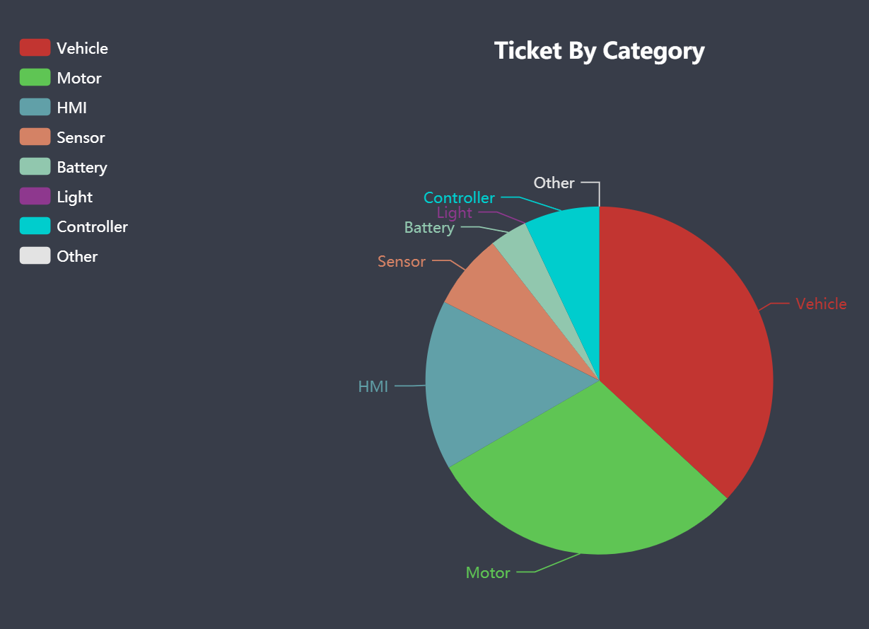

Guys, just installed brand new M510 FC1.0 and staright on first ride power losses, shut downs - error 11 and 30. Getting frustrated from Bafang, it should not be with brand new motor. :( Anybody has similar experience and what have u done?
Look what statistics I found in BESST - 44% fault rate motor, controller or sensor!
