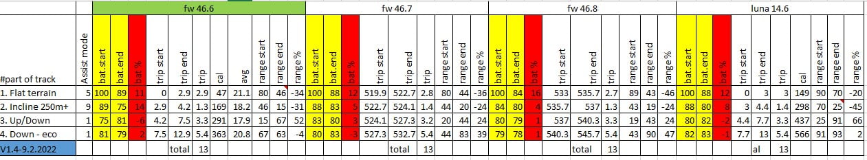

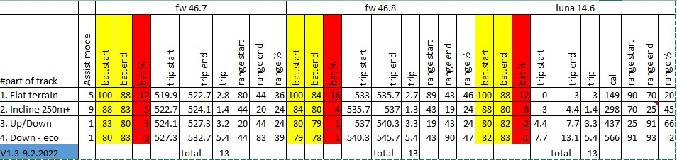

Today I added comparison with Luna 14.6 firmware:
My observations:
- PAS1 is very nice, exactly what I needed. Current is not over 5A, usually I see 3-4A.
- Instant drivetrain stop when you stop pedaling like bafang 46.7. Like it
- Overall, i feel like less powerfull then 46.7 (maybe like 46.6?), mild and not kicky. It will be good to compare with 46.6.
Values/numbers are below. For future tests i must:
- change wheel size to match 1:1
- track range only on PAS1, or PAS0, as every fw is calculating range differently (and differently on each PAS level).

mgx
Feb 18, 2021
110
112
Slovakia
Here is my comparison with 46.6 fw (Mainly against Luna 14.6)
= more agressive ramp up/down , but not as violent as on 46.7
= stop after propelling in 1-2 seconds, which is OK. Depend on PAS level used.
= going uphill is more fun then Luna fw, but calories burned (at least value from computer) is less on Bafang fw.
I added calories burned and avg speed value, to compare for future tests as well.
Only downside i found on 46.6 fw is range calculation, which is varying a lot. looks like strongly depend on battery V/temperature and is not relevant. Recovery rate is much more then other fw. (luna, bafang 46.7+)
Luna fw looks like very eco oriented, good for people who want:
- use own "manpower" for propelling as high as possible
- for distance gaining
- for difficult terrain, where adhesion is more important than just pure power
myself i prefer 46.6 more to fit my style.
I will recompare with longer circuit to zero battery, but this need higher parts out of snow, so i must wait a bit.
