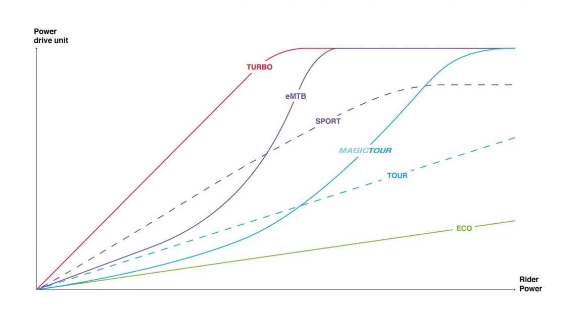

Can we also somehow configure the power applied for each level of assistance ? I really need to reduce the assistance on that level 1, it is much too powerful
