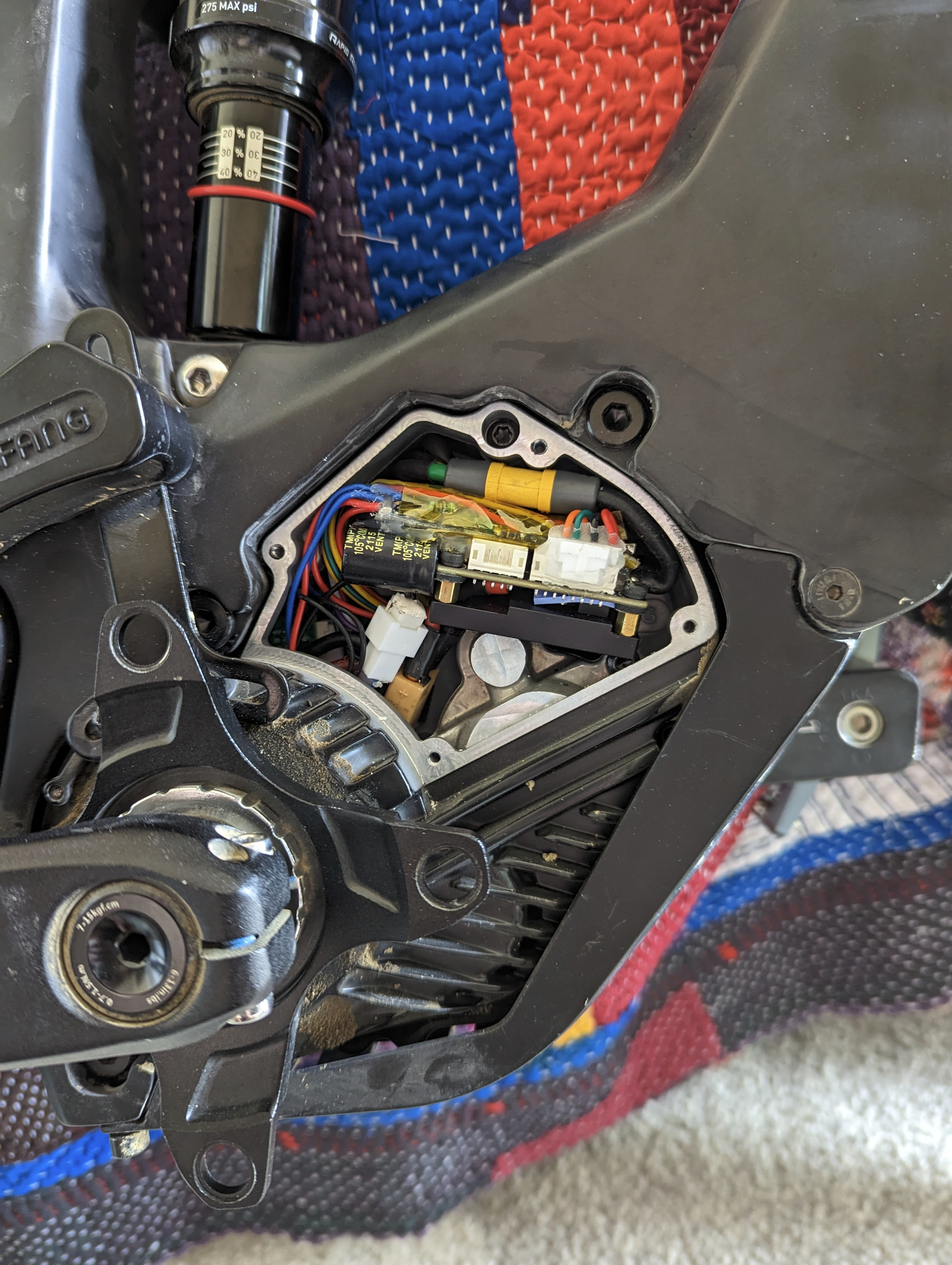

Hi guys, I have a problem with my Bafang M500. It turned off during mountain riding and I can't turn it on. I was thinking It's to hot, and after few minutest it will works again, but already not. I've checked battery, and main power supply to controller (yellow plug). It's ok. ~40V, full 36V battery. I also checked all connection and replace wire between motor and display (I had spare one). How can I check controller (maybe some fuses on it?) Could you help?

Hello.
Seems like controller is gone. Have you tried to swapp display and buttons? Most probably wont help though.
If you skilled, I can tell you which pin short to ground to check if controller starting (if you dont have spare display).

Could you tell which pins? I don't have spare display. This is CAN version. Do I need Besst Tool when replace controller? I also do this test and after push the power button, voltage droped to ~2-3V so it seems, fuse in controller should be ok?

Mate, you doing wrong conclusions, because you dont know how the power up works. Why u so surprised it is discharging capacitors, when u press power button? Press also minus and plus, one of it will be discharging also. There is resistor on buttons which is grounding battery.
Why u wont put down controller and inspect first pcb? Its 1 minute. That part with finns, no need to open whole motor. You look skilled. I would say you would find something blown or greenish rust on battery voltage paths.
PM me.
And yes, you would need Besst as you would need run calibration after controller replacement.

So, inspect PCB It was one of the first thing what I have done. And on the first look it seems to be good (pic below, reverse side looks simillar). I can't find any issue. But I'm also not as far in electronic to know what to measure in first step. I found this youtube totrurial and also try it. In this toturial was suggestion if voltage will not drop - fuse is broken. Also checked buttons on remote controler and it's working fine.

There is LED on pcb, if I remember right is light on when u press power and blinking when it boot. Try. If no blinking microcontroller is not booting.
Show me pls. the fuse, which one it is. Did u mesure it as u stating in video?
