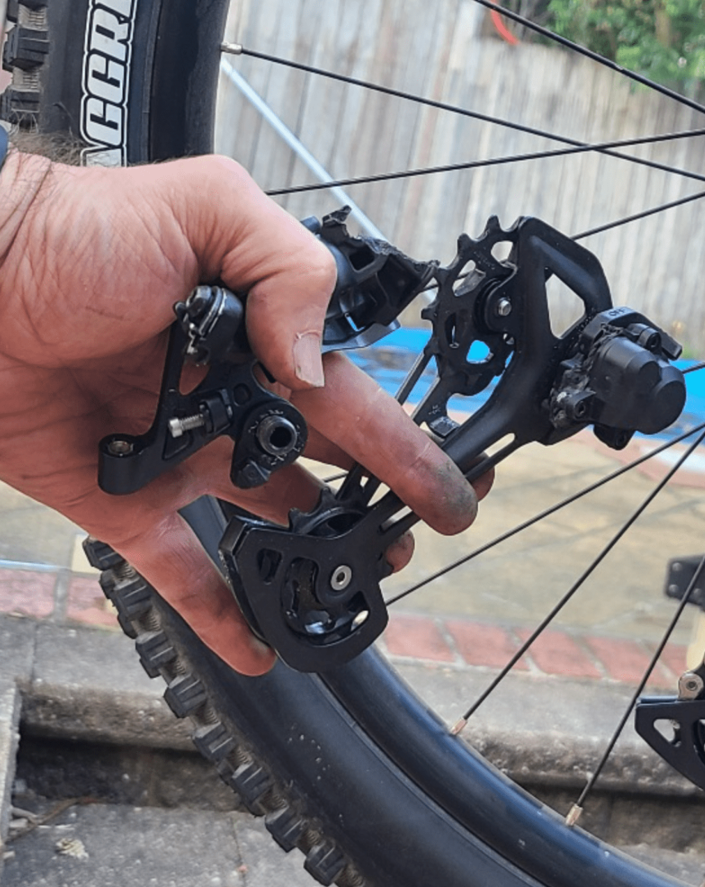

Well after 200km and one stupidly tiny crash I can confirm - DO NOT fall on your right side or be ready to spend hard cash :LOL:
I literally slid on sand in the berm, bike washed out, doing maybe 20km/h at most and softly "landed" on the right side.
Really nothing too bad, almost felt like laying a bike when you stop.
Hanger is fine, straighten the cage just a tiny bit and yet there is something wrong with the gear changes on the 1st and 12th gears, so it seems I'll need whole new XT Di2 derailleur....

I snapped my mechanical SLX derailleur about 3 months before buying the XT Di2 one. It happens.
Oh yeah, of course!
I was just surprised that such "tiny" hiccup most likely ended this product.
But yeah, it is part of the joy of smashing hills on MTB ;)

Here's the pic

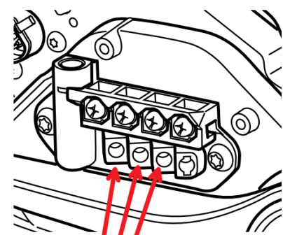

Does the SD300 just plug straight into the free ports on the EP801? I’m assuming this then powers the mech too, all the diagrams i find show additional seperate batteries which is somewhat confusing….

I believe the separate batteries are for non-e-bikes.
There are three identical ports on the motor (and a fourth that is close in appearance). Mech cable goes in one of the free ones. Another goes up the down tube to (in my case) the sc-en600 display, which has three ports, one to motor and one each to the left (sw -en600L) and right (SW-M8150) switches.
I bought a 300mm cable for the mech-motor connection, but for my Urrun it seemed a touch too short. It probably would have worked, but I happened to have an extra, short cable and a coupler and so added that on the motor end of the connection, which gave it a little slack and made it easier to ties the cables together.
Yes. Plug the derailleur into one of the 3 SD300 ports. Just don't plug it into the speed sensor port. It's clearly marked with a notch.
The derailleur is powered by the main 36V battery from the SD300 port. No need for an extra battery like the SRAM AXS system.

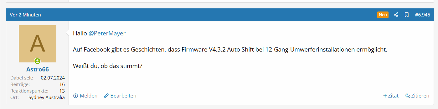

In a post on Facebook a guy claims that he has working Autoshift with 12 Speed and 85 Mm with Firmware 4.3.2
Any more knowledge here on that?
I'll ask Peter from EMax. His software allows you to configure Di2 installations, and is very familiar with Shimano EP801 firmware.
Hopefully he'll answer.
Edit : Ok done. Sorry it's in German. We'll see if he replies.

He's replied. There is no 4.3.2 Firmware. Only 4.3.0.
So it's pure fiction, as the current 12 speed chain couldn't possibly support repeated full load shifting. It's just too thin to fit the 12 speed cassette.
