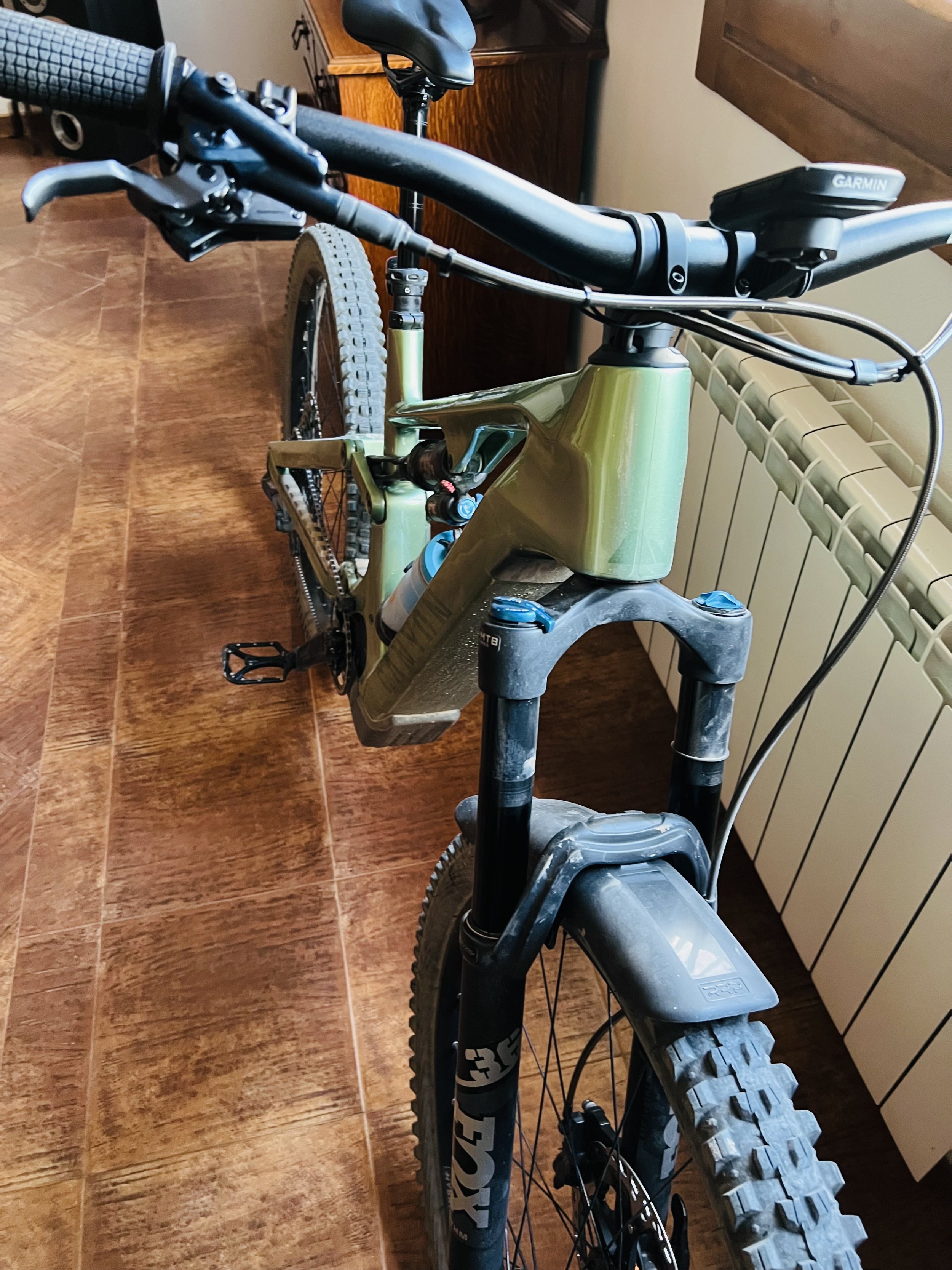

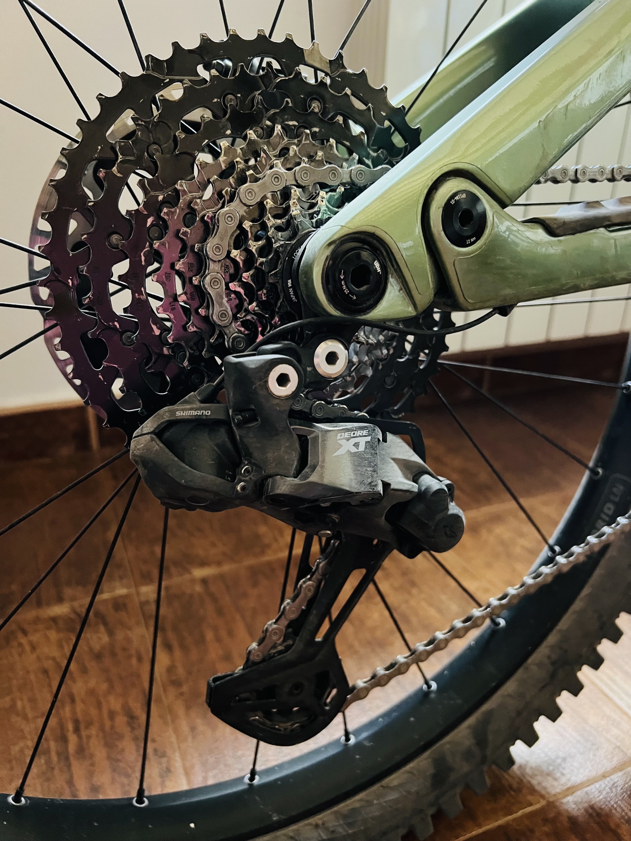

I have the system on my 2023 Canyon Spectral:On. It took a little time to source all the parts and I had a local Shimano specialist set it up. Think it was the first one for Shimano Spain. Have done around 900km so far with zero problems. I leave the bike in auto mostly. Going to the trails (on the road) i sometimes I shift manually whilst in auto mode as the cadence shift point is set at 72rpm and it looks a little weird peddling that fast in a sleepy Spanish Pueblo. It takes a little getting used to but works as it should when left to its own devices. It was the video above that made me decide to buy. The Freeshift is superb, I have it set to gear four as the default start point. I also have the Absolute Black steel chainring with alloy spider to compliment the system.
Some gear changes are totally silent, some you can hear but no crunching of gears when you suddenly come to a steep uphill section. When coasting downhill you can detect the Freeshift doing its job, but it´s very rocky where I live and you normally can´t hear it. I like it, it´s showing zero wear so far. Time will tell as they say. Shout if you want photos.

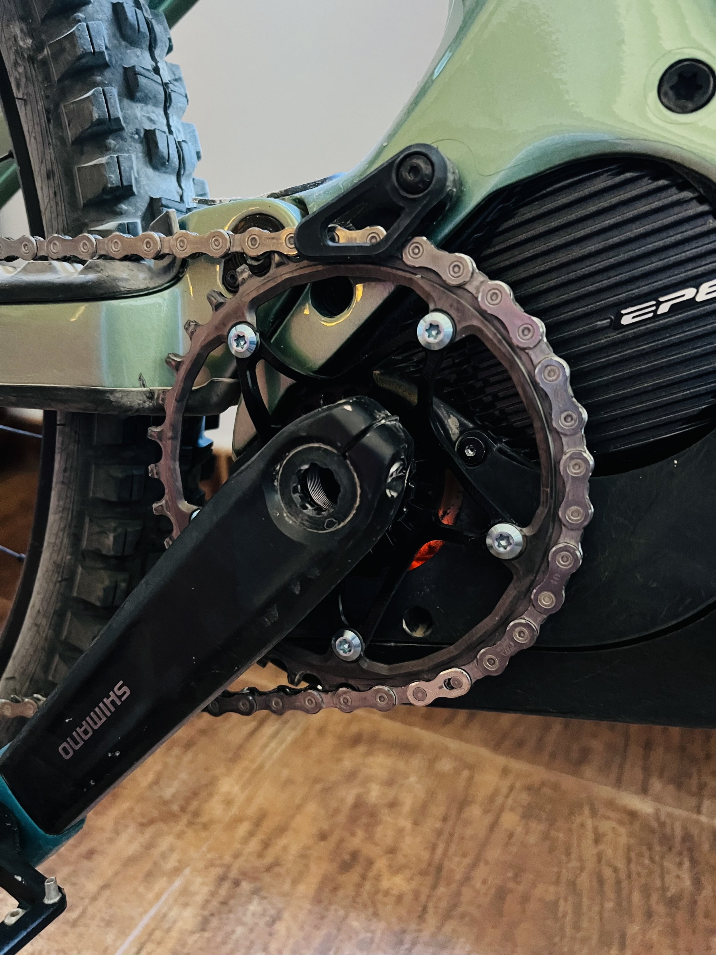

I have some Pinnd cranks on the way if they ever get customs clearance 🙄

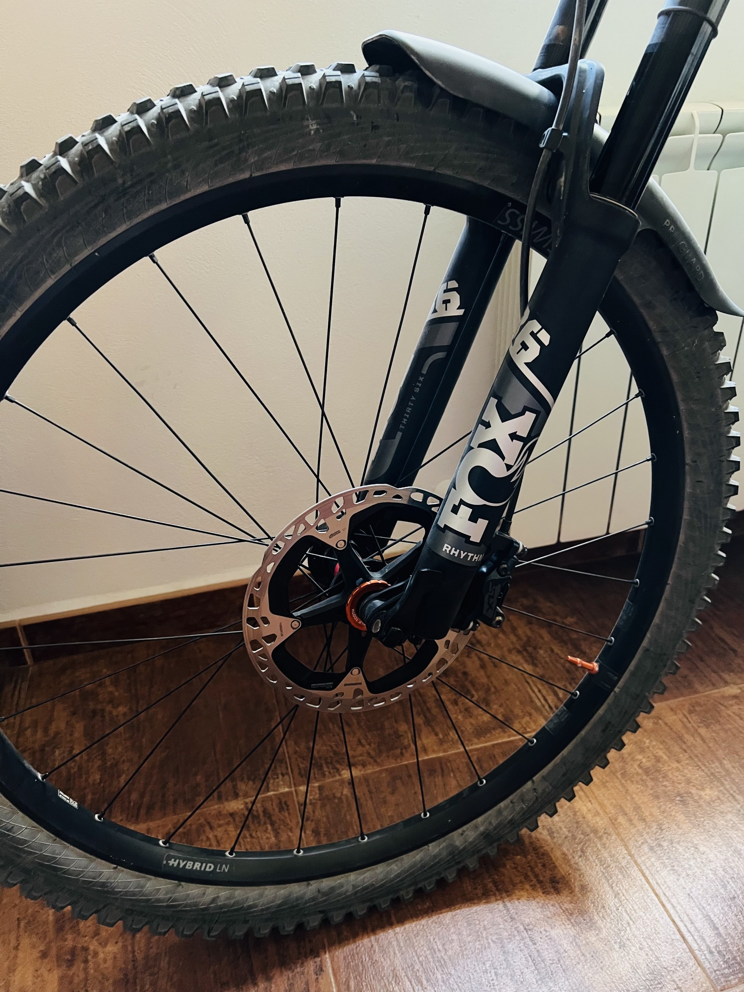

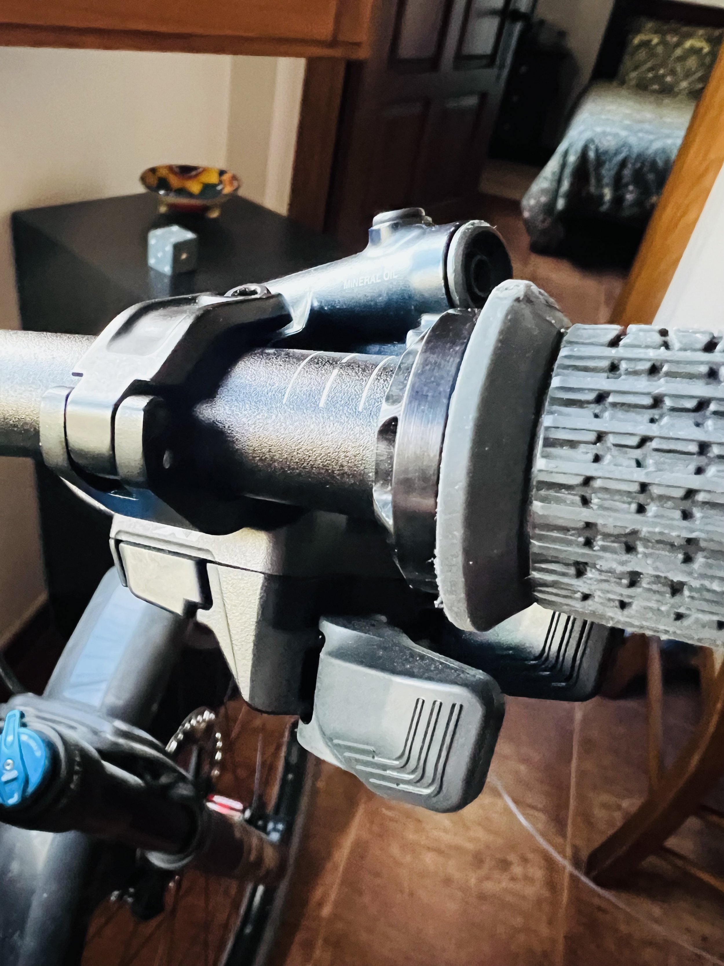

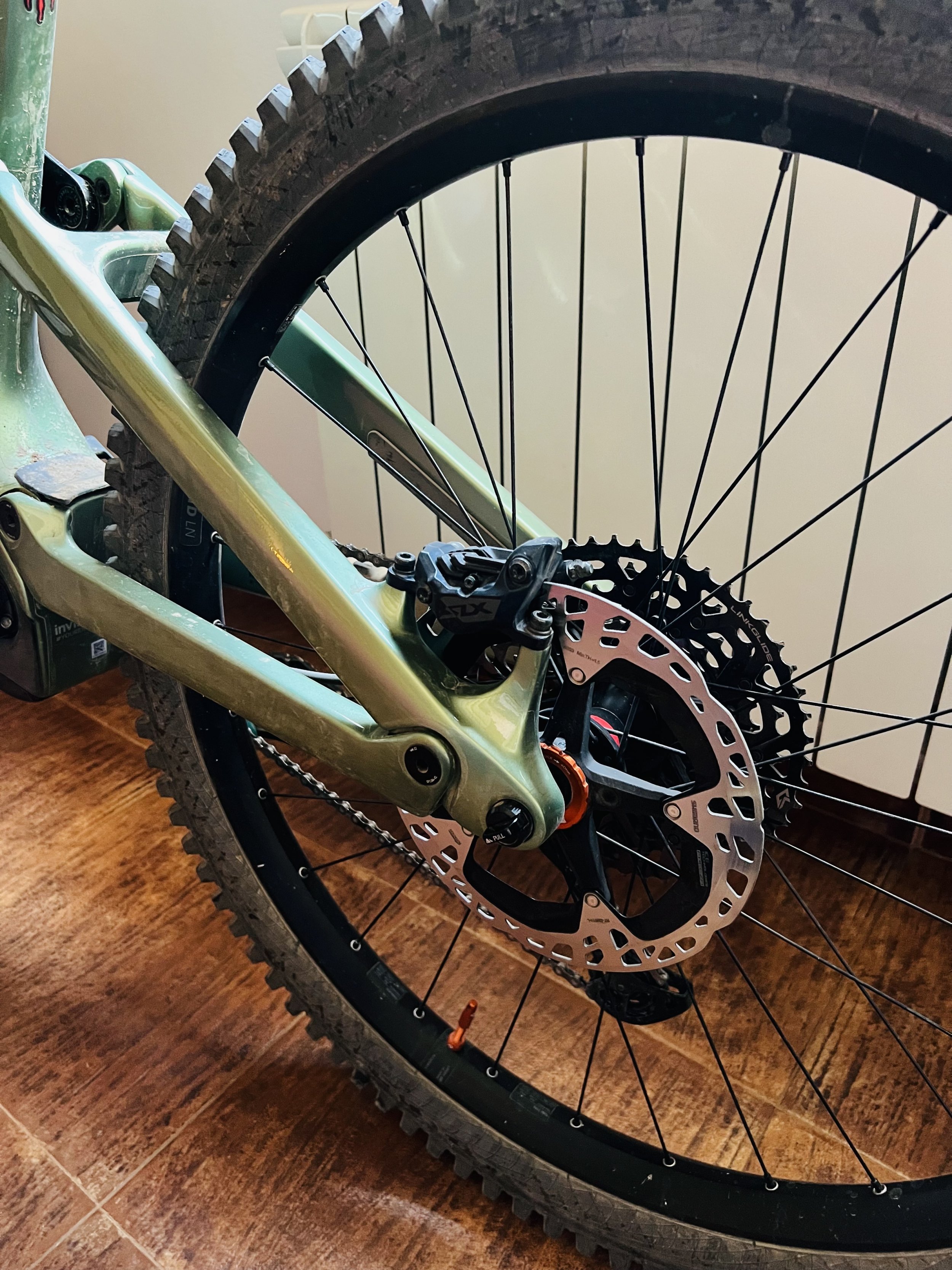

IMG_1806.jpeg IMG_1805.jpeg IMG_1807.jpeg IMG_1808.jpeg IMG_1809.jpeg IMG_1810.jpeg

Looks like you bought the CF8 and added the parts and got it set up? This model of Spectral seems to come set up with XT Di2.
Do I detect a note of disappointment in your post that its not freeing you off like said in the EMBN video, rather you have to ride to the settings, or is it that you need to get the settings right for each rider and for each ride trail?

The Cfr is 12 speed so no autoshift i´m afraid. Just freeshift. Not disappointed at all, what I wanted was not available to buy so I built what I wanted. It will continue to evolve with components that i like
