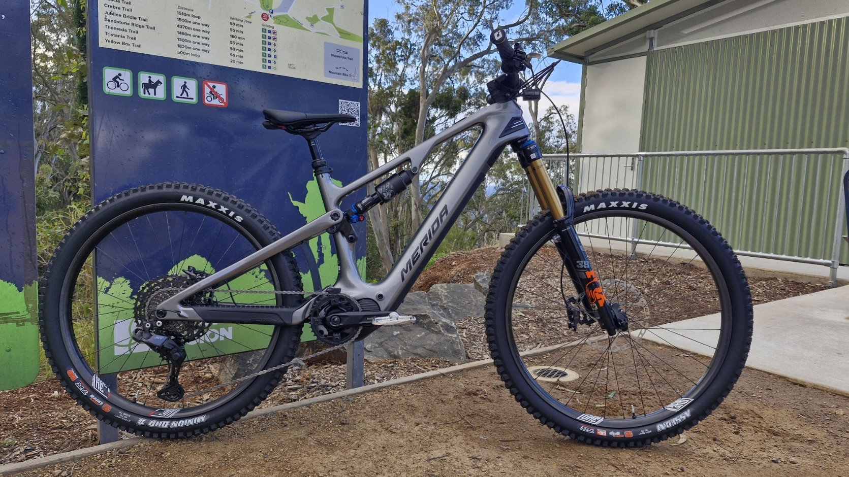

Ok so bike is here; I have a few things to do though, change forks, cranks and front wheel (store did the other bits) but it's currently 8pm and flippin freezing out in the shed, so I'll brave it but I won't have anything to mention with respect to Auto and Freeshift till tomorrow most likely as I wont really get to ride till then

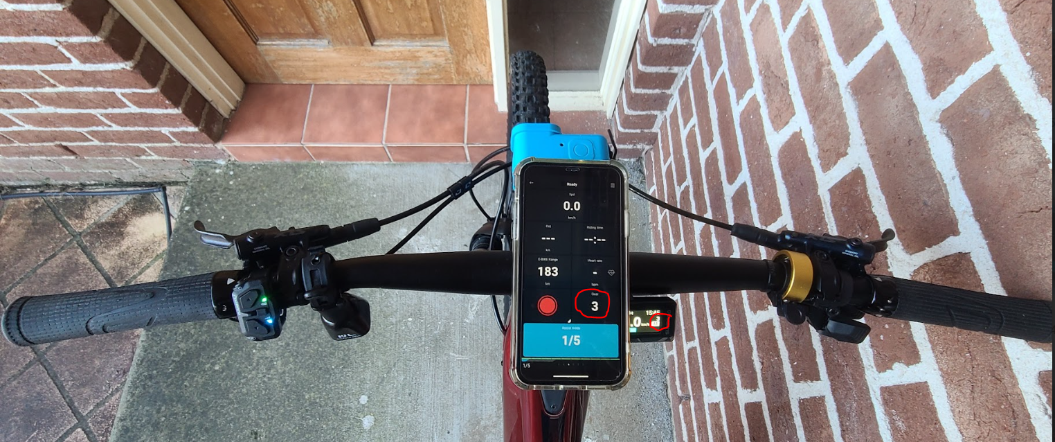

I use the E-Tube ride App and have the Gear I'm in, displayed in big letter, on my quad locked phone. <Old eyes 😉 >I find when I'm coasting downhill on a technical trail, and come to an uphill climb, I can forget what gear I was in, when I started the downhill.
So I quickly glance down, see the gear. Then press the downshift the exact amount of presses, to get me to the exact gear I believe I need for the uphill line I'm going to take. I find this shortens the time I'm focused on my gear change, as I just press the button the number of times I need, and just know the bike is going to be in the right gear.
I'm sure multishift could work for some. But I just find multi-press works better for me.
Here you can see how big the Gear Number is in the Etube ride App, compared with on the Shimano Display.

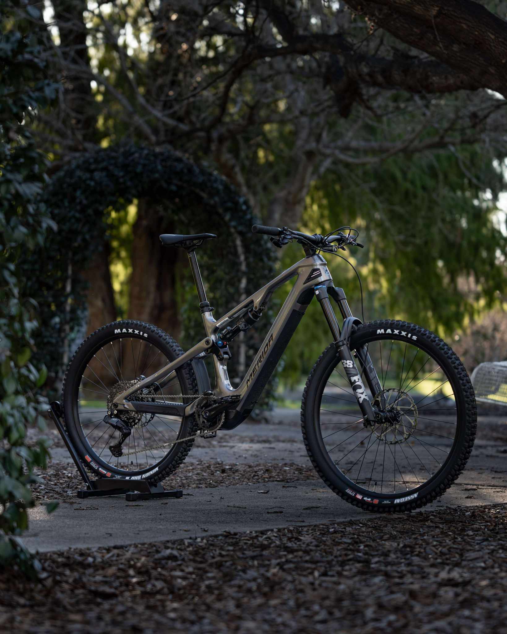

Well, it's home now. Got a few of the upgrades from my previous bike on also.
Being that it decided to rain the second after I took this pic and I didnt get to really ride the trail, I had a very quick lap at the skills park and when I got home up and down the street.
Tried Manual with Freeshift
Full Auto Shift
Auto with shifting enabled only when not pedalling.
General shifting; It's definitely not as fast as smashing through a 12spd Hyperglide with rapidshift shifter (honestly it's not that far off it though), but it is certainly significantly smoother. Even shifting under load I thought would be horrible but its not, it's actually very smooth. I didnt set it up either and looking at the settings there's been no microadjustments made so I should probably toy with it just to see. I did play with the settings just to see where and what everything does and it's actually quite intuitive; not as straight forward as T-Type from SRAM but gives a better idea of what is going on.
Manual with Freeshift - it's basically just like a regular shifter, except so long as the bike is rolling you can change gears without pedalling. Honestly this mode alone with worth the Di2 imo. Easy, no fuss. Coasting to a stop, just dump all the gears as you pull up. Going down hill and want to stay pedal level, shift up through all the gears so you can get straight back onto the power. I've only been playing around with the system for maybe a half hour and I'm not sure I would want to ride without it. It's just super conventient.
Auto (shifting only when not pedalling). Basically the same as Manual but relying on the set you choose. I like it in that you don't really need to think too much about whats happening and it just does it's thing in the background. From the limited time I used it; you probably need to really tune this (and full Auto in) before you get the most from these Auto modes. I believe I have it setup to more aggressively chase cadence with gear changes but it still felt like it wanted to hold gears more than if I had been in control in manual. Maybe I haven't workout out the settings entirely correctly for me, or maybe Shimano need to create a mode with tighter tolerances on cadence variation before it's entirely set and forget. Being able to anticipate definitely means Manual is still the best method but this mode I feel like will be a lot more handy when focus is more on riding down a trail and concentrating to let the bike take over while your focus is elsewhere.
Full Auto is the blacksheep I feel. It was good up and down the road and it did exactly as I expected. It had a tendency to want to gear hunt a bit and didnt really keep in the pedal zone I would prefer as I went from sometimes feeling like I was pedalling to hard and wanted another gear down or not pedalling hard enough and I wanted another gear or two up. I think for mild trails or generally just cruising along lower gradients or fireroads this would be useful.
All of that come swith the caveat that I didn't get to use any real proper Blue / Black trails and I can probably play with the settings some more. In general though, I reckon I will spend 95% of my rides in Auto with shifting only when not pedalling as it combines the best of Manual with the bonus of keeping an eye on the cadence range for you when you are too busy otherwise, while I might spend 5% jsut on fireroads or mellow climbs.

I installed Autoshift on my YT Decoy Core 5 2024. So far, I am tuning it to get better shifting, but it works fairly well as of now.
A quick rundown of the process of upgrading to Autoshift: I had to change Freehub from micro spline to HG, which I did not like. I changed the cassette, derailleur, and chain to the Linkglide versions. The rest of the components were already Autoshift/Linkglide compatible (12-speed Hyperglide+ XT di2 came with the bike, which is an awesome drive train, btw). At last, I had to update the software to enable Autoshift.
Let me know if you have any questions.
