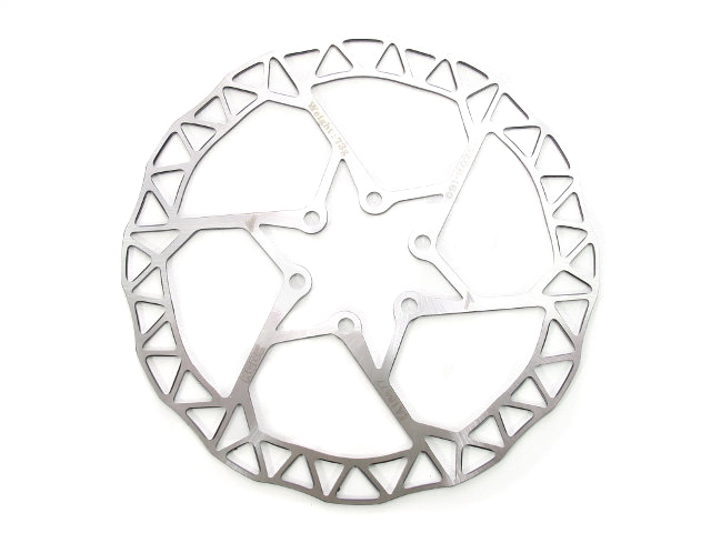

Hi,
I bought the Amflow PL Carbon "standard" model a week ago and my goal was to reduce weight (weight of the bike, reducing my weight is another story ...).
Starting weight last week was 21456g (frame size L , with plastic pedals, ready to ride).
And today: 18460g (ready to ride)
Parts changed:
- light wheels from "Neelz Wheels" (German Shop) with Duke carbon rims and NOX hubs, Wolfpack Speed tires with Schwalbe xtralight tubes, XTR cassette: minus 2000g
- Exustar E-PM215 pedals: plus 17g
- KCNC Razor 203mm disks: minus 163g
- Procraft PRC SP2 UD Carbon seat post: minus 549g
- Selle Carbonio seat: minus 139g
- Cannondale Hologram SAVE bar: minus 175g
- SRAM AXS pod controller: minus 129g
- SRAM X01 Eagle AXS derailleur with power cord: plus 89g
- Shimano XTR disk brakes: weight loss not known, haven't weight the brakes
Weight today: 18460g (ready to ride, including bell and an air tag)
Time to ride ;)
I know, that several parts are not for "heavy duty" bike rides, but that's not the intended use for the bike.
My goal was to reduce the Amflow below the Pro model - goal reached ;)
Greetings from Germany
Peter

You ditched the dropper post?
this is all there is to know on how serious his riding is and that he only decided that weight is his main deciding factor in choosing his parts.
i mean, just look at these "brake" discs:
this bike will never see more than a s1 trail
