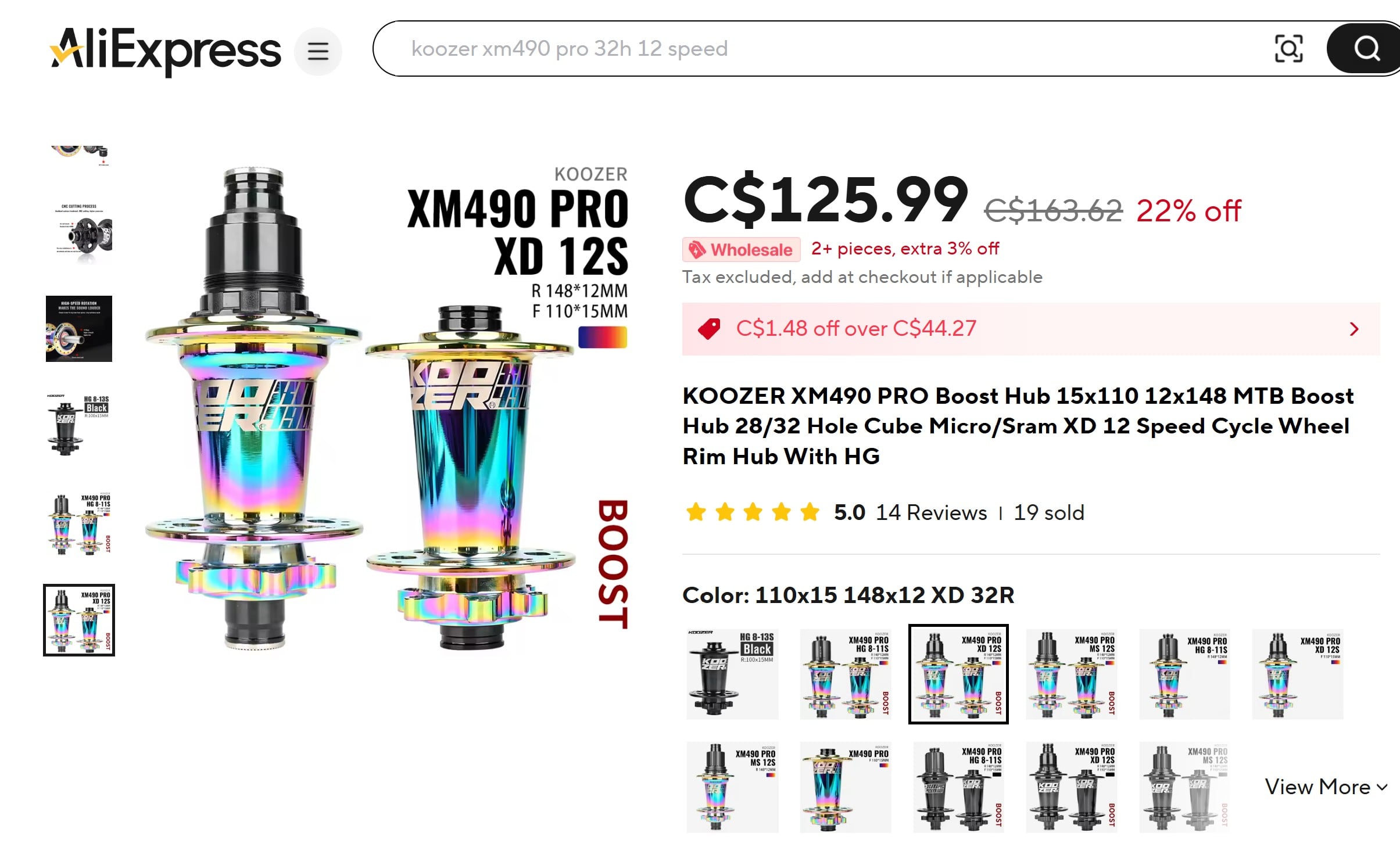

Congratulations on your new title, and as a fellow poser, I couldn't agree more with your build! I am wondering about your choice of rear hub. I know that its gold(ish) but do you think its going to be durable enough for an AMFLOW motor on an emtb?

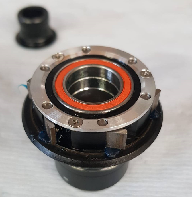

I've used Koozer hubs before in Black, after reading some positive reviews about 10 years ago. They are or were out of Taiwan I believe. I have never had an issue with them. They have 4 sealed bearings. 2 on the axle, and 2 in the freehub. They now are a 6 pawl 72 POE freehub rather than ratchet. They were originally 3 pawl. I'm not a fan of the ratchet. I find the sound is not consistent through the 360 degrees of rotation. And have had comments of, "Is something wrong with your wheel?"
I do add an extra light silicone grease to the pawls, which makes them much quieter. It must be a light grease or it can cause engagement issues. I am extremely strict with my maintenance.
The only criticism I've seen is that the machining on the pawl contact gear, is not as smooth. But it doesn't seem to impact operation or longevity. After running them for a while, the pawls bed in and make more points of contact. I will be inspecting the pawl engagement points after using it on the Amflow. I do see this as the only possible point of failure.
The best thing about them, is they are cost effective enough, that I keep a spare rear hub, that I can steal parts from if needed. I have never changed bearings. Just the freehub, or the whole hub, as I'm pretty proficient at lacing up my own wheels. They also disassemble and assemble really easily. So checking them is not a faff, so you do it more often.
Funny enough, the only hubs I've had issues with, have been the Shimano Cage bearing type hubs. You get wheel sideways movement fairly quickly. And striking a balance when tightening, is a PITA.

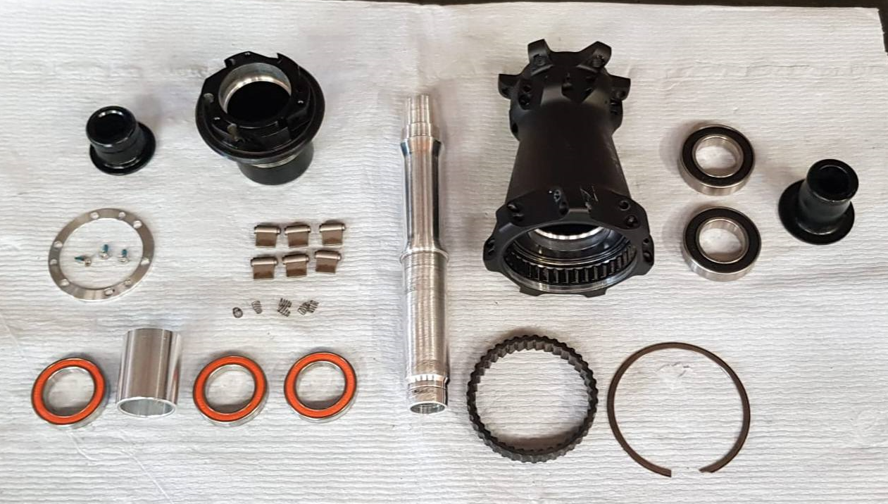

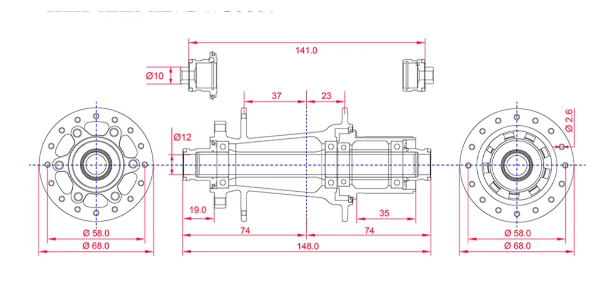

The other thing I would say about the hubs, is I'm unsure how high end the original Amflow rear hub is. It looks like a very decent 6 pawl hub. But there have been some issues reported. One of the most concerning, is Amflow have used quite a unique spoke, and cannot supply spares. And have recommended new wheels to people who have broken spokes.
I'll take a slightly lower end hub, where spares are readily available. Over a high end hub, where if something does go wrong, you really struggle to find spare bits.
Anyway. Here's some breakdown photo's of the Amflow rear hub.

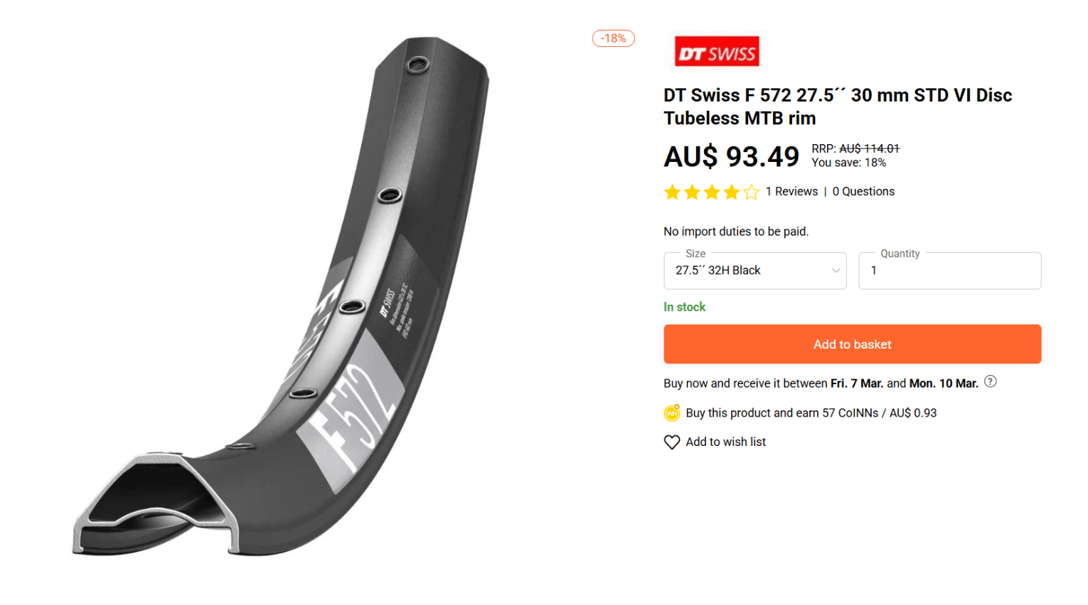

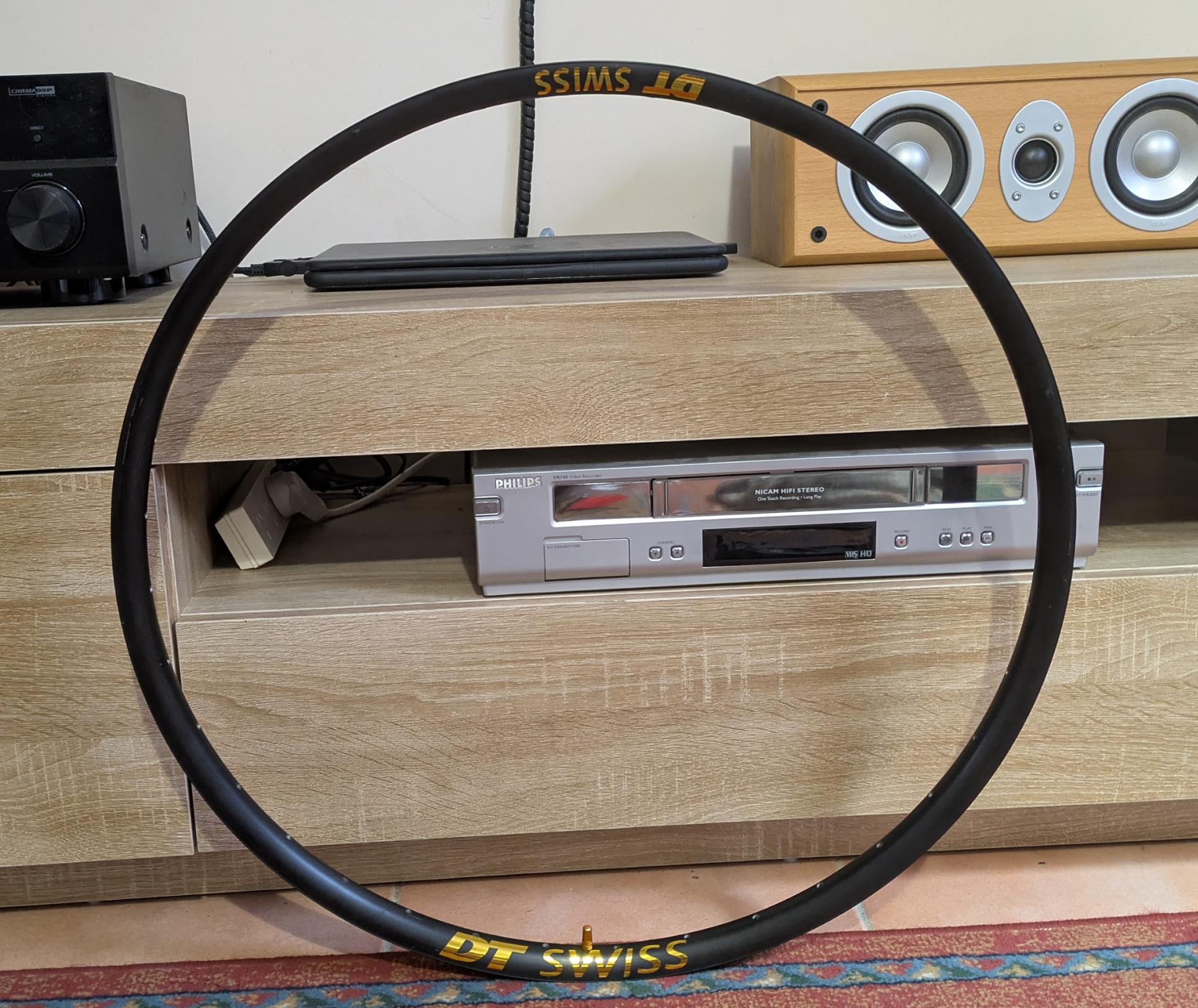

Did you find the alloy rims on Aliexpress along with the Kooser hubs? If not, have you ever bought any alloy rims from Aliexpress?
No. I bought DT Swiss rims from another online store. I removed the labels, and fitted gold labels.
I have bought 27.5 rims from Aliexpress. Same 30mm inside width. But they really weren't that much cheaper. About AUD$60. Aliexpress isn't a lot cheaper on single large items, due to shipping individual items isn't cost effective.

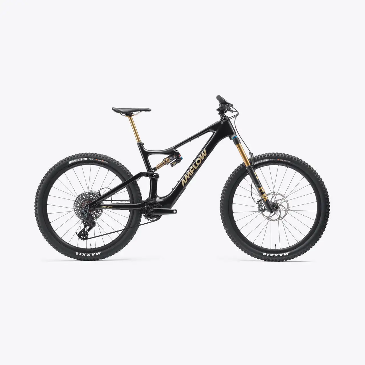

Never been so mucked around by a bike brand. Amflow now telling me that the PL Carbon Pro delivery won't be till May. :rolleyes:
So with bike trips planned around the supposed 6-8 week delivery, which is now seeming more than 12 weeks. I have pivoted and bought a spare EMTB. A lower spec, brand new Merida E160. It has the new Shimano EP801, which was missing from my previous Merida E160. I have also loaded the racing firmware, which is awesome. It also has slacker geometry and the newer 4 bar suspension.
I have also got the license from EMax and changed the region to USA Class 1. Giving me a 45kph limit.
I went for for first ride yesterday afternoon on the new bike, after downloading the new racing firmware, for the EP801. And boy oh boy what a difference to the old Merida with the EP6. Maybe I didn't really need to get the Amflow. 🤣
I rode the headland training course, and whaddya know. I'm going to have to find a better training course. I completed all the climbing parts first go without even a single dab. Ran it about 6 times. No dabs. Amazing performance.
The extra 100 watts plus the extra over-run, means you can approach any obstacle. Give one almighty pedal stroke, which lifts the front wheel, and the overrun keeps the wheel in the air, so you can fully clear the obstacle, without needing another pedal stroke, as you would just pedal strike on the obstacle. It's just so easy.
Very impressed with this bike. The Amflow will need to step up, or it will become the spare bike. 😉

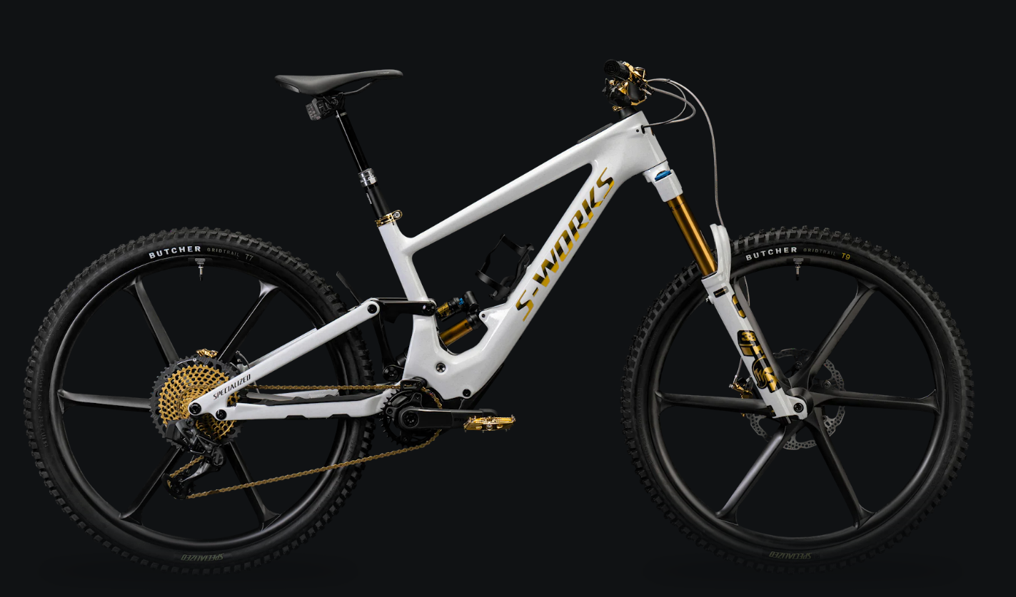

I got it in Red with Gold accents, so will also get the Liberace Upgrade. Current state of Liberace-ification. More to come with Gold fork Decals, and Gold with Black shadow Merida decals.
More upgrades will be adding the spare 12 speed Di2 transmission I have, from when I converted my old Merida to Di2 11 speed Linkglide to get autoshift (Autoshift turned out to be pretty ordinary) . Then adding the cleaner Bluetooth Display (which has been ordered), with much smaller Assist Select buttons (similar to the Amflow switches), and the power button on the downtube.

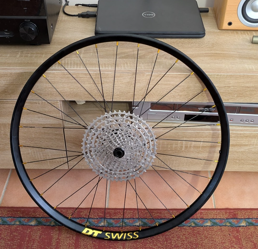

With a date on the Amflow confirmed. I thought I better finish off the Merida before it arrives or the Merida will get parked and mods not finished. Like a discarded favourite toy, when the new toy turns up .... 🤣

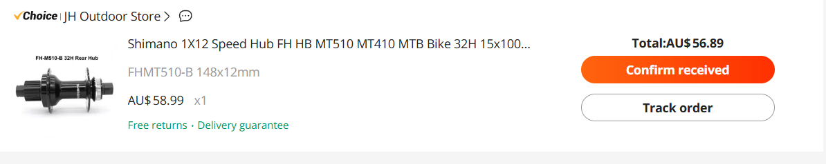

One of the mods, was adding the Shimano Di2 XT 12S Hyperglide Electronic Shifting, as I had a spare system in the draws at home. The E160 400 comes with a 9 speed Cues derailleur and 11-46T Linkglide Cassette. I must say that for a very cheap transmission. It worked really well. Infact I'm away for the weekend, and have left the 9 speed on as it's proven very robust. And will fit the Electronic 12s system when I get home. But there was some preparation required.
First thing was to build a Microspline Boost wheel. So I ordered a Shimano FH-MT510B hub for AUD$57 on Aliexpress. And when the hub turned up. It was a genuine Shimano hub out of the box. But I was unhappy with the sound coming from the freehub. So I stripped the hub and packed the hub cage bearings with bearing grease. Then applied a very light silicone grease to where the freehub pawls make contact with the hub.
When I reassembled the hub. OMG ..... what a difference in the hub performance and sound. And I'm sure this is where Shimano Hubs get a bad name. They are definitely not greased properly from the factory. And I now will always strip my new Shimano Hubs and grease them properly, before using them. I had to do this with the Koozer Hub for the Amflow as well. But only the pawls as it had all sealed bearings, which were rolling perfectly.
I also ordered a DT Swiss rim, and fitted the Gold Decals. I then also ordered more Gold Nipples.
The wheel came together really nicely, with the Deore 10-51T cassettte I had spare, added.
Very happy with the outcome, and I will fit everything next week, when I'm back from the Oaks Trail ride in the Blue Mountains.

Is that a VCR in your cabinet behind the wheel???

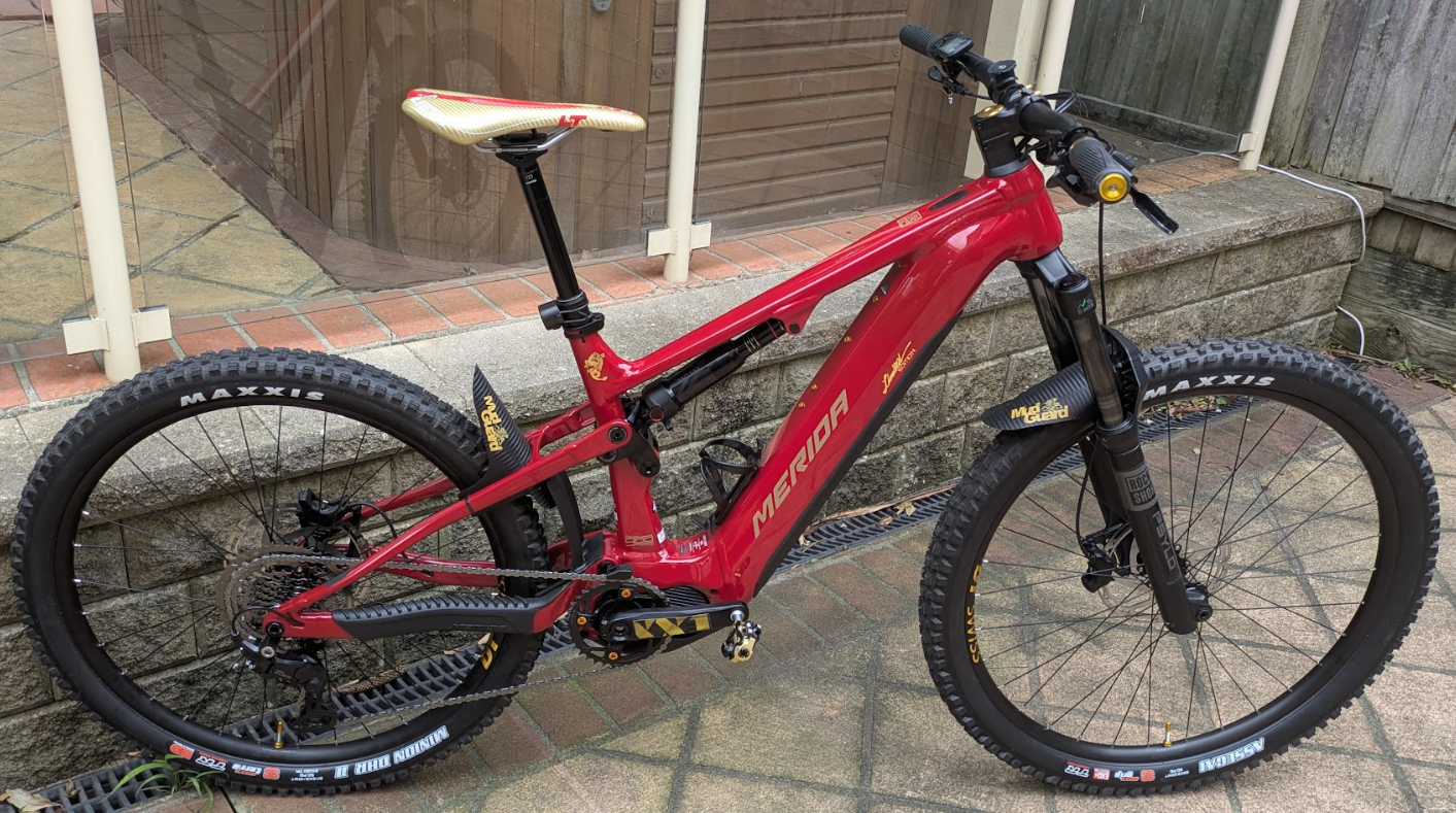

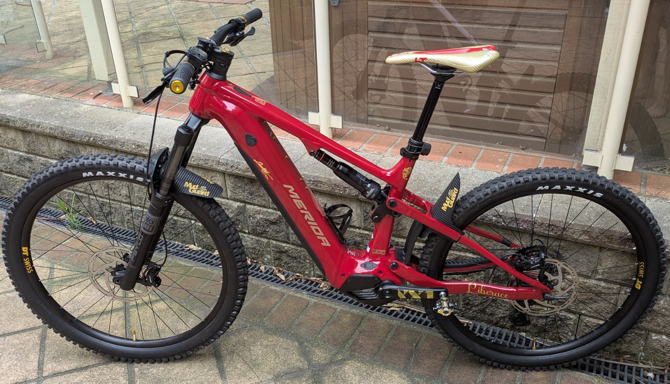

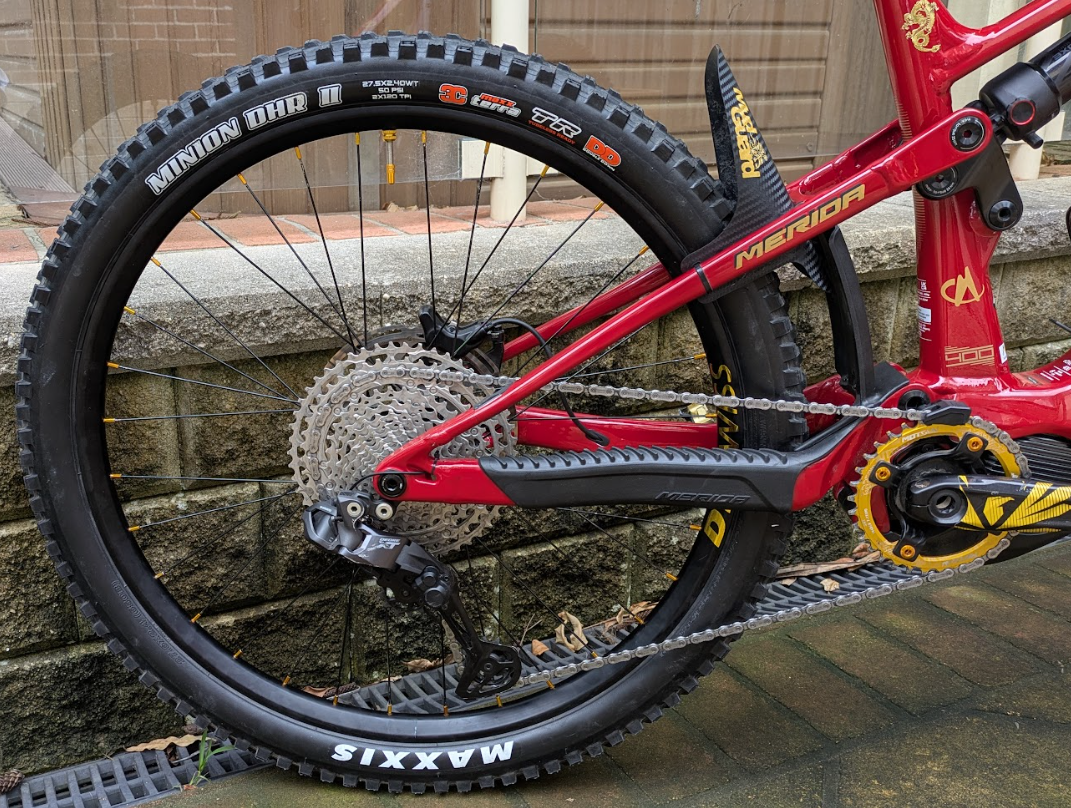

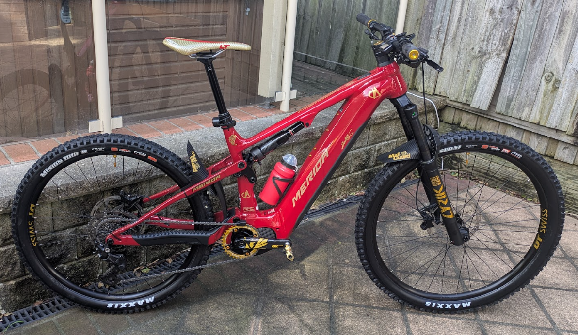

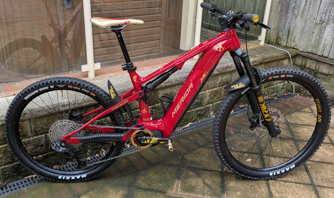

Only 2 days till my Amflow arrives in Australia .......... Meanwhile ........ The Merida gets it's new Shimano Di2 XT 12S Hyperglide Electronic Shifting. Using the old mechanical cable as a draw cord proved quite painful. But I got the electronic derailleur cable routed to the motor.
I also fitted a 34T Chainring, in place of the standard 36T. The chain only just clears the chainstay. So I won't be going to the 32T chainring.

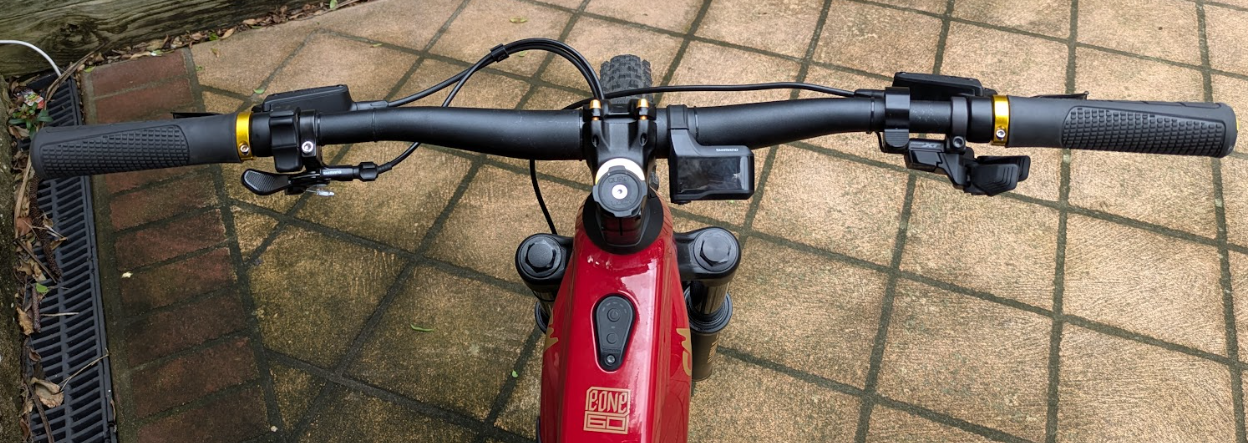

And with the change to the EM800 series of switches and display, the addition of the electronic shifter cleans up the cockpit nicely. I did fit a quad lock mount to the stem cap. But this time I drilled and tapped a 5mm thread into a new stem cap, and mounted it this way, rather than having a plastic quad lock fitting under the stem cap bolt. The plastic fitting would crush a little under really rough terrain, and cause the headset to become loose.
I also reconfigured the second button on the centretube power switch unit, as the light switch, instead of being an assist button, now I have the really clean, left hand side, Assist Up and Down buttons.
So this is the finished bike. I have had heaps of comments out on the trails, for how good it looks. Hopefully I can do even better with the Amflow.
The only other significant modification, was to the front fork. I removed both the pre-tension washers from the coil spring. It made a massive difference in the plushness of the fork on smaller bumps.
