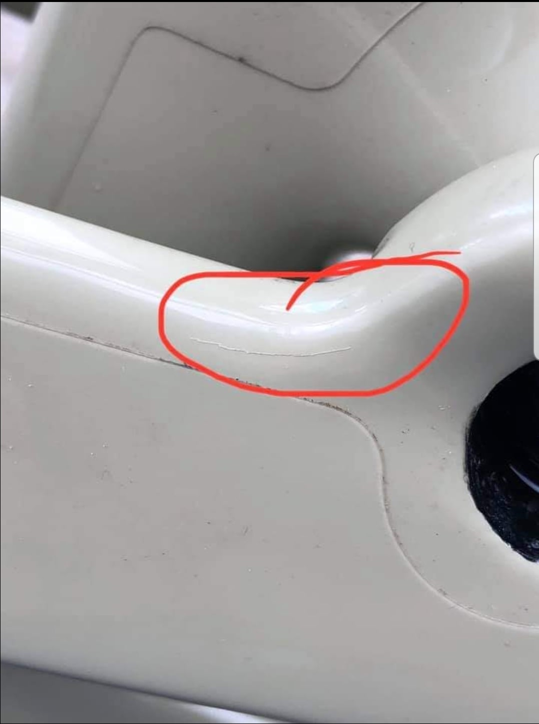

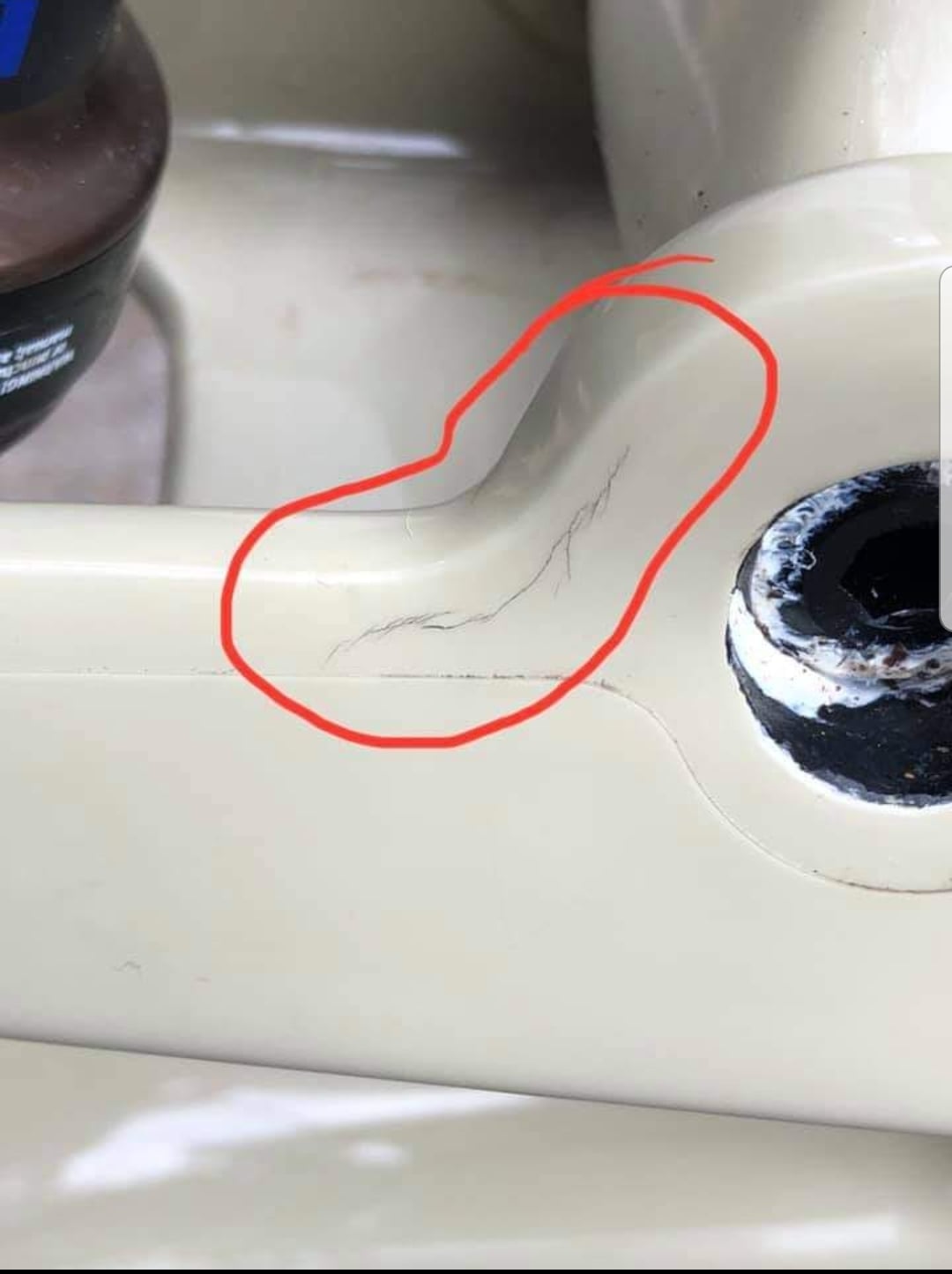

AllMtn 6&7 - Warning - Check your rear triangle bearing locations for cracked paint!

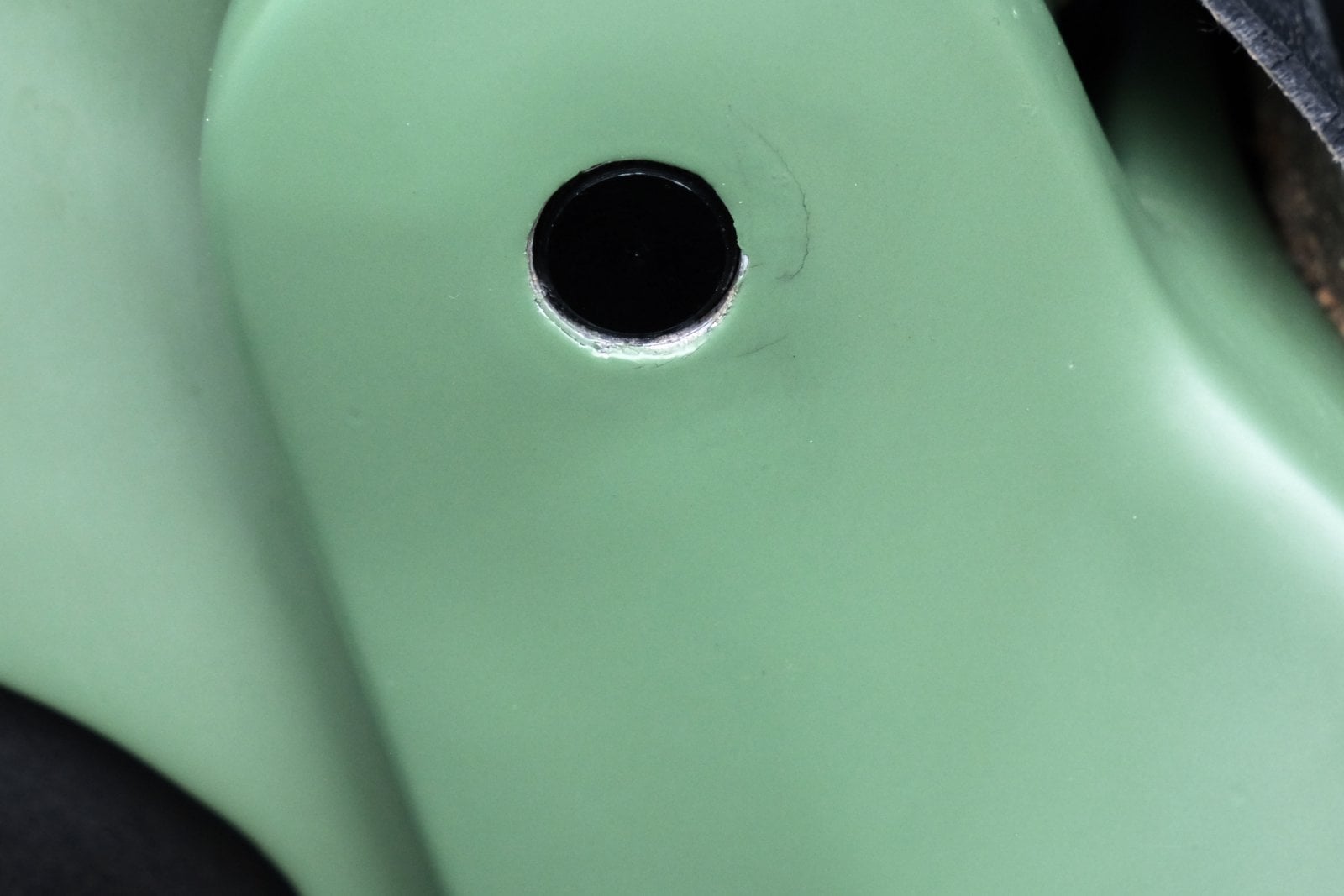

It looks like most of these are pressed in aluminum plugs, machined to accept bearings. I assume they are properly bonded to the carbon. In locations like the UK with large seasonal temperature swings the aluminum can shrink a bit, where the carbon won't, causing the plug to shift a bit in the carbon bed, breaking its' bond. With the cracks in the paint in a circle over the plug bond it looks like this is what happened. Probably not fatal unless the plug begins moving freely.
However, if the crack in the paint is radiating outward, away from the bearing plug, instead of following perfectly the aluminum plug seam (as in the nasty crack in Haibike Sucker of Chains' white frame picture), then you have a serious structural issue.

So I've brough a friends AllMtn 6 home with me this week to give it a full service before he goes away end of next week on a biking trip around Italy.
While cleaning the bike I found the entire bearing casing has come out of the carbon rear triangle!
There was no signs of paint cracking as he had checked it fairly regularly. The bike is about 2 years old and it looks like they only warranty the rear triangle for a year. But he's also the 2nd owner of the bike and even the frame warranty isn't transferrable!
It now looks like his entire trip is going to have to get cancelled, and lost deposit etc....
And I have absolutely no idea how this could ever be fixed. Looks like there's no way to buy a new rear triangle from HaiBike either.

Seen quite a few go like this tbh. The frame and rear triangle have a 5 year warranty to the original owner and like most brands cant be transferred (excluding specialized and Trek)....Try contacting Haibike/Raleigh UK you "might" be able to order spares, however the timescales will be long. Another option would be to take it to a well regarded carbon repair specialist. It can be fixed and rebonded - carbon bike repair in leatherhead seem to be the best from the research I did, they're endorsed by all the big brands etc. Good luck!

If it were my own bike and if I read right; it is the aluminum sleeve that the bearing drops into? If so I would mix up some epoxy resin and re-bond the piece.
I would rough up both surfaces, clean, then bond the parts back together. I might first drill some dimples on the outside of the aluminum sleeve (not all the way through) to give the epoxy a place to flow into and hold onto it. I might further wrap the bearing in plastic wrap (to keep resin off of it) and re-assemble the rear triangle so the part sets in the correct position (in case there was any room for play worn into the carbon).
Not professional advice, just what I would do, considering there is no warranty to void

That’s what I was going to do with carbon fibre. But raceco have offered to repair it with new parts.
Will update here with pics

As an update to this Raceco had parts ordered and delivered from Germany within a day.
My mate drove down today, and within 40 minutes they had him back on the road with the rear triangle parts replaced
All covered under warranty with no cost.
I think this is about the best customer service I've ever heard of. Will definitely be keeping those guys in mind when I buy my next bike!
