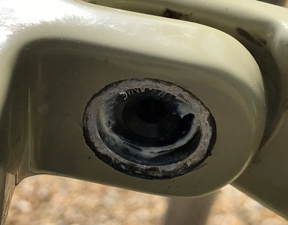

Did the repair co cock it up? - What happened bud.
Hard to know on alternative ebikes as they all have issues and parts are a nightmare to source for everyone. If it was me I'd100% go specialized next, not a fan usually as the pricing sucks, purely as I'm within reach of Berkshire cycles and they don't leave riders without a working bike.
The 'repair' could have been done by a 10 year old with a Dremel and some Araldite. All bearing housings (including those that were undamaged) were milled out manually and badly. They had the bike for many weeks and took it off the stand and rested it on the floor, causing loads of small scratches to the bottom of the frame. When they undid bolts to remove the rear triangle, they cracked paint off the frame, They failed to prebuild the bike properly (missing screws). They hid their damage. They have refused to put things right. I am currently taking them to court. Here are some photos of the repaired bike:

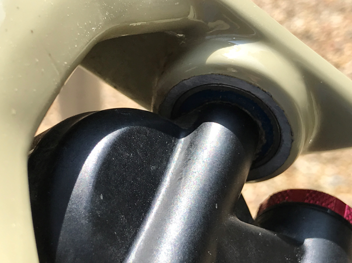

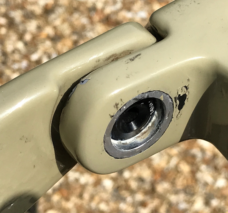

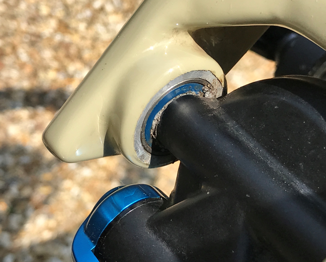

Damage done by e-bikeshop.co.uk when they removed the engine to get access to wiring to remove the rear triangle. This was initially hidden beneath grease.
This is the bearing that originally actually came loose in the frame making the bike unusable. This is the repaired bike!!!

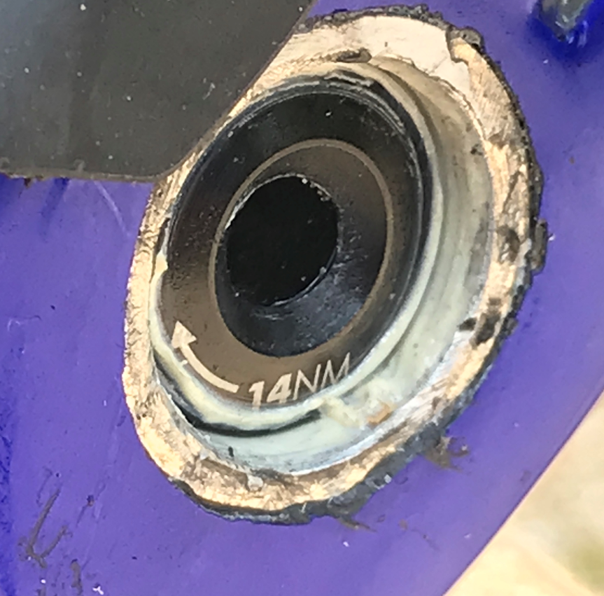

This photo says it all:
Notice that in their inept attempt to mill out the carbon fibre, they manage to do loads of additional damage to the frame and the paintwork. When they did the work they clearly used a rough workshop bench, as there are loads of scratches and chips.
When this was rejected as unacceptable, e-bikeshop.co.uk's attitude is that the bike is functional and so what am I complaining about.
The Haibike warranty promises 5 years warranty for the frame. This issue is undoubtedly covered by that warranty. It promises to replace damaged parts with new ones. This attempt at a fix clearly falls well short of this. Unfortunately the damage is now to every element of the frame. A replacement bike or a full refund would be an appropriate solution.
I have had legal advice, and have no doubt that e-bikeshop.co.uk will lose this case. They may be more reasonable in future as a result. Obviously, I would never buy from them again, their attitude has been appalling.
I will publish much more in future including all the tactics they used to try to avoid doing the right thing, what spurious and incorrect legal arguments they used etc, and of course what happens with the case. This might help if others ever find themselves in a similar position.
If anyone has a bike with the same colour scheme, it might help me if you could take some matching photos of undamaged bearings so that I can create more photos like the one above. Please get in touch if you can help, and I will send you photos that I would like to get 'before' shots to help the court see the extent of the damage done. Thanks.

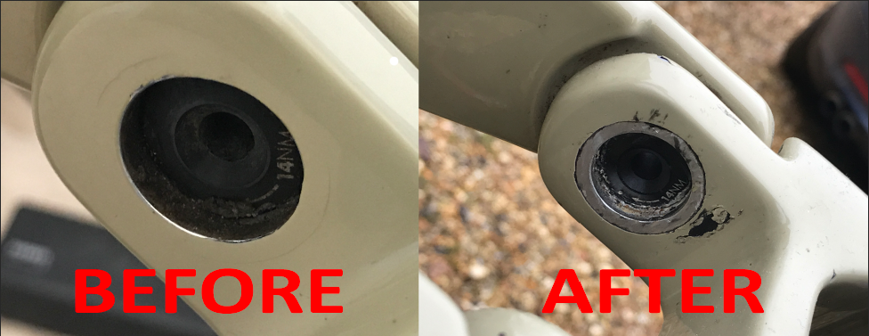

Hi, what I really need is shots taken of an undamaged bearing housing taken from exactly the same angle, so that I can produce a number of before and after photos, so that is it clear that the 'after' photo displays the serious damage done. The judge will not have time to interpret things, it needs to be presented in a manner that very easily demonstrates a clear breach of a duty of care, and a failure to honour the warranty promised (breach of contract).
It would be helpful to show: Perfect condition > Warranty Failure (my current before photo) > 'Repaired' photos. I only need about 6 photos to help me:
I would like this with no cracking to show what it should look like
And these bearings had no issues, but now look poor. Pictures of what they originally looked like (identical picture composition is best) would be helpful.
Many thanks.

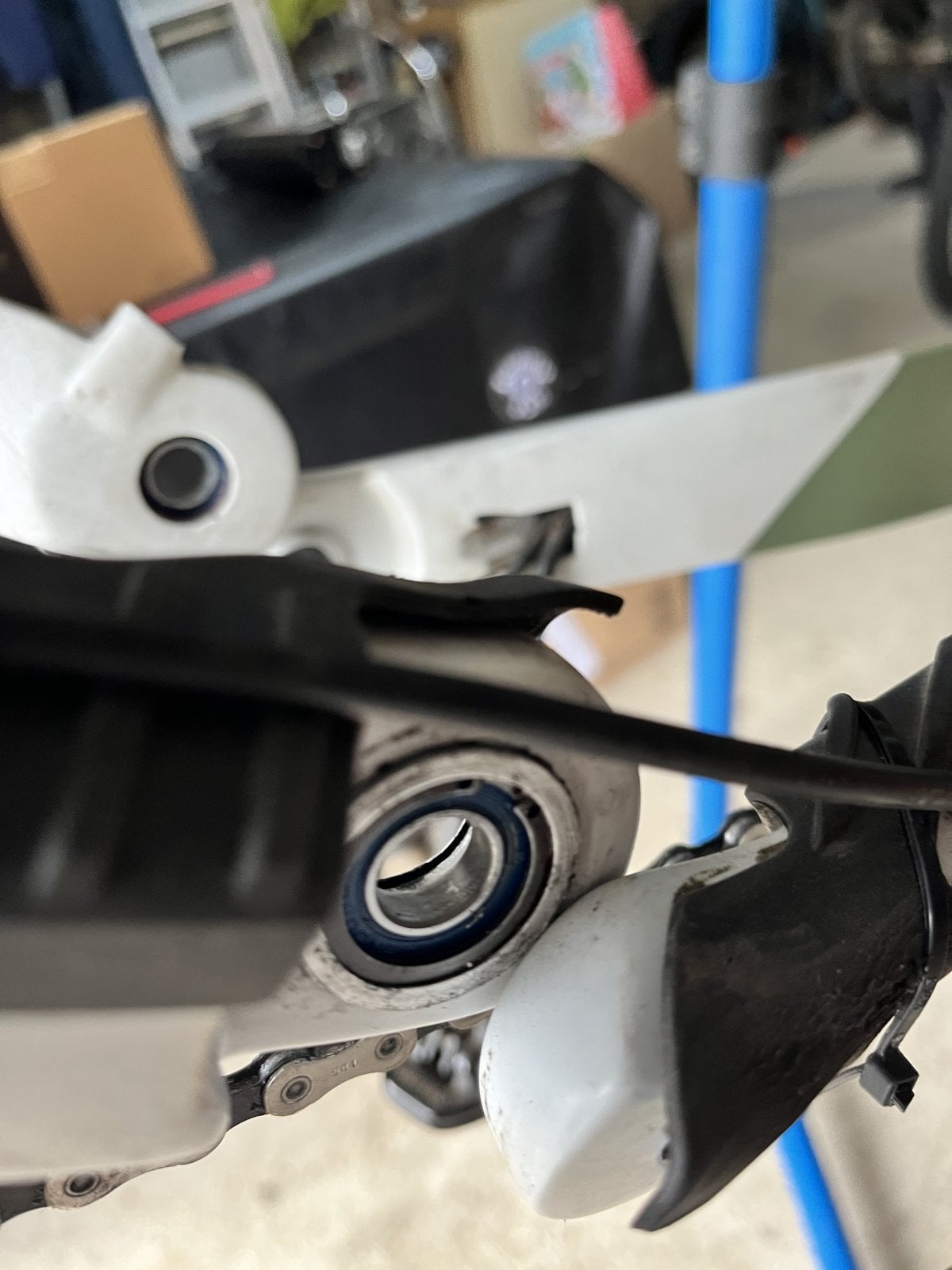

I'll try and get you photo of the rear linkage over the next day or so. The pic above is standard fella, the shims are on display in that area of the bike - it's the 4 horst link ones that they sprayed over. I'd remove those 4 pivot bolts and take a peek on the insides If I were you, judging by the edges on the pics of the earlier post they look like they'll be trashed too

Cheers :) I'll be doing a few more vids soon - Abus Battery Lock servicing / Headset Bearings / Bike Torque settings / cleaning out the XLC dropper / Extending chain life etc.
For the ones replaced on the vids - 6901 x 4 and 6902 x 2. - For the full set on this bike 6902 *2, 6901 x 6, 6900 x 2 - Would check the headset bearings if you haven't already - The stupid cable inlet design literally destroys the lower one on a monthly basis for me
The driveside 6901's were shagged after 300 tame miles, but I regreased them 3 times before replacing - total miles traveled at that point was about 1500 miles - That was all on the original chain btw :)

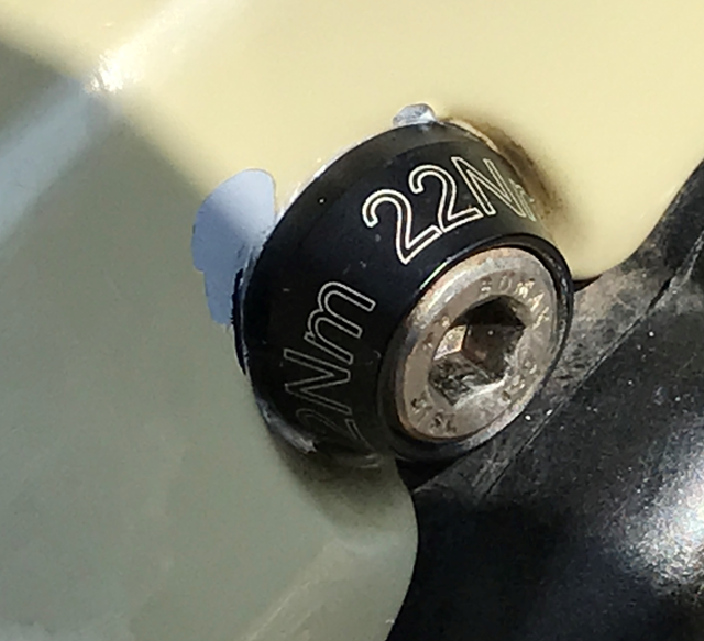

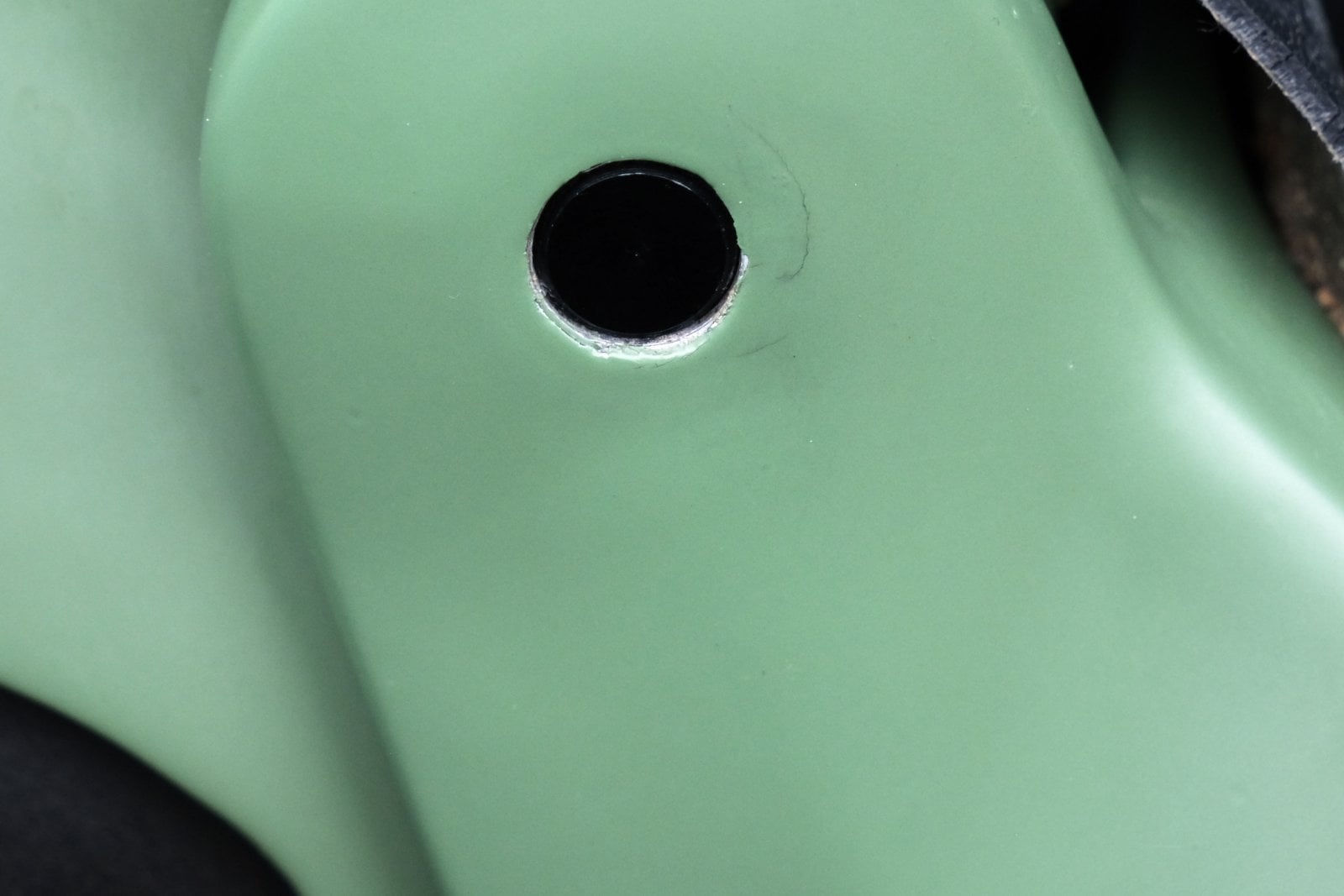

And it looks like I'm finally joining the gang. I noticed a mild circle starting to appear on the upper drive side Friday morning. Ill be taking photos of the location after every ride to see how it progresses from now on. Very mild atm, but we all know where its gonna emd up 😤

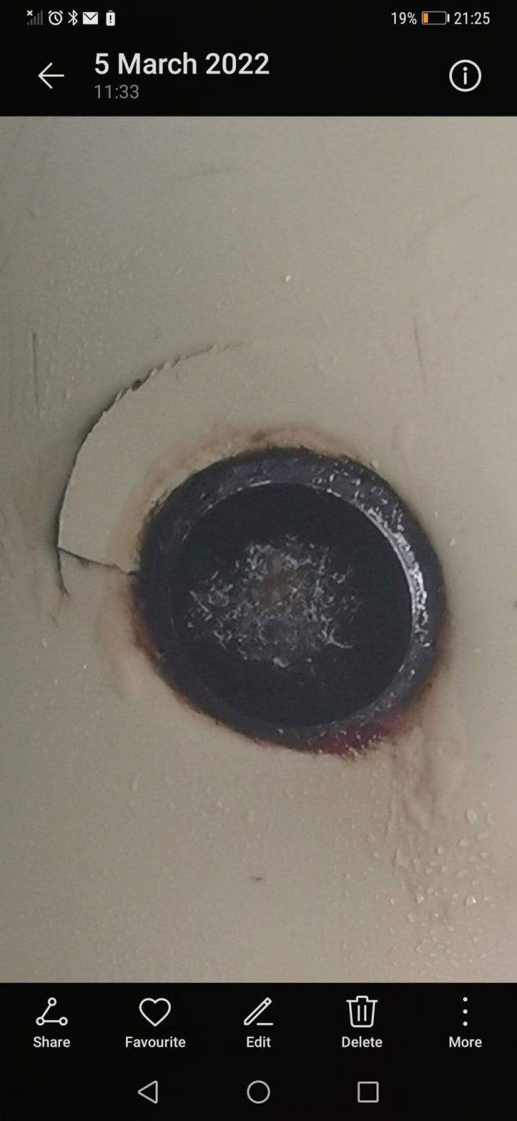

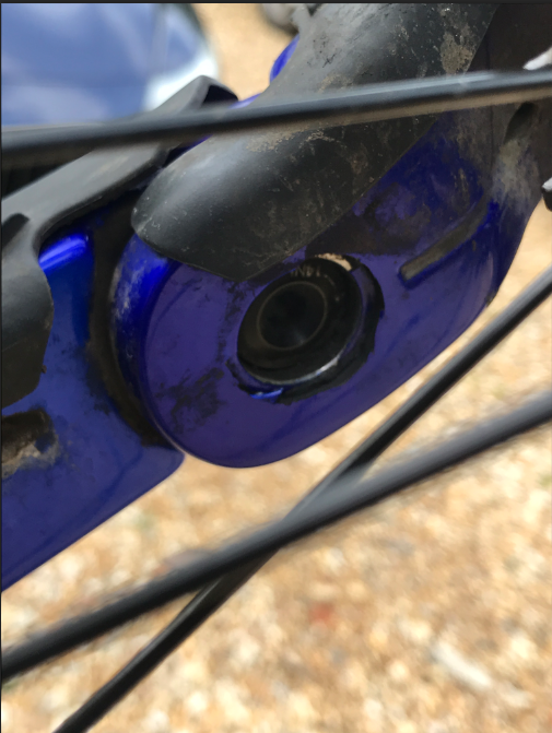

Hi everyone, afraid to say my Allmtn 6 2021 has a hairline crack around the main pivot point on the chain stay on the non drive side. Currently have a warranty claim in with Raleigh/Haibike via the LBS I brought it from. Pic attached shows the hairline crack around the pivot point, doesn't look much but LBS advised not to ride it, which I wouldn't want to just in case. The bikes been well maintained and not abused, regularly check the pivots with a torque wrench although there's not much to check on this pivot as the bolt is locked in place with a grub screw. Fingers crossed I hear something from Raleigh/Haibike soon.
Ug sorry to hear that - I've seen a few more over the last couple of weeks. Assume you'll be getting a refund, although I have recently seen a few replacement carbon rear parts get supplied for other owners with these issues, so that could be promising news
Jimtheboss
Jun 16, 2022
Cornwall
Not sure what's going to happen yet, the LBS I bought it from have been very helpful so far and quick to lodge the warranty claim, they say its the first one they have seen and sold a fair few of the Allmtn 6 and 7's. I have pointed them towards this thread to suggest there are a few others. I hadn't really thought about a refund, I really do like the bike, done over 1000 miles on it and apart from this its been fine, only normal wear and tear/maintenance. That is reassuring that there maybe spare frame parts around now, hopefully I will hear something soon.

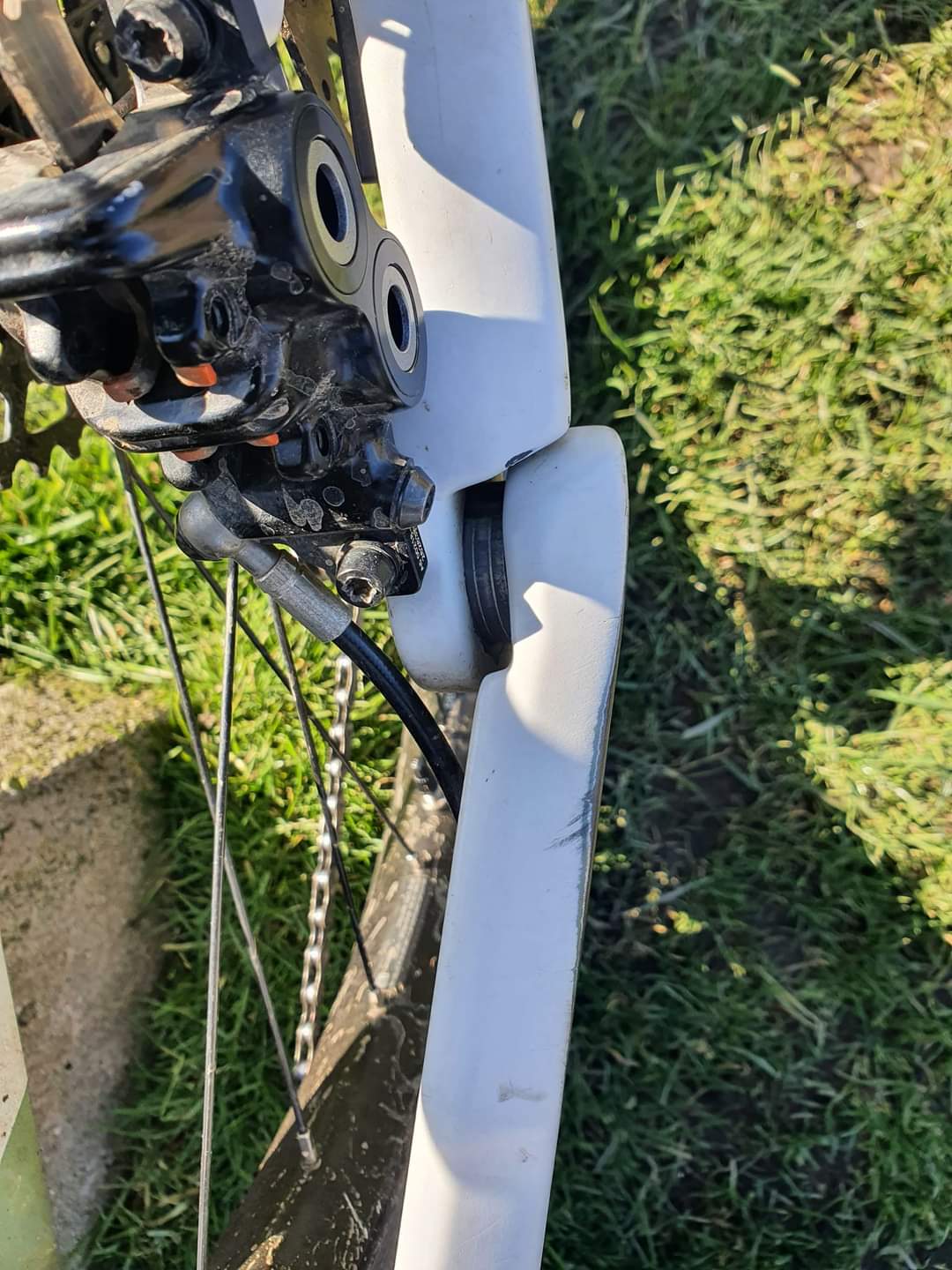

Looks like I am joining the club also with my Allmnt6. I have only just had it back for 1 month after it was away for 4 months for a motor replacement. Only found out as decided to check as had read this thread. have just contacted the bike shop, lets see what happens. 19 months of ownership and its already been 5 months out of action
Oh no, I feel for you my friend. Hope you get a quick response. Would be interested to find out what your outcome is and if there are spares available and whether they have been improved manufacturing of the pivot points so this shouldn't happen again. I will be onto my LBS soon for an update on mine.
