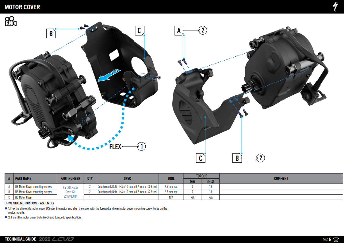

I still cant get rid of this annoying rattle though, stuffed the top tube with more bubblewrap today and its still there!
Used adhesive felt between the motor cover and the motor, I realized that the noise was coming from that point by removing the battery and knocking on the cover.
I split the two engine covers (c) and put the adhesive felt because they banged on the engine, there was some space in the front towards the battery now I no longer have the noise 🥳
