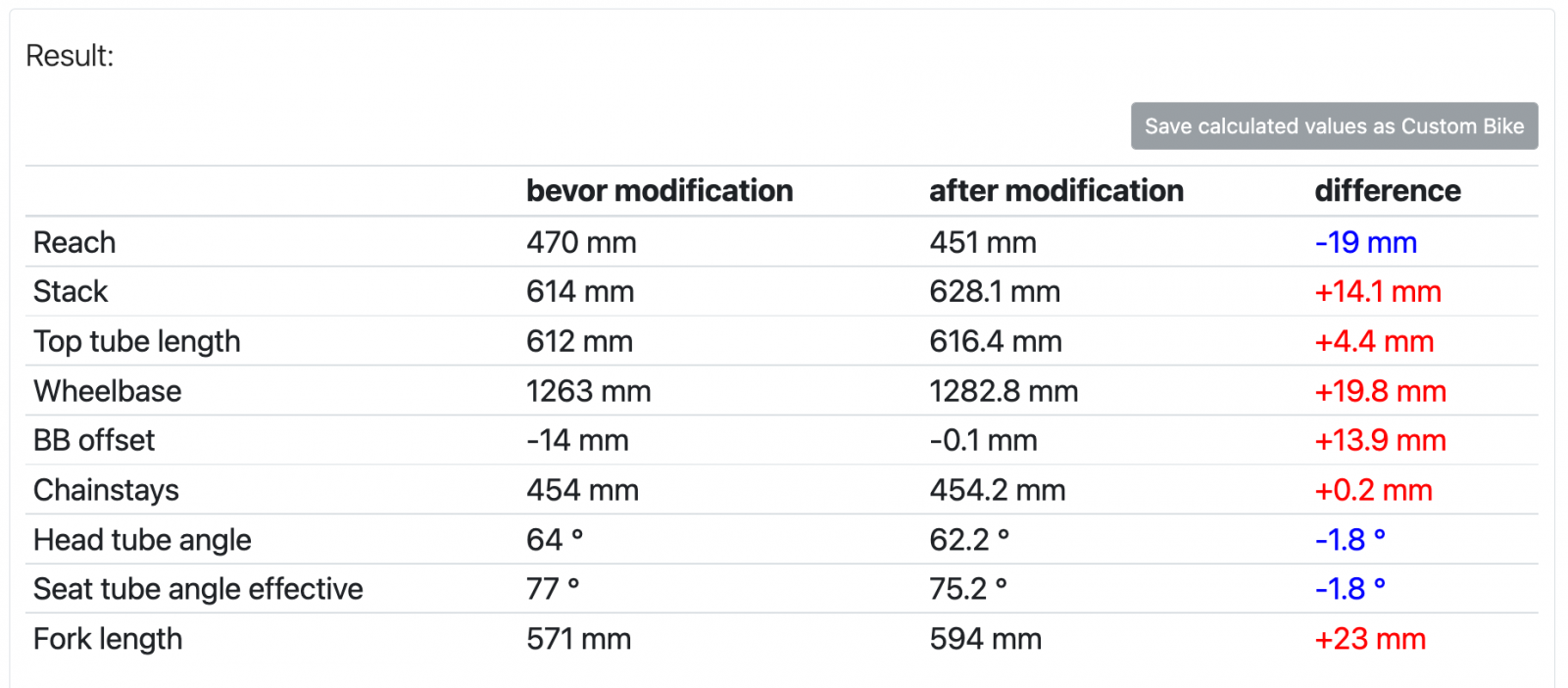

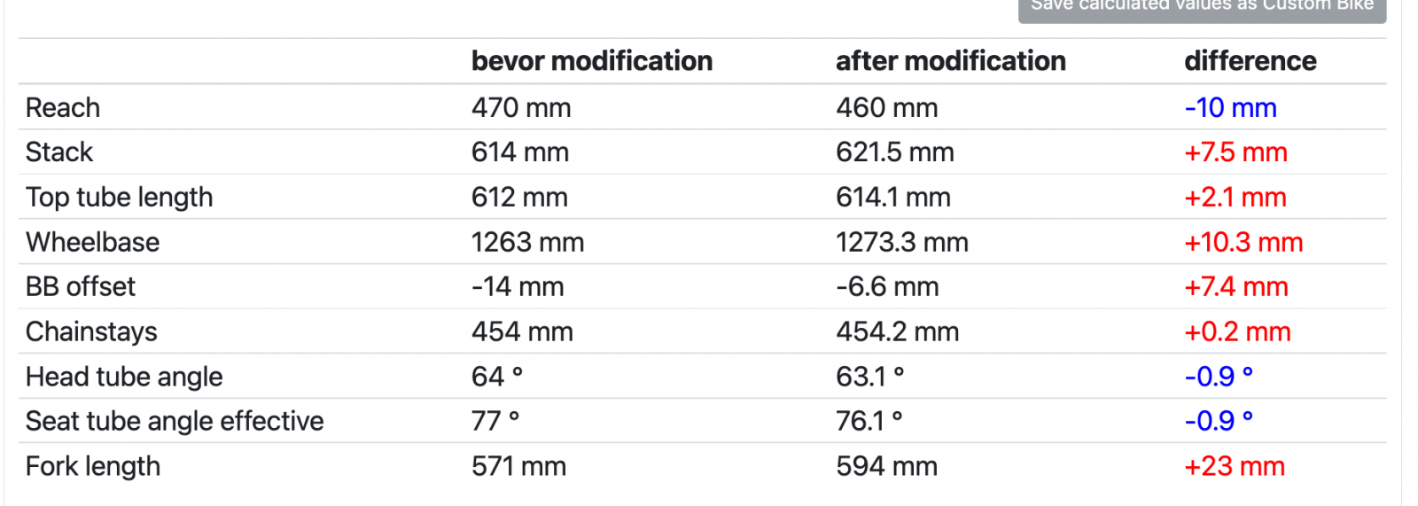

This is what the calculator gave me
Stock vs. Fox 38 (180mm) Mullet
Stock vs. Fox 38 (180mm) 29 f/r
Just did the first test ride on the 29 f/r setup yesterday and can really confirm what has been reported here already: it's fast like hell!
I expected there will be some modifications of my position on the bike needed as geometry changes quite a bite. But jumping on the bike it just felt right. When riding, the positive rolling effect of the 29er rear wheel was clearly noticeable on downhills. The whole setup now feels well balanced. Curious now on who it feels on tight switch backs - still need to test that.
I liked the mullet setup much more than the stock. But it's quite an extreme setup, not so easy to ride but a lot of fun. From my first impression yesterday, I feel like the 29er setup is easier to ride and faster. Let's see how it feels on the upcoming rides.

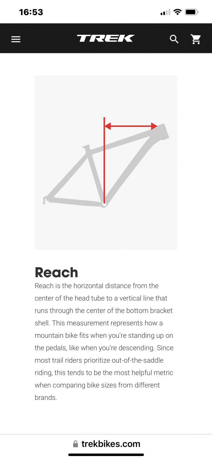

How can the reach numbers change by changing the rear wheel ?
Edit oops , front wheel ?
Just imagine putting your bike vertically on the backwheel: reach goes towards zero as BB and Steerer Tube are more or less inline (vertically).

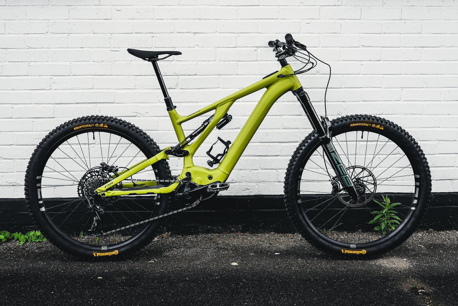

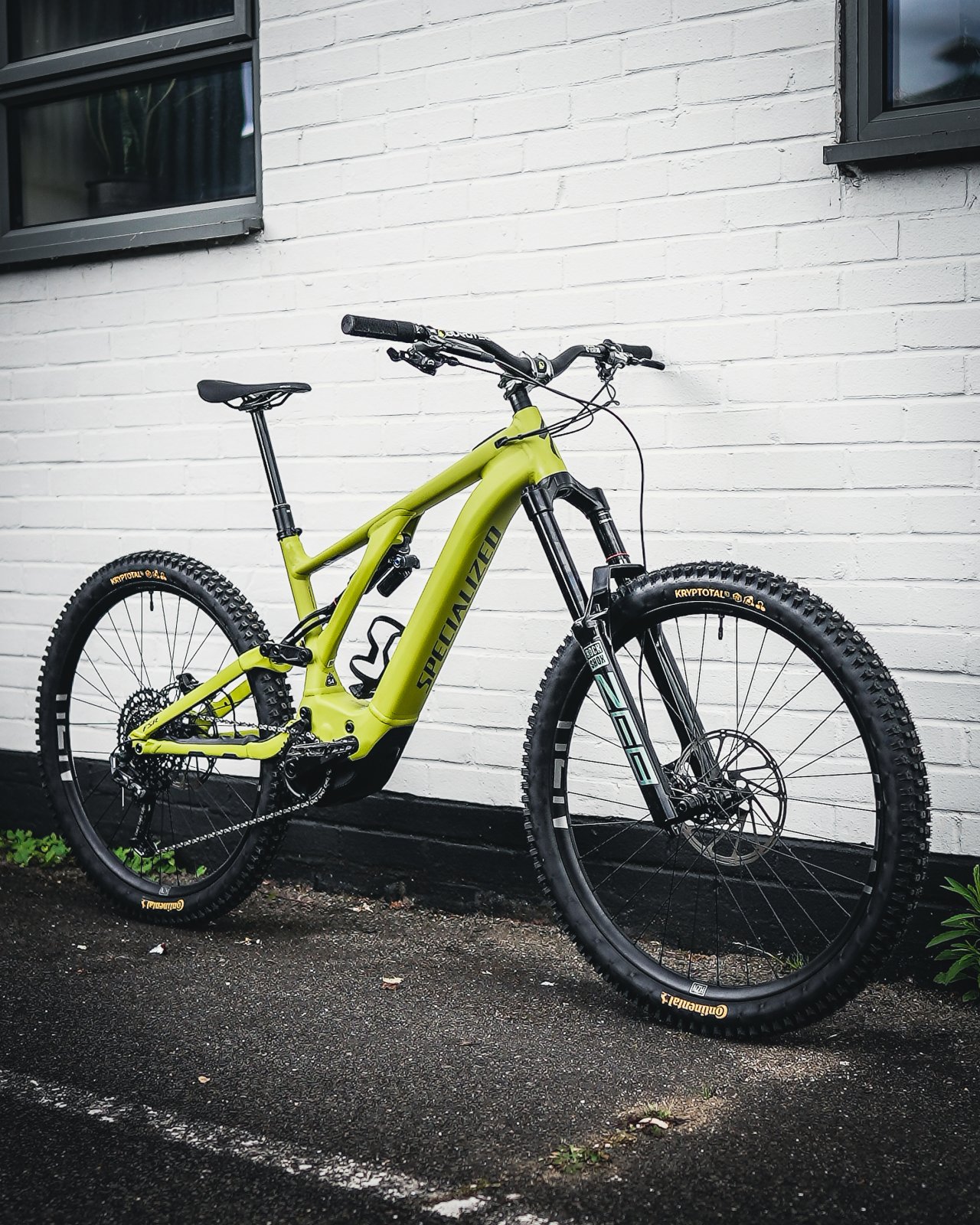

First ride yesterday. This is possibly the best climbing ebike I've ridden. Its full 29er, Brose Motor, mega long travel and steep seat angle just get up anything!
Bike is pretty slack, with Zeb 180 and its axle to crown of 596mm, it must be under 63 degrees. I also noticed the Zeb runs high in its travel. I'm going to fit a Fox 38 that I think will work better. And also try it with flip chip in high.
BB height is pretty high, but at 33% sag its not too far off a 'standard' Spesh Enduro
Definitely need to play around more with bar height and geo.

flip chip high.
Bike is absurdly capable. Seat angle is super steep and bike is around 62.5 head angle 😂Zeb axle to crown is 596mm on the 180 so hoping the Fox 38 will steepen it up slightly.

Rob, please fill us in with more detail on your ride and handling impressions when you get a moment.
Its amazing. I have a ton of time on the Gen 3 levo and now have this to compare.
The rear suspension is better on this. Obviously its longer travel, but seems more sensitive off the top with more progression that the Gen 3 levo when using an air shock (I think air is important on this Kenevo as it loses progressivity at the end of the stroke, air helps it ramp up more).
The 22.9KG weight, its almost as light as my S-Works Carbon Levo!! Crazy right?! It basically is a super enduro long travel Levo, but full 29er.
It has the new Mastermind TCU, the same 700Wh battery, so all the features from the Gen 3 Levo too, other than adjustable geo.
On the geo, its slack. Like 62.5 degrees! But it doesn't feel too unwieldy, I put it in high position on the shock and it turns quick. BB is high (362mm) but a 180mm bike when sagged at 35% isnt too far off a Yeti / Kenevo SL, so its a non issue to me.

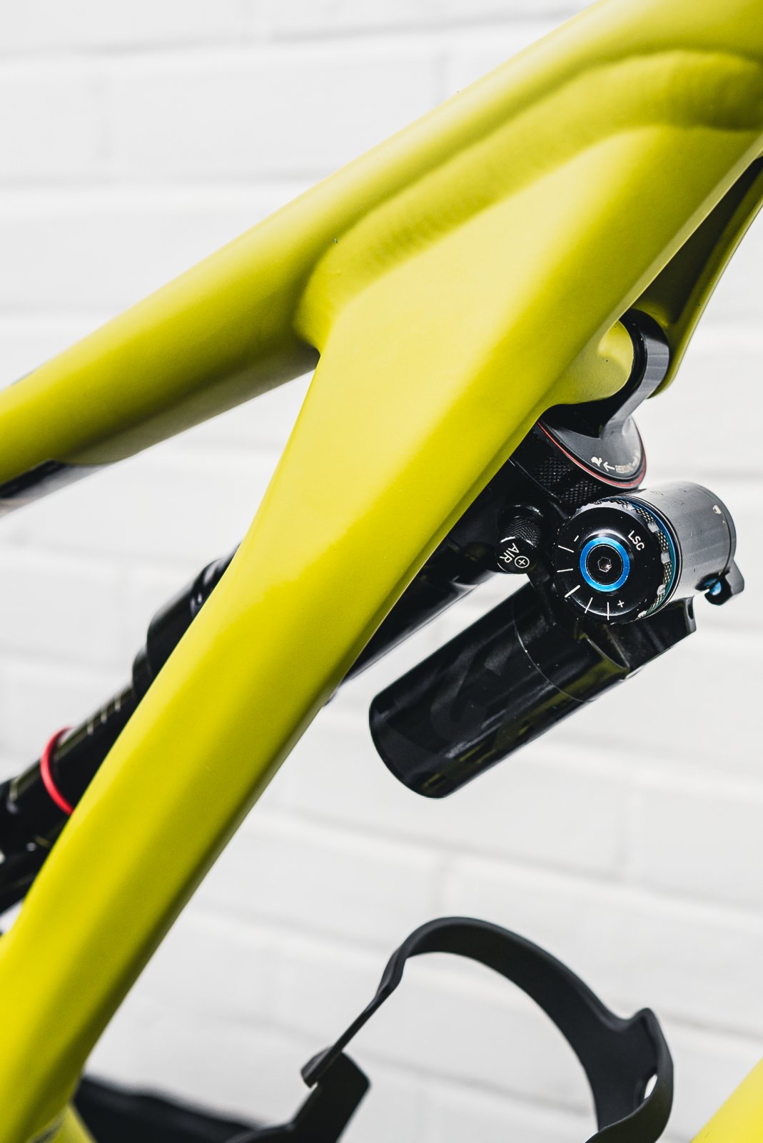

I agree with Rob. The air shock on mine was initially a concern as am used to coil. However after installing a slightly higher volume spacer on the X2 it started to offer both the preload, pop and mid support for cornering I was looking for. Also when taking hits soaks it up very well.
I too was amazed that Spesh haven't made a 29et turbo Kenevo. Maybe because they think it would compromise the Levo Gen 3.
My BB is 352 ish now. That's with the offset bushing; with 180mm travel and 25% sag gives a good feel both up and down ref pedal clearance and cornering.
