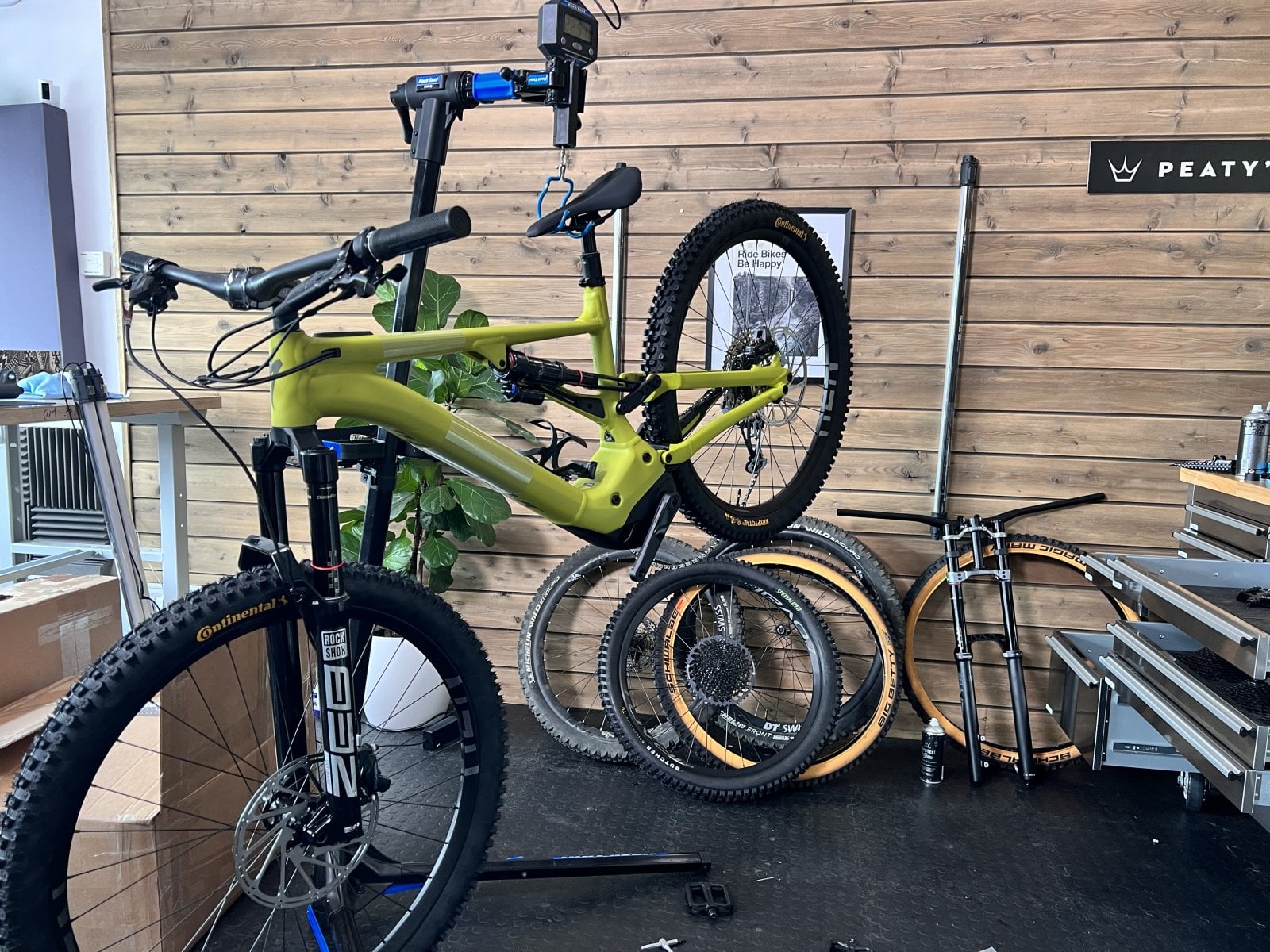

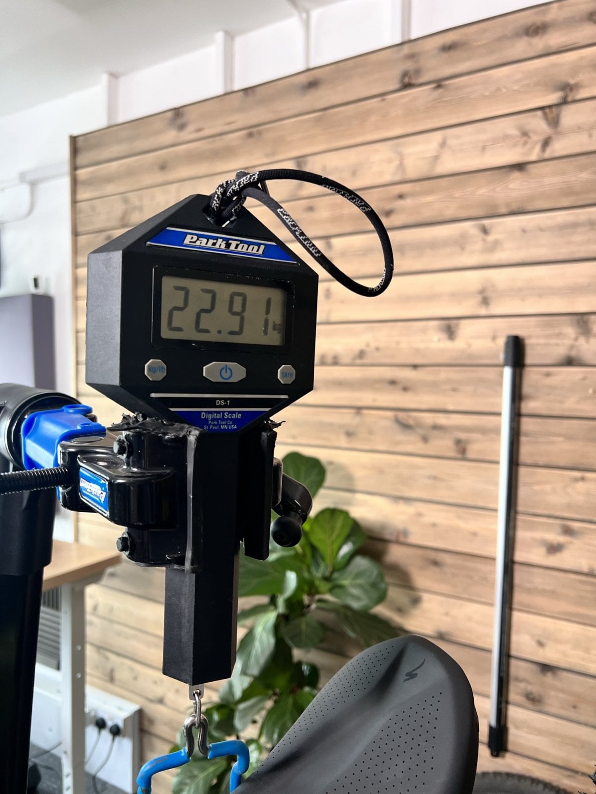

29er Kenevo and 22.91KG. Alloy wheels.
Easily possible for a 22KG Kenevo with carbon frame.
88DF8EE1-6B50-409A-956E-BEE700FB314E.jpeg BE9977B5-89A5-4931-8686-927848876609.jpeg

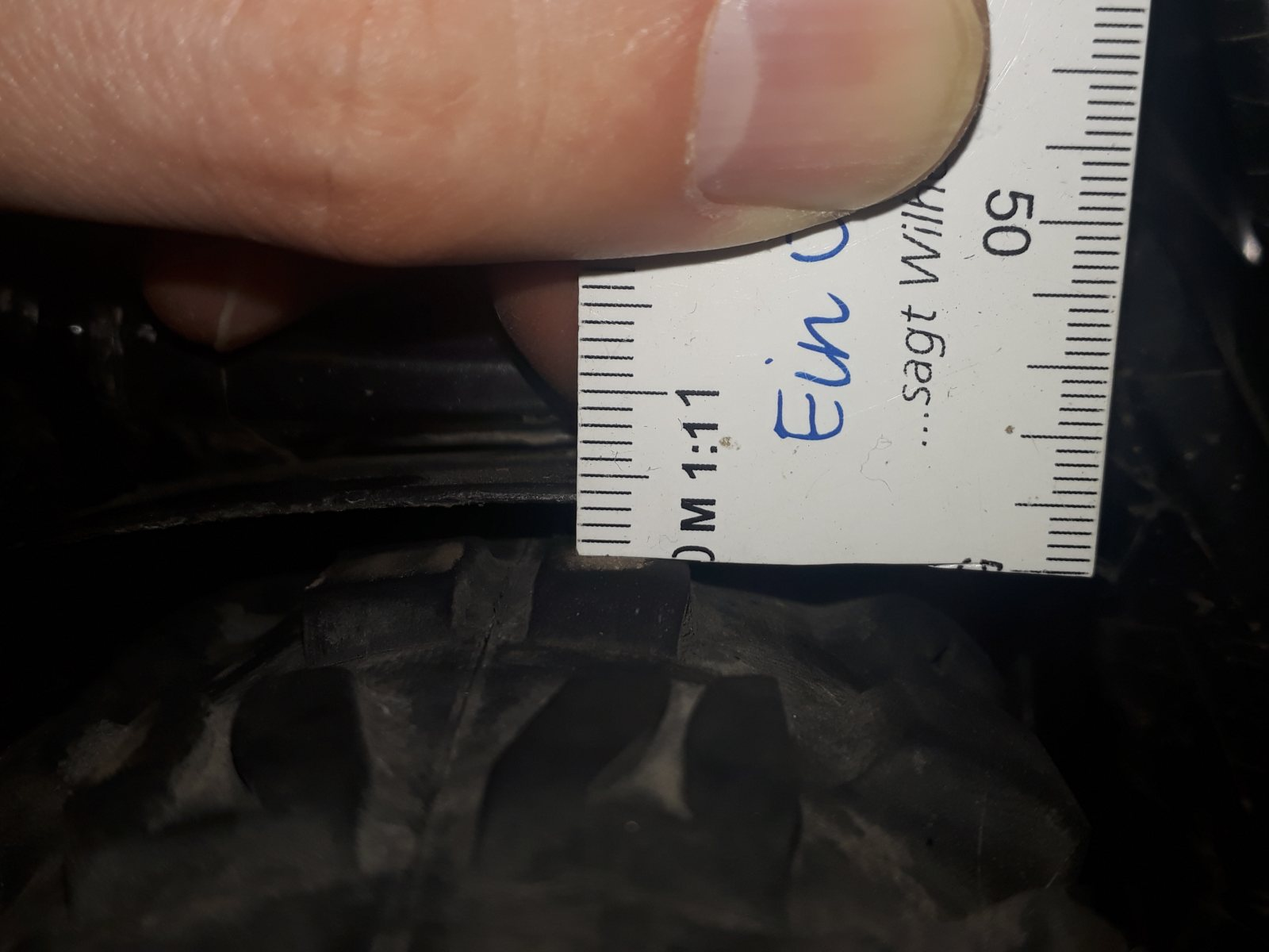

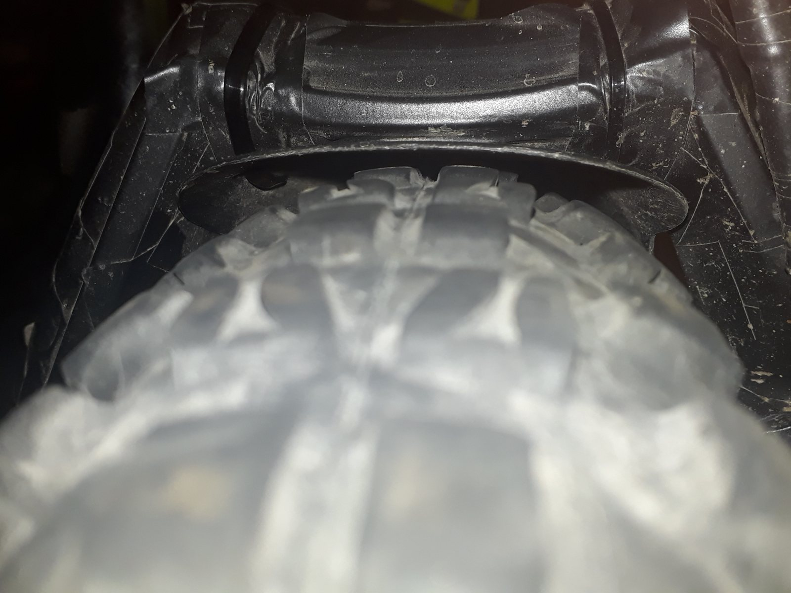

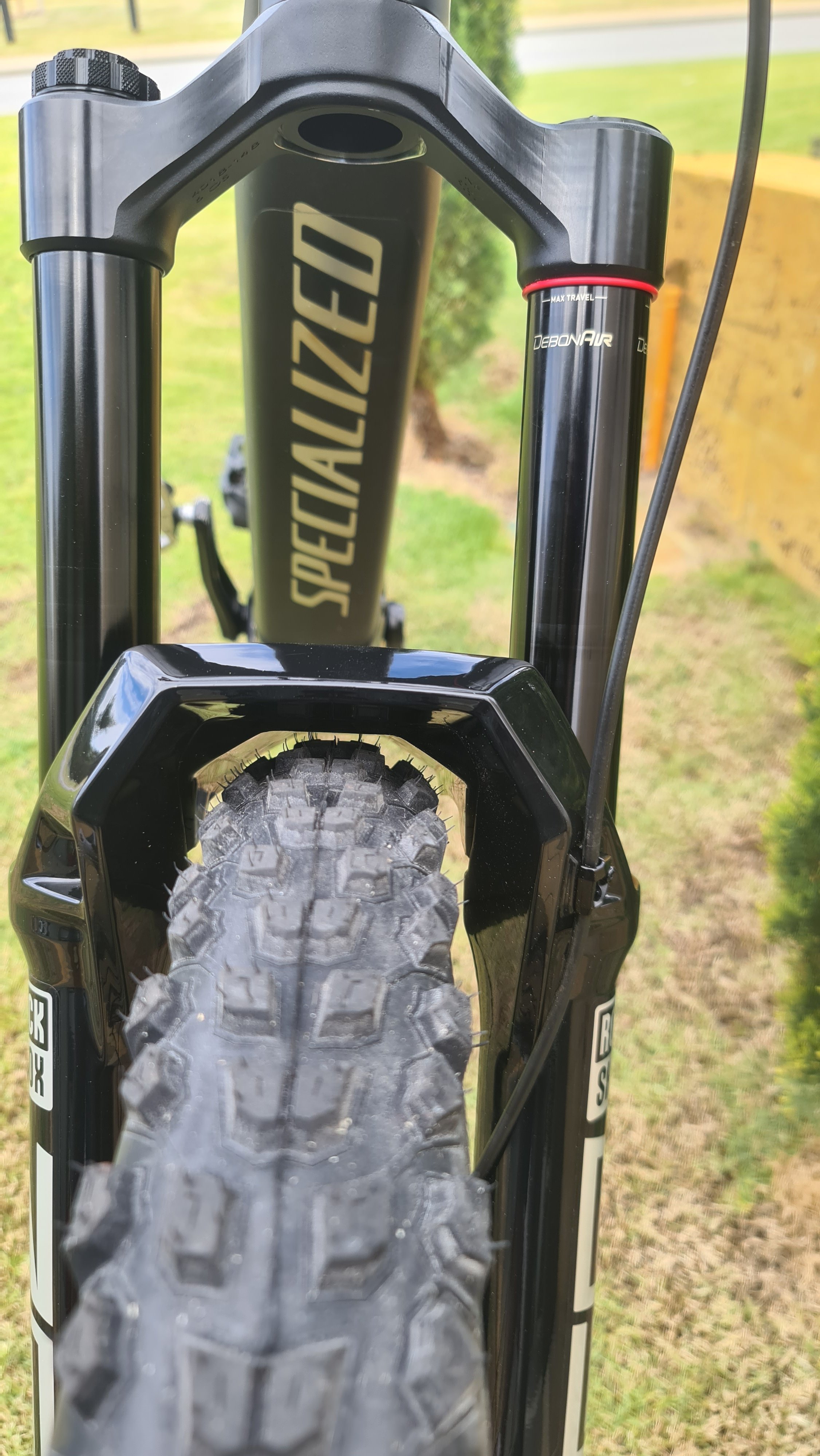

So I ordered a 29" front wheel and a used tire just to check the clearance on the default Marzocchi Z1 Bomber fork.
And... it's not much, I wouldn't want to ride like that.
The rim is a SunRingle Duroc 40 with 36mm inner width, the tire a used 29x2.5" Maxxis DHF with around 70% of the tread pattern left according to the seller. Tire pressure is just 1 Bar (~14.5 psi), a higher pressure would likely result in even less available space. Also, a narrower rim would likely cause the shape of the tire to be higher instead of wider.
Tire clearance seems to be around 3mm to the Marsh Guard and maybe 5-6mm to the fork.
#lazy

That’s a bit tight , it’s not just there though . If you let the air out and full compress the fork you might find the crown will hit the tyre .

sp00n
Jul 11, 2021
62
31
The tyre will only go flat on the bottom..
The air out of the fork. 🙃
The fork crown (the part where the steerer tube and the stanchions are pressed in) might come deeper than the fork arch (the part connecting the lower legs), so it might hit the tire on full compression. Not a thing you want to experience during a ride.
I said it 1st ☺️👍
I rode one summer mullet mode. 29" at front, but only max. 2.3 fit in front.
WTF? I thought it was only lowers what was difference between 27" and 29" forks.
