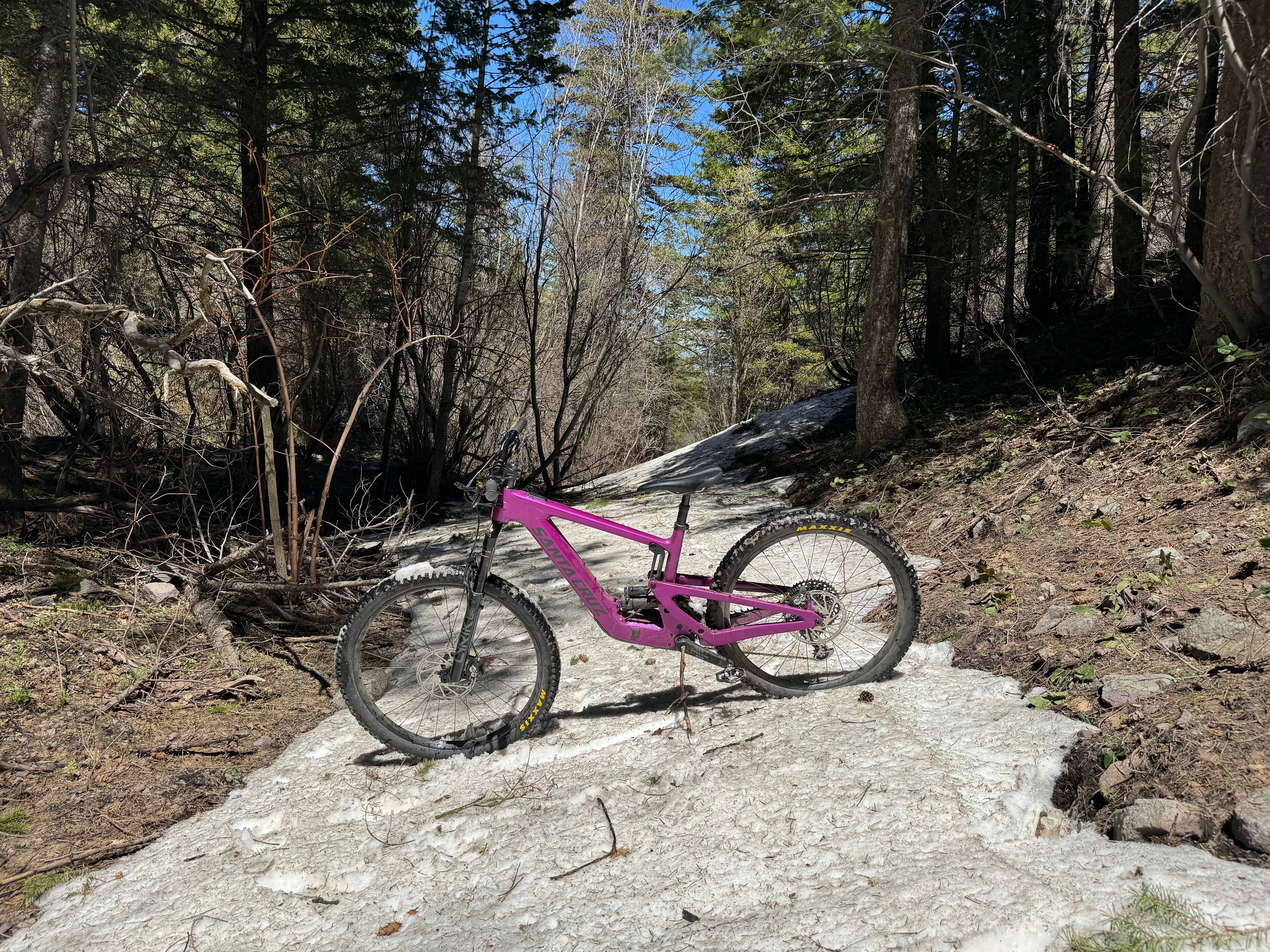

My bike finally arrived and I have been able to get out a couple of times on it already. Such a fun bike. Loving how poppy and flickable it is - noticeable upgrade from the Transition relay in that regard.
I had a matte ride wrap kit laying around from when I first ordered the bike last fall (originally ordered the grey color), decided to put it on before my first ride. It definitely took some sparkle out of the magenta. Unsure how much I like it and am pondering replacing it with a clear wrap.
Had my LBS install shimano saint brakes when the bike arrived. First time on saints, must say I really like them in comparison to the codes I had ridden before.
Question for the group: how silent is your bike? Do you notice any rattle when descending? I am Not wondering about the quietness of the fazua motor. But I can't pin down where a rattle is coming from when I encounter repeated bumps. It sounds like cable rattle but I am having a hard time replicating it when not on the trail. I notice that Santa Cruz still isn't guiding the rear brake line through the rear triangle, so maybe that is the culprit or contributing. Contemplating placing some foam of sorts around all of the cables in the bottom of the frame. What have others done? What have you used?

My bike came with a foam tube in the rear triangle around the brake line already. Check with your shop if they left it in place. In terms of rattles, mine is mostly pretty quiet - every now and then I hear something, but not certain where it's coming from. If I had to guess, it's from the excess ring controller cable up loose in the head tube area. When I had the lower guard / battery hatch off during brake install, the cables seemed pretty well secured down there.

Silent for the first few months then it developed a creak and a rattle. It took some time to isolate the two sounds. The creak is coming from the fork (CSU issue - annoying, no way to fix). The rattle was caused by one of the cables contacting the battery. I added some foam around the cable and problem solved.

Did you just add foam around the cables behind the battery guard, or up higher than that behind the battery?

It's more difficult than you'd think compared to SC trail bikes. Rear triangle gets a foam sleeve stuffed down inside, then the rubber grommet fitted around it and the speed sensor wire. After the brake hose enters the front triangle, there's about 2-3" before it enters a guide tube, which is tucked up above the battery. There is a fairly sharp bend getting up to it, so there's no way that you can just feed it in the hole and hit the guide tube. I took off the bottom cover, fed the brake line through and out the bottom hatch. Then I dropped a Park Tool Internal Routing Tool line down from the head tube, and attached the brake line to it, and used that to guide it into the start of the guide tube. Once you get it into the guide tube, you can just shove it up from the open hatch and out the top. Then you reinstall the hatch.

I've just replaced the brakes on mine (trying out shigura) and agree it's not as simple as the trail bikes. In my 5010 you just had to push the line in and it would follow the routing.
In this one you do have to remove and reinstall the foam on the rear triangle - quite easy - and then have some sort of guidance when you remove the motor cover to send line beneath the battery.
Not having the proper tools I just put half a toothpick in the new brake line, old brake line in through head tube, insert that into the toothpick, put some tape around it and slowly push the new one in. All done.
