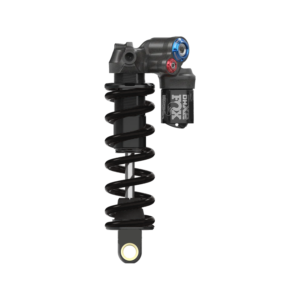

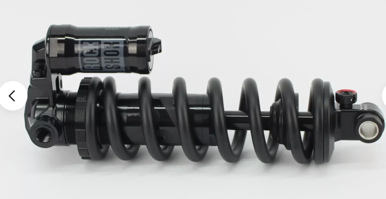

Sorry, I'm sure this has been asked before but I have recently picked up a Wild size medium 2024 model. Can anyone tell me if this particular shock fits the frame. It's a 205x65 Rock Shox Super Deluxe Coil Select R or would I be better off going with a Fox DHX2?
Also, in terms of spring rate, I am 76kg on a good day, is a 450lb spring the way to go?
Not too sure if that one will fit, Someone on here will know. I use a DHX2 and that fits fine.

So am i hearing this right?
A Fox DHX2 will fit on a 2023 Wild without any modification needed?
DrDexx
Mar 2, 2024
57
63
Longridge
Yes, maybe on a small frame there might be an issue. But on my XL there is loads of room.

The shock will have to be 205mmx65mm trunnion mount.
Yeah Orbea are not very helpful at times!
DrDexx
Mar 2, 2024
57
63
Longridge
Strange - Fox don't list a 205mmx65mm trunnion DHX or DHX2 on thier website for purchase?????
Here a performance elite one.
You can also get a 205x60mm trunion and remove the stroke reducing spacers. It's a very easy job, you don't need to take the shock apart.
Like this
Thanks again. Really appreciate your replies and help.
Yeah I just spoke with Sport and Leisure and the Elite is the version that comes on pre-built bikes so all good with that,
Cheers
Yeah, I think the only thing that one doesn't have is the lock out, which to be honest, is pointless on a ebike.
