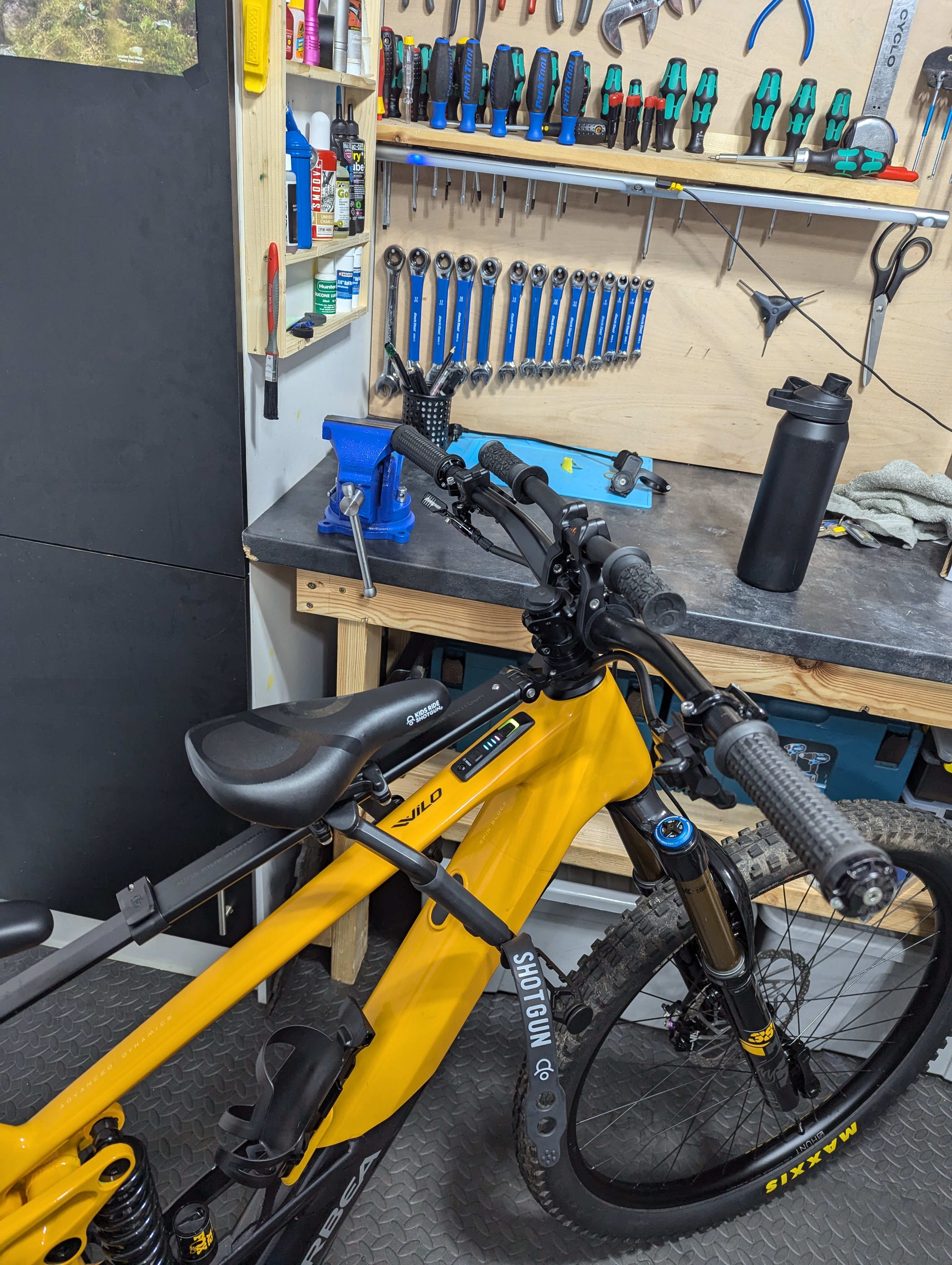

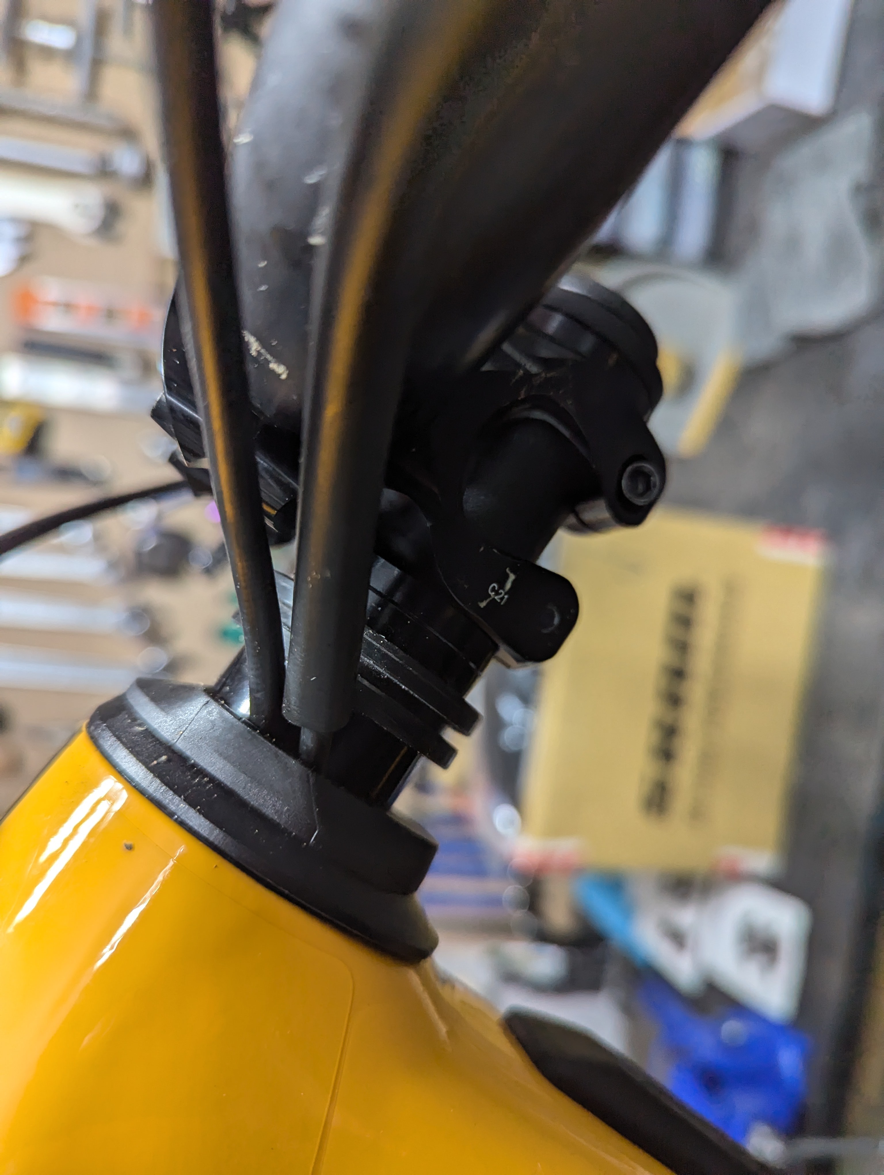

The Shotgun stem spacer wont work with the Orbea because of cable routing through the headset. I tried it, didnt work out for me.
Thanks very much for this. I definitely want an e bike to do some kids runs with so such a shame it rules this amazing bike out!
Yeti 160e here I come
Yeah as sad as it is, this was one of the reasons I sold my Orbea on. My kids absolutely love the Shotgun seat! There are ways around the frame/fork issue with crown spacers etc but it's just a faff swapping everything (for me anyway).
Enjoy the new ebike hunt. I went with a Heckler and won't look back 👌🏻
I use the kids ride shotgun seat with the Wild, you just need to add the universal headset adapter (SIC HS02-06).
Just be aware that the fork crown may hit the down tube on smaller frames. No issue on my XL.
Epic!
I was actually able to talk to local distributor and he assured me it can be done. Test rode it last Friday and ordering the 2024 model on run out special today!
I tried it with a non Orbea stem and the universal adapter and the bend of the hydraulic brake hose was to much. Also the brake hose was constantly rubbing at the shotgun when installed. This was a no for me.

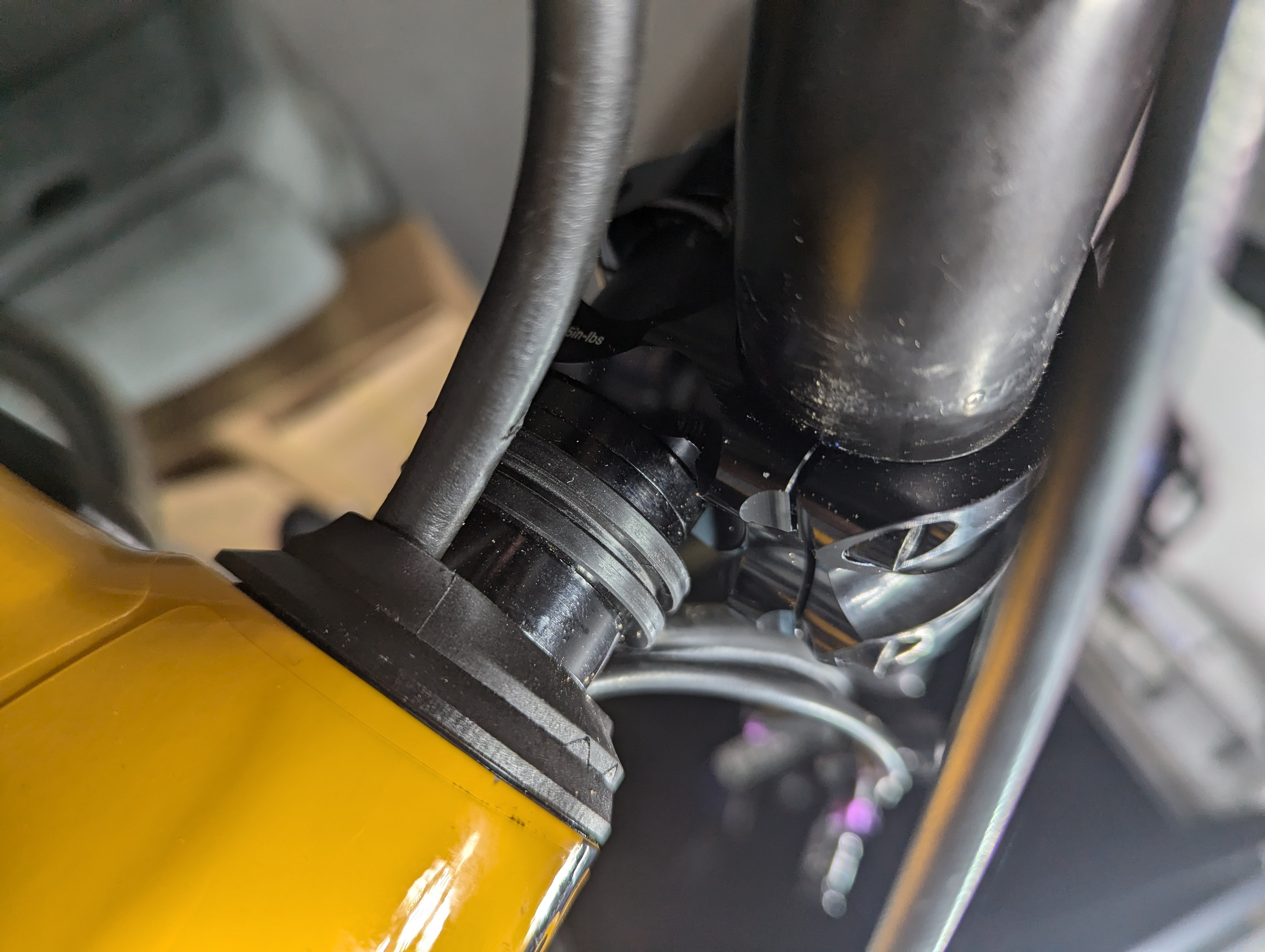

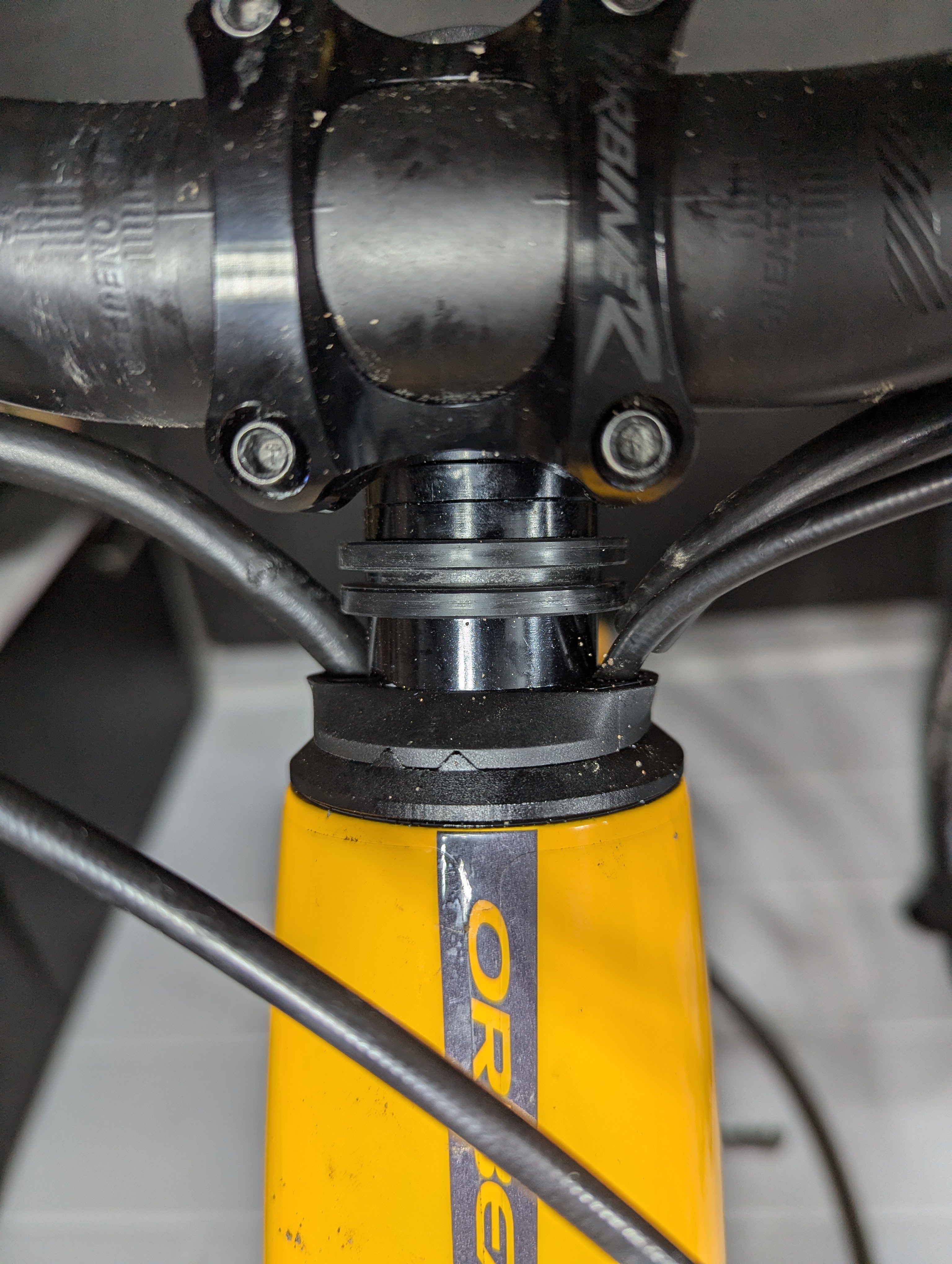

D

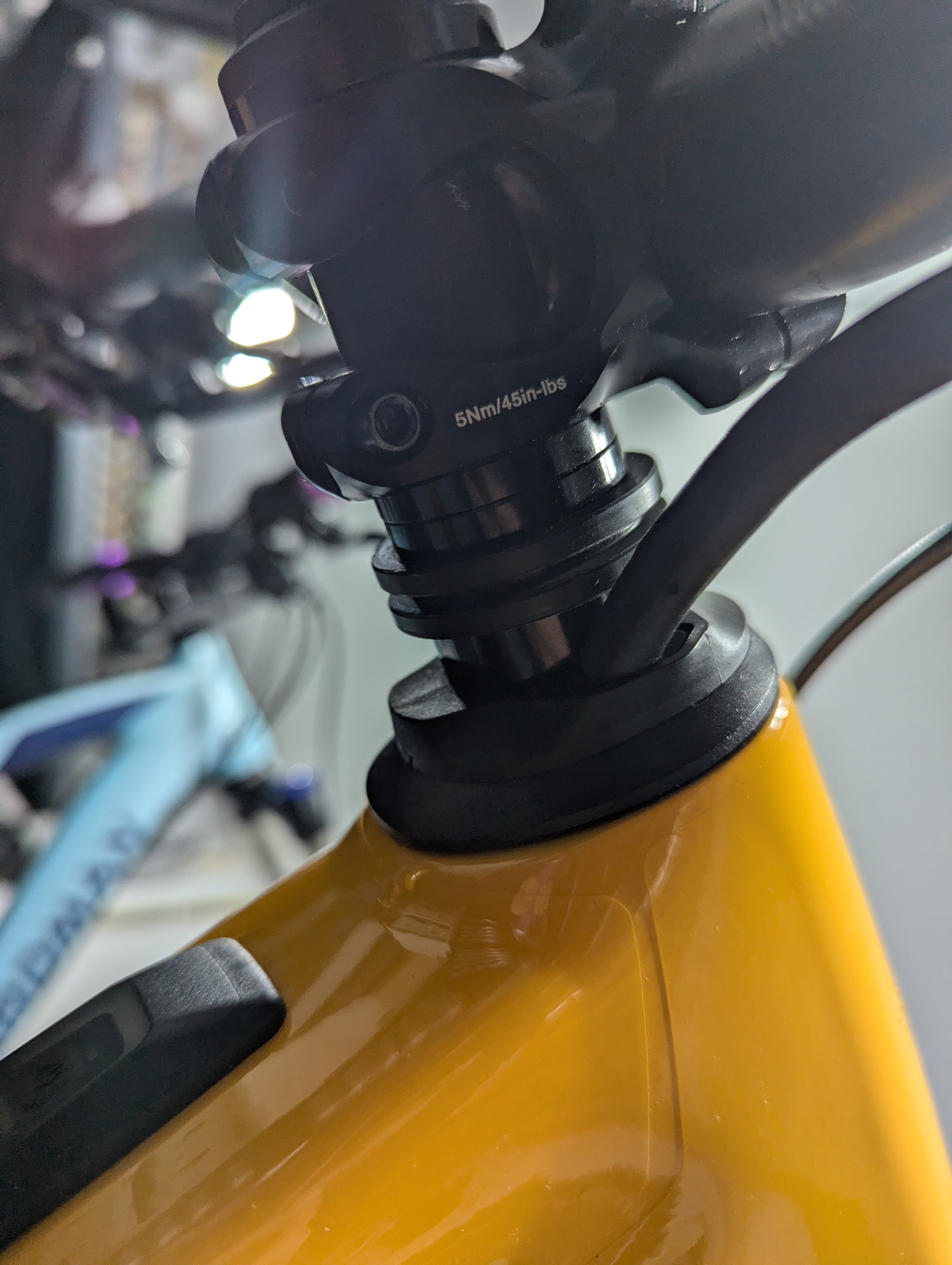

Do you have any other front on/other side shots please? Just so I can show the shop how you’ve routed it.
Here's some shots of close up of the spacer set up. You can probably lose one of the 5mm spacer if your stem is a little longer (mine is 32mm long and 35mm clamp) but I'm tall with nakerd hands so need the height! I also have foam on the cables so they wouldn't be as in the way if you don't.
Let me know if you need any more.

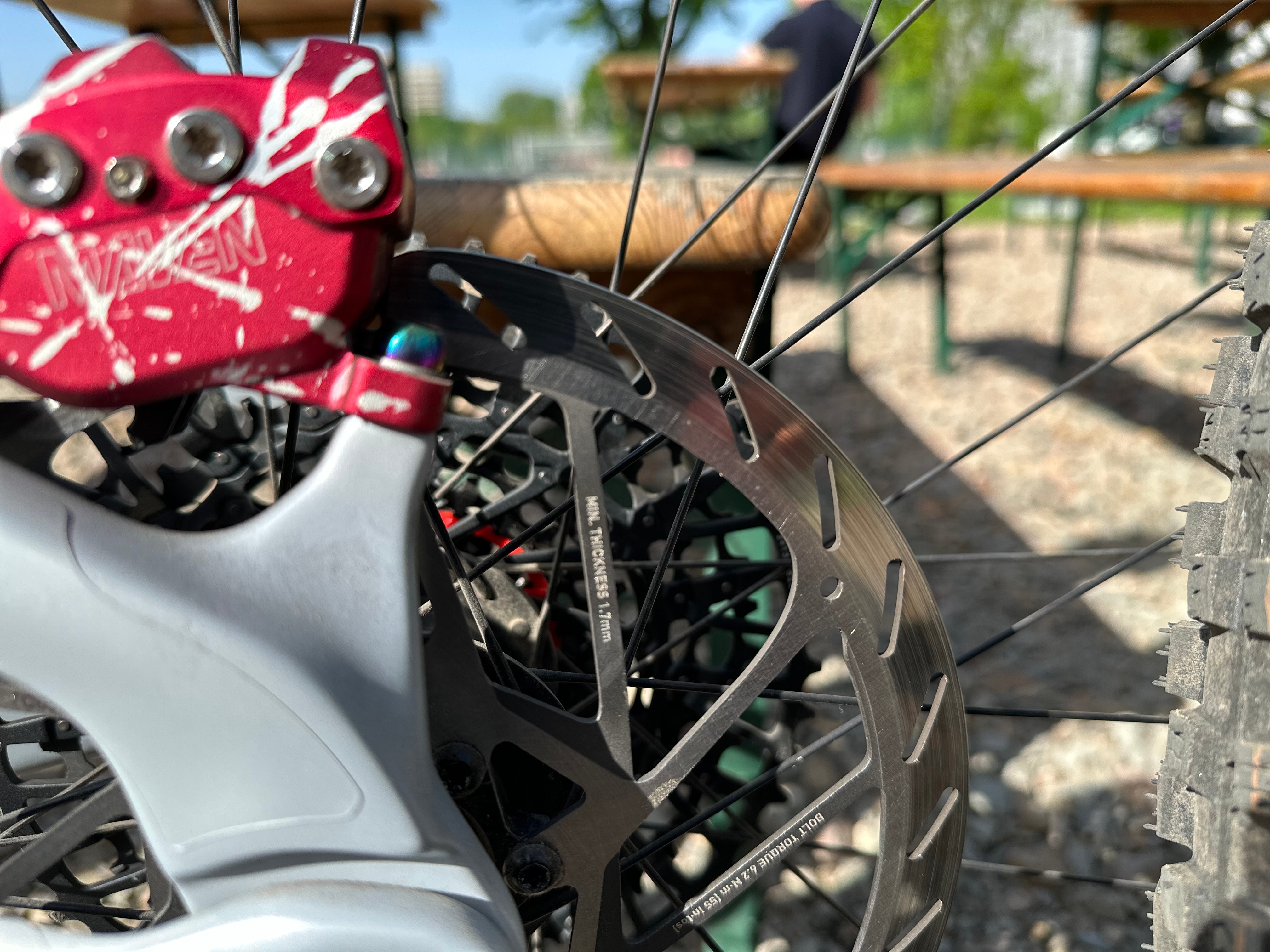

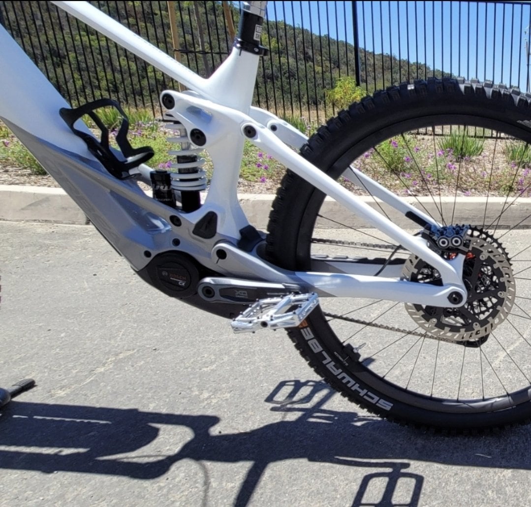

Is anyone running 200 mm rotors? I’ve just tried to fit one and seems that frame has 203 pm rear mount. This has to be one of the most annoying aspects of this bike. Basically you cannot run SRAM rear break without going for 220 rotors (correct me if I’m wrong).
Yep I noticed that the very top of my brake pads have a groove where they aren't being touched. I have a 23 H20 that came with DB8's and 200 mm rotors on both ends. Says in the manual it's 203mm minimum size rear rotors. Pretty crappy so ship the bike with the wrong sized rotors so they could get away with shipping budget brakes.
I bent one of the lever blades and turns out you can't buy just a replacement blade for a DB8, have to spend about $65 on the whole unit. Also since the lever is just cheap stamped and folded metal you can't really bend it back without it getting too far out of shape to re-mount
Ended up ordering some TRP DH-R's to try out. Will have fun figuring out how to route the rear hose. Saw some pointers online hopefully won't have to drop the motor and battery

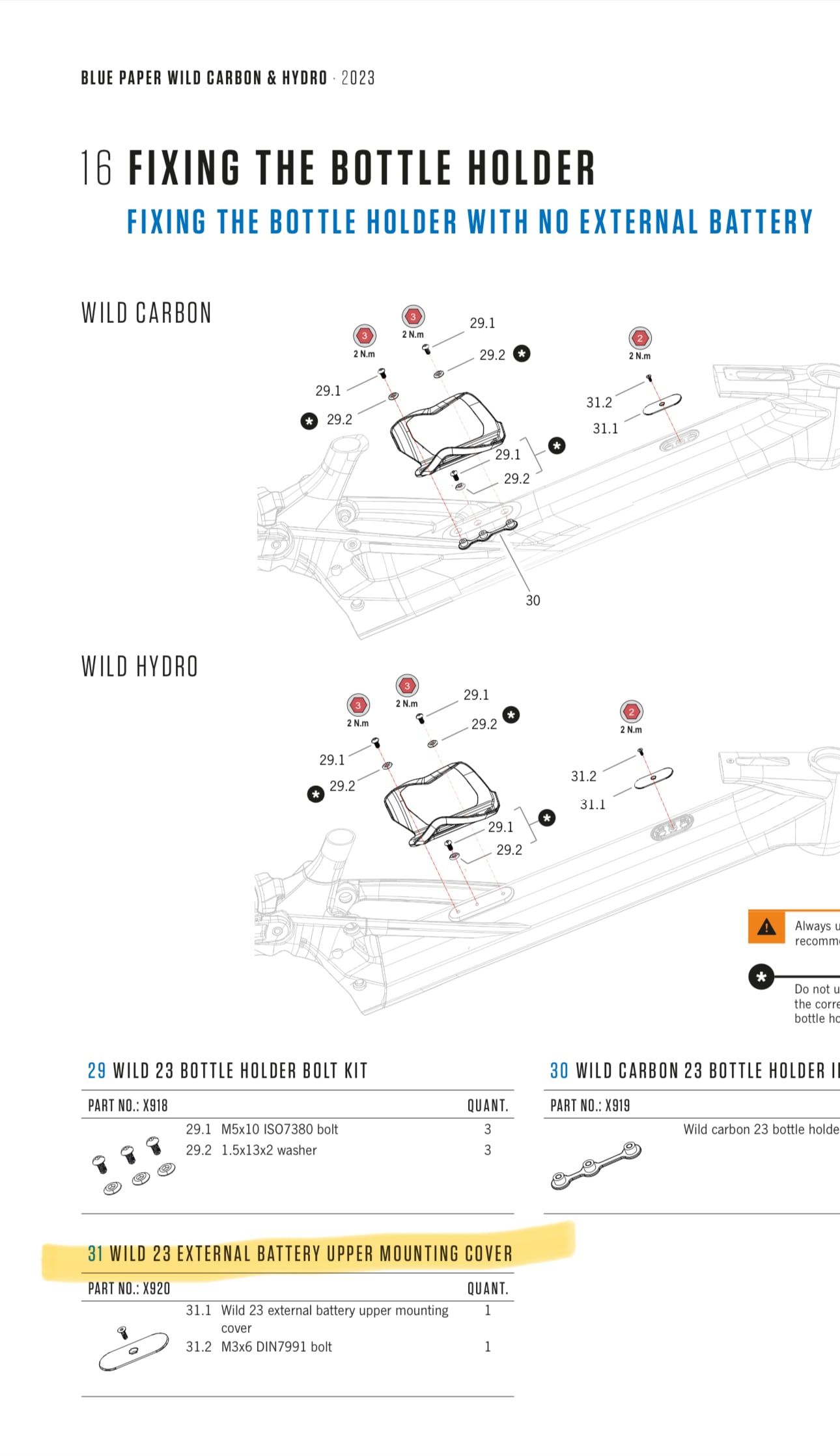

Any issues fitting the external battery with a DHX coil? I have just a cheap bottle cage but had to move it up from the top and bottom mounts to the top and center mount so the bottle doesn't rub on the reservoir.
I run a DHX2 coil shock and the external battery, you have to use the orbea powermore adapter plate which essentially moves the bottle cage bolts up a little to accommodate fitting the battery. I don't think it would fit without moving the bolts up.

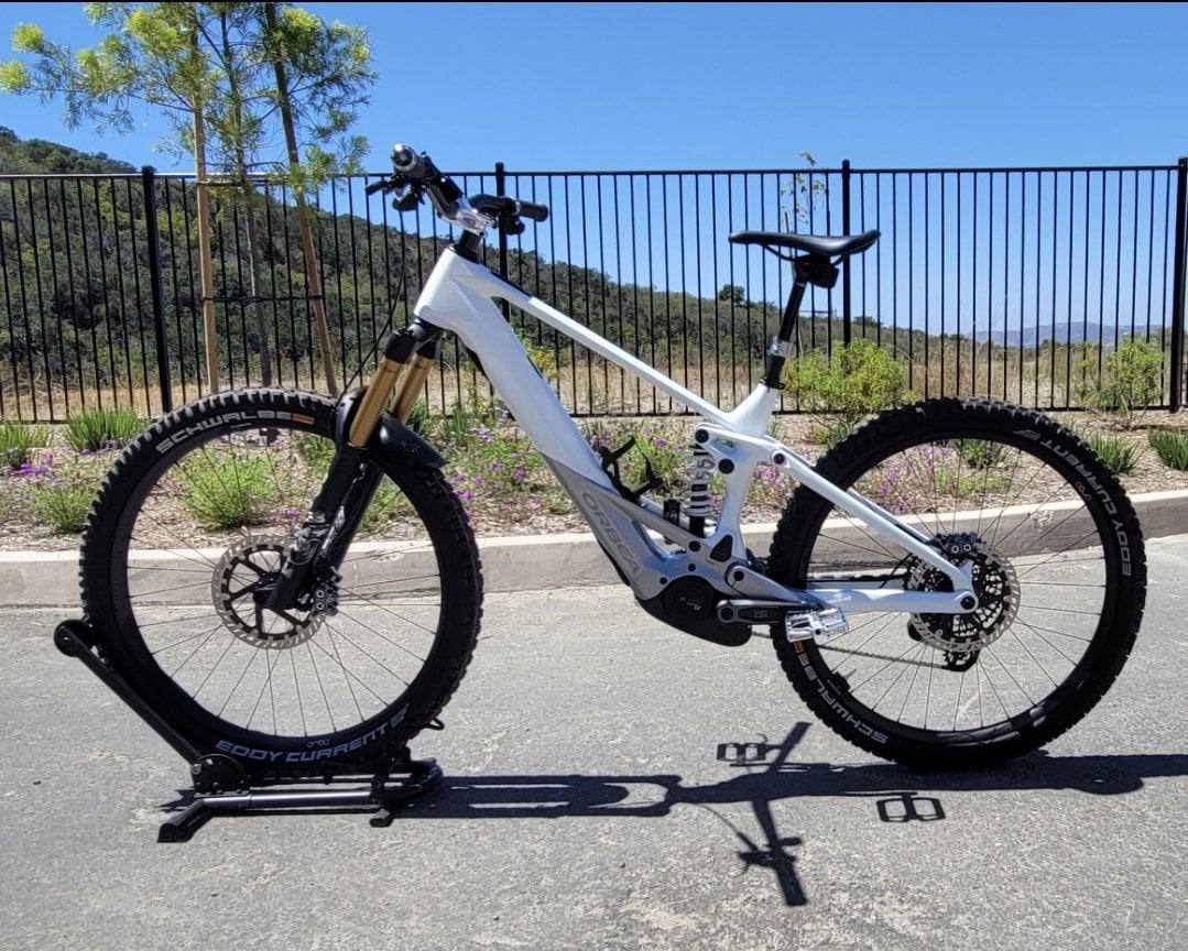

Ok, finally got around to making my long term review of the Wild. We all know the bike is amazing - but between FB & Forums, a few issues are always being brought up between spin block, shock fitment, and rear triangle issues on alloy frames. I speak to those and really dive into the spinblock and workarounds for folks. Hope you enjoy!
Now we have a reference for folks asking about fork damper clearance, spinblock parts, etc etc

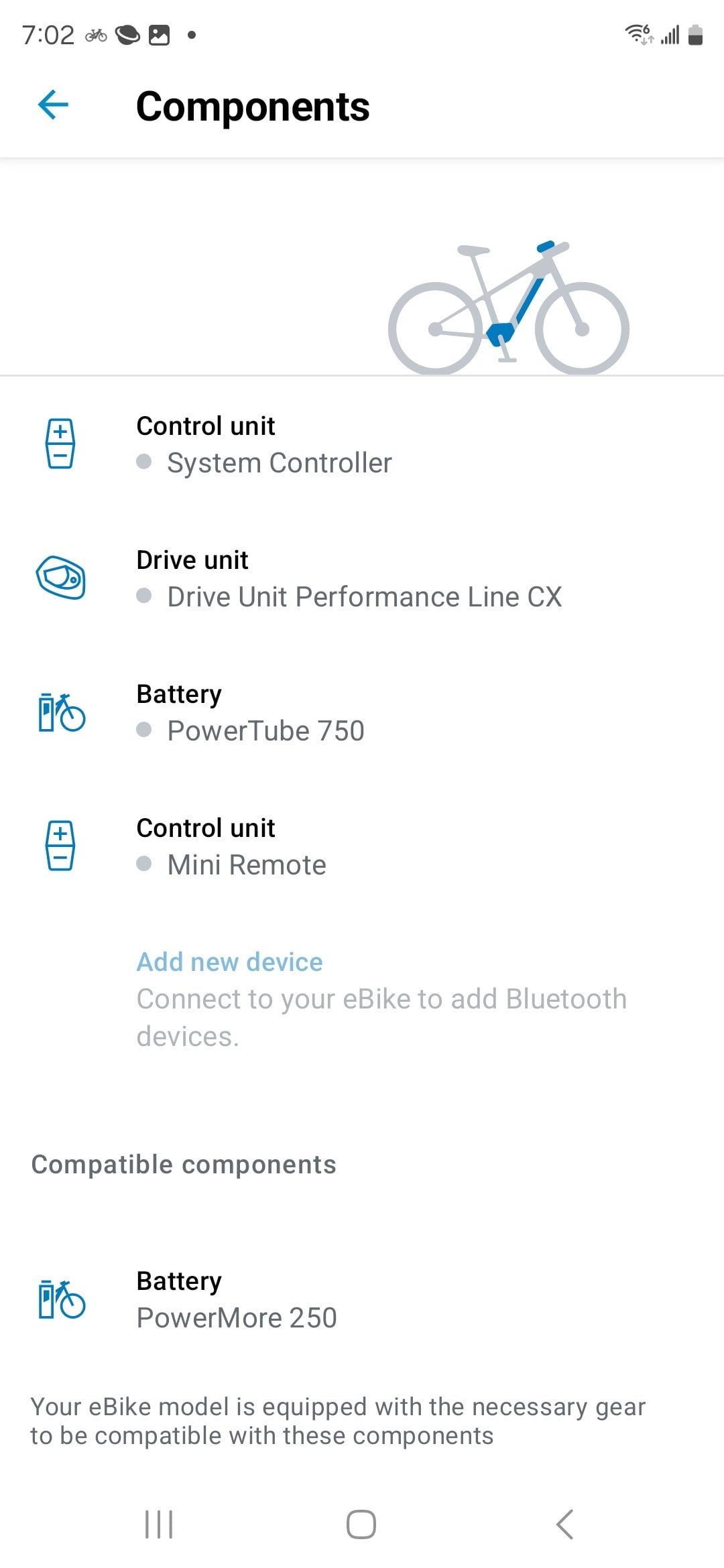

So I just purchased the PowerMore 250 external battery (live in US, had to buy from shop in Italy due to availability) along with the Orbea mounting hardware for my 2023 Wild.
Everything is due to arrive this week. Checked my Flow App and it shows the PowerMore Battery as a compatible component.
Hopefully I don't have any issues with battery being a Euro model and my bike is set up as a US.
Has anyone followed the same path or had any success with adding PowerMore 250 to a 2023 Wikd

From what I've read and a video review I watched , it pulls from both at the same time. Looks like if your main battery runs completely dry, you can connect PowerMore and even ride in boost.
The cable Orbea states to use in 300mm in length. From what I can tell, might be a little longer than you need. Think 200mm would be fine.
Once I receive my range extender and connect it, will post a follow up message on compatibility and how it performs.
