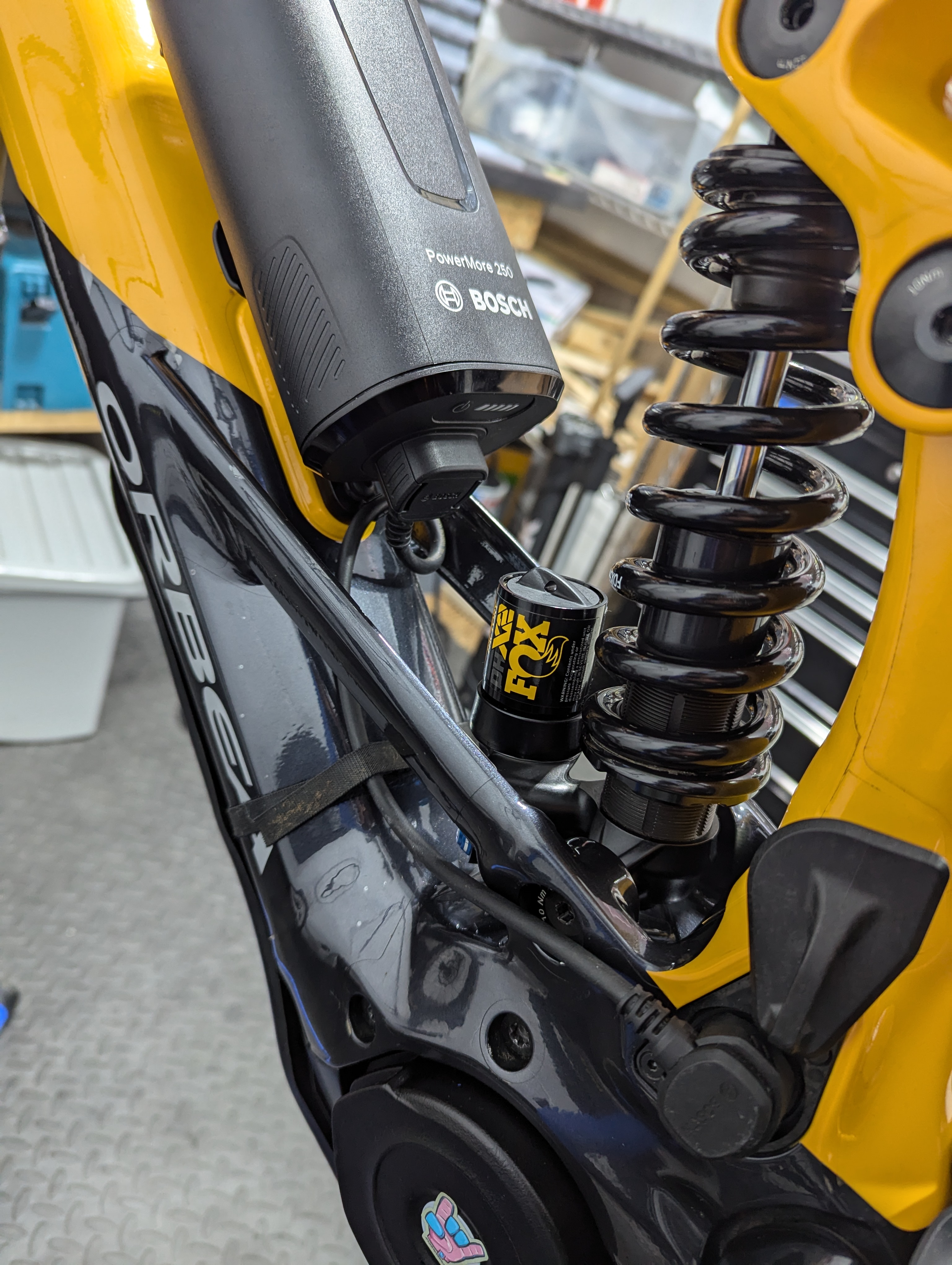

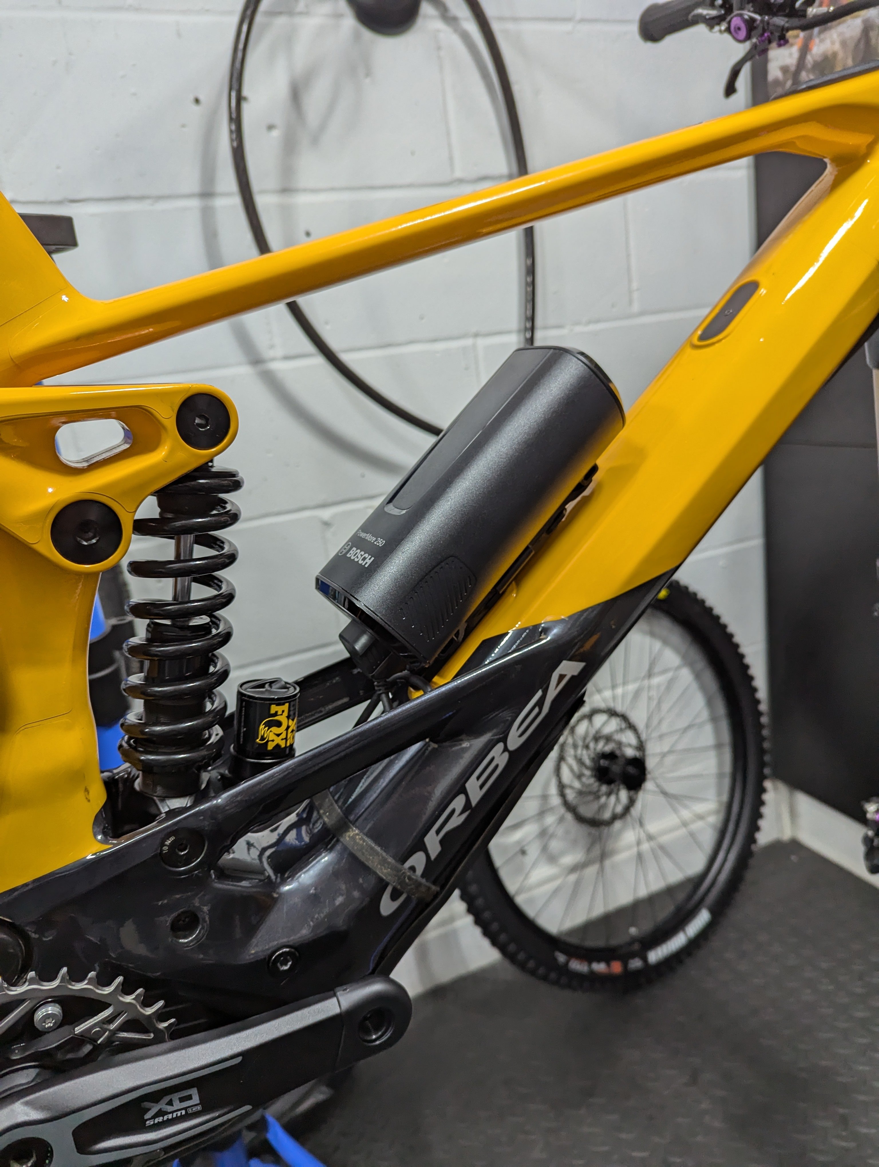

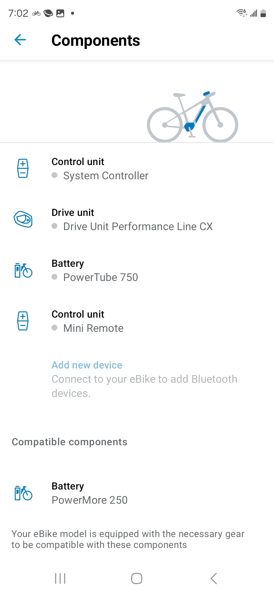

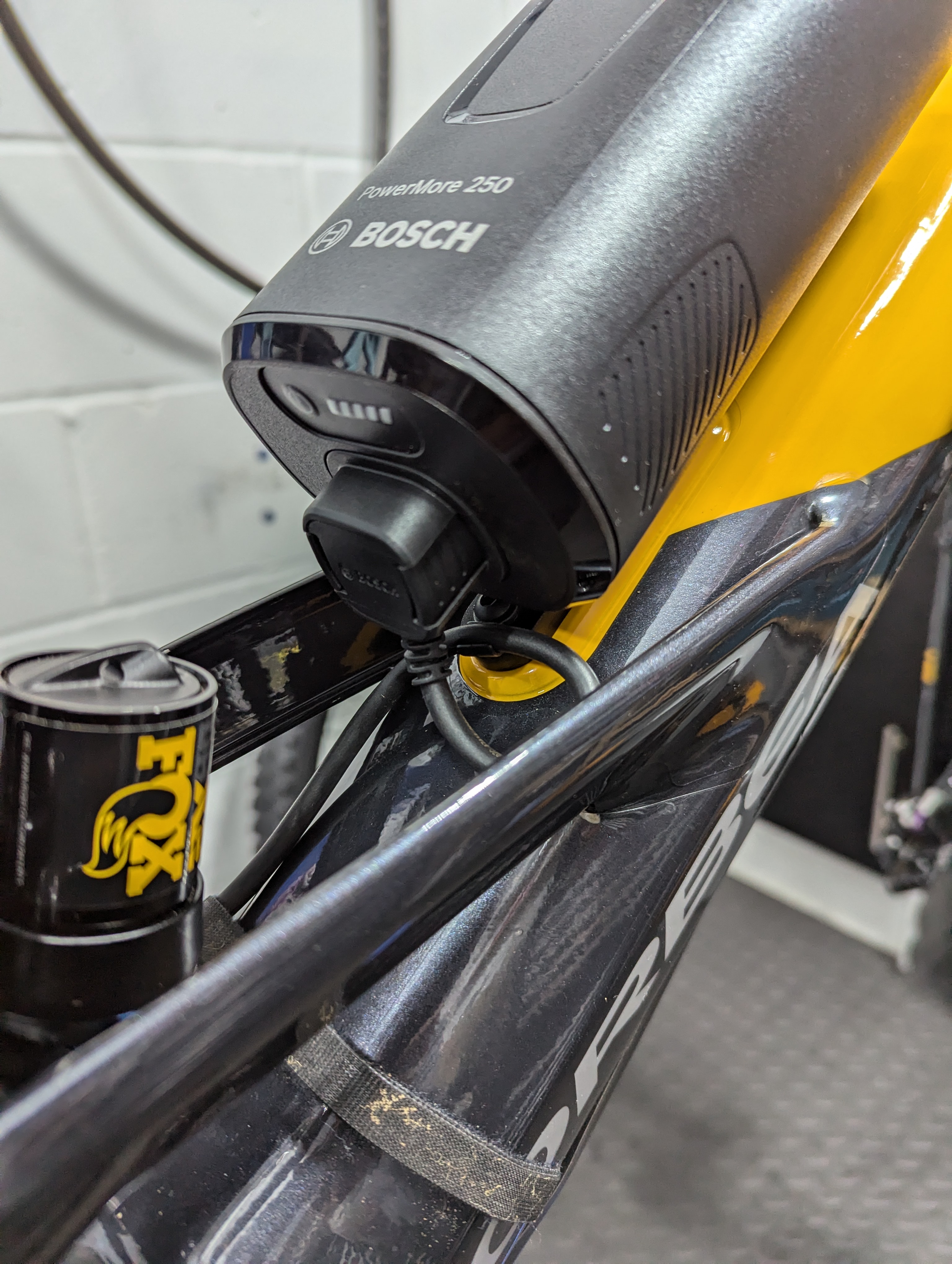

So I just purchased the PowerMore 250 external battery (live in US, had to buy from shop in Italy due to availability) along with the Orbea mounting hardware for my 2023 Wild.
Everything is due to arrive this week. Checked my Flow App and it shows the PowerMore Battery as a compatible component.
Hopefully I don't have any issues with battery being a Euro model and my bike is set up as a US.
Has anyone followed the same path or had any success with adding PowerMore 250 to a 2023 Wikd
I have a range extender, its big and heavy but works well. (well the 2 times I've actually used it) If I've burnt through my 750 battery, I'm usually knackered by then anyway lol.

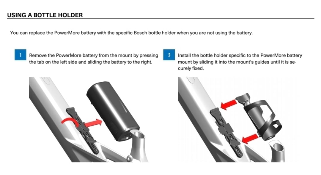

It is plug and play, but I had the hardware installed at the shop, (I don't think its any different??) the mounting system is cool though and comes with a bottle cage too.
Singletrackmind
Sep 17, 2020
477
435
San Diego, CA

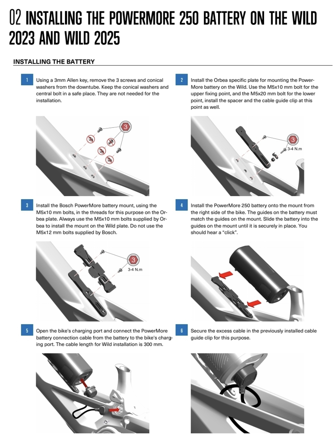

From what I've read and a video review I watched , it pulls from both at the same time. Looks like if your main battery runs completely dry, you can connect PowerMore and even ride in boost.
The cable Orbea states to use in 300mm in length. From what I can tell, might be a little longer than you need. Think 200mm would be fine.
Once I receive my range extender and connect it, will post a follow up message on compatibility and how it performs.
The Bosch PowerMore 250 arrived today from Italy and the Orbea mounting bracket from England arrived as well. Connected PowerMore to my Wild and it seems to work as hoped. The PowerMore was not recognized via Bluetooth as a connected component. You need to open Flow App and look for 2 battery icons to see if it's connected.
It came about 40% charged and I'm using same charging cable that plugs into Wild to charge the PowerMore and it works perfectly!
Going on an epic climbing ride this weekend that drained my Wild battery dry last time I rode. See no reason why I won't be able to get in many more miles.
Screenshot_20241125_191647_Gallery.jpg Screenshot_20241125_191711_Gallery.jpg
kntr
Sep 19, 2019
201
283
Pics!!!

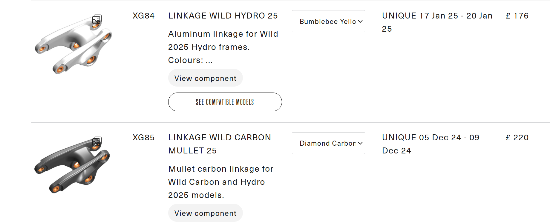

New 2025 links are available to order on the Orbea spares site.
Obviously only the 2025 Model is listed as compatible. Anyone want to test if this is true? I'm tempted to try the alloy link for an extra 10mm of travel, but its an expensive test!
It's a good question, looking at the specs I don't see anything that jumps out that says it won't at least fit, seems all the hardware in terms of bolts and bearings, etc. is the same as the 23, but don't see any specific measurements on distances between mounting bolts and what not.
Seems it calls for the same size shock as the 23, so it's going to put more leverage on the same amount of shock travel which may have more of an impact on handling than just having an extra 10mm. Which I would guess is a positive impact being more supple and reactive as it takes less force on the wheel to move on the shaft, but may need to compensate to prevent hard bottoms.
My gut says it will fit, but I don't know if there are negative outcomes in terms of overall geometry. Suppose you could reach out to Orbea, but it says in the manual to take it to a dealer if you just want to swap the 25 to the mullet linkage so I doubt they will be very helpful or will most likely just say no it won't fit, buy a new bike.
the hydro link is for 29, the standard link that comes on the bike.
carbon is for mullet-27.5.
that's what they told me.

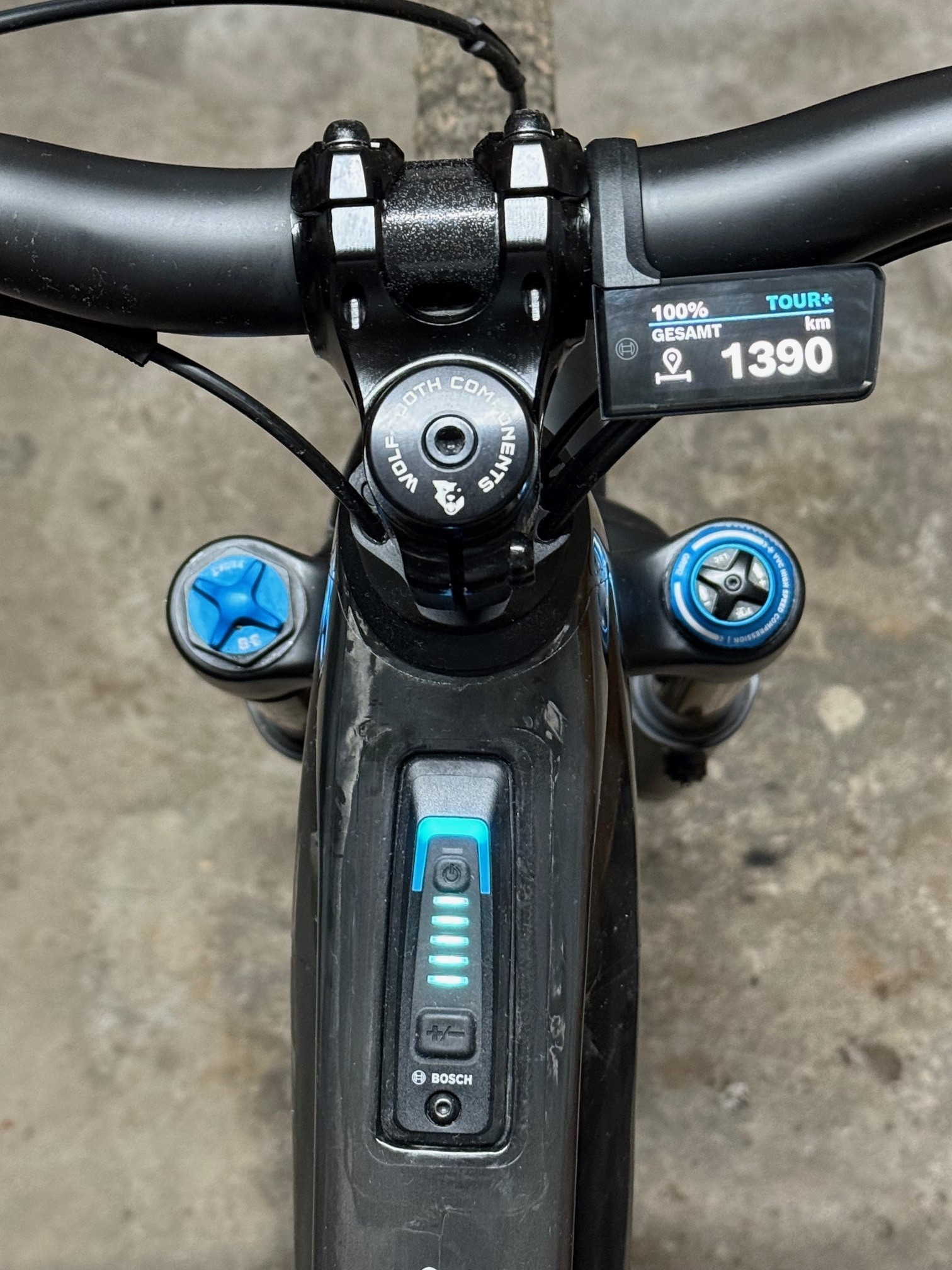

Anyone else having issues with the shifter being stiff? I my downshift is noticeably stiffer than on my other bike with the the same shifter (X01) and GX Derailleur and same issue with the stock Shimano setup it came with. I took off the motor guard so I could access the cable (but didn't drop the motor/battery) and removed the headset and got everything as free as I could also shortened the cable as much as I could to reduce any extra bends. Also put in a Jagwire "ultraslick" inner cable and it came with a Jagwire SL housing.
Not sure if there is much else I can do to remove kinks ie. drop motor and check if there is anything else I can do to help the routing, or if this is just the nature of this bike and I need to either live with it or go AXS. Just being harder to press the lever isn't a huge deal, but I think it's causing some issues not wanting to smoothly upshift in certain gears thinking the cable is being held a bit taught and overcoming the spring tension on the derallure.
Same here, I ride the same setup on my normal bike (XT derailleur, XT shifter etc.) and I needed significantly more thumb pressure on my Wild. It became so stiff that after one year the friction was so high that the tension of the derailleur wasn't enough to put the chain on the smaller cogs.
So last week I changed the OEM cable housing to an expensive Jagwire housing. Unfortunately all attempts failed to connect the new with the old housing and pull them through the frame so I had to drop the motor and I had to disassemble the whole headset. This was an absolute pain in the a** and I never buy a frame with headset routing again.
Now the shifting is way way softer, not perfectly soft like on my normal bike but also way better then when I received the bike. The reason for the resistance is the bend above and after the motor where the housing routes in the chainstay. In addition the OEM housing might not be the best one.
And since I had to drop the motor and disassemble the headset I installed the Bosvch Purion 400 display and this might be the best upgrade an my bike so far.

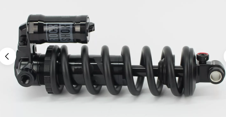

Sorry, I'm sure this has been asked before but I have recently picked up a Wild size medium 2024 model. Can anyone tell me if this particular shock fits the frame. It's a 205x65 Rock Shox Super Deluxe Coil Select R or would I be better off going with a Fox DHX2?
Also, in terms of spring rate, I am 76kg on a good day, is a 450lb spring the way to go?
