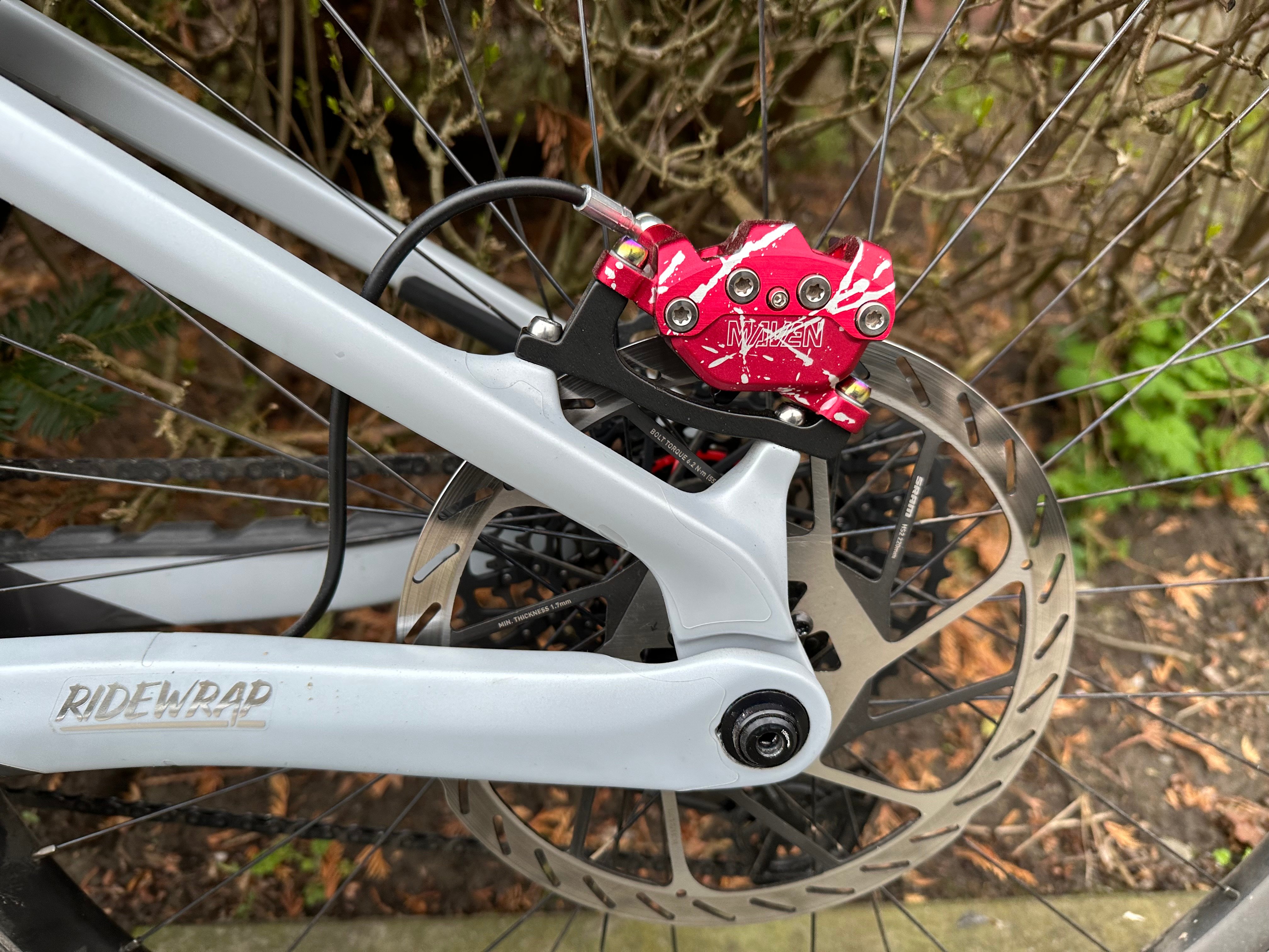

Is anyone a using a 220mm rear rotor/disc on the wild?
Installed one to my alloy Wild via a centre lock adapter and it too close to the frame. Unsure if it's the use of a center lock adapter or not.
They are slightly thicker 2.3mm discs, so that doesn't help either.
Yes I’m using SRAM HS2 220 on my Wild without problems - it is IS tho….

Is anyone running 200 mm rotors? I’ve just tried to fit one and seems that frame has 203 pm rear mount. This has to be one of the most annoying aspects of this bike. Basically you cannot run SRAM rear break without going for 220 rotors (correct me if I’m wrong).

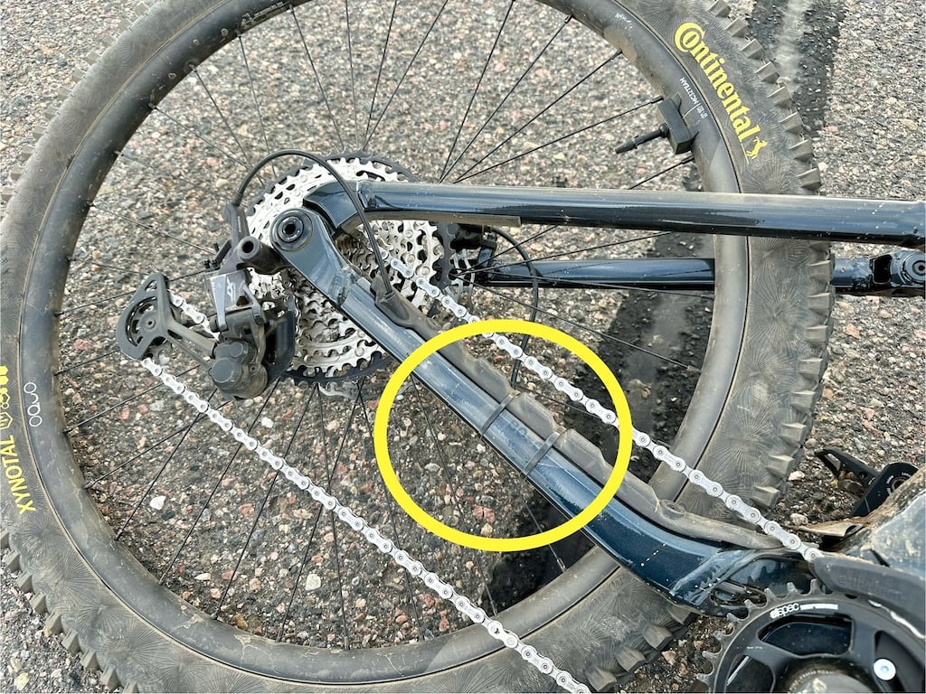

Like many on here, I have 100 miles on my Wild H10 and have cracked two motor covers. I wrote Orbea about my concern and their surprising response directed me to a aftermarket protector. Doesn't seem like they are very receptive to solving the problem.
On a separate issue...I was noticing a lot of noise coming from the motor area. After checking all of my bolts and doing some tapping around I noticed that on the aluminum frame they didn't put any adhesive on the chain stay protector between the screws. This caused the protector to slap against the frame when the chain hit it. A couple zip ties proved my theory. I'll go back and do a more permanent fix. Just a FYI to those chasing down annoying rattles.
I had a similar issue and I ended up putting some 3m VHB tape in between the frame and chainguard.

Any specific reason for 220 back since SRAM don't recommend it?
SRAM never said that they don’t recommend 220 on rear. I’m running 220 because it’s free power and it works perfect with Mavens. I would argue that there is no reason for going for the smaller back rotor.

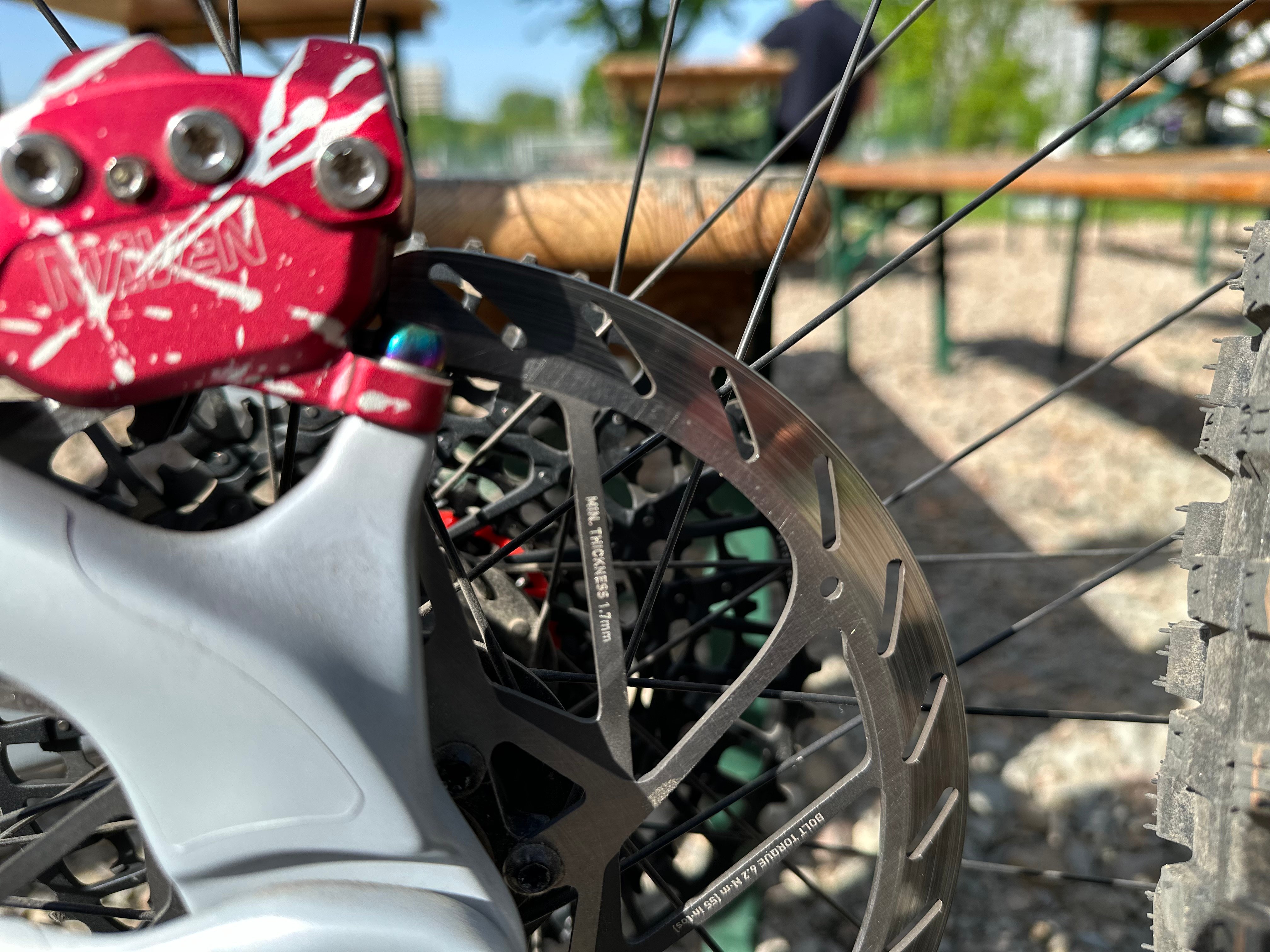

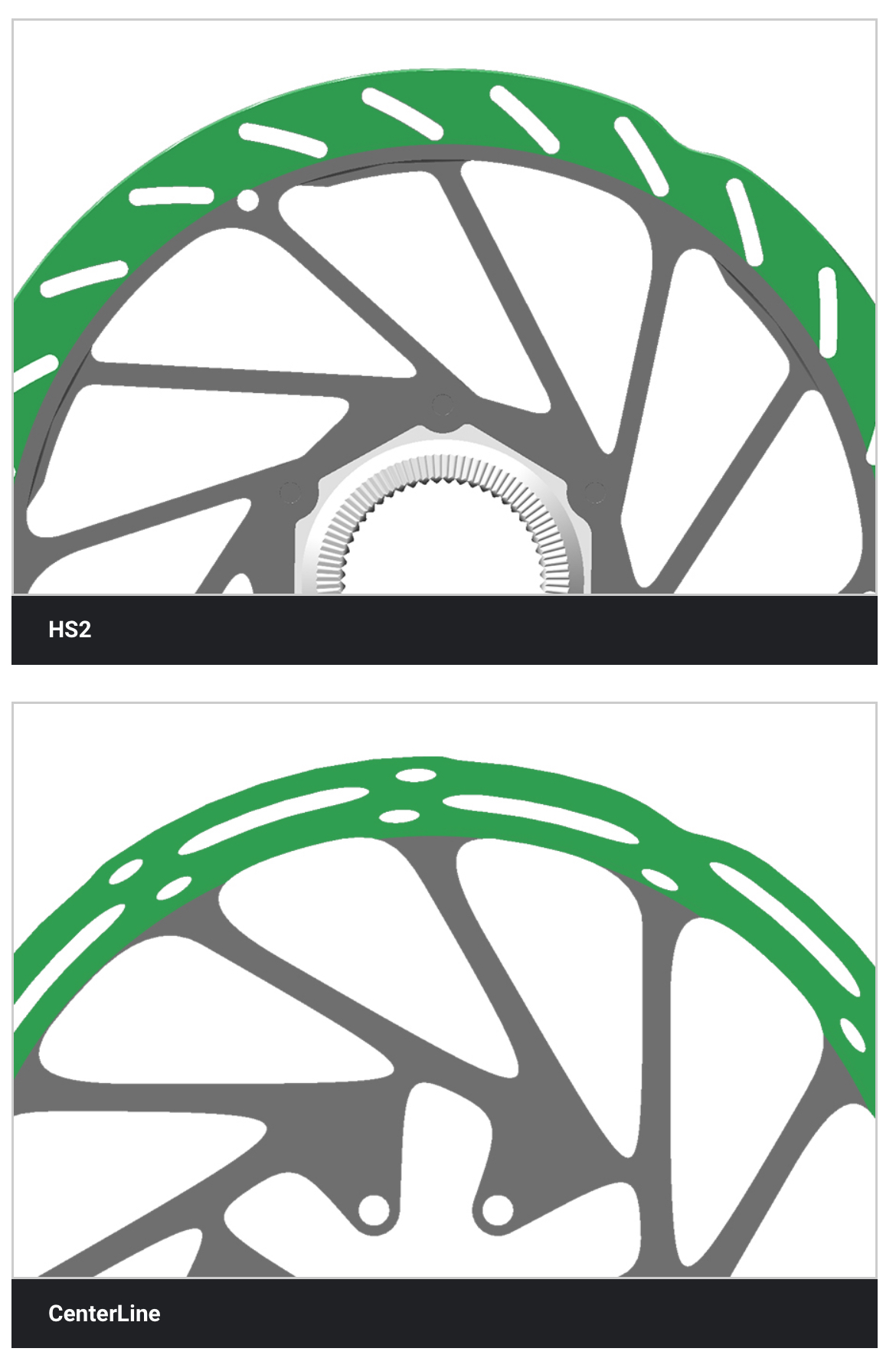

If you decide to run a 220 rotor on the wild you’ll need a +17mm Adapter not +20. You can see in the photo that the pads are not sitting at the bottom of this rotor.
I don’t see that much of a difference between front and back rotor wear when I look on them side by side. You are not supposed to have entire rotor area covered to. I realize that this is not ideal since you don’t have full pad coverage but SRAM 17p adapter doesn’t work with Mavens.

SRAM do recommend smaller rotors than normal so your argument is the opposite of what SRAM is saying but cool if you are satisfied with the size.
«For every 20mm jump in rotor size, the mechanical power increase is 14%. This means that going from a 180mm rotor to a 220mm rotor would boost system power by 28%. But too big of a rotor could also lead to not enough heat being generated, and a smaller rotor where the correct amount of heat is being generated could actually have more power on the trail. Paying attention to the color of the spokes on your rotors (below the pad track) can be a tell of how your rotors are performing.
-Browned or bronzed discoloring means the size is optimal.
-Purple or rainbow discoloring means your rotors are running too hot and sizing up would be suggested.
-No distinct coloring would suggest they aren't getting hot enough and sizing down would lead to optimal performance»

Where did you find this information running brakes at that temperature 230c+ to get that golden heat colour seams a little high
At SRAM website.
Maven with oversized callipers is developed a bit different than other brakes but of course if someone prefer (mostly for the look) big rotors it's up to them.
