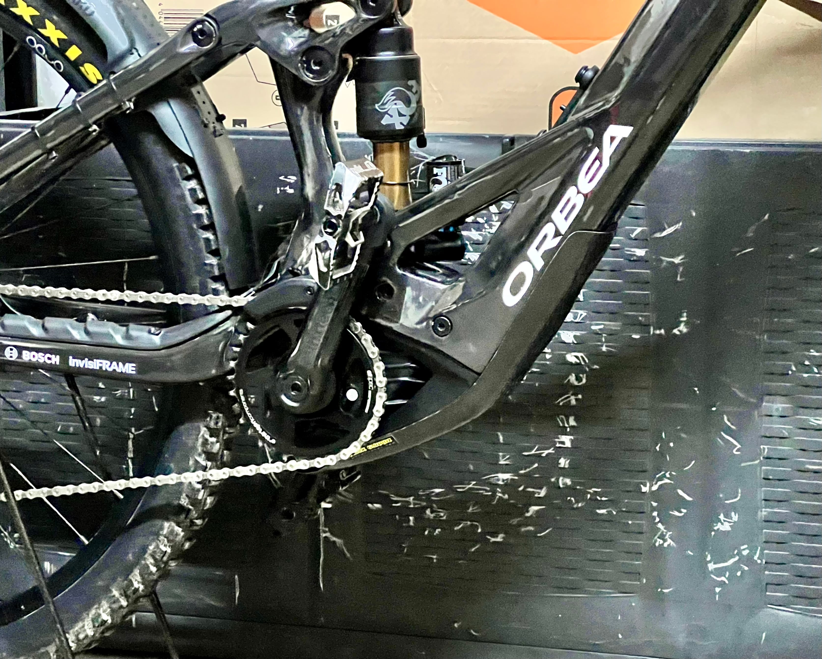

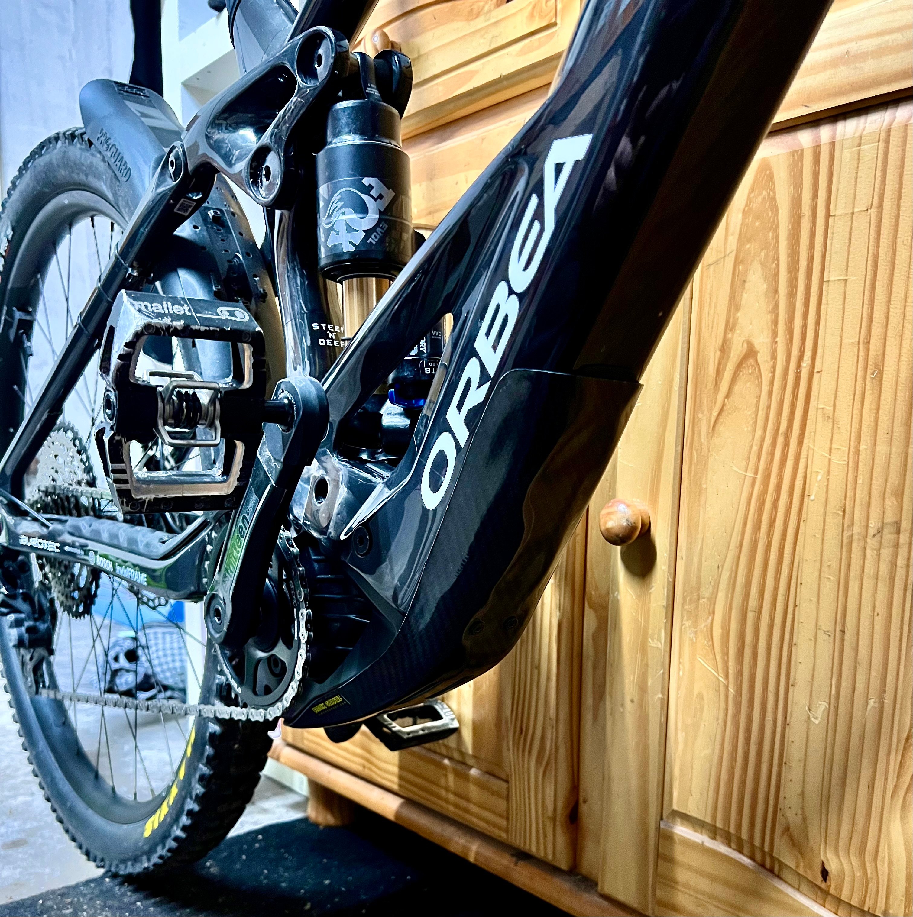

Another great ride on Sunday on the steep and loose trails round here, loving the Wild. Had the chainring lockring undo though. I had heard reports of them being loose from the factory but (foolishly) hadn’t checked mine as was just about to change it. Was stamping on the pedals when it came off and I nearly got ejected, thought the chain had snapped at first. Managed to bodge it just tight enough with a multitool as a drift and a large lump of chalk hammer.
Put an XX1 T-type chainring on yesterday and found two things – the spider assembly clashes with the Orbea chainguide, also looks like you can’t use a 104BCD chainring on a spider as that would clash. Also a Nukeproof ISCG05 chainguide (probably anything other than the Orbea one) won’t fit due to the shape of the carbon moulding around the motor. That’s why the top guide is longer than standard on the Orbea one, it mounts further forward than other types so has to extend backwards.
Anyone else come across the this and any suggestions for decent quality direct mount steel chainrings? The E13 one they come with is pretty cheapo and I was getting back chainsuck in Surrey Hills slop a few weeks back, sounded like a bag of spanners in the washing machine

I've heard you can run it without the guide no probs

I have been on my local trails as they aren't rocky but have dropped chains before on similar set ups on fast rocky trails with no top guide

I put on e-13 Helix cranks and Bosch specific chain ring. Zero problems and looks killer.

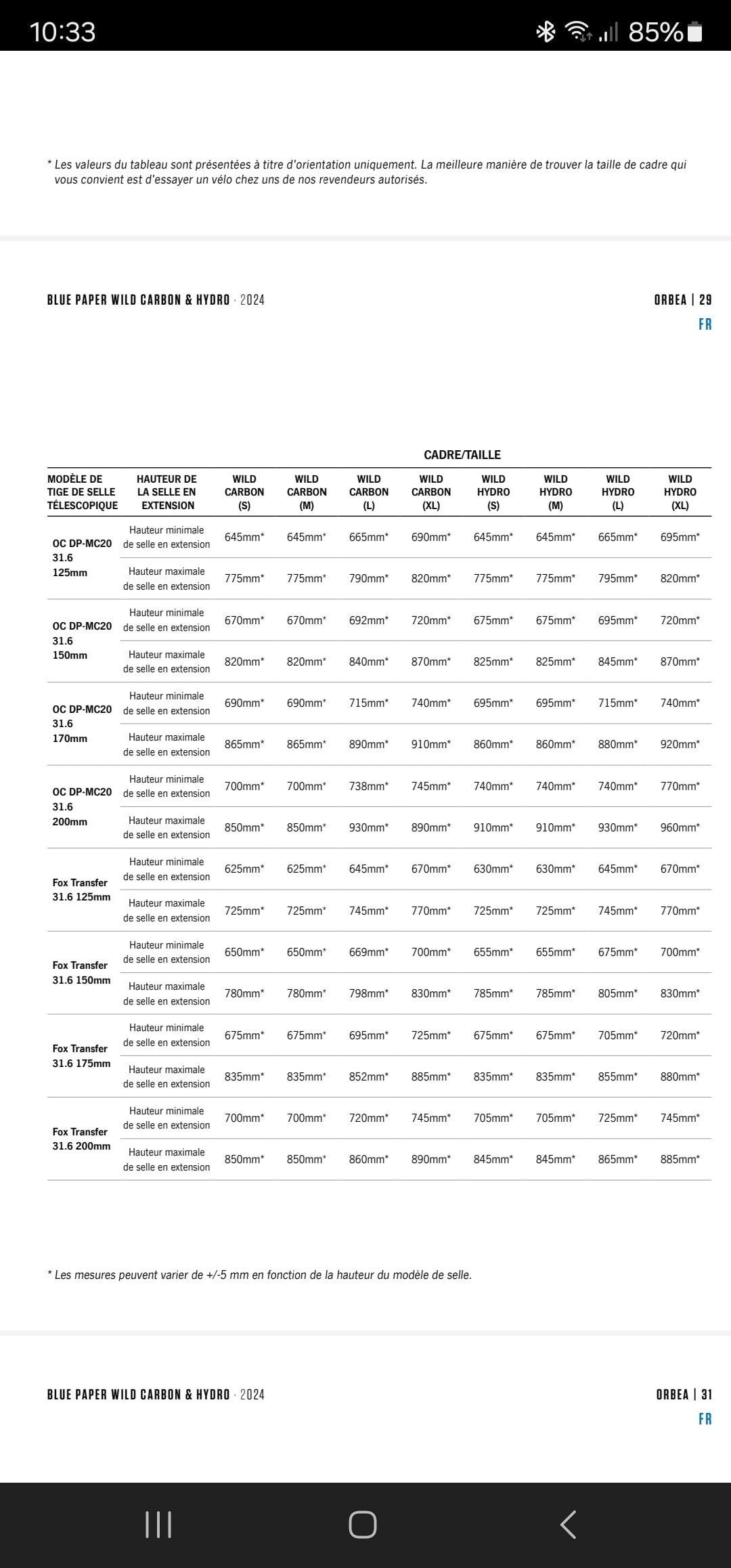

From the blue paper

Hi Mike.
The mechanics can change out the batteries in about 15-20 mins (they swapped mine from 750 to 625 at the trails. I assume that they will have mechanics at the pits and be able to swap out fairly quick.
Just did mine, took me 5 mins to get it out but a bit longer to get it back in, if the cables are to long especially the dropper post then its a pain. My only concern would be how many times you are undoing and doing the engine bolts up. Was thiking of trying to get a 500w in there for racing.

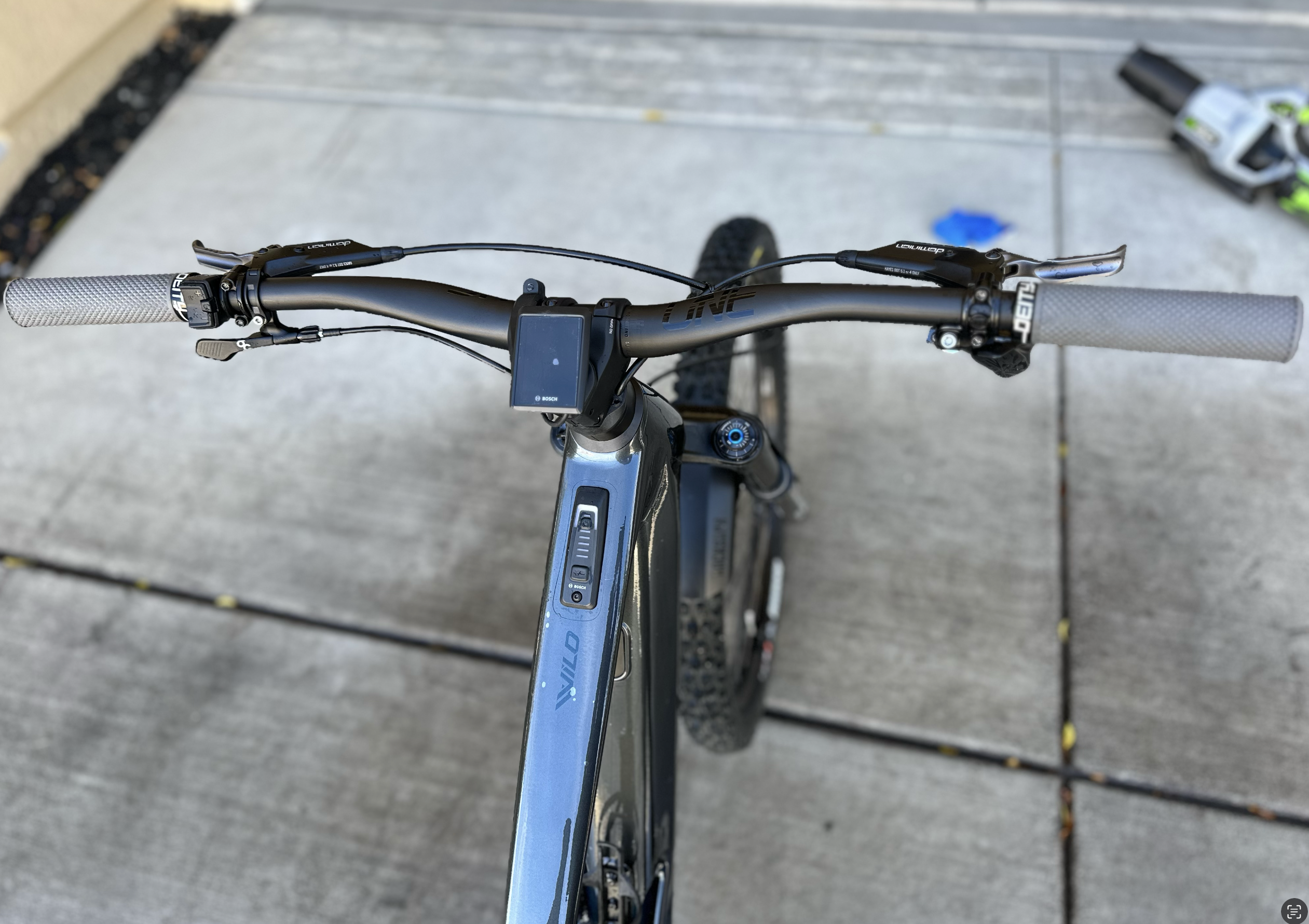

Recently picked up my 2023+ Wild H10! Upgraded a few things through my LBS:
  • RS Zeb Ultimate 170mm
  • Hayes Dominion A4 Brakes
  • SRAM AXS GX shifter
  • 170mm dropper
  • OneUp carbon E-bar
  • DH casing tires
  • Kiox 300 display. Not sure if I'll keep the display or not - I wish the Bosch "smart" system would connect to external devices like Wahoo/Garmin etc. I may just want a completely clean cockpit and stick my wahoo in my fanny pack (lol) View attachment 131187
I didn't realize how limited fitment for rear shocks is, but I guess It makes sense with the frame design. I had a RS SuperDeluxe coil I wanted to throw on but I read on multiple forums (including this one) that it will rub the frame. Oh well, the Float X will do for now - I'll explore that later. It's just so fun to ride already! I do enjoy the headset routing for a super clean cockpit.
The only thing I may want to upgrade soon is going to 220mm rotors + a new dropper lever to go with the matchmaker setup.

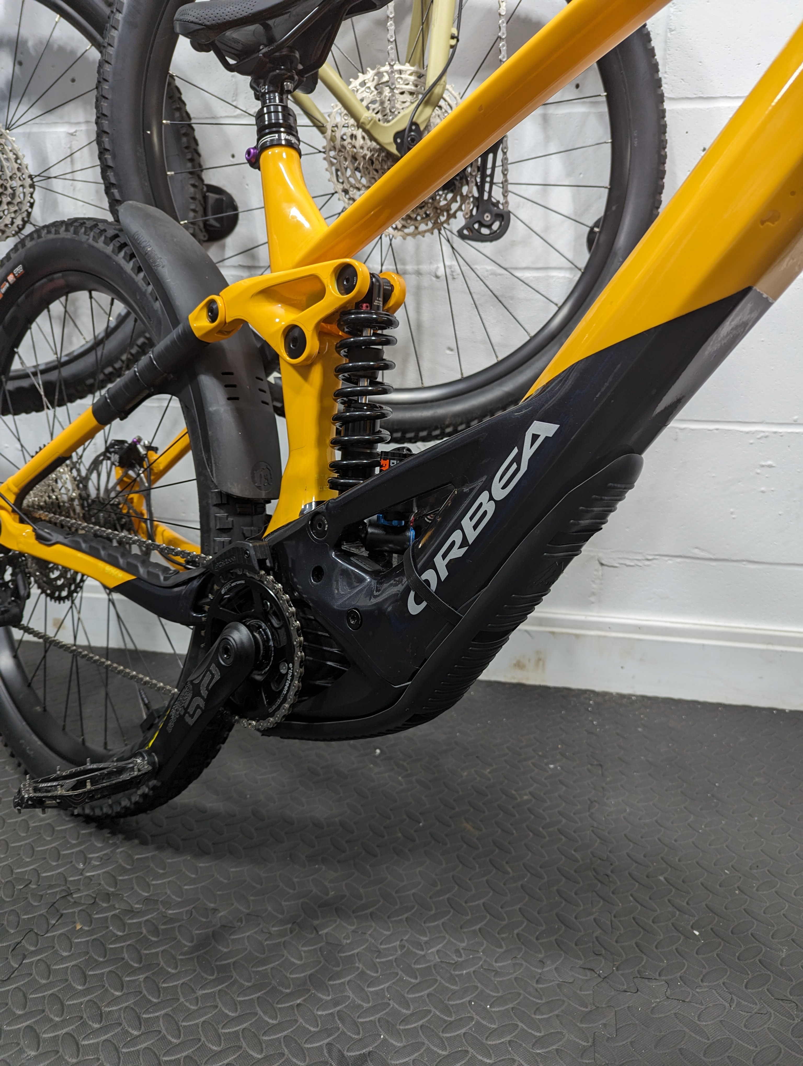

Like many on here, I have 100 miles on my Wild H10 and have cracked two motor covers. I wrote Orbea about my concern and their surprising response directed me to a aftermarket protector. Doesn't seem like they are very receptive to solving the problem.
On a separate issue...I was noticing a lot of noise coming from the motor area. After checking all of my bolts and doing some tapping around I noticed that on the aluminum frame they didn't put any adhesive on the chain stay protector between the screws. This caused the protector to slap against the frame when the chain hit it. A couple zip ties proved my theory. I'll go back and do a more permanent fix. Just a FYI to those chasing down annoying rattles.
