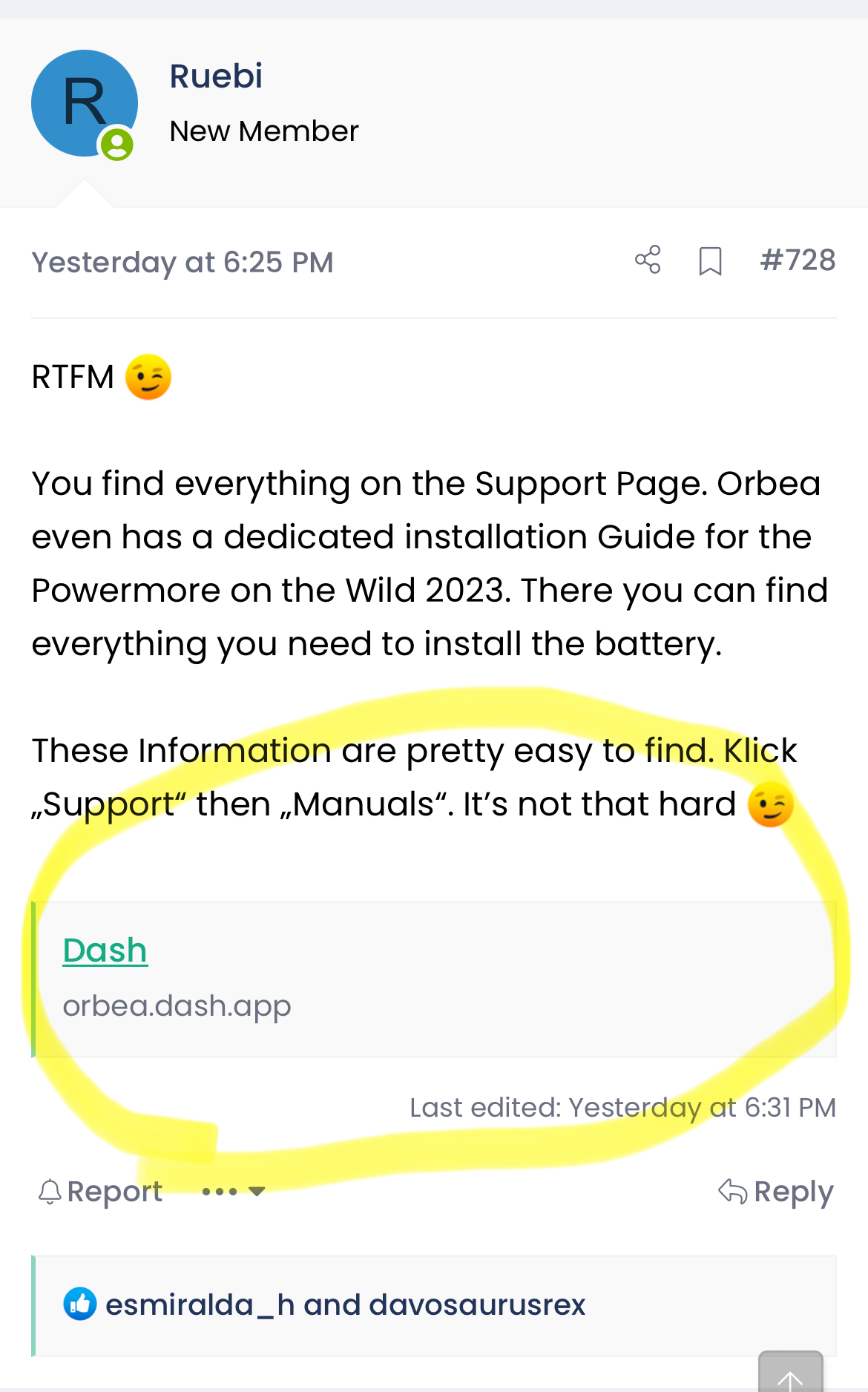

RTFM ;)
You find everything on the Support Page. Orbea even has a dedicated installation Guide for the Powermore on the Wild 2023. There you can find everything you need to install the battery.
These Information are pretty easy to find. Klick „Support“ then „Manuals“. It’s not that hard ;)

You know what else is not hard? Posting a link. :) Thanks. Ill check it out. Found it.
300mm cord is needed
Ruebi
Jul 17, 2023
31
41
Heidelberg
I did.

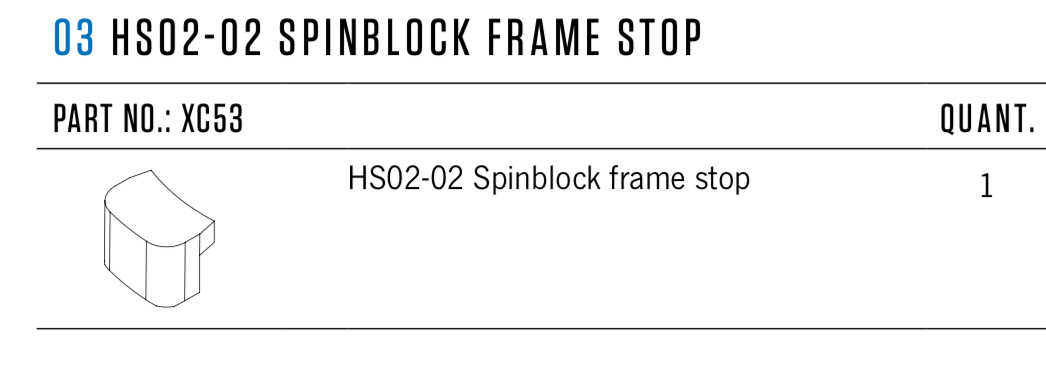

I changed the Orbea stem/spacer to a regular "non-spin block" stem with round spacers. Do I have to remove the frame stop? The bluepaper isn't clear about this.
I tried it with the frame stop in the headset but I had some issues when rotating the bars over the former blocked position.
Durrti
Aug 22, 2021
162
164
California
You don’t have to remove it, I left mine in to potentially help keep the forks from the down tube in a crash.
pdqmach26
Jul 31, 2023
Laguna
I just installed a regular stem, Raceface Turbine. Removed the spin block frame stopper but I do have an XL frame
Ruebi
Jul 17, 2023
31
41
Heidelberg
Thanks! With the L frame and the Fox 38 there is also no real contact. The rubber downtube bumper slightly touches the high speed compression dial and opens it by 2 clicks. ;)

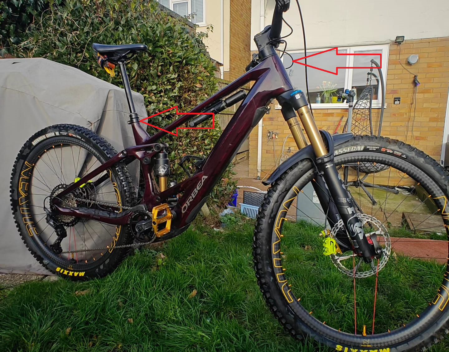

Hi all, I wanted to shorten the dropper cable as it sticks out past the bars and it annoys me, so I took the lever off and started to try and pull through the cable from the seat post end. It really doesn't move very much, has anyone taken their post out? seems like it's stiff past the battery/motor, last thing I want to have to do is drop the motor, just to take a few MM off a cable. (and if I have the post out, it would be rude not to upgrade the seat clamp, what size is it?)
mrplaff
Aug 10, 2023
Norge
Did you remember to remove the end cap, because I didn’t! A good pull fixed it though, end cap came out once I turned the bike upside down.
Edit: I removed mine entirely for AXS Reverb, so perhaps not relevant to your predicament.
Bigmike
Dec 4, 2021
33
37
Cornwall
Your best bet is undo the cable and remove the crimp from inner wire pull the seat post out along with the inner wire trim the outer to length use a new inner wire and thead it to the outer down the seat tube this is a bit tricky once the inner is trough connect to the dropper and pull the inner wire while guiding the post in,
VWsurfbum
🤴King of Bling🌠
Jan 11, 2021
1,580
2,340
England
Trouble is the cable doesn't move to pull it through to pull the inner cable free.
Bigmike
Dec 4, 2021
33
37
Cornwall
Don't need to touch the outer cable just remove it from the dropper lever and remove the crimp undo the seatpost clamp and put it out with the seatpost then trim outer casing at the bar end refit seatpost with new inner cable
VWsurfbum
🤴King of Bling🌠
Jan 11, 2021
1,580
2,340
England
I'll try that tonight!
Bigmike
Dec 4, 2021
33
37
Cornwall
If you tape it before cutting, it won’t fray. Be sure to add a crimp before it does.
Try taping a inner cable the pulling it through the outer and let me know how it goes once it's clamped and crimped it very difficult to get in to feed back though the outer far easier to replace the inner wire
