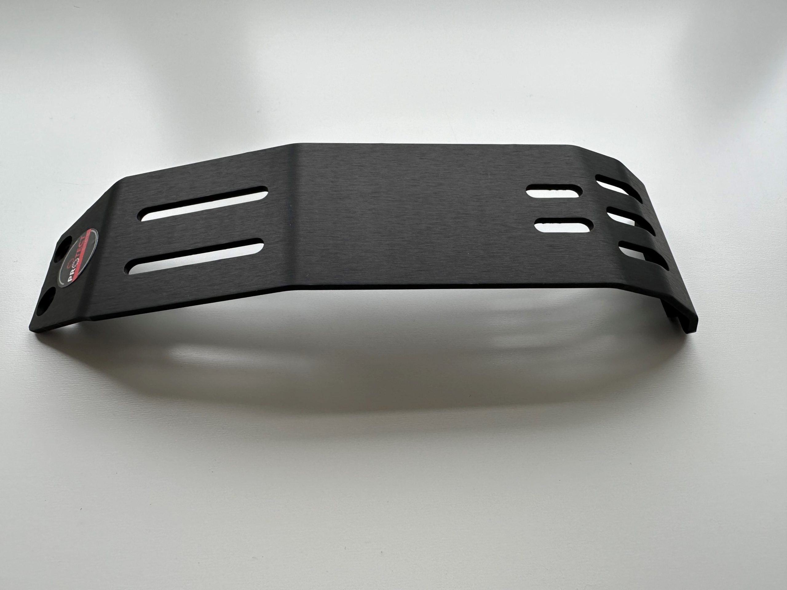

So, yesterday I cracked the motor cover in 2 places when I was a bit to optimistic crossing a fallen tree : ( .
I'm actually surprised it lasted this long, given how many rock hits I've had lately - but it is a pretty stout piece of plastic. A spare Orbea part is 29,95 € which isn't totally unreasonable. But still. I'm wondering if anyone has tried the aftermarket offerings? So far I've found:
ilten
Oct 22, 2023
7
My thoughts so far: The AVS looks promising. Ok, I bend parts like this on a dayly basis at work. using cnc brake presses so I might be a bit biased. I'm tempted to (and probably will) make one myself. Only drawback I see, it really doesn't look nice on the bike. The angular looks and the gaps are not aesthetically pleasing to my eye on the flowing form of the Wild frame.
The Rockguardz looks good - but is just a piece of carbon fiber slapped over the stock guard. I wonder how much better it'll hold up to impacts? I would much prefer a complete copy of the original piece in carbon.
The protect bash plate is the same idea in aluminum. Has anyone used this?
I've ordered some carbon fibre mats and epoxy last night. I'll try to beef up/repair the original part with a layer or two of carbon fibre and see if it'll hold up.
I've been abusing a P3 carbon skid plate on my KTM EXC F for years. I wish I could find something similar for the Wild.
