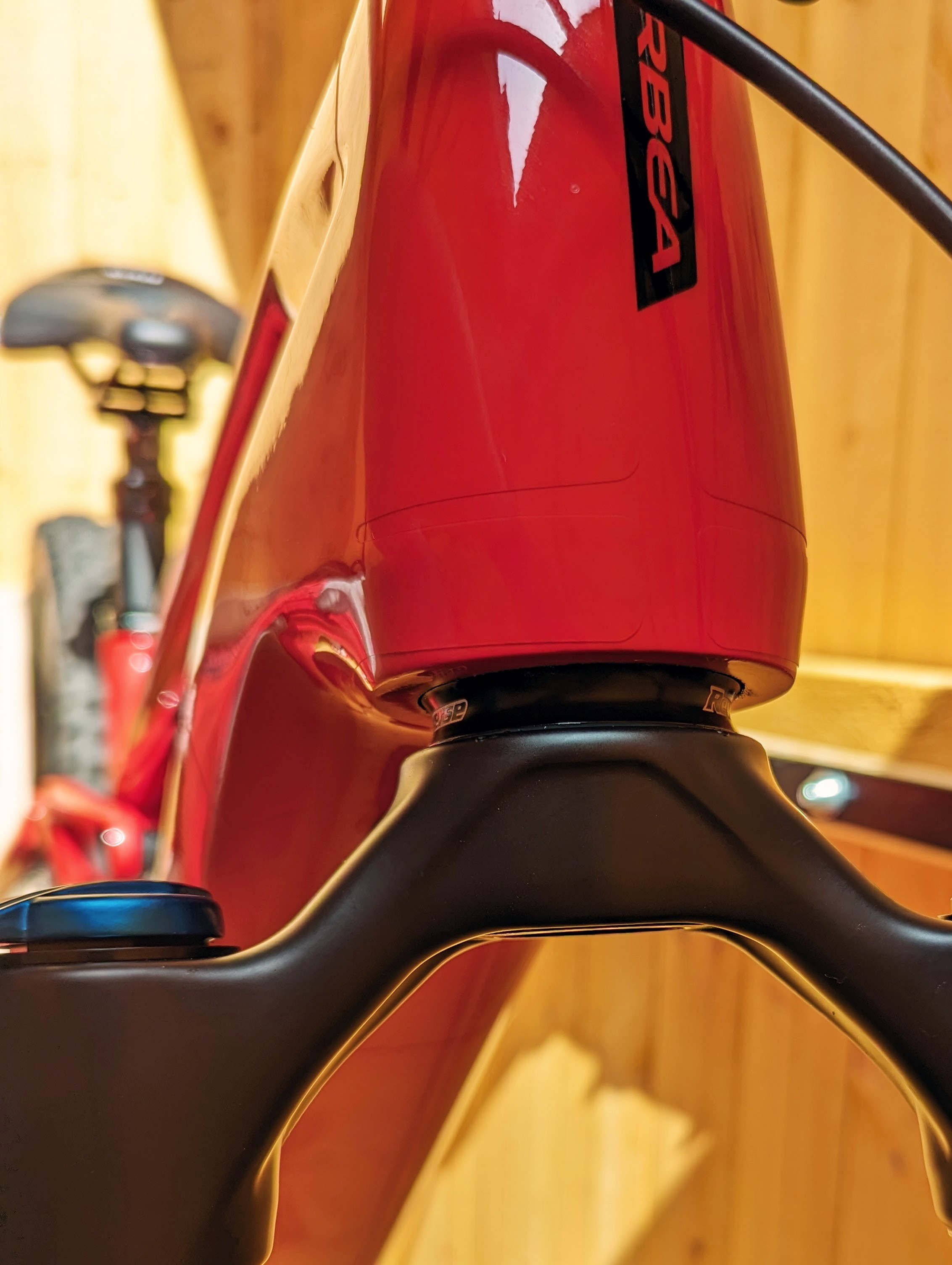

Nice, it's such a pain in the arse and it's the only thing I truly dislike with the bike!

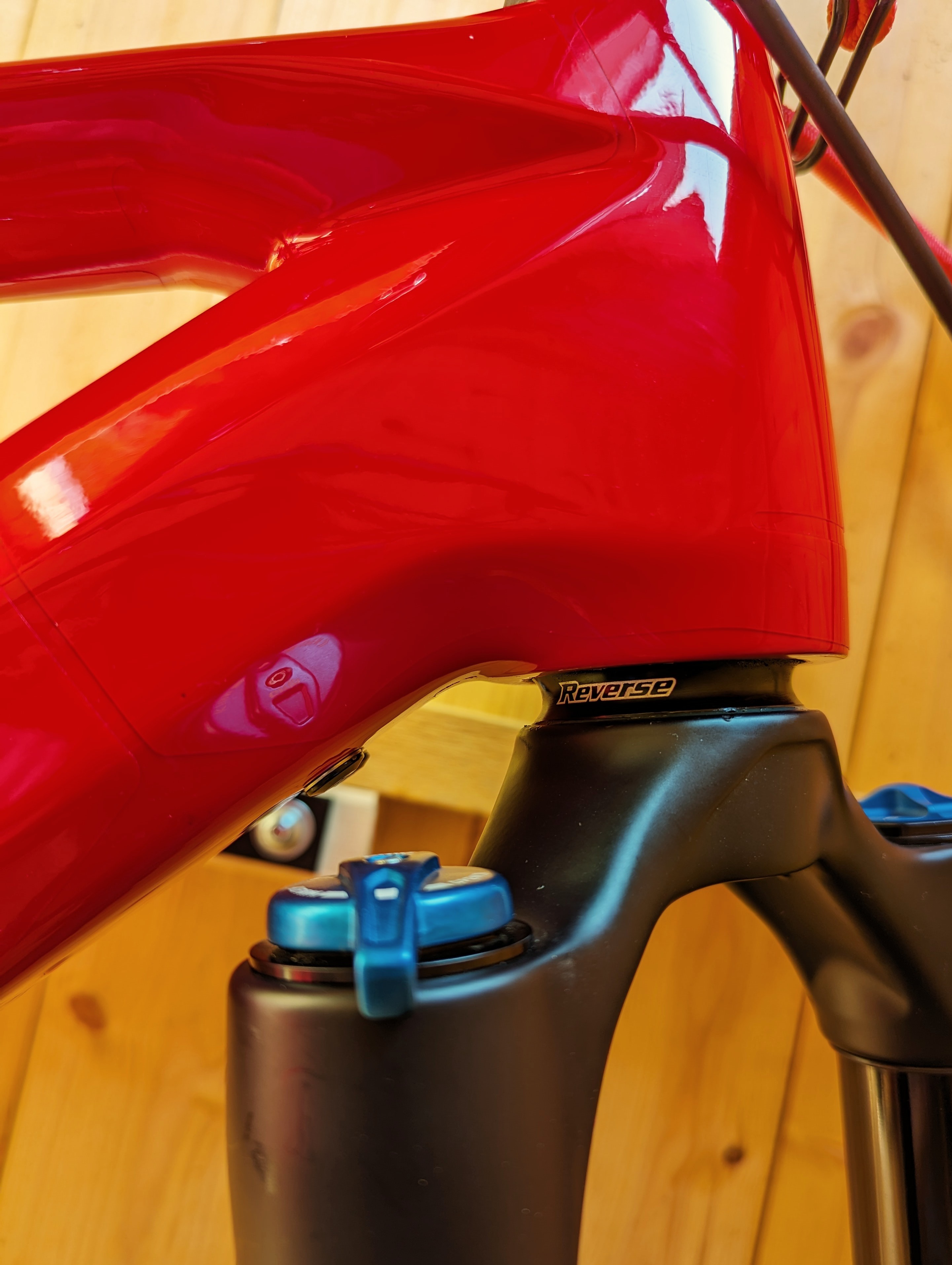

Do you happen to have any close ups of the race spacer?
Thanks.
Yeah sure, the spacer is made by reverse components
Close up it makes the frame/fork look a tad 'gappy' but you'll soon forget it's even there. With that spacer installed I now only just get fork clearance of the frame when turning the bars.

hi,what is the minimum crown race for fork clearance without spinblock? with fox 38 grip2?
There is with less height +3,+5 ...

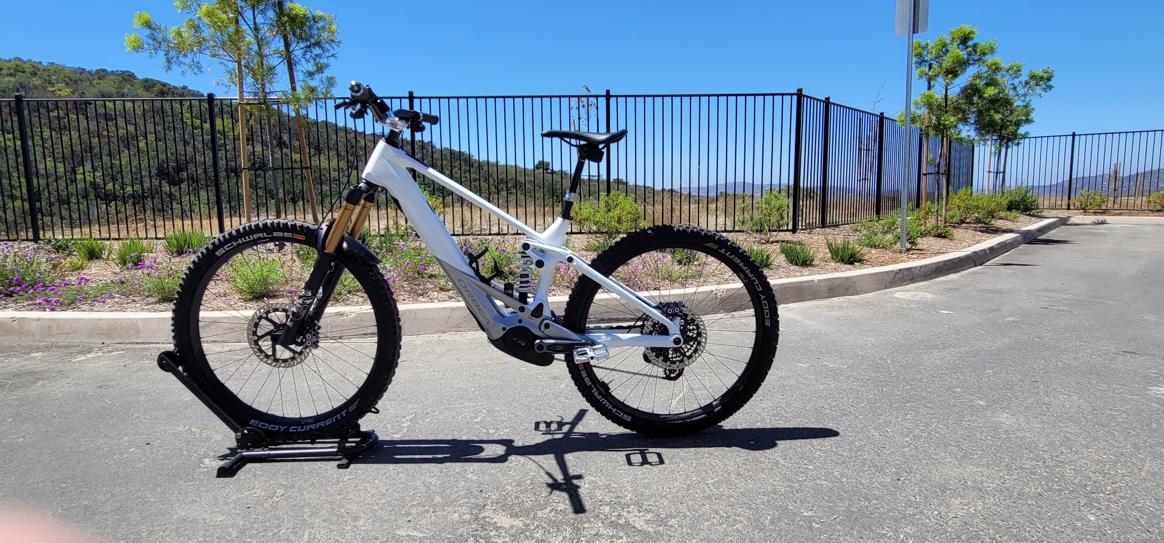

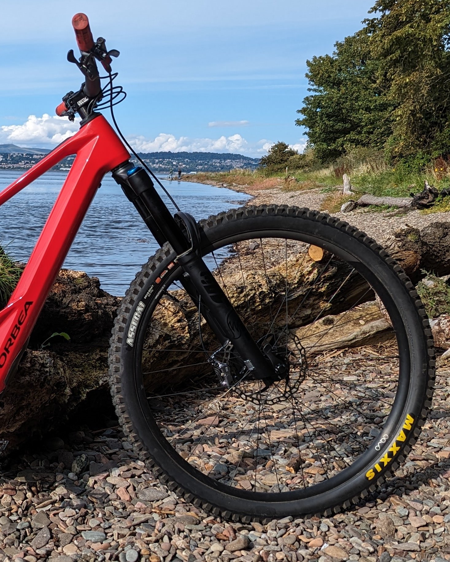

Tom115
Sep 11, 2023
7
France
I am 6ft and went with a large, think it fits perfectly. I am running a 170mm Rockshox AXS Reverb Dropper and could have fit a dropper with more travel but 170mm is all that I need on this bike.
Keep in mind other body dimensions play a role in how a bike "fits" you and size can be a personal preference depending on the ride characteristics you are seeking.
I think Orbea runs a lower seat tube to give you more options for longer travel droppers. Only have a couple rides on my new Wild, but it fit like a glove right out of the gate.
See pics of new Wild and of my YT Decoy that has a seat tube that's actually longer then most manufacturers. I can barely fit the same 170mm dropper.
Having owned 5 emtbs over last few years (too many Amish bikes over the years to count!) and ridden a few of my riding buddies emtbs, think the Wild is the best all-round bike I've ever rode. Climbs awesome, likes the flowy/techy stuff and more then holds its own on the knar!

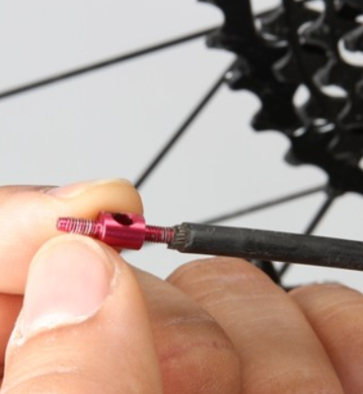

Hello!
I see you replaced the brakes. Did you replaced also the hose? I read some guys struggling to slide the new hose as it seems all is blocked inside the frame.
One shop near me told that he has been obliged to remove motor/battery to get sorted...
What is you experience on this? Thanks! :)
I've got 10mm crown race spacer on mine and the blue adjuster on the fork crown still tickles the downtube.

Hello!
Yes, I did replace the hose. I have a Shigura brake set-up (Shimano Saint levers and Magura MT7 calipers with Magura MDR-P 220mm rotors) and was required to use a Magura Brake Hose. I did not have to remove or drop the battery to do this. I recommend draining all the brake fluid from hose you are changing, cur off the banjo bolt on one end, olive and bard on other so all you have is brake hose. Pull the hose out from the rear of the bike and as you are doing this, have new hose you are installing pushed against the end of the hose that is being pulled into the frame (end of hose that had olive/barb). The old hose will serve as a guide. I did remove the stem and spacers when installing the new hose to make it easier, plus I went with the aftermarket stem and used Orbea adapter that let's you run regular stem with round Spacers.

Hello!

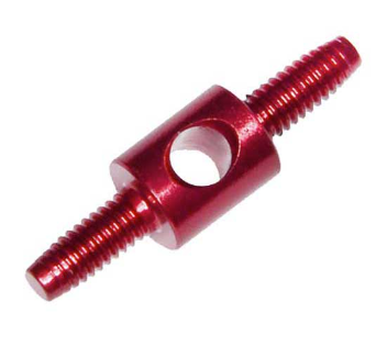

Maybe use something like a RockShox Reverb Barb Connector. Then you should be able to easily insert a new hose while pulling out the old one.
There are similar variants from other brands if this one in particular does not fit well enough. I have not used any myself, but planning to for replacing my dropper cable housing some time in the future.

Thanks a lot guys :) (y)
And yes, this is exactly how I proceed usually on all my bikes. I have the reverb part and "screw" the new hose to the old one and pull.
But I read some guys were not able to do this as the existing hose seemed blocked/attached inside, so...???
Anyway I will try, thanks again!
By the way, this is to change the stock M6120 brakes to my Saint brakes. Perhaps I can keep the hose and just change levers and calipers?
Here is another option albeit much more expensive.

I just swapped my brakes to Magura and it was super easy. Just had to drop the skid plate to guide the brake line above the battery.

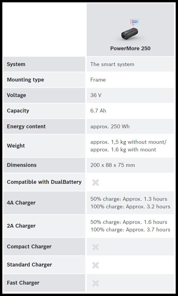

Hi everyone!
Does anyone know if the new RockShox Vivid would fit on the wild 2023 :unsure: ?
Has anyone tried it yet?
thanks !

These bikes do feel a bit small when pedaling because the seat tube is steep, but I think it’s a good thing. I’m 6’5 and ride an XL and it fits me pretty well, maybe a tad bit small for me. I think if you get the L make sure you have a 50mm stem, take out all spacers under the stem which will give you more reach to make it feel bigger, and adjust the stack by putting a higher rise bar if you need it higher

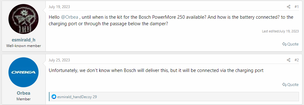

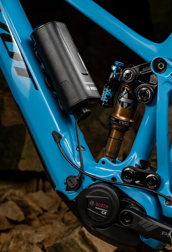

It won't work at least so far. "PowerMore 250 is only available for eBikes with the smart system from model year 2024. ".. also in the Flow app, there is no "PowerMore" option which apparently should show. I've no idea if they plan to offer a way to retrofit.
Thanks. I've edited my post above to not spread any false hope.
Guess we will just have to wait and see. It would really surprise me if Bosch launched a unit like this that is literally meant for retrofitting if it's not compatible with the vast amount of bikes already sold. That would seem like a lost opportunity to make a lot of $$$
(unless there was a change to the main battery itself for the 24-versions that I'm not aware of(?)
That looks promising. Thanks :)

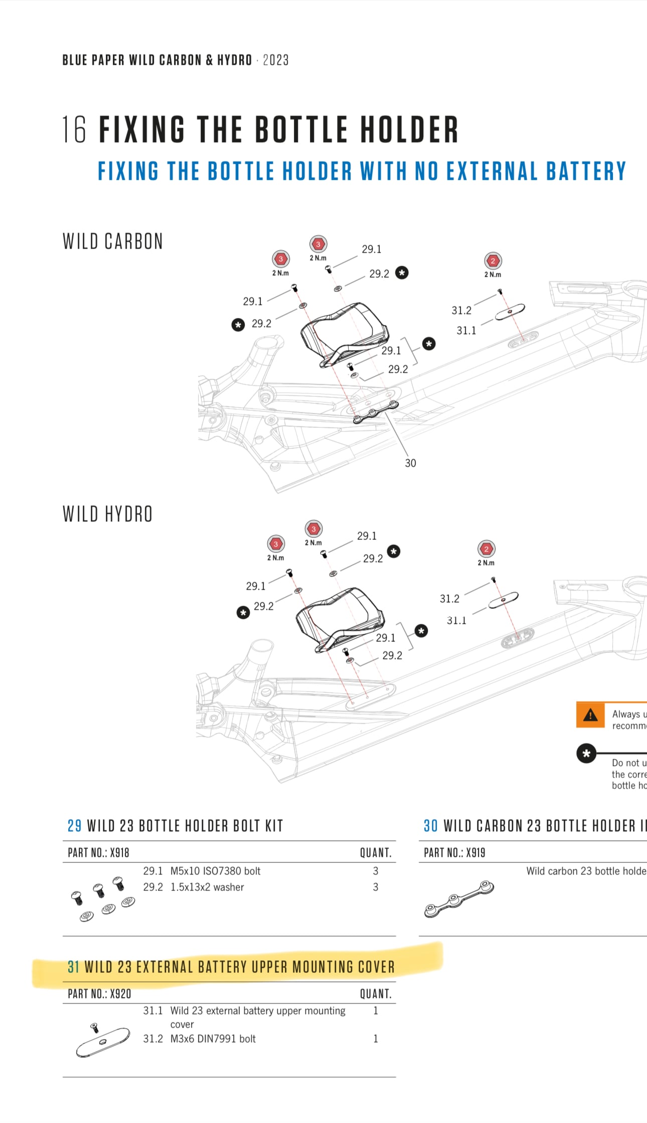

Durrti
Aug 22, 2021
162
164
California
This is from the “blue paper” seems pretty confirmed to me 🤷‍♂️
