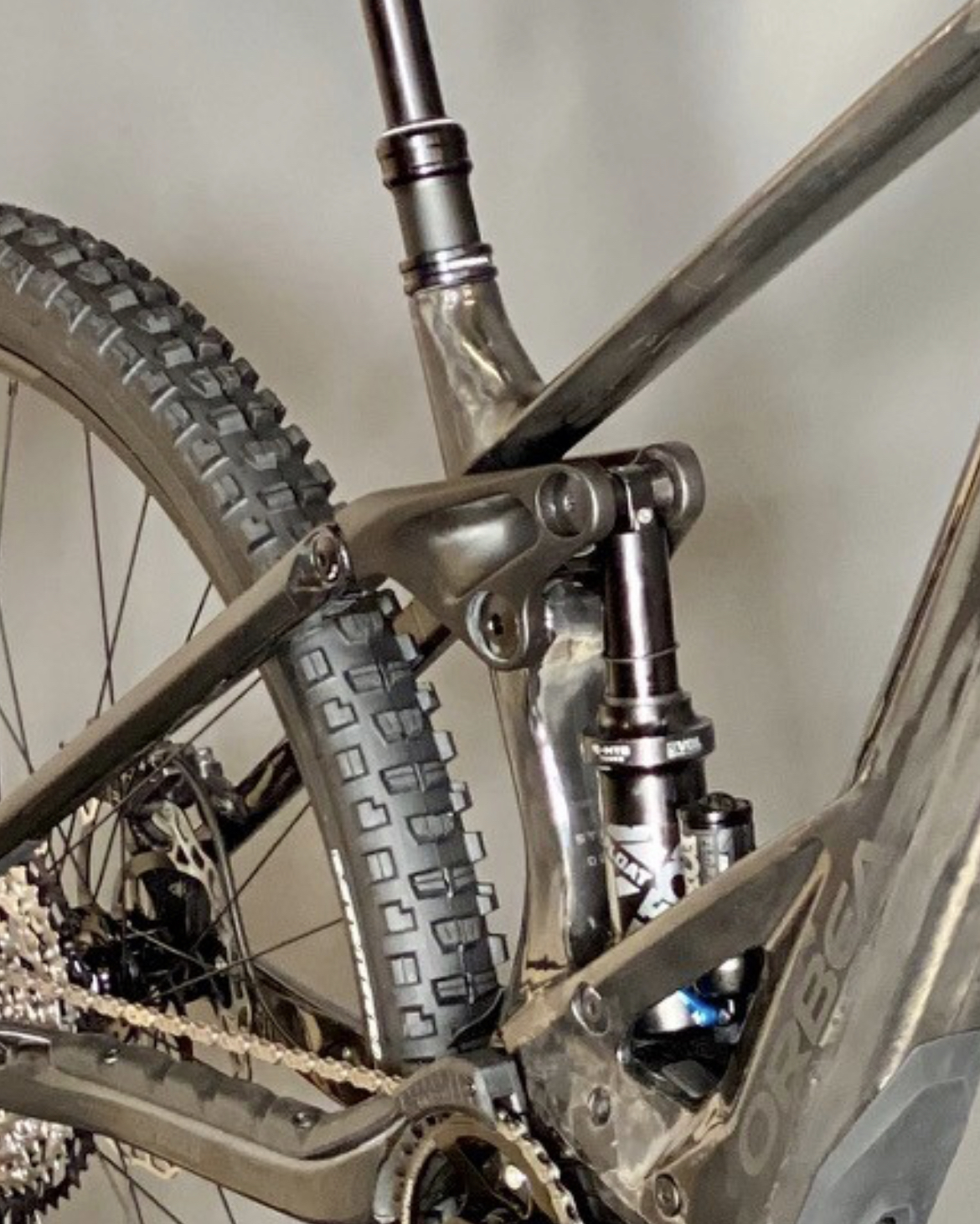

If you choose a Carbon View Colour, you cannot choose a secondary colour.
On some bikes it seems to be black, on others its painted. I talked to the guy with the black swingarm frame and he was a bit disappointed that the swingarm is black. In myO is it is clearly painted in Carbon View.
aHR0cHM6Ly9mc3RhdGljMS5lbXRiLW5ld3MuZGUvdjMvMC80OS80OTg0OS1uc3dqZGhiY3N4ZXUtb3JiZWF3aWxkMjAyM2RzY18wMzE1LW9yaWdpbmFsLmpwZw.jpg
Edit: Other example. Two Bikes in Carbon Raw Gloss. One with a matte black swingarm, one with a glossy Carbon View paint. Is it possible that there are two versions, one in carbon and one in aluminium, depending on the model?
I have just ordered a Rise M team model 2023, with myo program, same color red wine Carbon view Matt. No possibility to have the rear suspension link in the same frame color? Maybe it’s not possible with the new rise to choose. The same for the wheels MC32 LTD, normally you can choose an additional color for the rims, but not possible with the myo configurator.
I contacted Orbea for more information, but don’t know if I’ll get an answer?

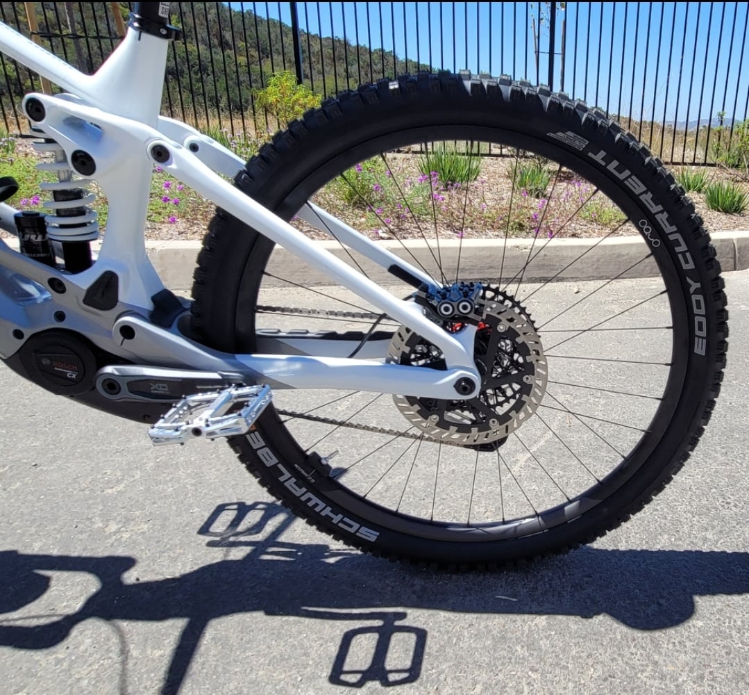

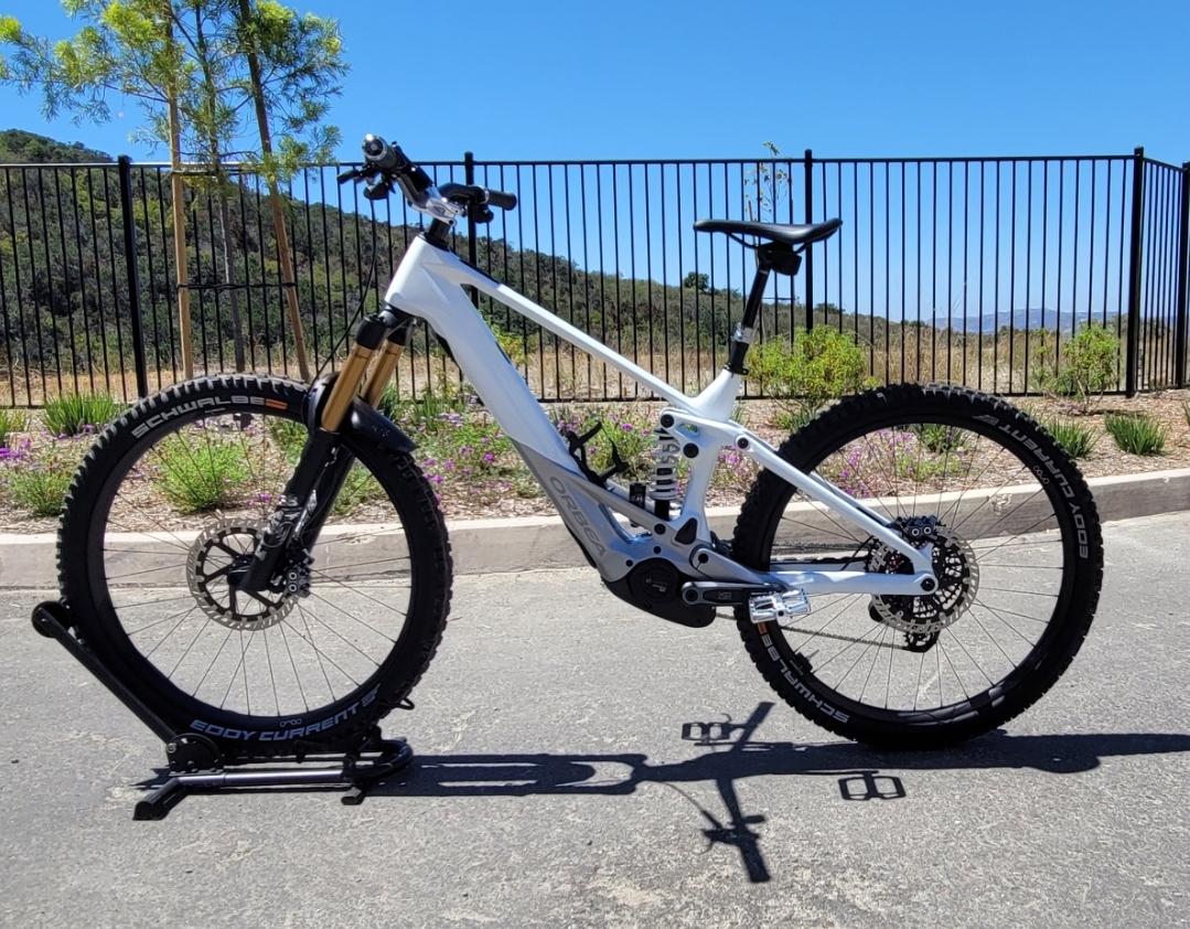

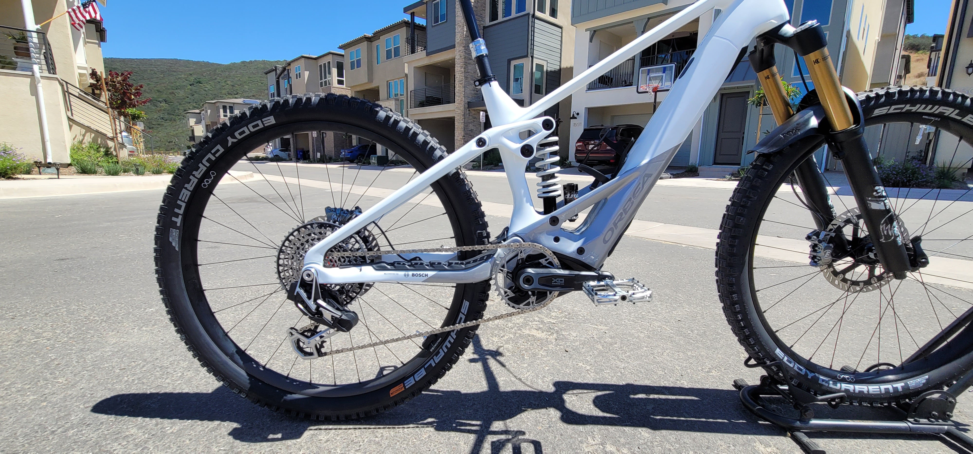

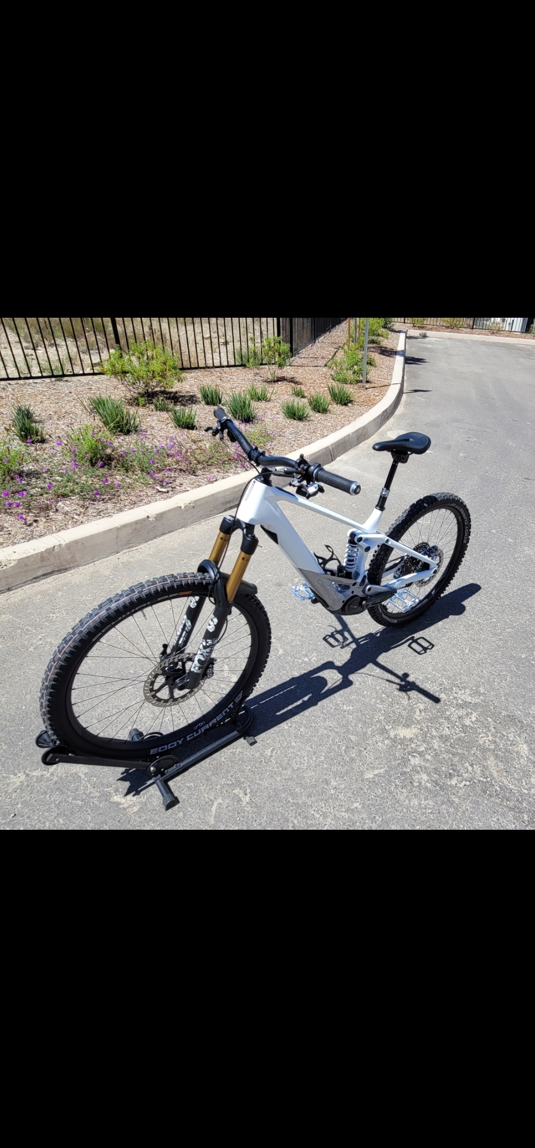

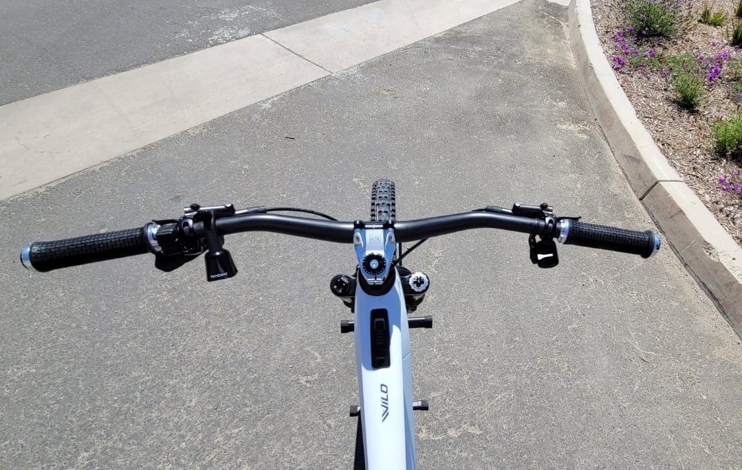

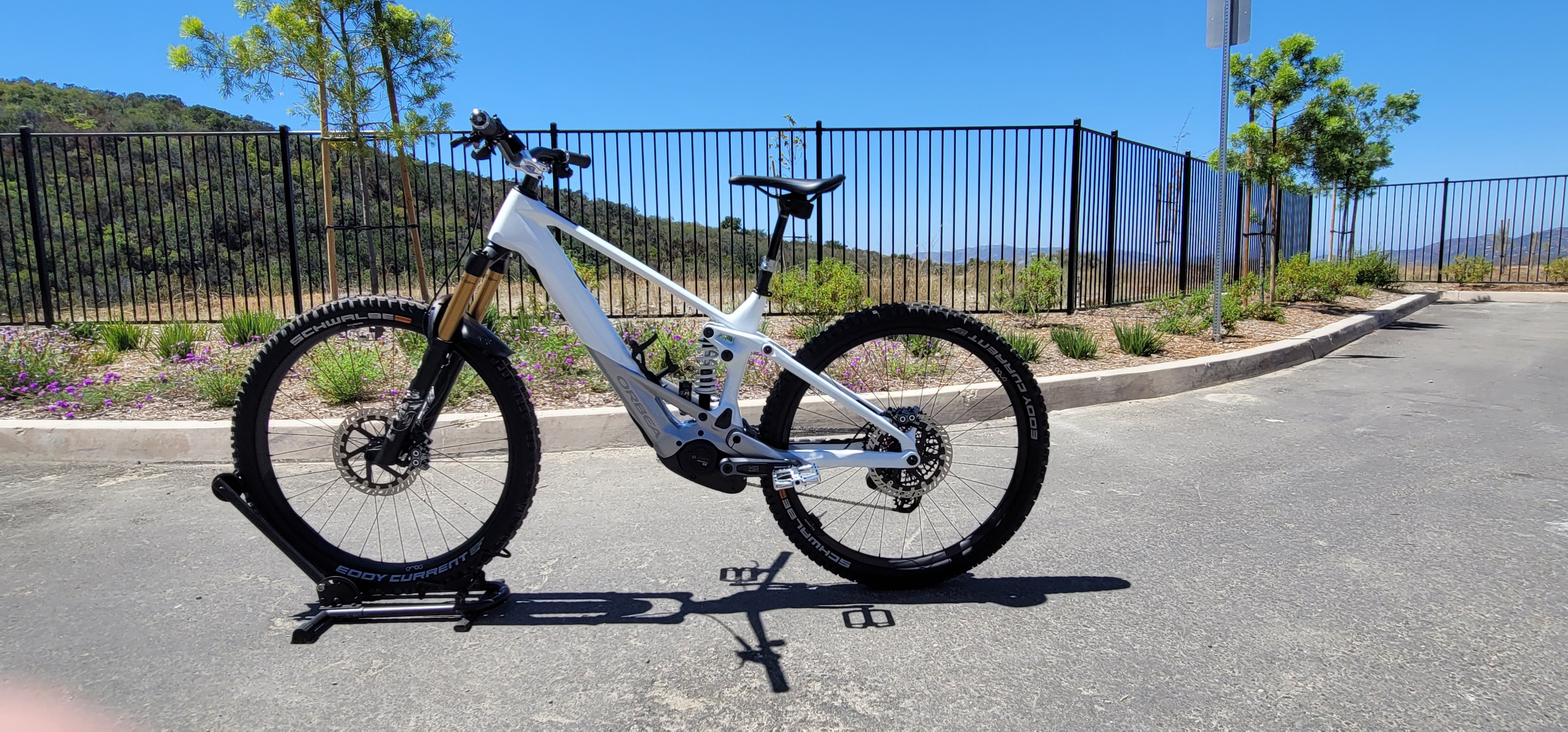

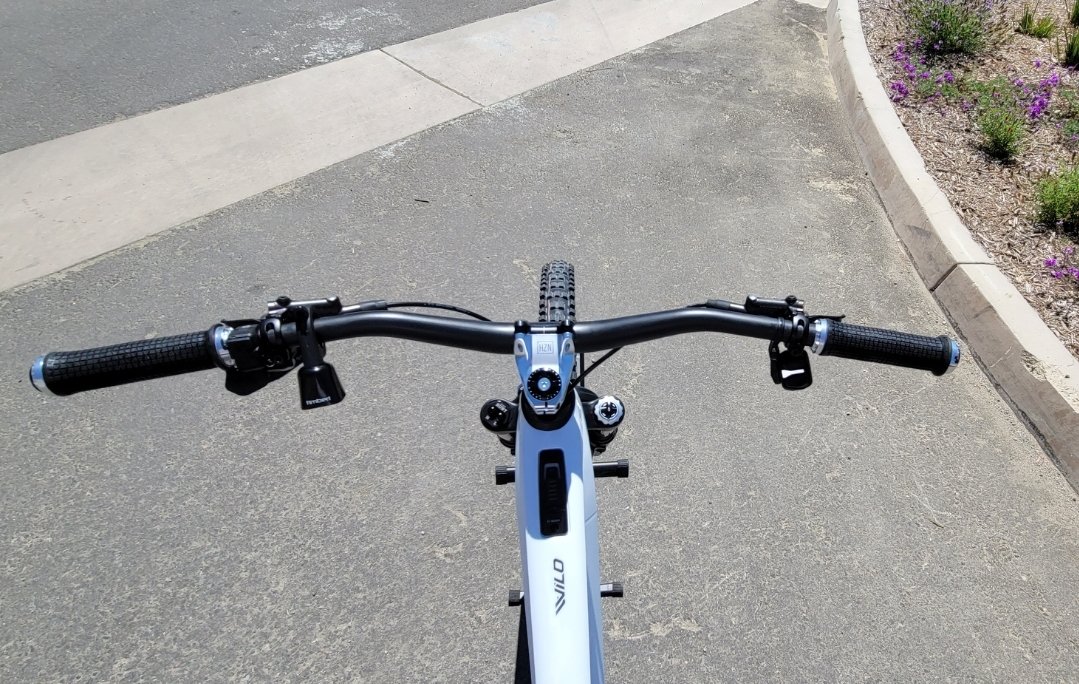

New Wild arrived and has been RideWrapped with custom components installed. Maiden voyage in a couple days!
FRAME
Orbea Wild Hydro 2023 Carbon, 160mm travel, 29" wheels, Concentric Boost 12x148
Custom Paint/Ridewrap Taylored Kit
SHOCK
MRP Hazard Custom 205x65mm Trunion/400lb Progressive Spring
FORK
Fox 38 Float Performance 170 Grip 3-Position QR15x110 E-Bike Optimized with custom Slik Graphics Decals
HEADSET
Alloy 1-1/2", Black Oxidated Bearing
CHAINRING
SRAM XX Eagle AXS Transmission Direct Mount 36T Boost
CRANK
SRAM XO Eagle 160mm
Pedals
Deity TMAC Silver
Controller
SRAM XX Eagle AXS Transmission Pod Ultimate
CASSETTE
SRAM XX Eagle AXS Transmission 10-51t 12-Speed
REAR DERAILLEUR
CHAIN
HANDLEBAR
SQ Lab Carbon, 4-degree upsweep, 12 degrees backsweep, 45mm rise, 780 x 31.8mm
GRIPS
Revolution Pro Series Large (black grip/silver lock-on rings)
STEM
Nukeproof Horizon 31.8 x 50mm (black body/silver end cap Deity stem cap)
BRAKES
FRONT/REAR BRAKES
Shimano Saint Brake Levers
Magura MT7 Calipers
Magura MDR-P 220mm rotors
Front Pads - Sport (green)
Rear Pads - Performance (grey)
WHEELS
OQUO Mountain Control MC32TEAM eBIKE 29"
TIRES
Swalbe Eddy Current 29 x 2.6"
SEATPOST
Rockshox Reverb AXS
Ø 31.6 mm 170 mm travel
SADDLE
Ergon SM E Mountain Sport
Screenshot_20230805_143332_Gallery.jpg Screenshot_20230805_143352_Gallery.jpg Screenshot_20230805_143826_Gallery.jpg Screenshot_20230805_144047_Gallery.jpg Screenshot_20230805_143852_Gallery.jpg Screenshot_20230805_143839_Gallery.jpg

Best looking one so far 😍 I'm assuming you're fork crown clears the underside of your downtube seeing as you've fitted your own stem/removed the knokblock feature??

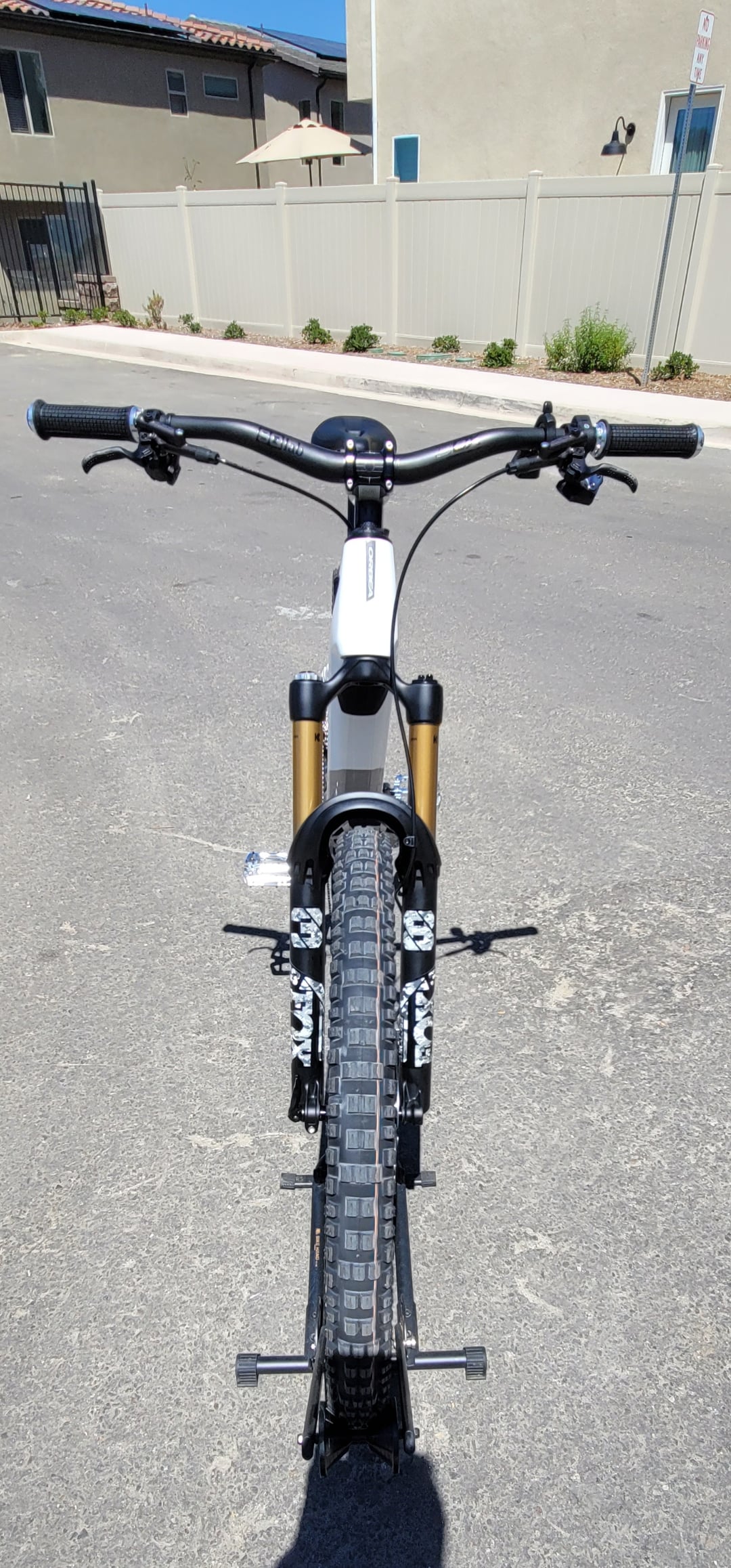

That's some spec, did you get it as a frame only option or did you spend a day ripping all the standard stuff off? (Normally what I do)
Those bars look interesting, I like the back sweep, it may be useful for me coming back from injury to try something like that?
Singletrackmind
Sep 17, 2020
477
435
San Diego, CA
Unfortunately Orbea doesn't sell the Wild as a frame only option. Had a lot of fun installing all the custom components and eas able to sell all the components that came stock on bike. SQLAB makes some great handlebars. I prefer the 12 degree backsweep bar and I believe they have a bar with 16 degrees as well. Has definitely helped with hand fatigue and eliminated hot spots. Not sure of how they would help with a back injury but their website has lots of info. Going to a bigger diameter grip has helped with my aging back!

Mines a shoulder / arm injury. but the hand positioning i think is definitely going to be a fun thing to get right. I ordered the higher rise bars with my wild. hopefully that helps, but I'll keep an eye out for these bars for sure.

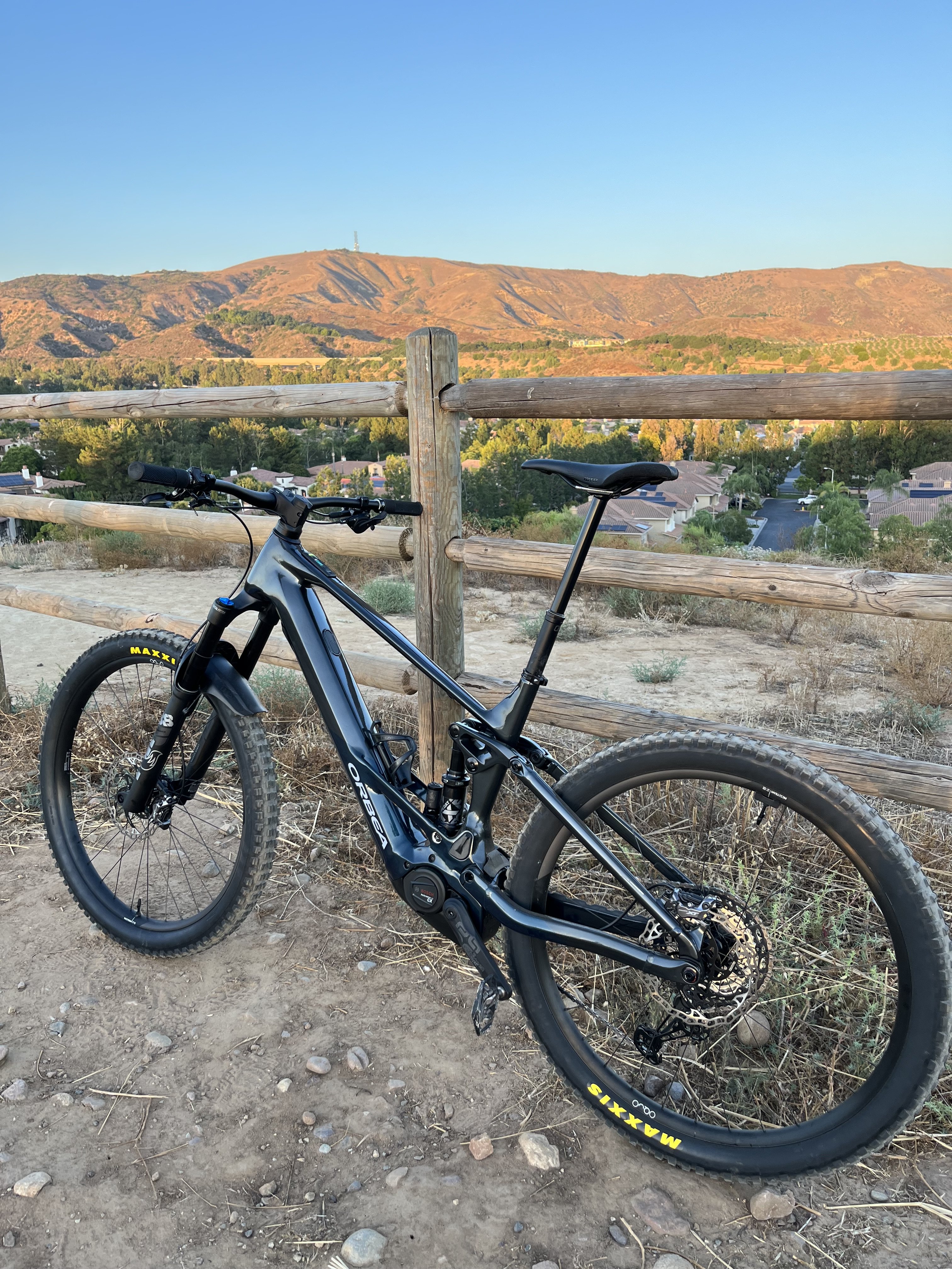

Just got my XL H10 and can’t wait to put some miles on it! Paint quality was good, except for a big scratch on the seatstay that the dealer is going to replace.
When I ordered it I asked for the brakes, stem, and tires to be upgraded, but Orbea shipped it completely stock and they didn’t tell me. I also ordered the smaller battery but it came with the bigger battery. My bike shop did try and help me out with the upgrades/price.

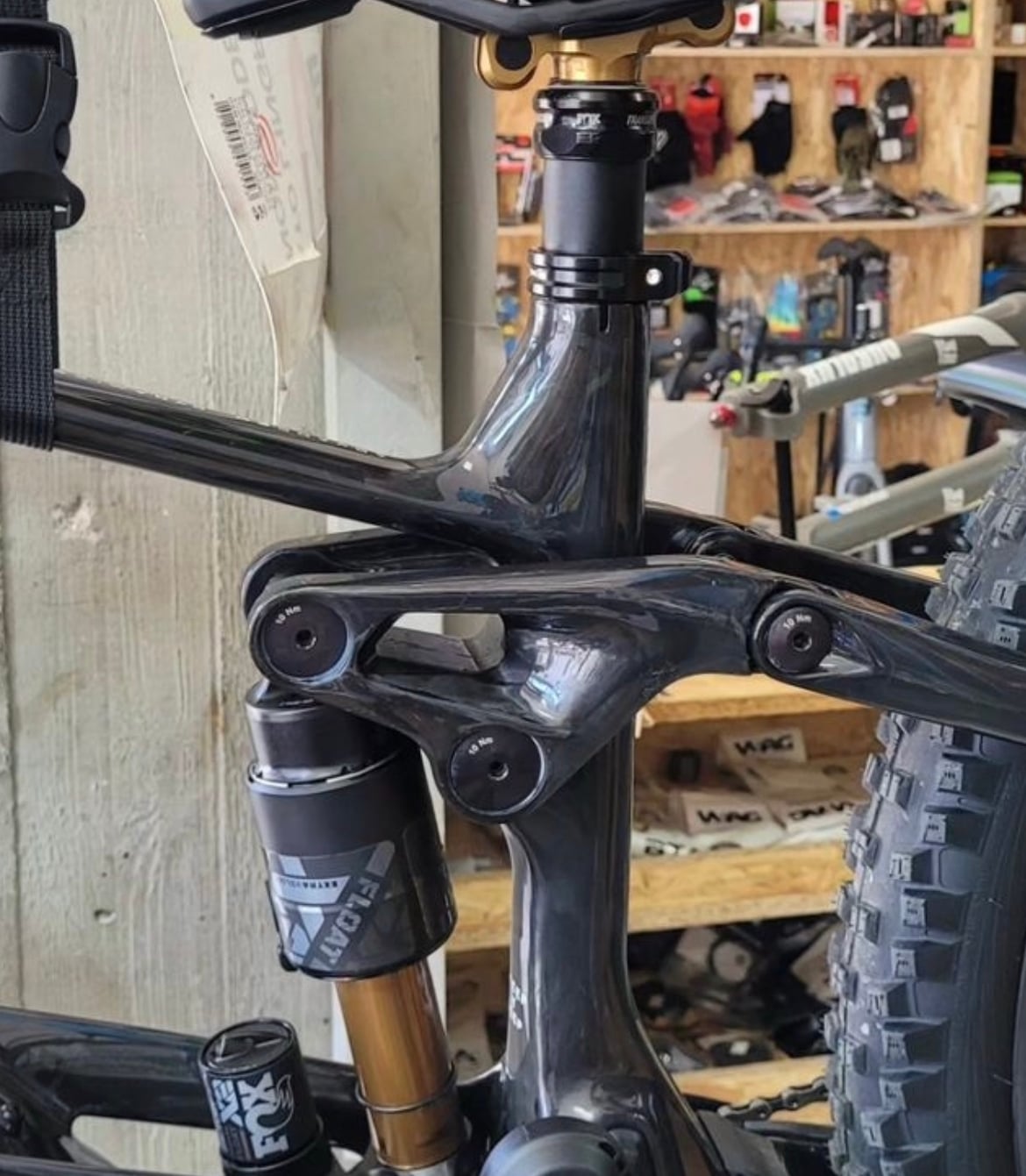

Does anyone rides his Wild with a Coil and can give me some impressions? I just bought a Lyrik Ultimate 2023 and I am thinking of trying a Super Deluxe Coil. Thanks.
Singletrackmind
Sep 17, 2020
477
435
San Diego, CA

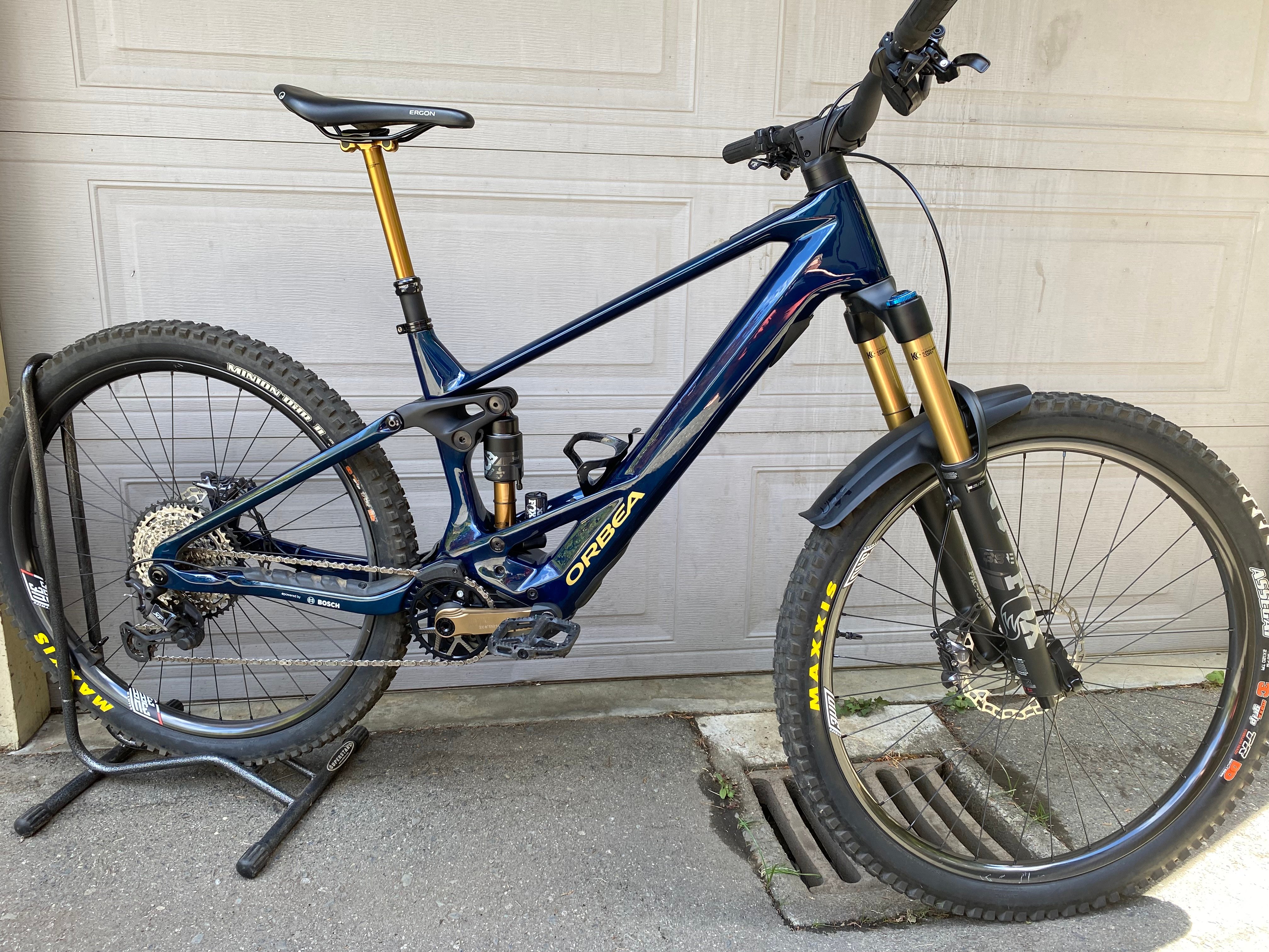

I have a customized Wild with and MRP HAZARD progressive coil and it shreds! Expected improved dh performance but surprised how well it performs when climbing. You can also customize the color of the coil!

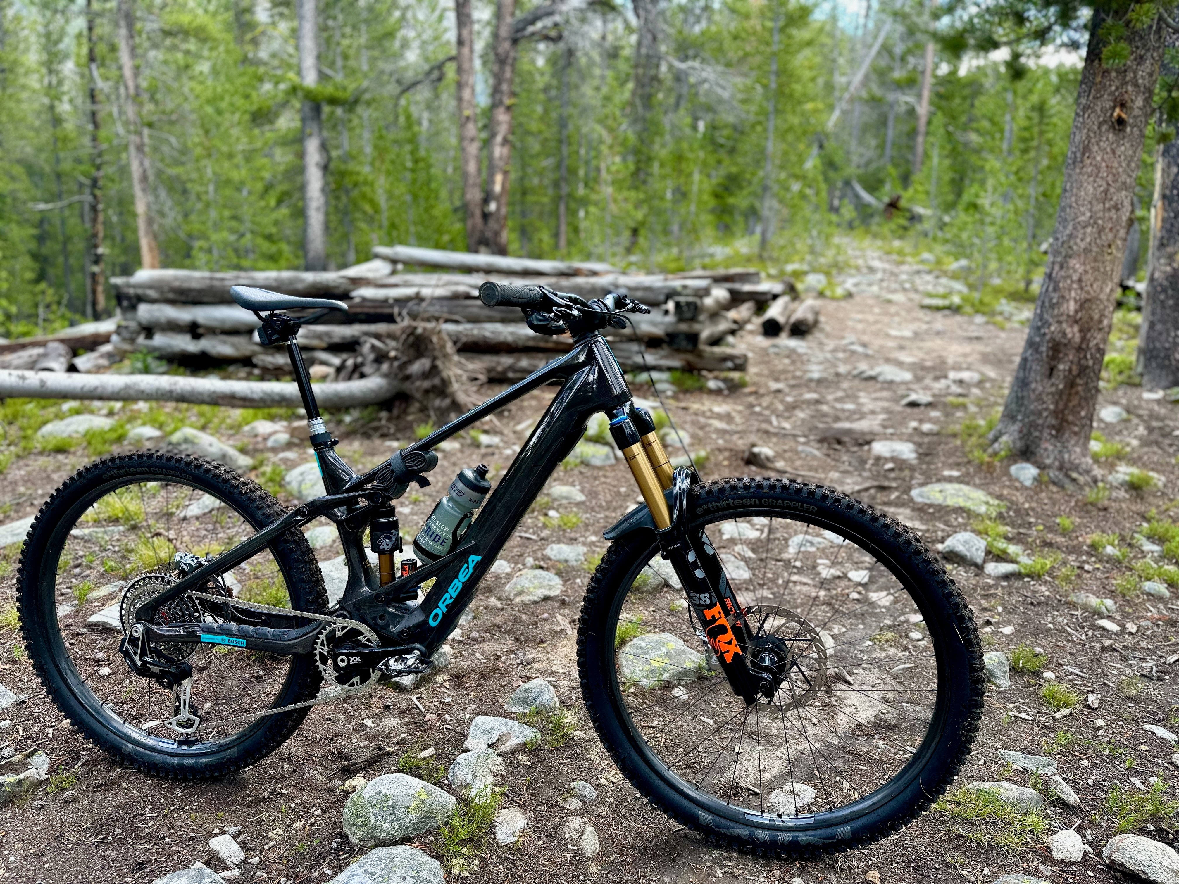

I have about 150 miles on my Orbea Wild M20 so far. I took most of the stock parts off it and moved a lot over from my previous Rise. My 38 barely fit given the 10mm-longer heattube on the Wild; I put the X2 on it - we'll see how it fairs; feels great so far with some setting adjustments.
The 10 pound difference to the Wild (my Rise was 42 pounds - this is 52) is really significant. It feels so much more top-heavy.
This is the Cosmic Carbon color - I'll never get another Orbea without doing the MyO program. In person this color is just UPS brown - not my favorite but given the timing of when my local dealer was getting Wilds in, this made the most sense.
Really fun so far - feels very stiff / almost rigid but the faster you push the better it feels.
Put the XX Transmission on it, different brake set and trying 220mm rotors front and rear (not sure how long the rear 220 will last before it gets smashed by a rock...its a huge rotor for the back wheel). ENVE AM30 wheels and 'trying the eThirteen Grappler tires (really great so far - super soft compounds).
