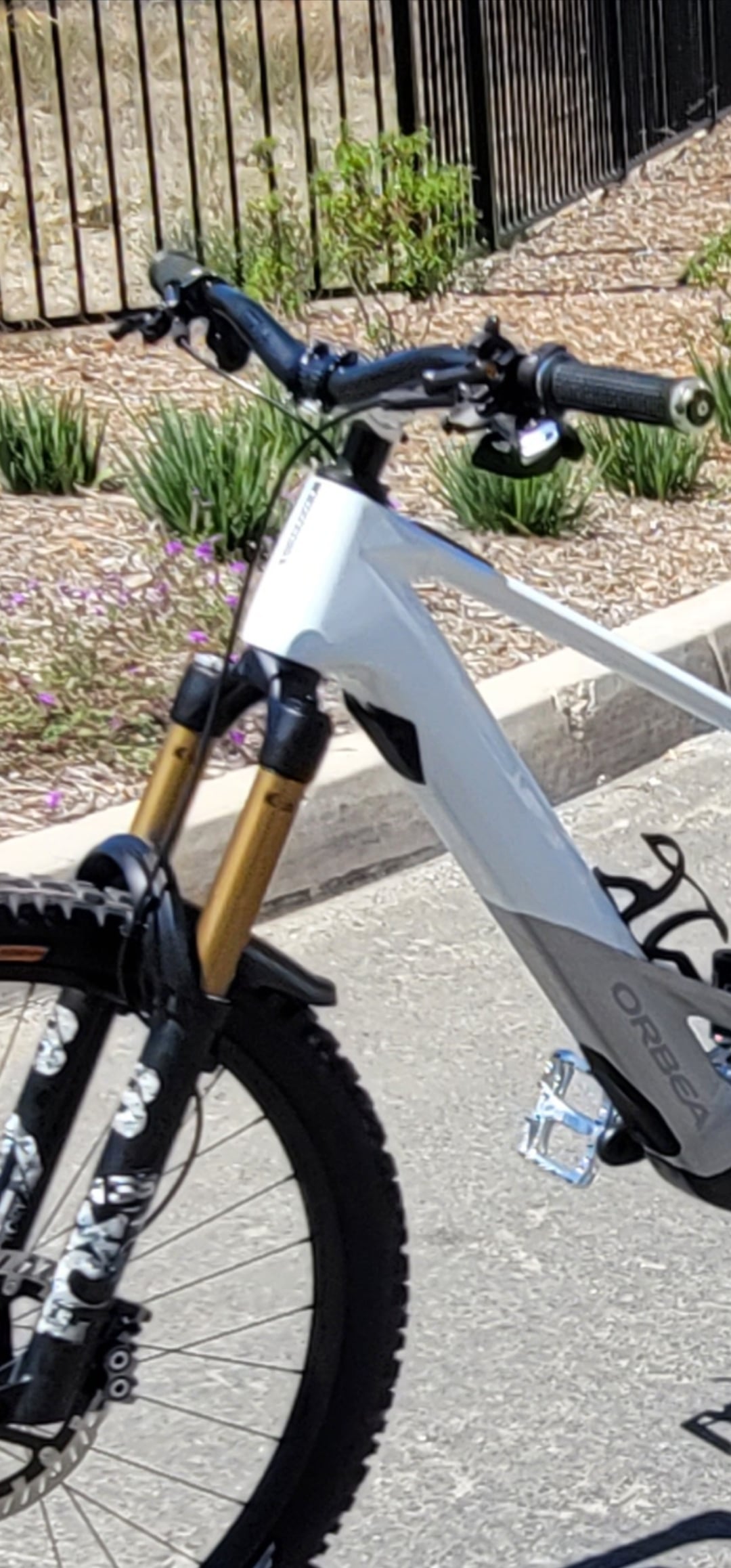

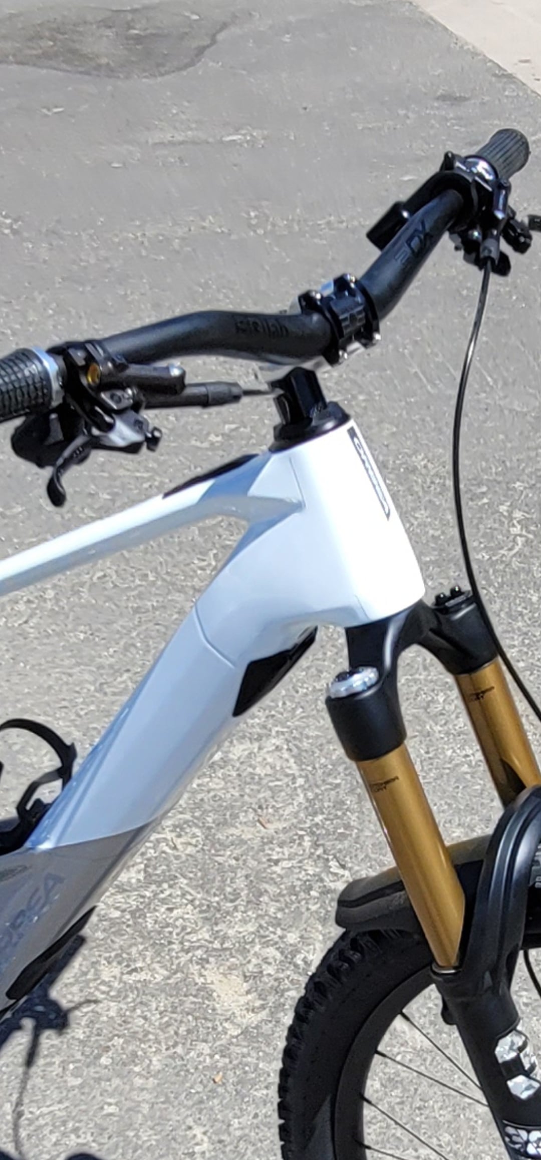

You can get a kit from Orbea to run a standard stem and spacers. The cables still run through the headset area but they go outside of the headset spacers. When you do this you lose the knock block aspect of your stock headset.
If you are on an XL you should be fine. I’m on a large size frame and with a fox 36 fork, my compression adjustment on the drive side, and the air cap on the non drive side, would barely miss the downtube if the bars over rotated in a crash. I would think smaller than large and the controls at the top of your fork legs would likely hit the frame and damage it.
Somewhere in this thread there are pictures of people switching to standard stem and spacers.

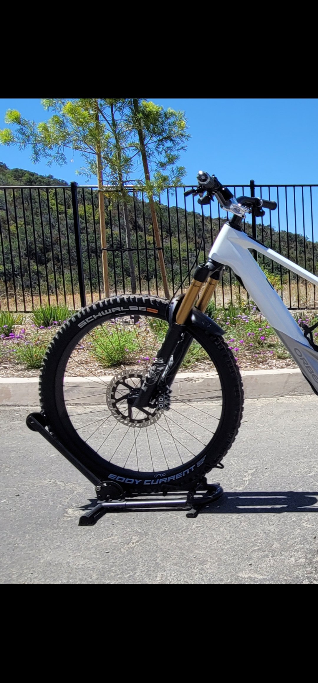

What size frame are you on and does your fork clear your frame with over rotation of the bars. That’s a really sharp looking bike with some excellent mods!!
Thanks! I have a size Large frame. No problems with 170mm travel fork clearing the frame. Can honestly state my Wild is the best all-round emtb I've had the privilege of owning/riding. Have a new YT Decoy MX Core 4 that is setup more for dh oriented trails that I absolutely adore. VERY exciting times for new emtb technologies! Happy Trails

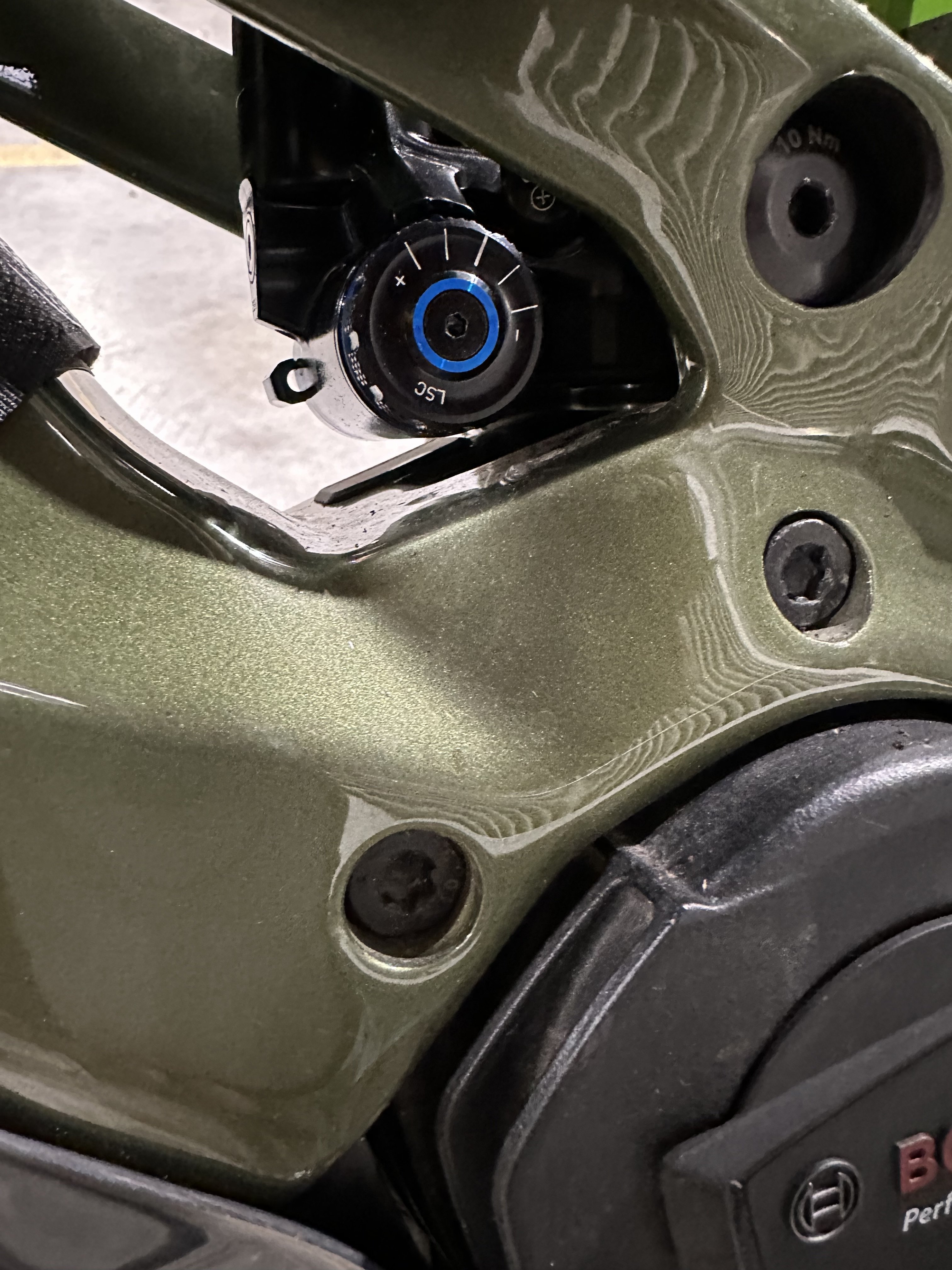

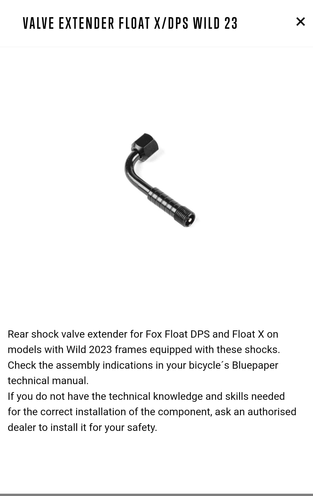

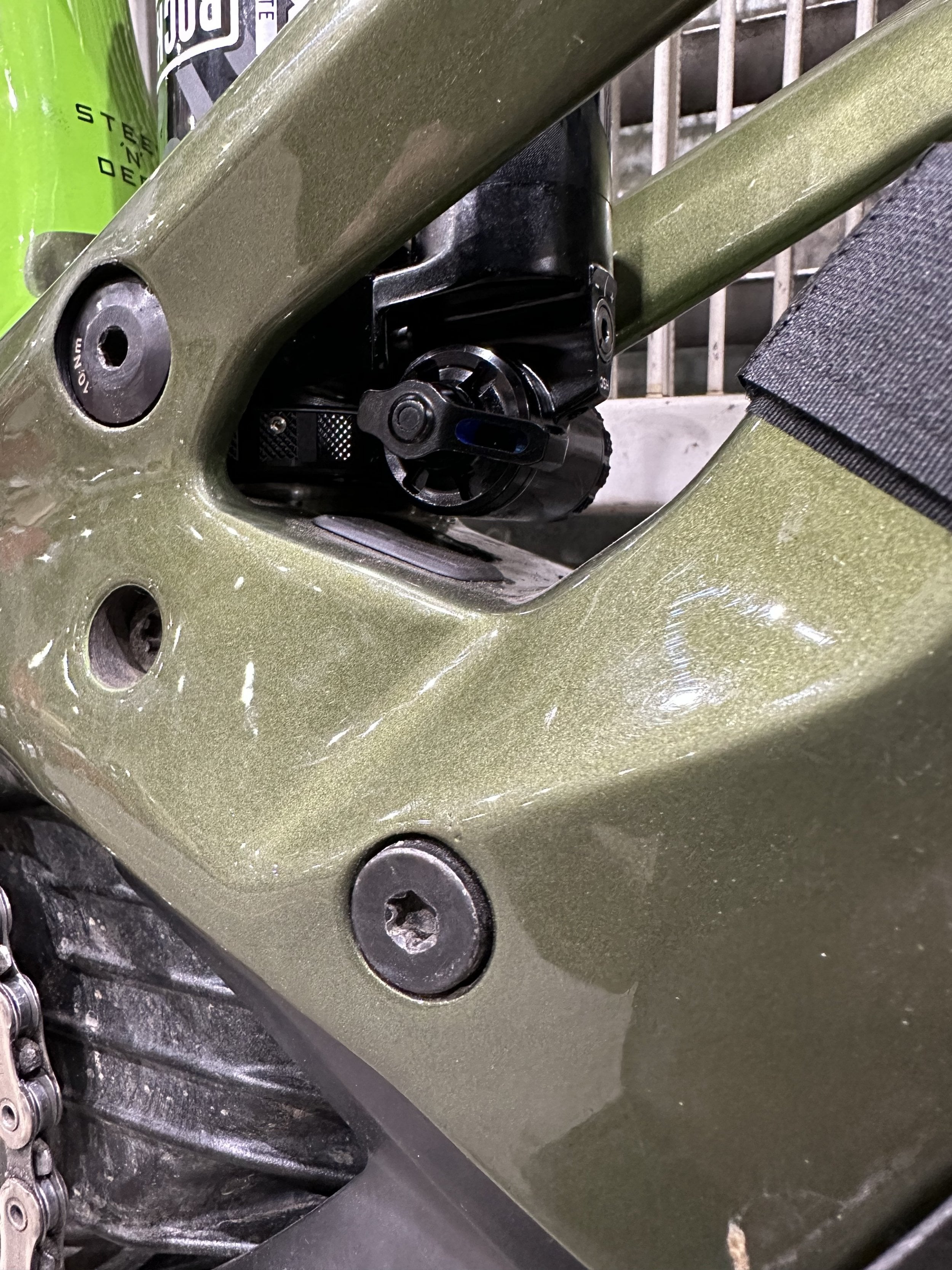

So, next question - I had a DPX2 off my Crafty which I was going to put on, unfortunately with the side mounted adjusters it fouls the frame spar on one side.
What other air shocks do we know will fit and have reasonably accessible adjusters? X2 obviously but 24 is spendy, trying to keep costs under control. Have got Zebs coming and it would be nice to keep matching (I guess, but not a showstopper) but the super deluxe have the rebound dial on top, anyone know if they fit and possible to adjust when fitted?
dieselbtle99
Sep 1, 2023
29
26
United States
Thanks @paal .Will leave that one for a Christmas pressie or summat

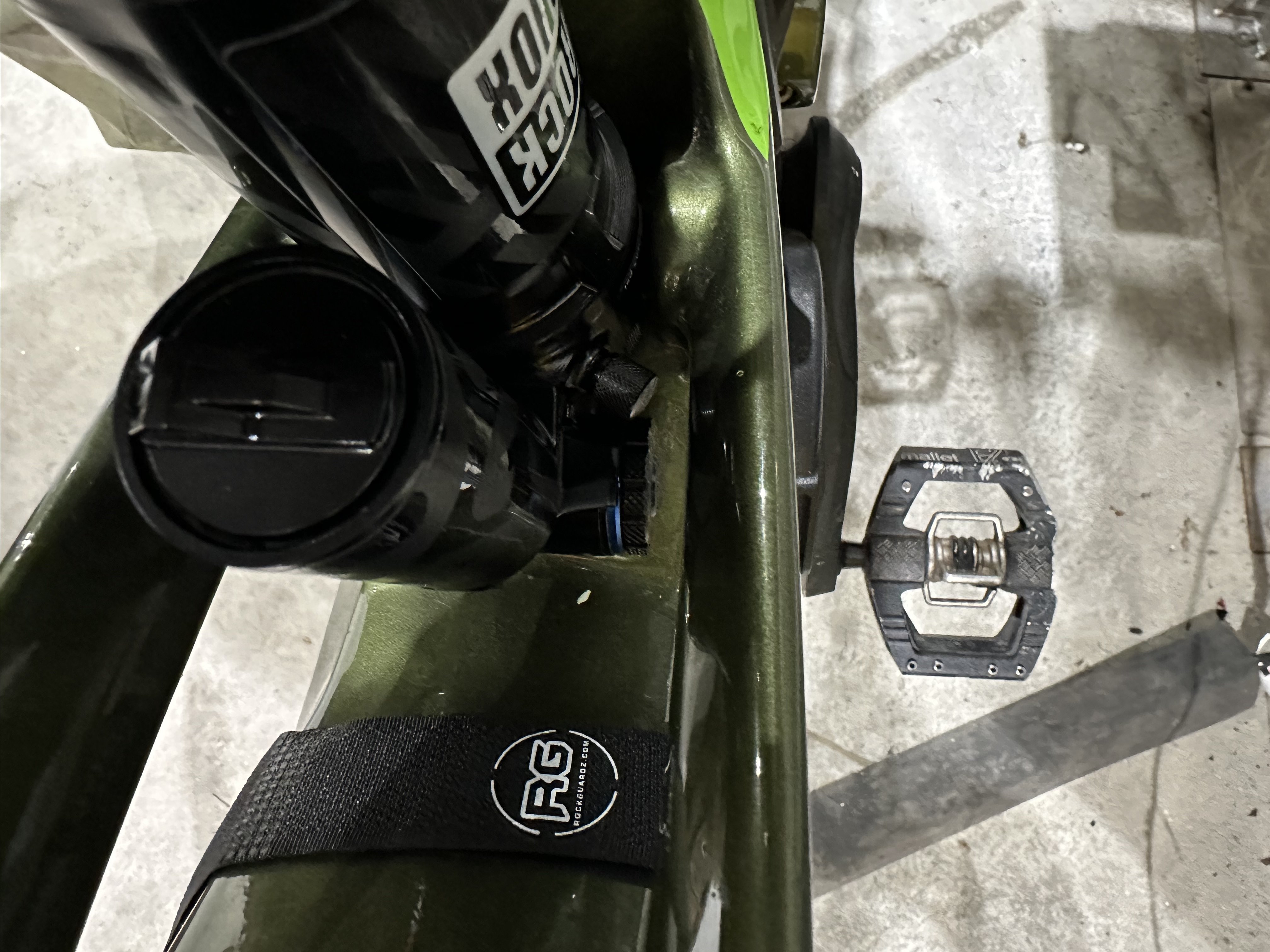

Just fitted a sdu to my wild m10. Can reach all adjusters but need a 90deg adapter to air it up. Working on getting adapters. Will update when complete. I had to unmount from trunion and slide forward to get my shock pump on.
Be wary fitting the latest RS SDU to a 2023 carbon Wild. RS does not recommend due to interference at the trunion head (specific case I know of was interference on a medium M10 under full compression).

Ah bugger, just bought a lightly used one. Thought it looked like it would be tight. Would think it's the same on all models as I expect the lay up in that area is the same
