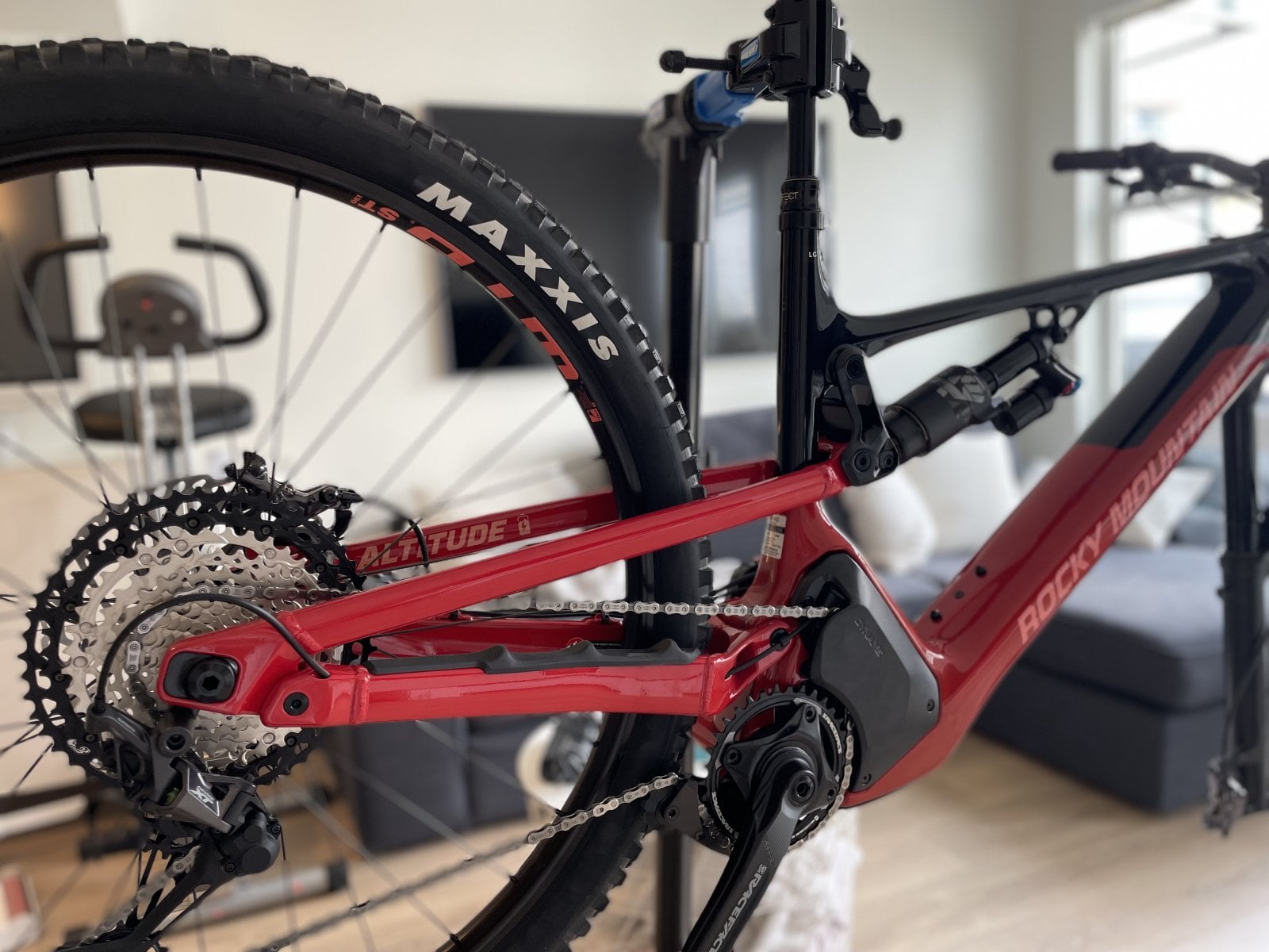

My new 2022 Rocky Mountain Altitude PowerPlay C70. In British Columbia.

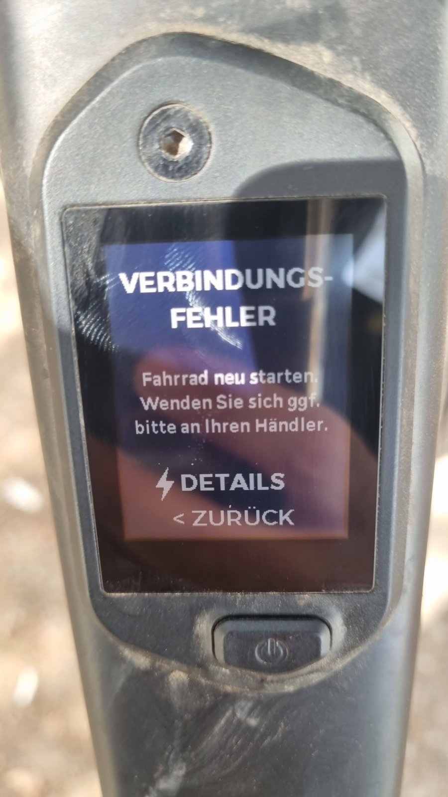

The display backlight is flickering a bit. Im not sure if its there all the time, or that it just under certain lighting conditions. Anyone else notice this?
Also sometimes i get a communication error on the display right after powering up when there is a charger attached to the bike. This happens with the AC adapter and also once with the overtime pack. Solution is to power the bike off and on, and things work fine again. Ive only had this happen like 3 times. Could this be a firmware related problem?
Hi. Brand new Altitude C70 here as well. I found the same flickering under strong light, and the same connection issue, which I bypassed rebooting the bike.
eh could you eleborate?
Not sure what you mean by bypassing and rebooting, and did that resolve the issue?
Hi. I mean I solved forcing to turn off the bike through its power button on the Jumbotron. Since then, I turned on and off the bike several times over 3 days, and no issue happened.

Yes power cycling solves the problem, but only temporarily. The error seems to pop up every now and then, like once every few weeks. Its not a big issue, but still somewhat annoying.

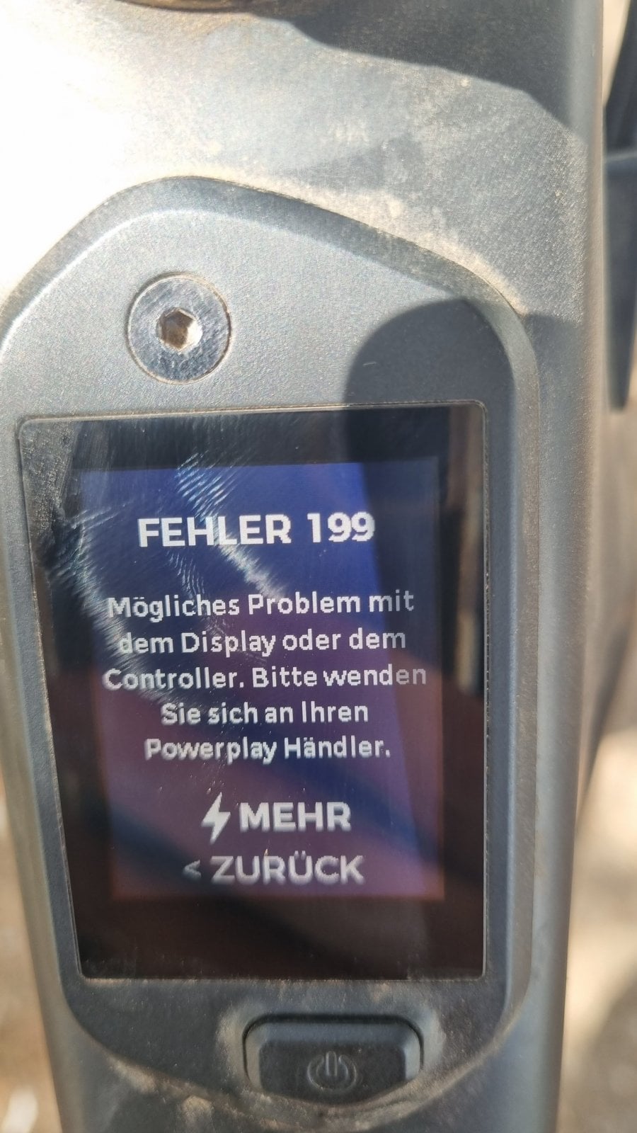

hello people, in my C90 I get the error 199. Is it the error you were talking about? the procedure is the same, turn the ebike off and on. But it happens to me regularly...is there a solution?

Yes its Error 199 that pops up every now and then. I think ive seen it like 5 or 6 times in the last 6 weeks.
Wouldnt be surprised if this was a firmware issue?

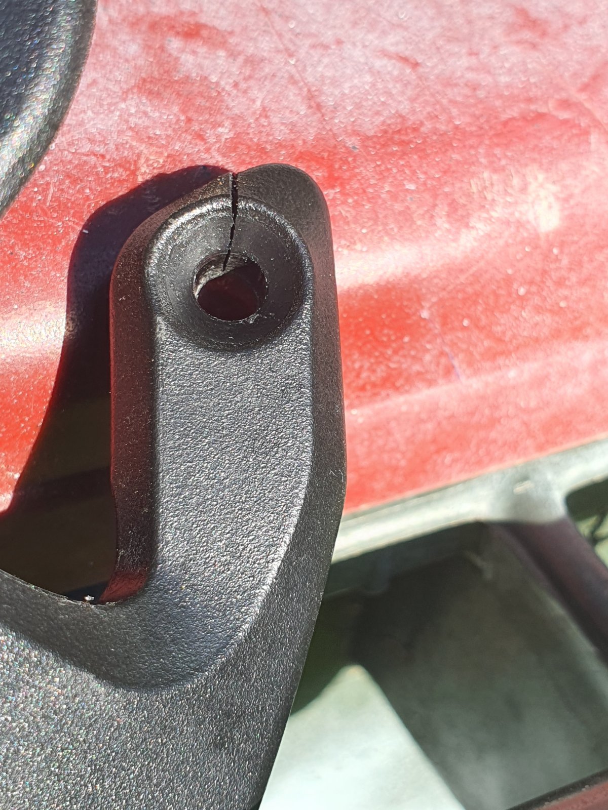

This tapered hole is not the best design solution. The same problem is present also on the motor covers of the Dyname 2.0. Resulting from this design solution is a very low torque limit of the tapered head screws. Use a low strength thread lock (like Loctite 222) and thigten the screws very very carefully, a lot below the torque limit that would result considering the thread dimensions only. If the screws are aluminum, better replace them with steel screws, because even a low strength threadlocker might be too much for the allen key insert when you try to unscrew them the next time.

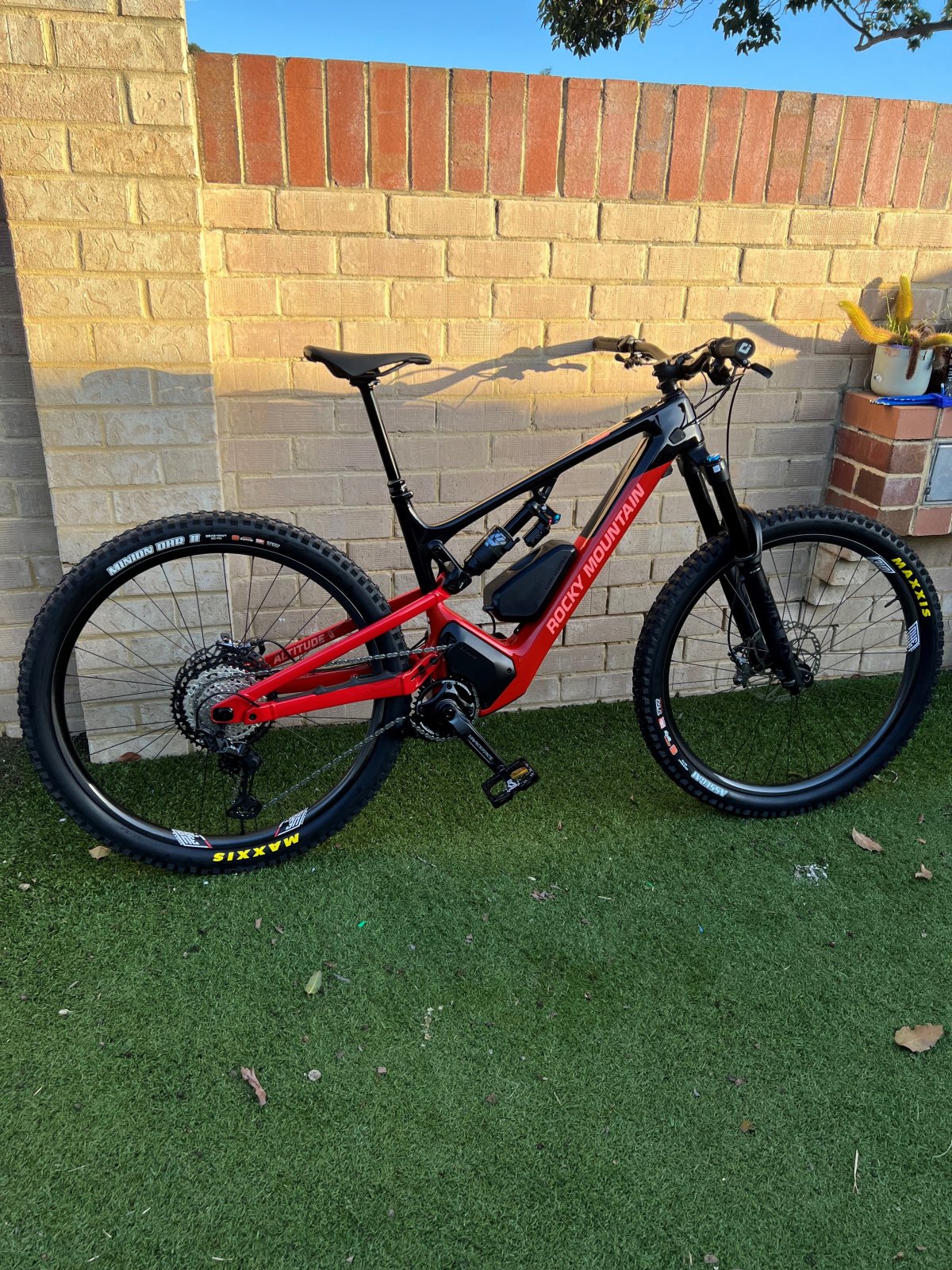

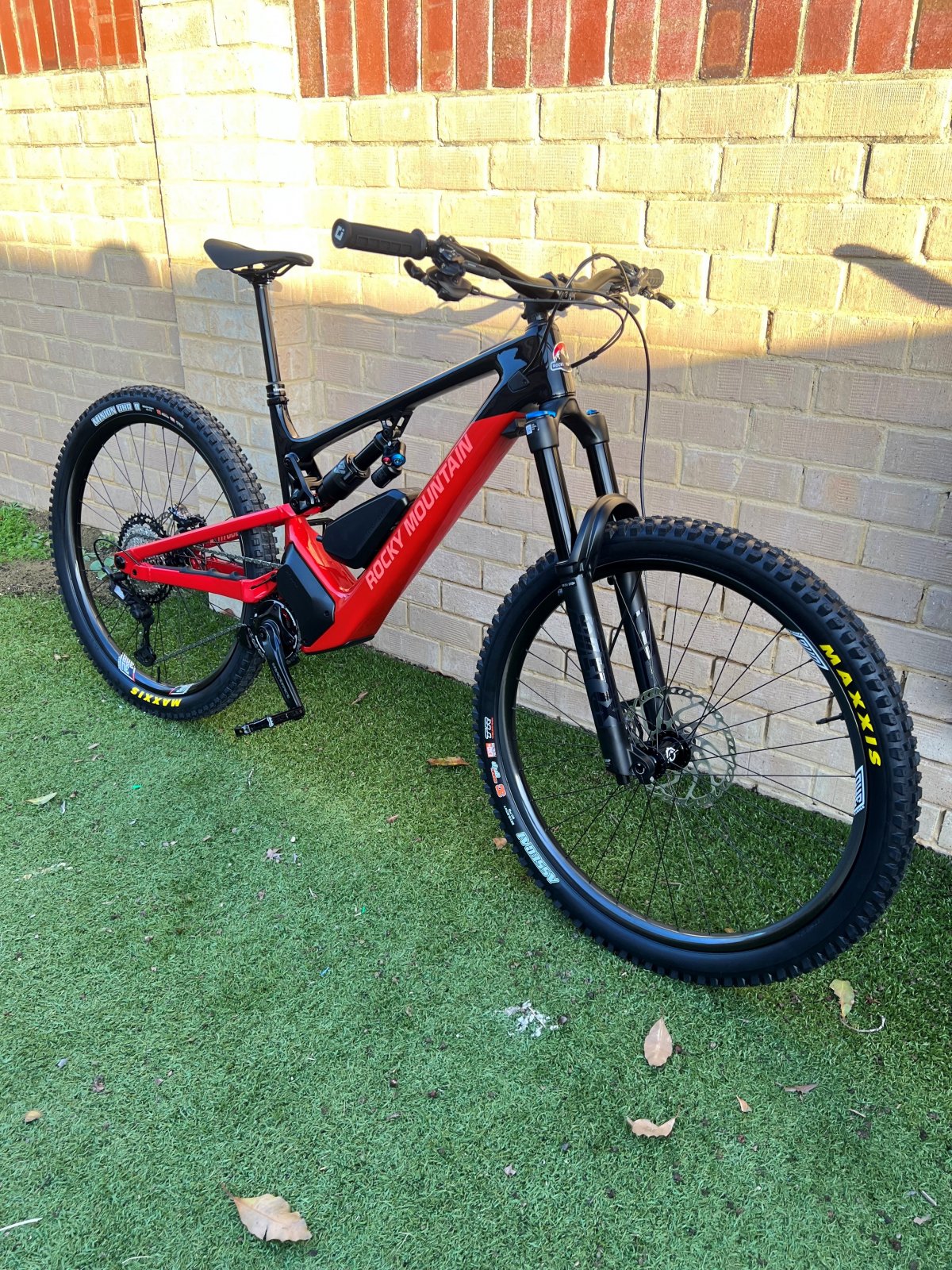

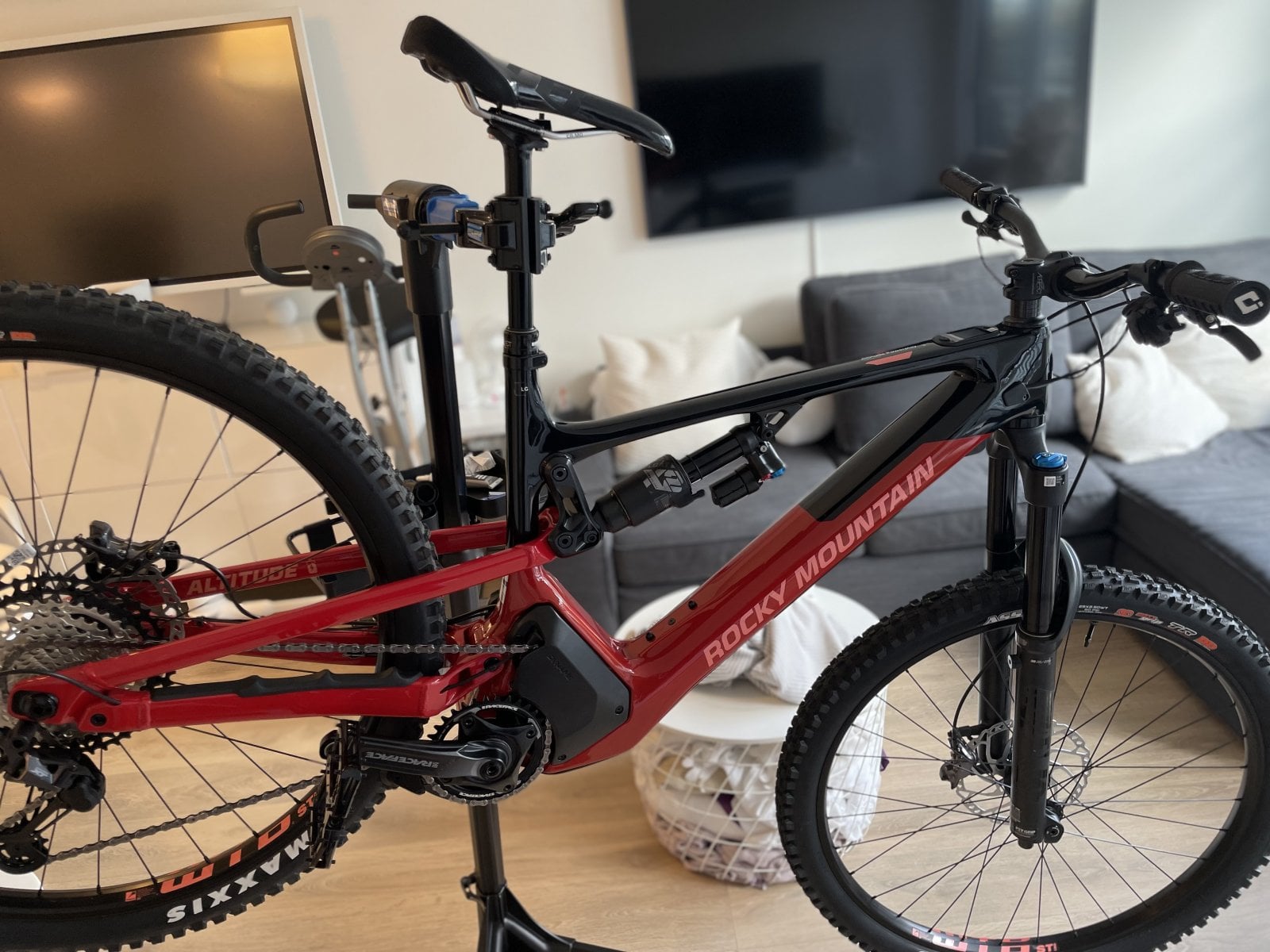

Just picked this up today, only changes so far are we are one wheels and specialzed seat. trying to get an AXS droppper but nobody has them in stock. Am in Perth Western Australia apparently this is the only altitude in large for this year due to supply.
Not sure can ride it yet as i cant stop staring at it :) its a real looker.
Wifes not happy as i currently have in the main bedroom.

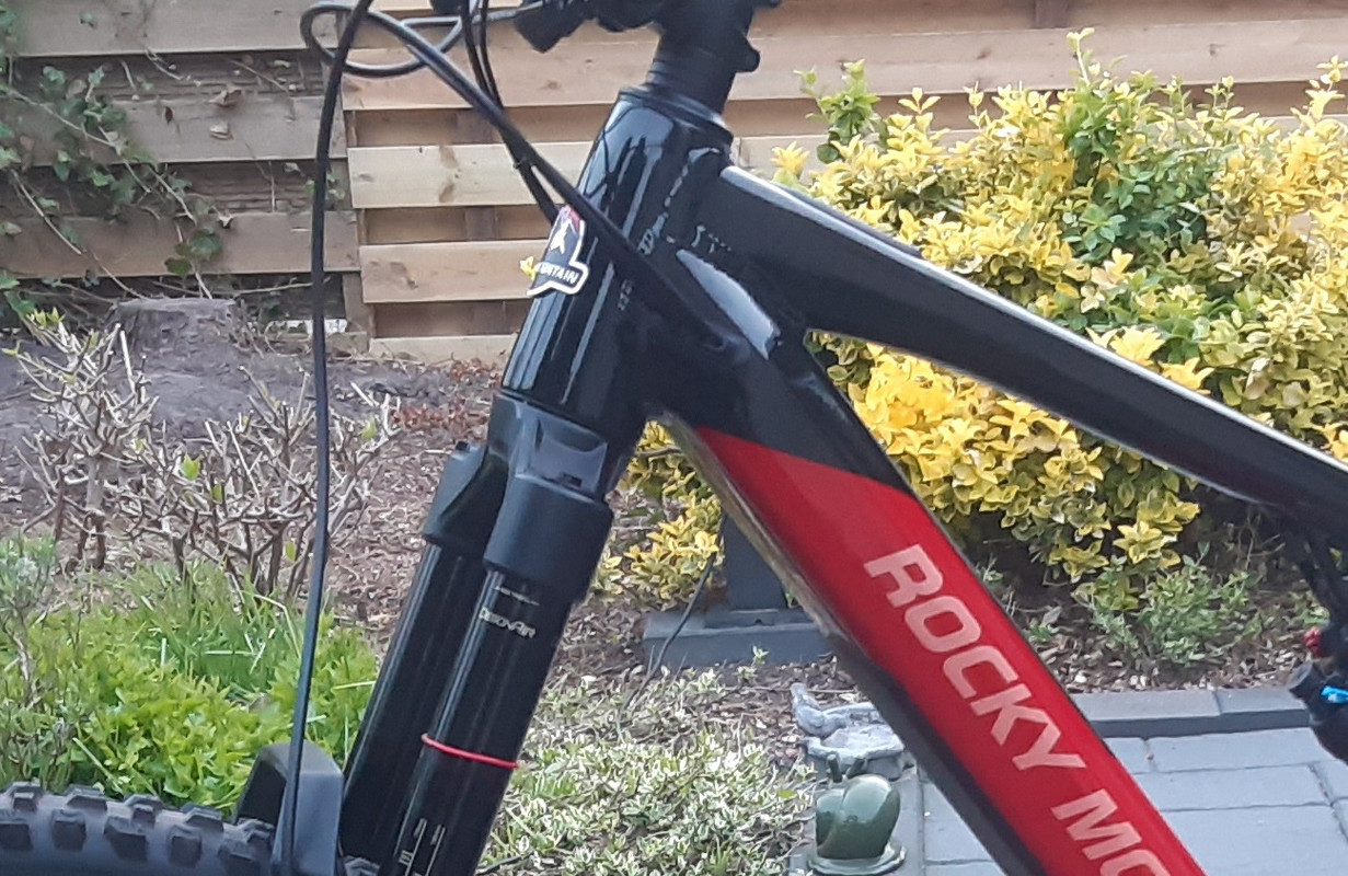

Great (y). may i ask if anyone knows how to remove the plastik robber underneath the downtube that provides the fork of hitting the frame? I did unsrew the bolt but the plastik robber did not come loose 🤷‍♂️

Dont know. Mine didnt came with a rubber stop. The fork just rotates all the way. Perhaps its for smaller sized frames only? (i have the XL).
Moe Ped, you seem to be missing the black protective covers on the underside of the downtube?
Also why did you swap you maxxis tyres to identical non oem types?
But nice bike obviously!

The covers came in the bag with the owners manual, kept the original wheels complete also went for the lighter version of the tyre and didnt want cushcore.

If you dont have the rubber stop, could you please take a picture of that part? I want to remove it because in tecnical climbs i need to have more freedom in turning the steerer - i just dont know if with removed bolt i could just tear the rubber stop off

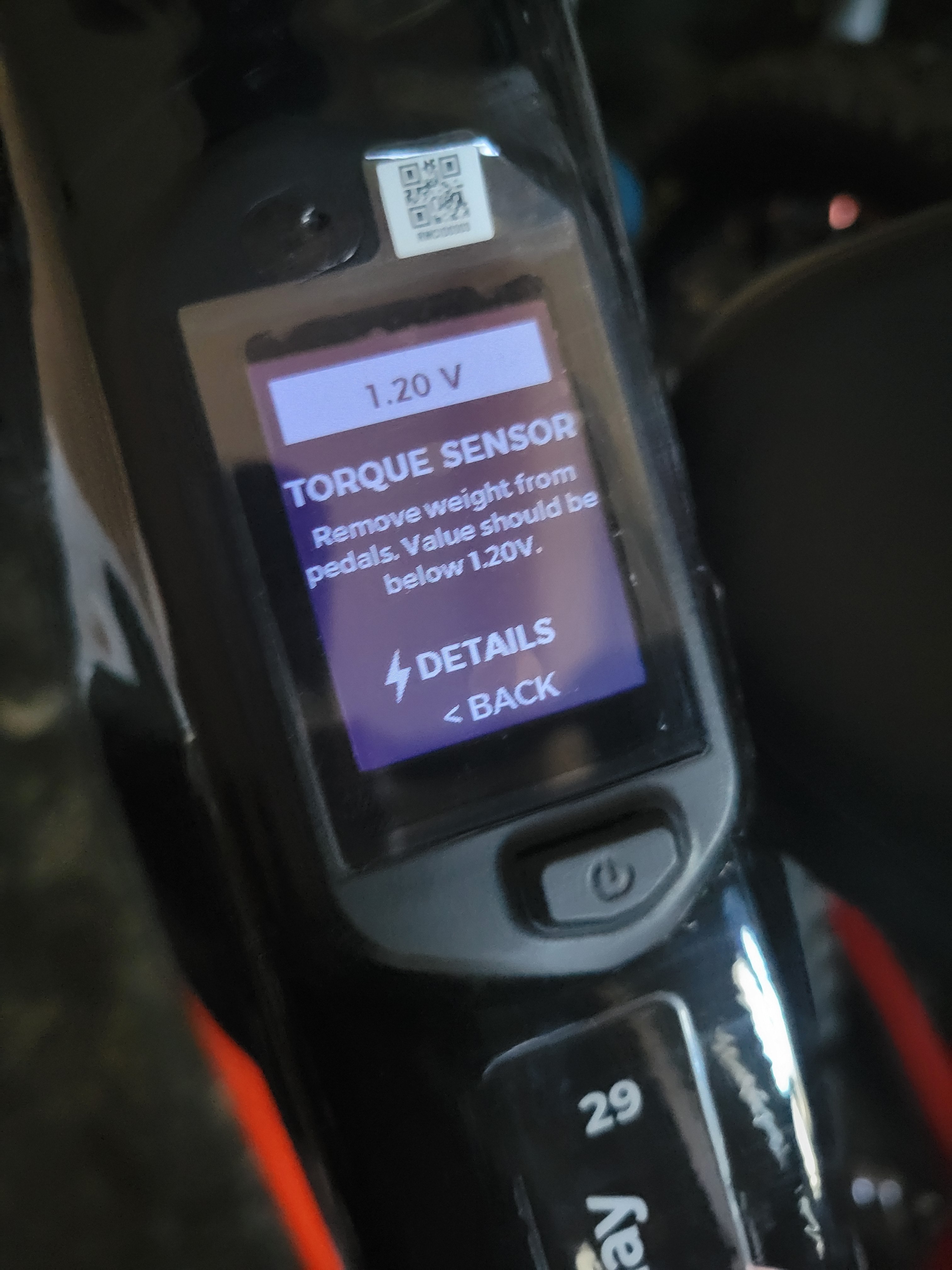

Error 157 Code
Just got my 2022 Altitude c70. Rode it around the streets to get use to it and rode to the bike shop and back and noticed i got an Error 157 code.
i opened the cover and some grease from the torque pulley transfered to the cover but everything was snug and fine. As i only rode it on the street there was nothing on the cogs to clean off.
I tried calibrating as per the instruction on the jumbotron but i still have the error. The bike rides fine and i wouldnt have noticed if i didnt read about it in a review . The shop i bought it from is actually pretty far from where i live but last resort is to take it back and have them take a look. I've tried calibrating multiple ways but it could just be the sensor?
Anyone have this problem?

You really shouldnt have to recalibrate every ride. Cant remember the last time i calibrated it and everything still works as it should. Just keep the torque pulley clean and make sure no debris is stuck behind the pulley that might obstruct its functioning.
From what i can see, error 157 could indicate a stuck or obstructed torque pulley. So go check that out.
Also, in the diagnostic menu (hold mode and up button for 3 seconds), go to Live data -> Sensors -> Torque. There you will see if the sensor is working correct. It also displays your calibration value. Without applying force to the pedals the calibration value should match the sensor Voltage. This is what it means to be "calibrated". Then when applying force to the pedals you should see the torque sensor Voltage go up.
My display tells me the sensitivity is 120Nm/V, so technically when you apply 120Nm of torque on the pedals, the sensor Voltage should go up by 1 Volt.
120Nm is the equivalent of putting ~70kgs of weight on one pedal. That should give you a rough idea.
FYI, my torque sensor shows a value of 1.44V when in rest.
On the screen it says it should be below 1.20v without weight , which mine bounces between 1.19v -1.20
It's probably fine.

Well yours is apparently a bit different, stating that the level should be below 1.20V.
As mine is already at 1.44V without weight. Maybe they changed something in the sensor for the later models? (mine is 2022 altitude, bought May of this year)
When does your error typically show up? Under what kind of circumstances?
Note that errors in the errorlog will remain there forever, even if the problem is fixed (there is probably a way to erase them, i just dont know how)

Ah i went to my old error log entries and lo and behold i also had 2x the 157 error show up. But in my case it said that the value should be below 1.44V. That kind of makes sense, because that is the zero point for my sensor (and what it was calibrated to at the time).
Yours is calibrated at 1.20V, so that would explain why there is a difference in the message.
I only got those codes twice in the beginning, and have never seen them afterwards.
So maybe Dynamo is right, just ignore it and it'll probably fix itself over time...?

Error only popped up once. And I calibrated .
I thought it would wipe the error. I kept trying to clear the error.But I guess it's actually fine. Just paranoid about the new bike.
Thanks for all the help !! Really appreciate the piece of mind and now I'll just go rip some climbs lol.
