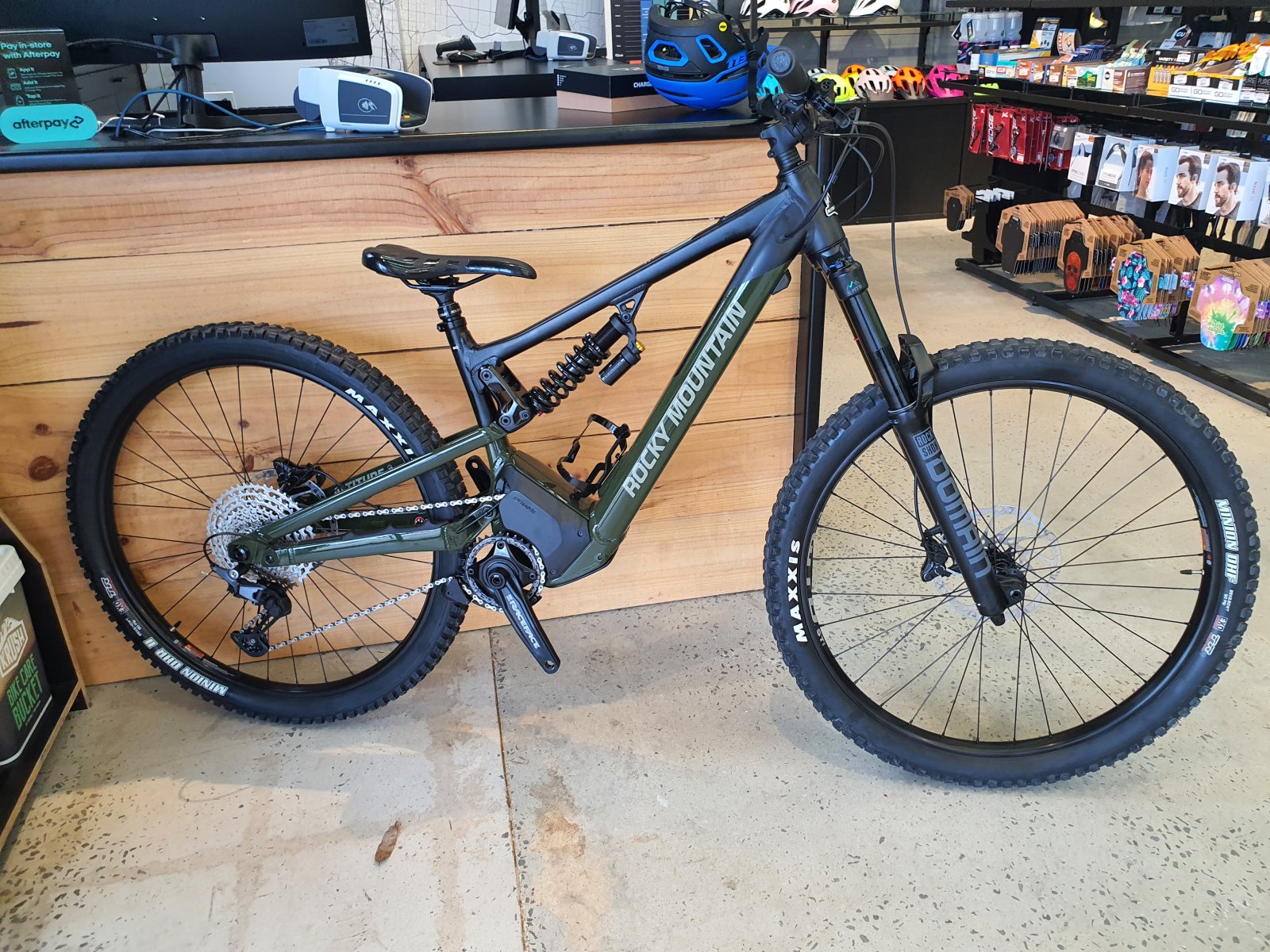

I'm considering upgrading the rear shock of my Altitude Powerplay A70 my23. The current shock is the Fox Float X performance.
The only "problem" 😬 is that the rear cinematic of this bike works so well that I don't know how much of this performance has to be attributed to the suspension system and how much to the rear shock.
I'm searching for a bit more support out of the turns and a more poppy feeling, the current shock has no compression tuning, so it's more difficult to achieve what I'm looking for...
In other words, what is the margin of improvement I can get switching to a rear shock such as a Fox Float X2 factory or a EXT Storia LOK 3 coil?
Do you have any experience with different shocks on this bike? How does the feeling change?
Robstyle
Nov 17, 2021
127
147
New Zealand
A coil gains significant small bump sensitivity over the factory float X. And because of this you can run spring rates on the firmer side to help with the support you seek. I've found the rear isn't too fussy on compression and once you get your rebound set right the bike really comes alive.
