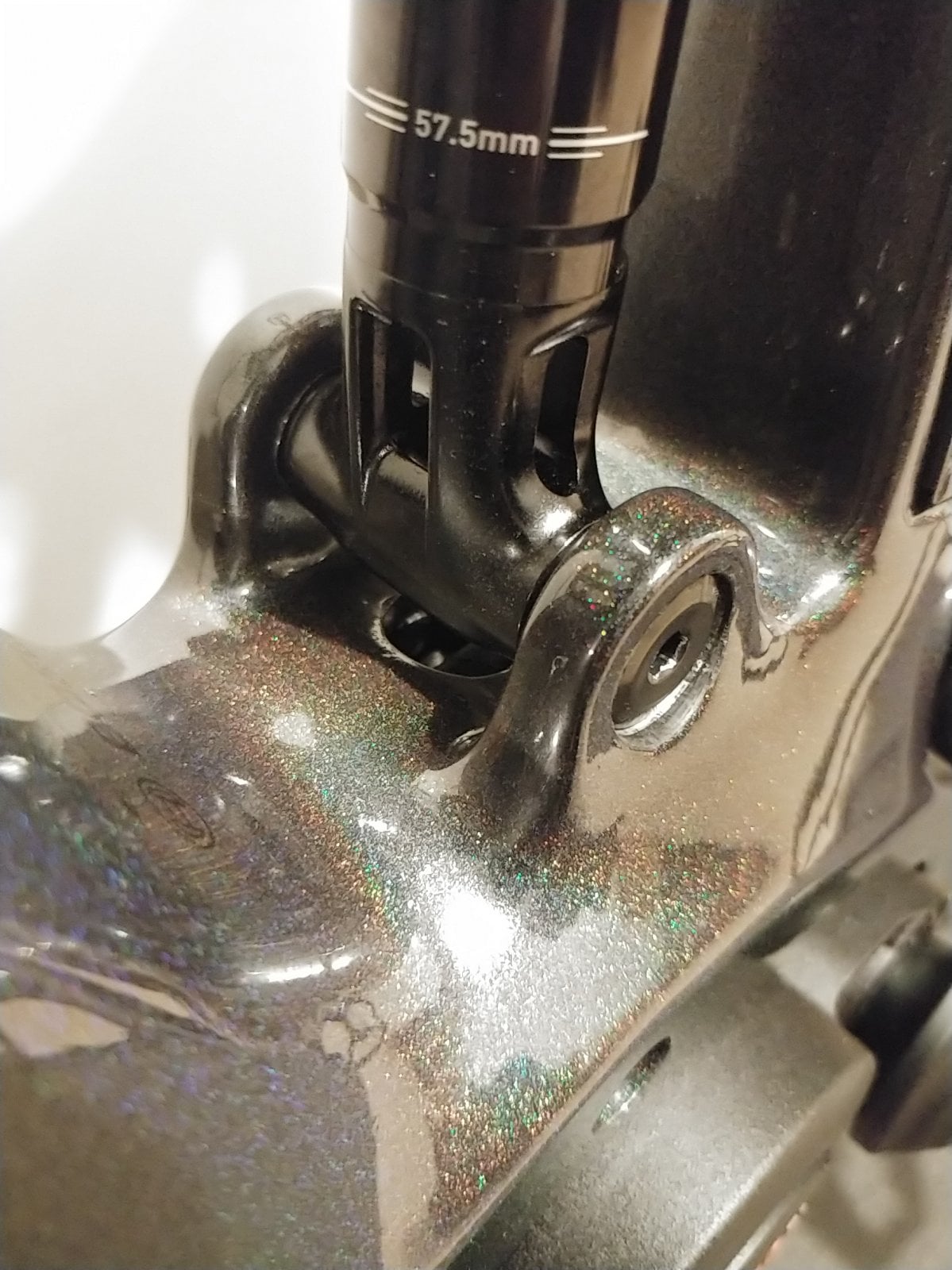

Maybe a dumb question but is there meant to be an open hole in the frame under the rear shock on the 2022 with thru shaft?
Is there meant to be a plug there or is it some kind of drainage?
