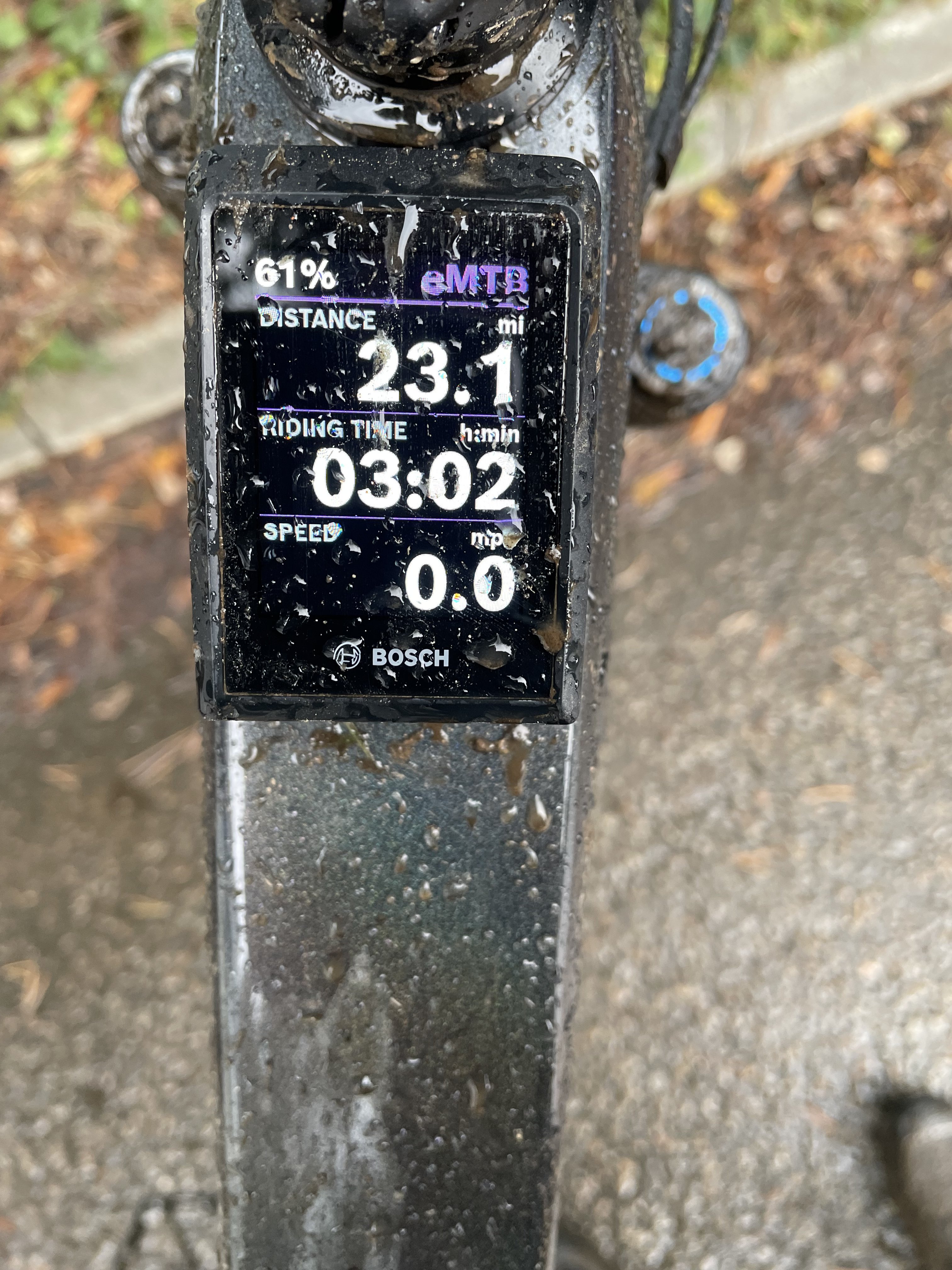

I got this at the weekend. Mostly flat, mostly in Eco.

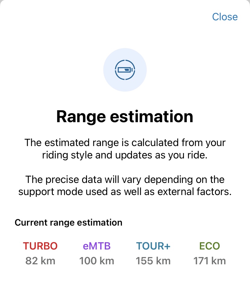

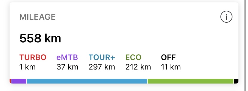

Right, here’s the fully charged range estimate. (Based on all flat riding I’m assuming) must be close to 10 charge cycles now and within that 558km about 8,000m of climbing.
36E69334-3E1B-4568-A573-2B6D99135B33.jpeg CD5272C8-23F6-4C4E-8098-E2802798DAB3.jpeg

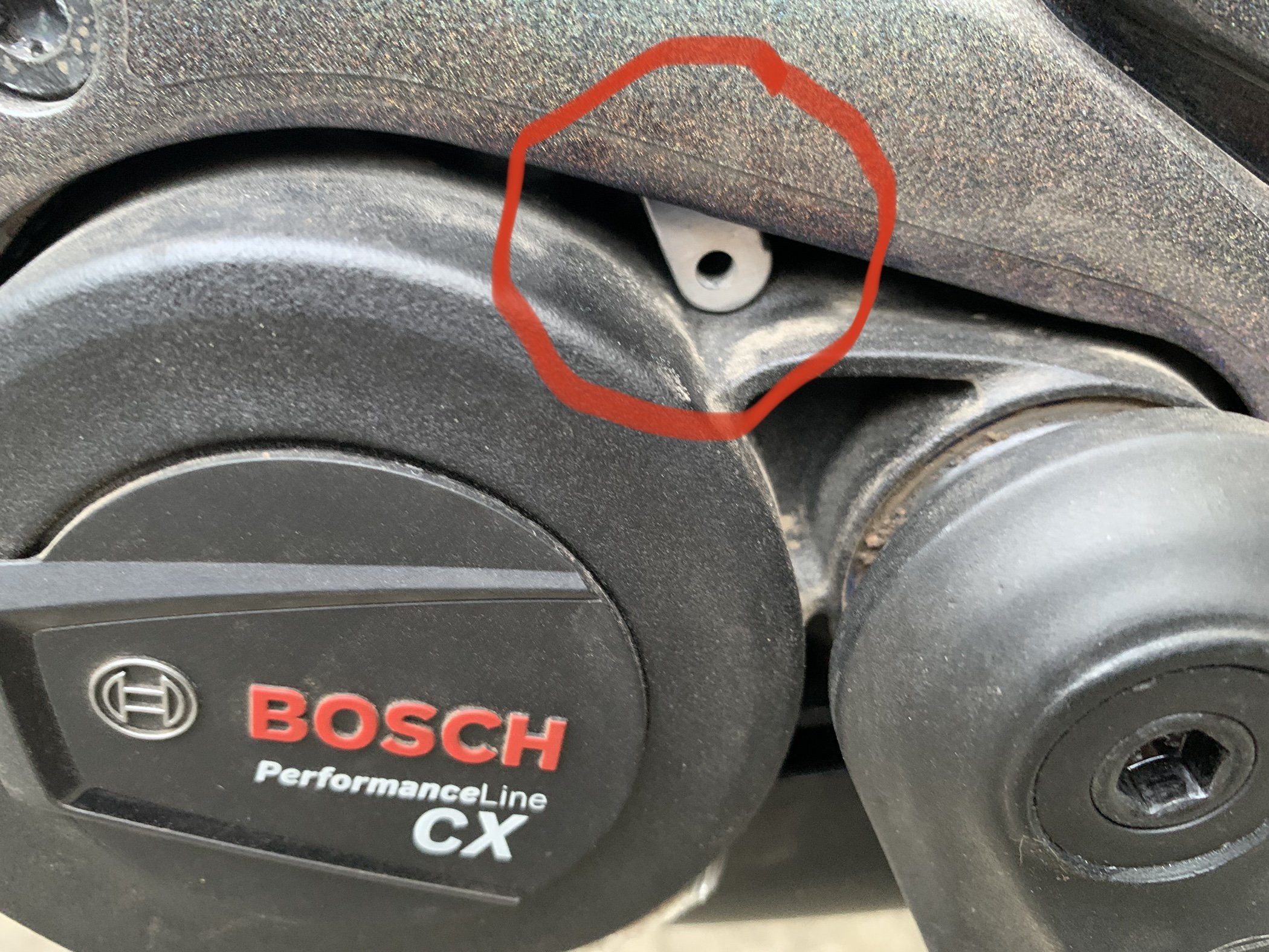

So over the last month to 6 weeks I've had a creak develop in the right hand side crank whilst pedaling. Took it into the dealer and they gave it back with the sound still there but slightly less noise.
Anyway move on a few more weeks and a few more rides and I'm contemplating taking it somewhere else to diagnose. After doing some reading on here about creaks coming from different areas than you think, I decided to try fix it myself.
Removed the seatpost (what a crap cable system the line pro dropper has!) lost the cable, had to remove the dropper lever and push the slack back into the seat tube to reattach the cable to the dropper. Greased the inner collar and carbon seat tube.
Well… the creak came back worse than ever. So back to the dealer for the 2nd time and got to deal direct with the mechanic this time.
He said commonest creak on the rail is rear axle and bearings. Now someone posted that exact area on another thread so well done to them. Mechanic removed the rear inner and outer bearings on both sides, re seated them squarely and greased them.
PERFECT! Creak is gone and dead quiet whilst pedalling. Very very happy in a simple fix that I don’t have to pay for.

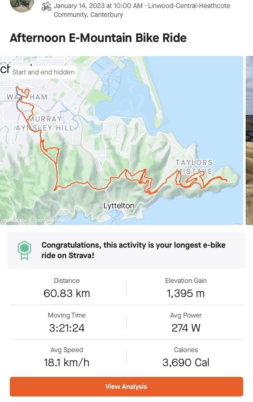

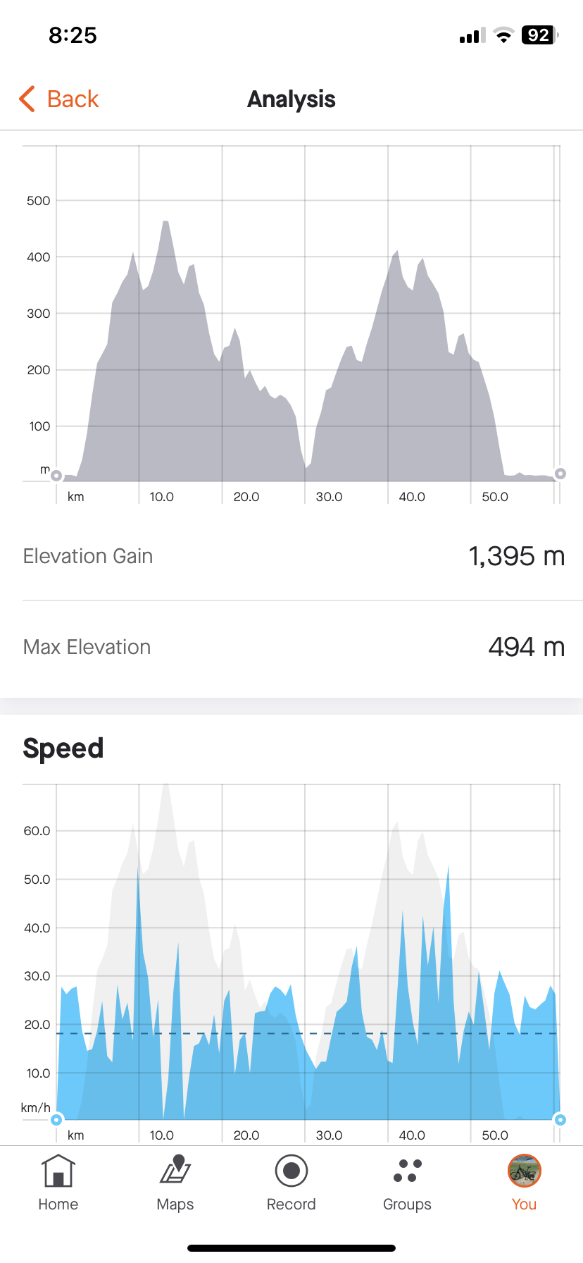

Over the weekend did my longest ride on the rail so far. 60km with 1395m of elevation over 3 hours riding. (37.5 miles / 4576 feet). Mostly Tour+ and Eco probably 4-5% in EMTB (No turbo).
Came home with 17% battery spare. Range was showing another 15km in Tour+. Super happy with the ride.
5F1BD085-618E-4BF0-AE89-EC62E5EB764A.jpeg 19CB76C4-46BD-4BE8-A355-0C7B8D29C0B3.png
After a FAR more demanding ride with 1400m of climbing over the weekend, I believe the truer numbers for range at 100% charge are:
Turbo = 54km
EMTB = 65km
Tour+ = 102km
Eco = 112km

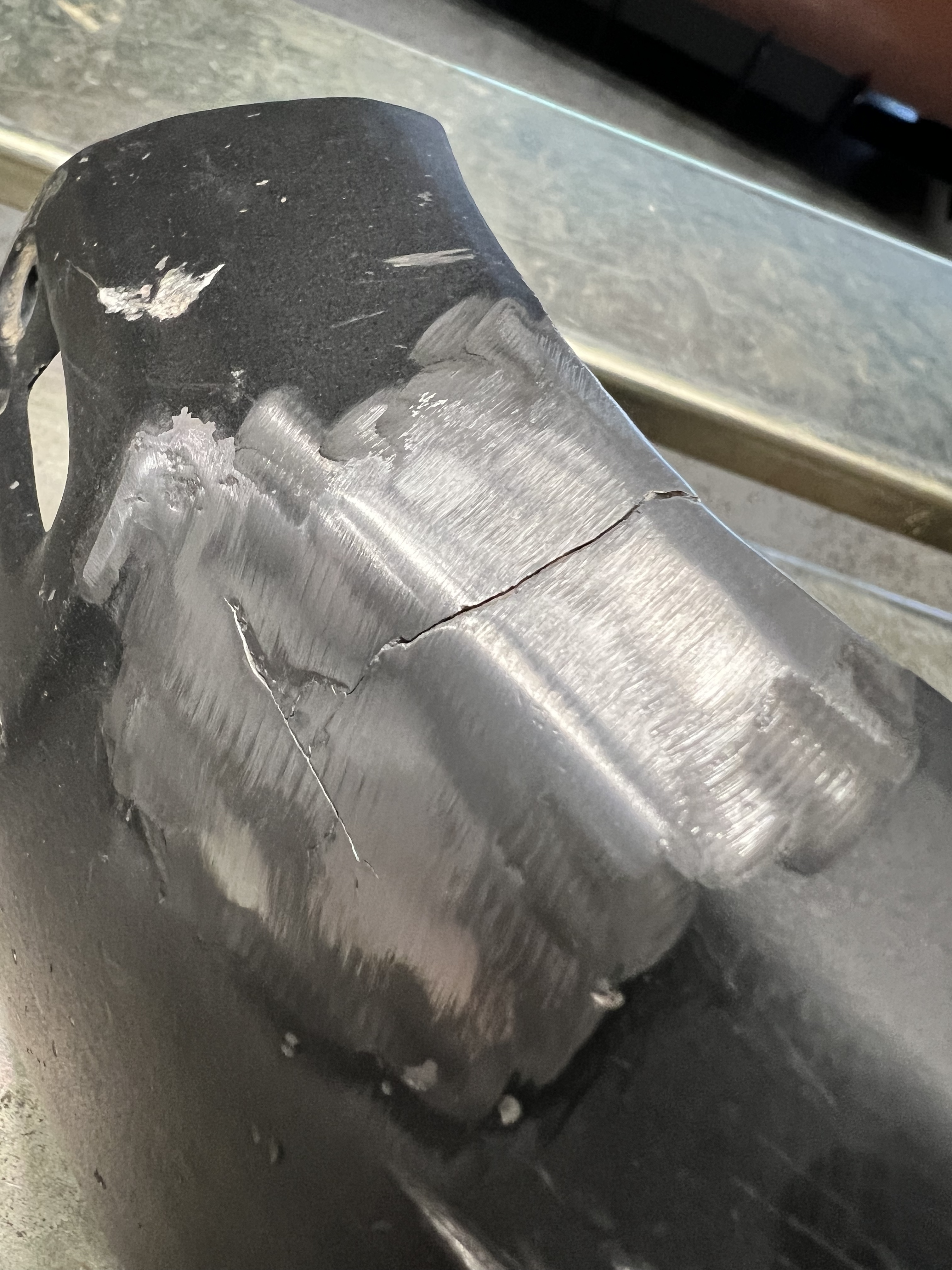

I've fallen victim to the infamous cracked motor guard. Anyone else? Trying to find the part number. I ordered the bash plate that Protect EMTB sells so this doesn't happen again.

In 450 miles Ive only tapped mine once on a rock drop I should have jumped rather than tried roll over. Its got a very small scratch on it now.
Was yours from a rock strike?

I don't recall the exact moment this would have happened but I"m sure it was from a rock strike yes. I consider rock strikes part of normal riding - nothing extreme, mind you, but I should be able to strike a rock and not have my bottom motor guard crack like this. Others have experienced a similar issue and it is certainly a design flaw. Trek really needs to beef these up. I believe they're a cast aluminum. It's really a weak design when you pull it off and look at it - long distance between front and rear bolt secure locations with no reinforcement in the center of any sort. No wonder they crack.

Wrong material! It either has to be robust enough to withstand a hit or better still made of a material ( e.g Poly prop) that will flex and absorb the shock. An open design, single skin ally only supported at each end is bound to crack into 2 pieces. If you can find a replacement made from a material like Polyprop it would be far more robust.
