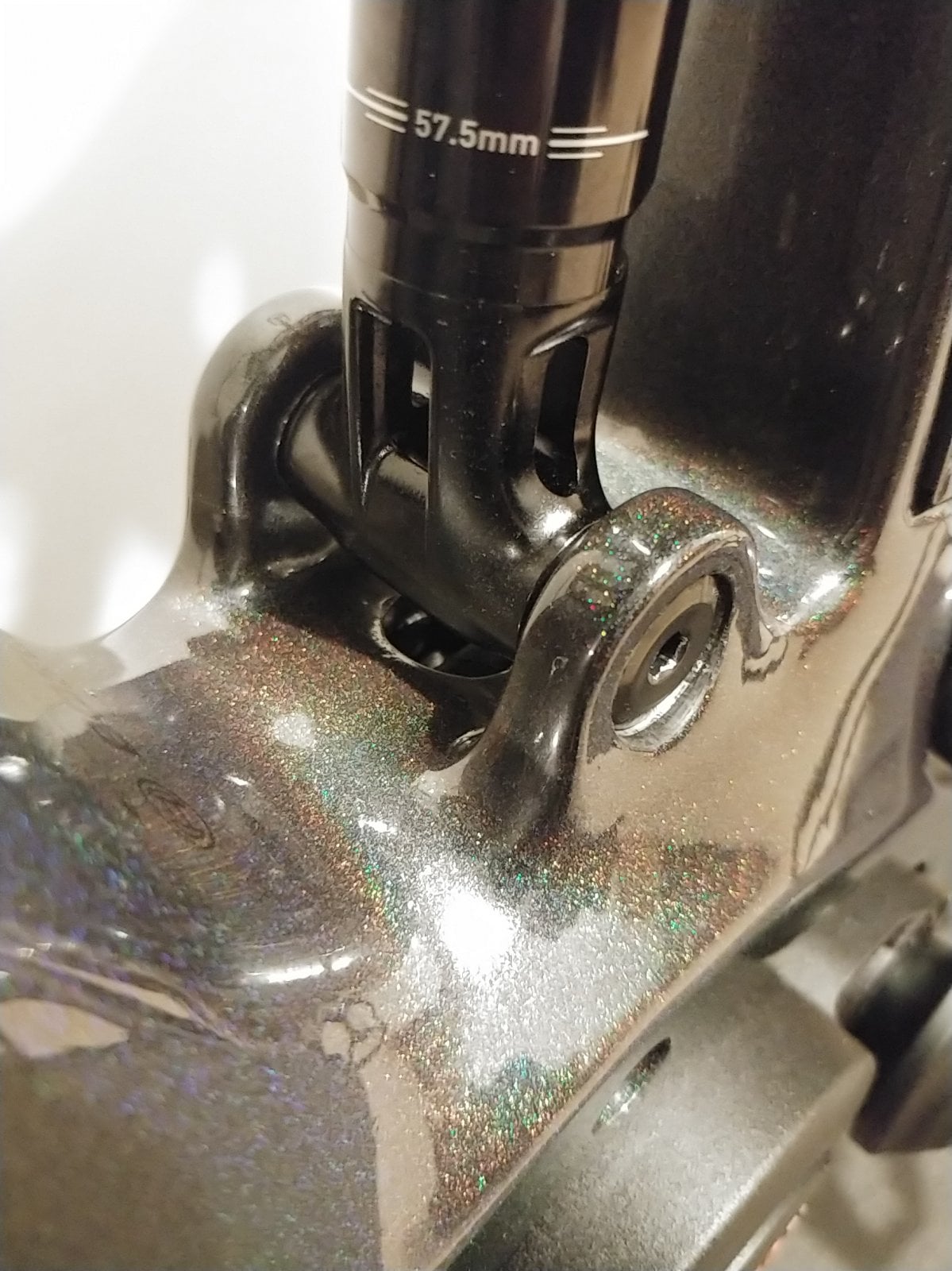

Maybe a dumb question but is there meant to be an open hole in the frame under the rear shock on the 2022 with thru shaft?
Is there meant to be a plug there or is it some kind of drainage?
Yes, there is supposed to be a hole there. It is to allow the shaft of the Thrushaft to pass into under compression. Do not plug it! Obviously not required if using any other shock…

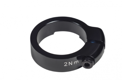

You don't have to get rid of the knockblock to set up a shorter stem, Bontrager has knockblock 35mm stems, and also there is a knockblock lockring.

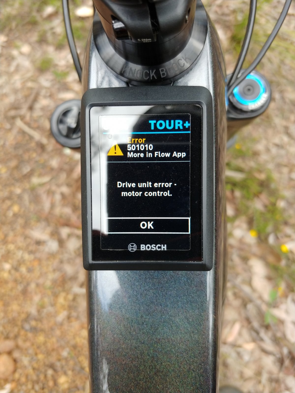

My 2022 9.8 XT kept losing power and switching itself off on a ride today. Error message 501010 came up on the screen the first time other times it just turned off. Tried reseating the battery but it kept turning off with increased frequency. Sounds like a trip back to the LBS is on the cards. Has anyone seen this error?
Yes mine did exactly as you described last week.
Got it home cleaned terminals, even though there was no visible dirt.
I then took out the damper pad I had installed.
I have now been on 3 big rides with no issues.
Thanks i will give this a try. I had installed the damper pad too and its been fine for the last 4 rides... I will remove and test.
That's interesting that you had also fitted the damper pad.
I had covered over 300 miles with it fitted with no issues, but was always worried that it seemed to be pushing the battery away from the terminal a bit too much, you only get about 8 mm of insertion without it fitted.
Of course this could just be a red herring, time will tell.
