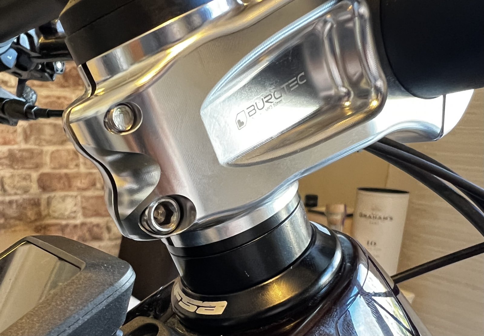

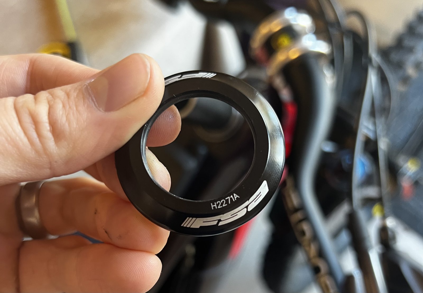

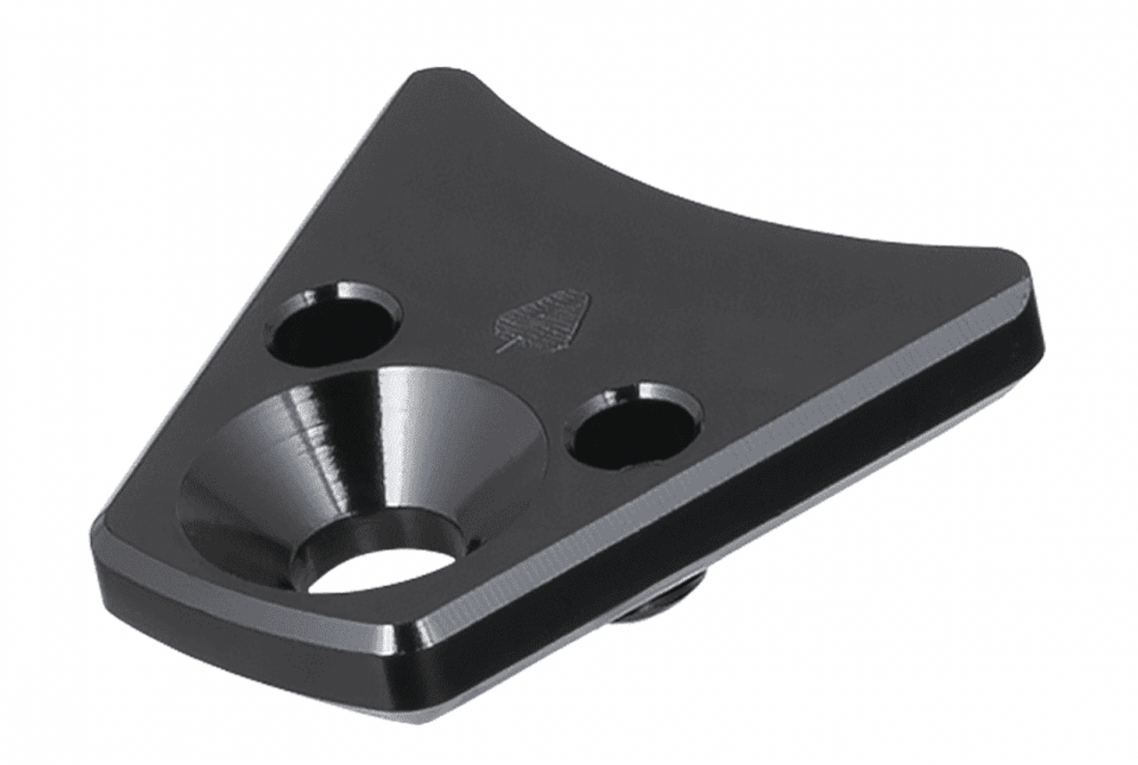

If you want to totally delete and remove the Trek Knock Block here's what you need.
Part H2271A headset bearing cover - cost £7.64 here
Part W1048249 Non Block frame Chip - cost £10.99 here
Pros
Can use any stem you want, not just the Trek Knockblock Stems
Can use any stack height you want (just like most other bikes out there!)
No need to use the proprietary Knock Block Spacer Adapter (£18.99 price)
No need to use the proprietary Trek knock block stem spacers, use standard ones instead
Cleaner looking stem without Treks bulkier looking lock ring
Cons
If you are a complete numpty and do a spectacular crash you may be extremely unlucky and damage the display, the bars would need to hyper rotate at force to do proper damage I'd have thought. You can buy a new one here for £93.

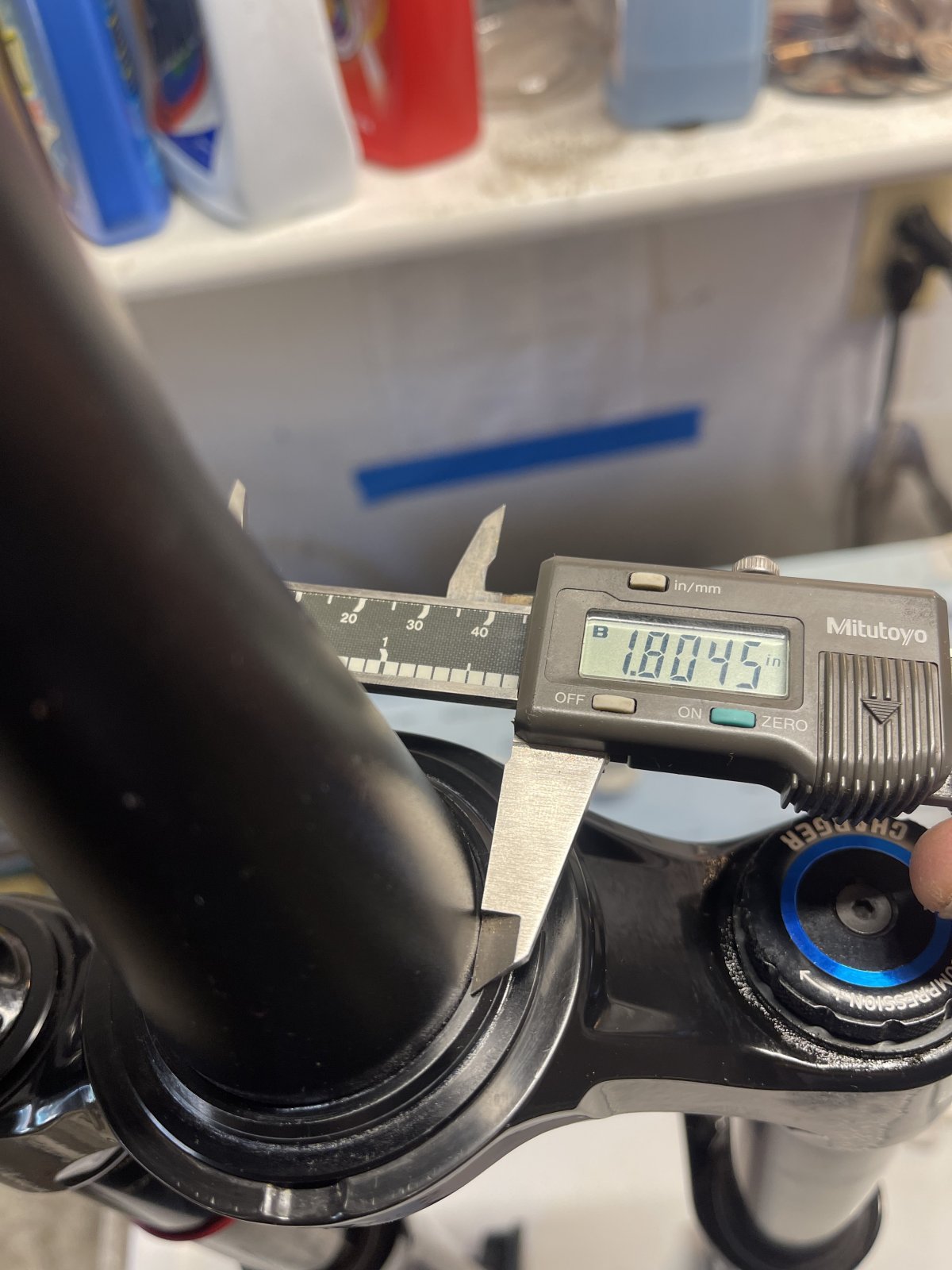

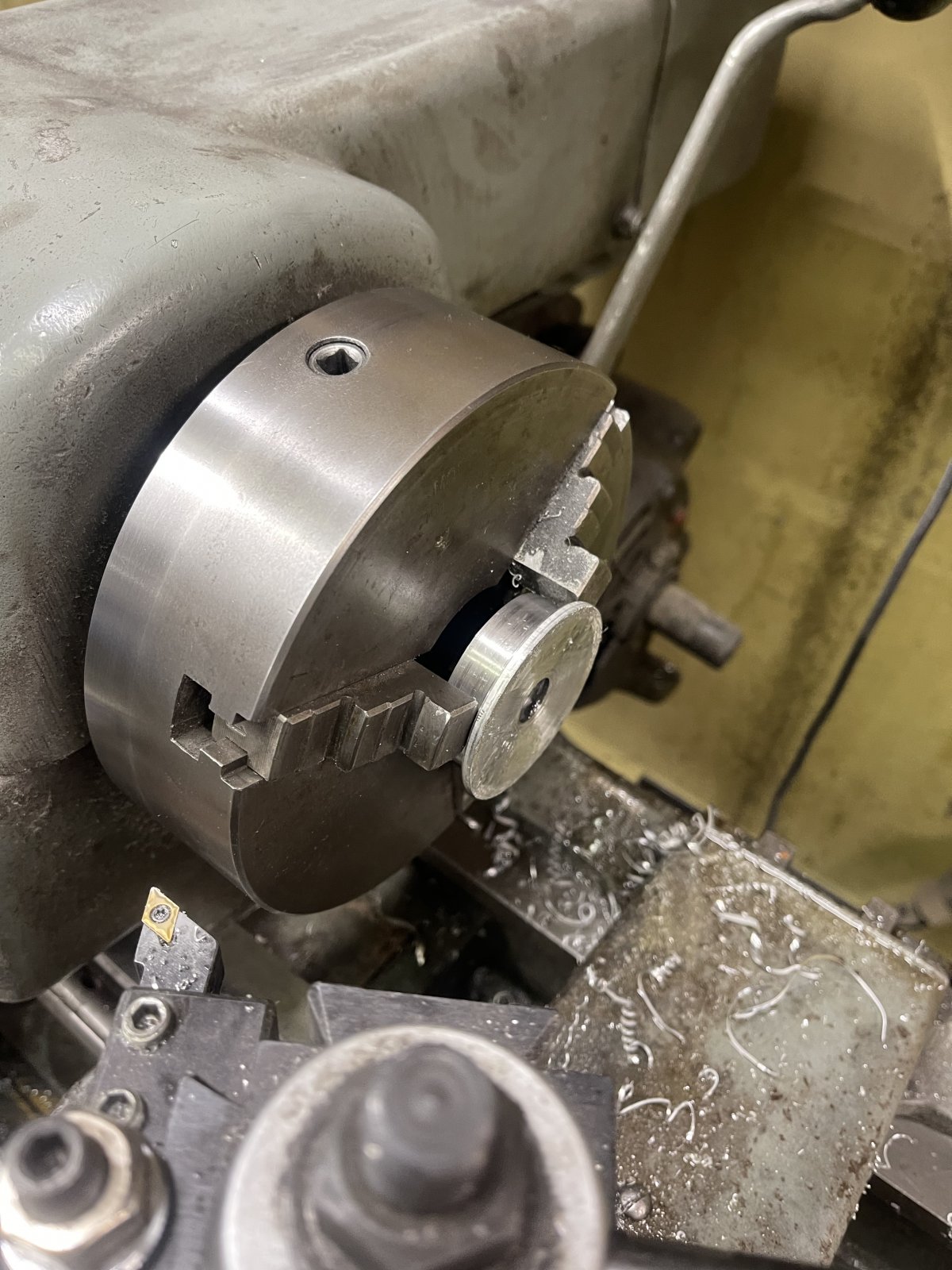

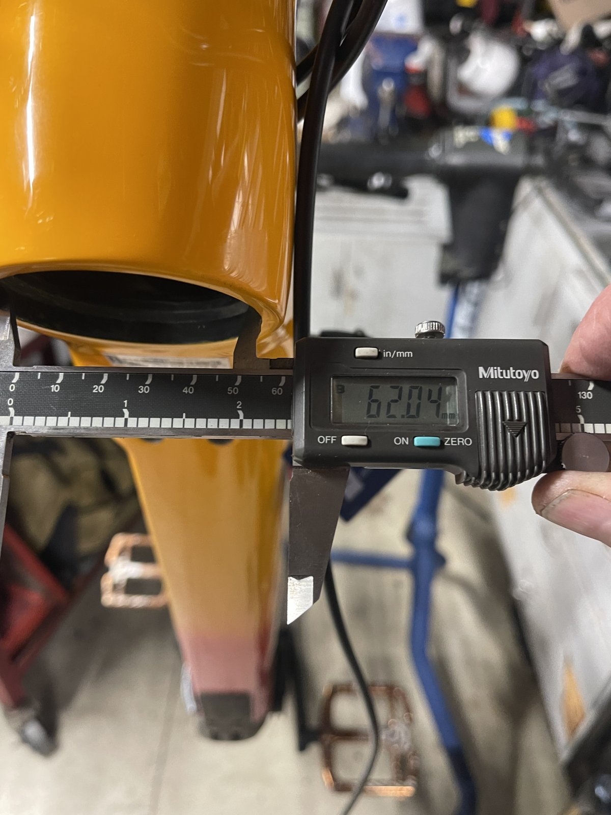

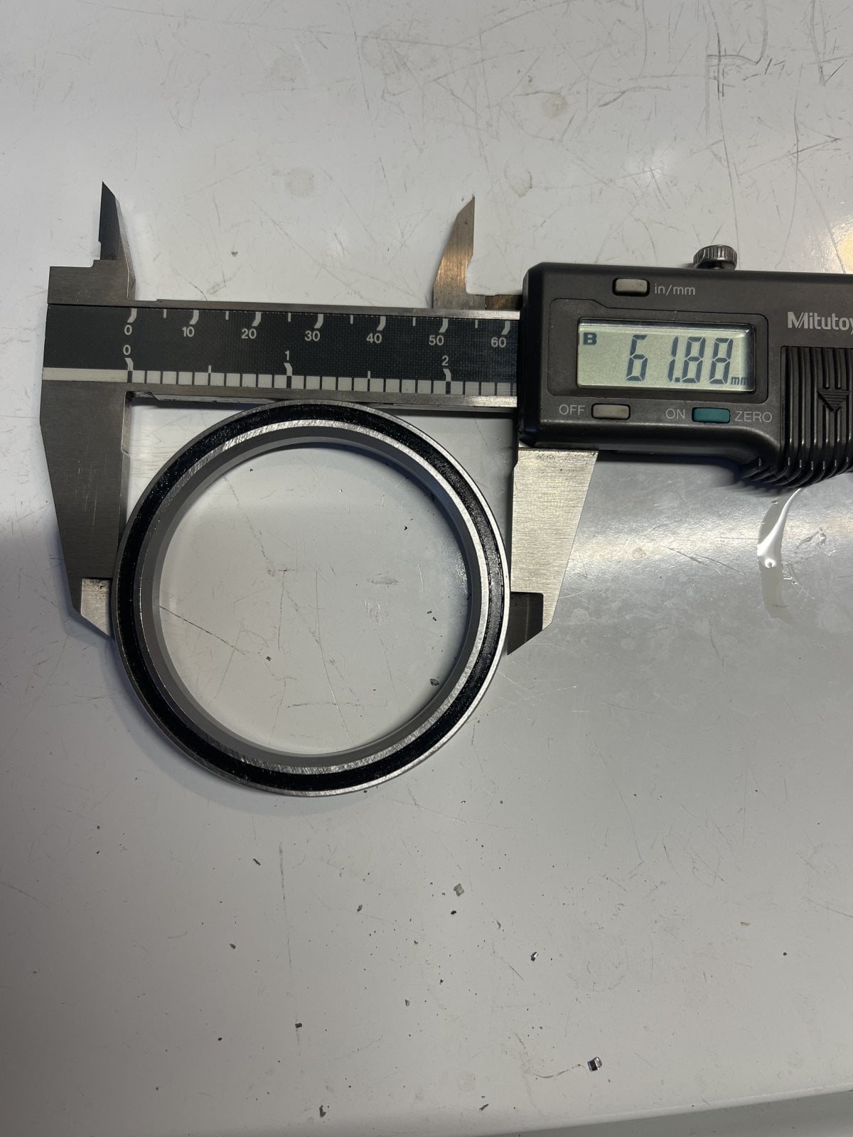

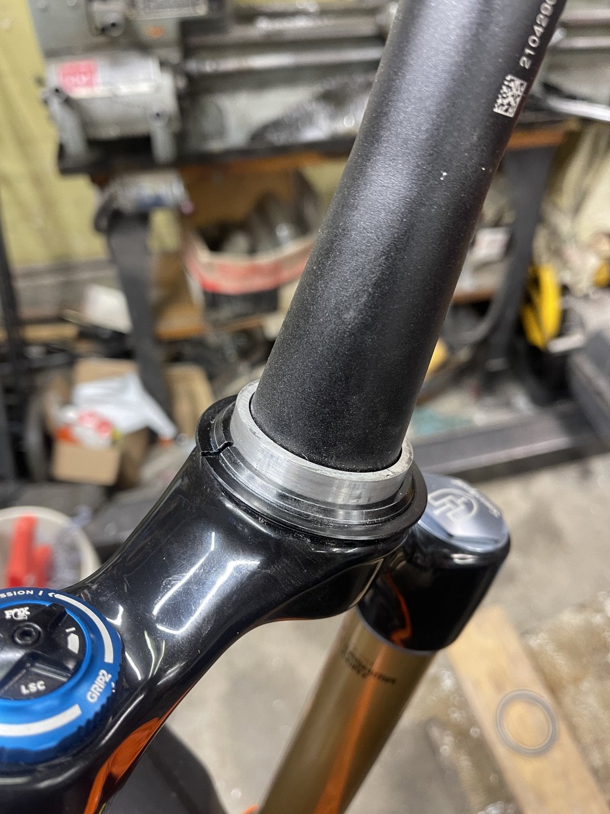

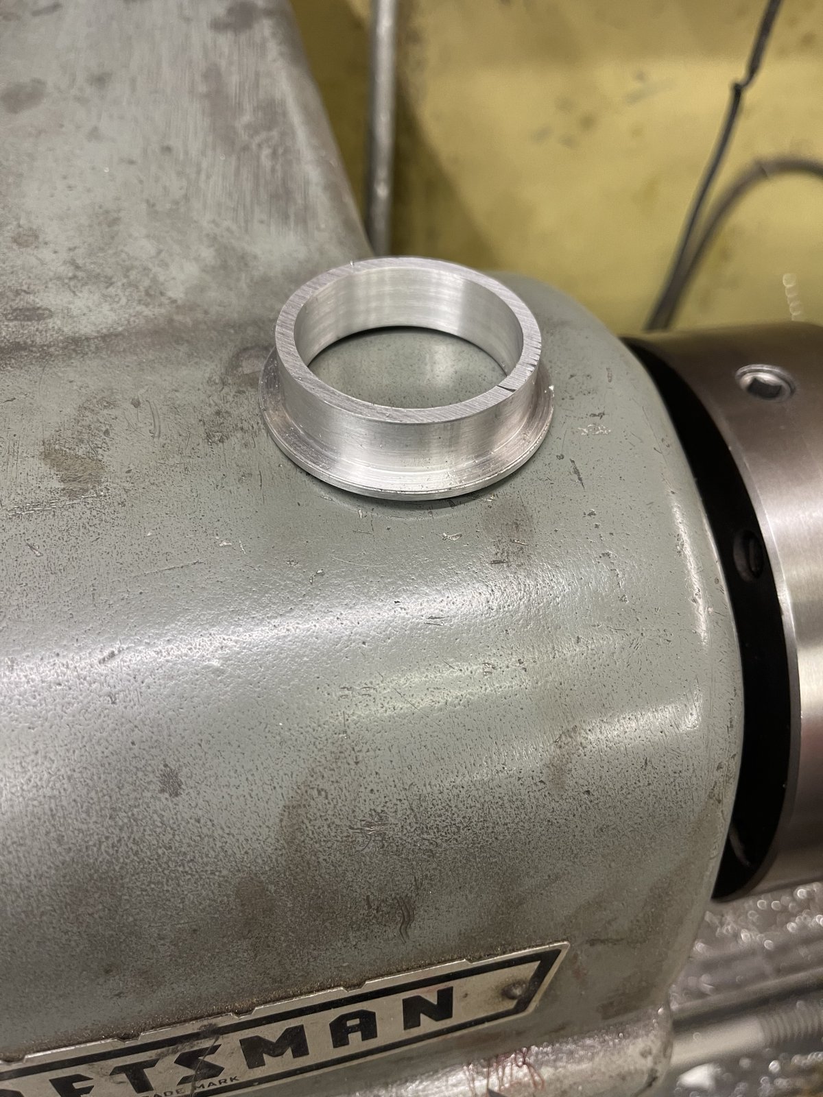

I wasn’t happy with the Rockshock Zeb and wanted to install a pair of Fox38’s I had.
The ‘22 Rail 9.8 & 9.9 is equipped with a 1.8” tapered steer tube. To run a standard fork with a 1.5 taper you need a 1.8/1.5 crown race reducer. Unfortunately it seems there are none available in the States. I made a sleeve to adapt the stock Rockshock crown race to my Fox 38 forks. Once pressed together it seems like it will work until adapter crown races are available…supposedly sometime in August.

Unfortunately this “Super Taper” is still new. With all the supply issues, it seems like the aftermarket support is a bit delayed. Just trying to explain what a 1.8” tapered steer tube was to the local bike stores or online vendors was a challenge.
But it was all worth it, the 170mm Fox 38 with a Smashpot coil conversion and Ohlins shock are magical. My skill and ability are the only thing holding the bike back.
