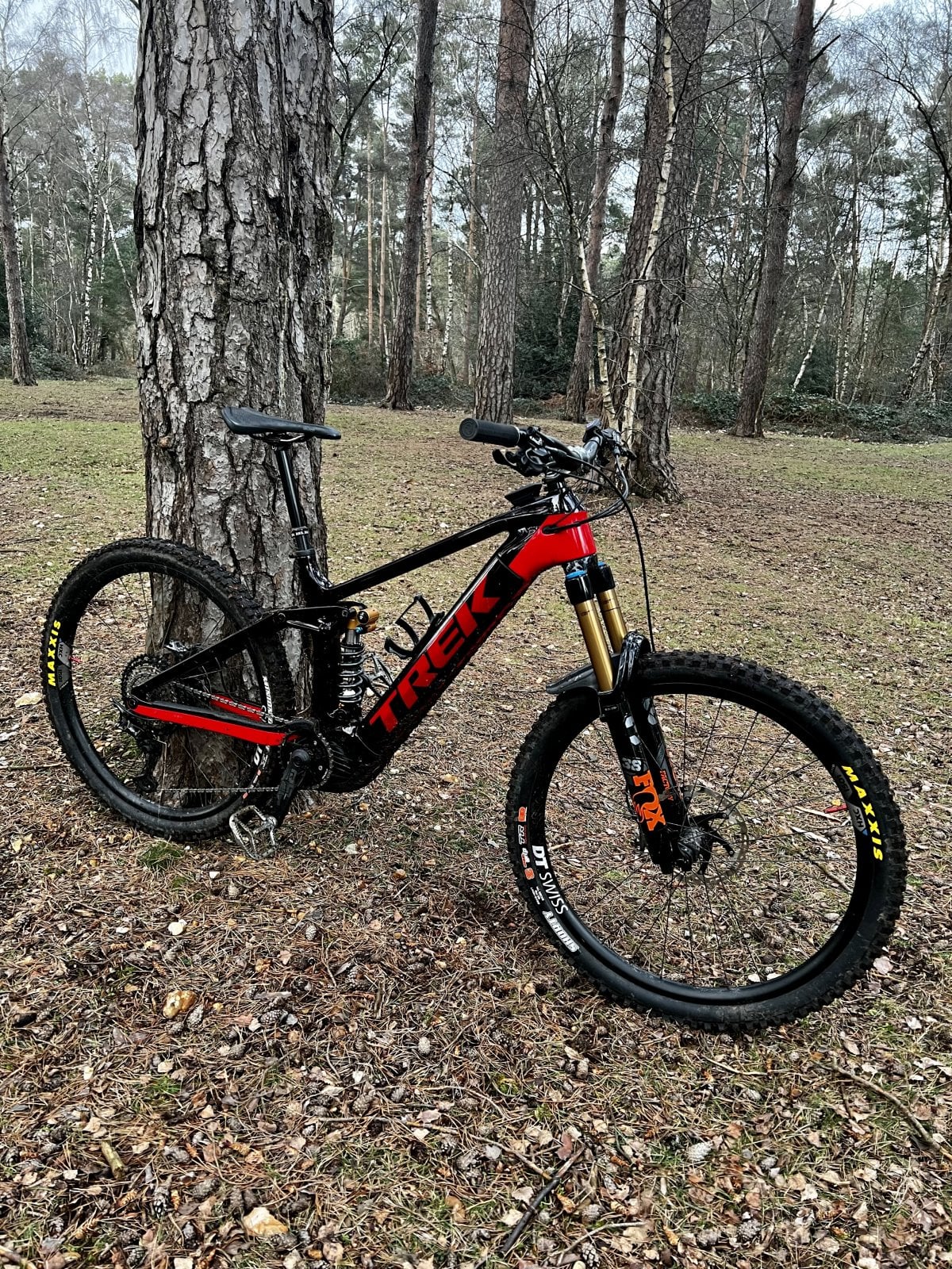

I now have the setup pretty dialled.
35mm Riser Bar, 50mm Stem 5mm rise. Fork at about 105 psi 2 tokens. 500Lb spring on the coil.
170mm fork, 165mm rear travel.
2.4 tyres, flip chip in high, 160mm crank arms. 63.8 degree head angle.
Bike feels absolutely brilliant so far.

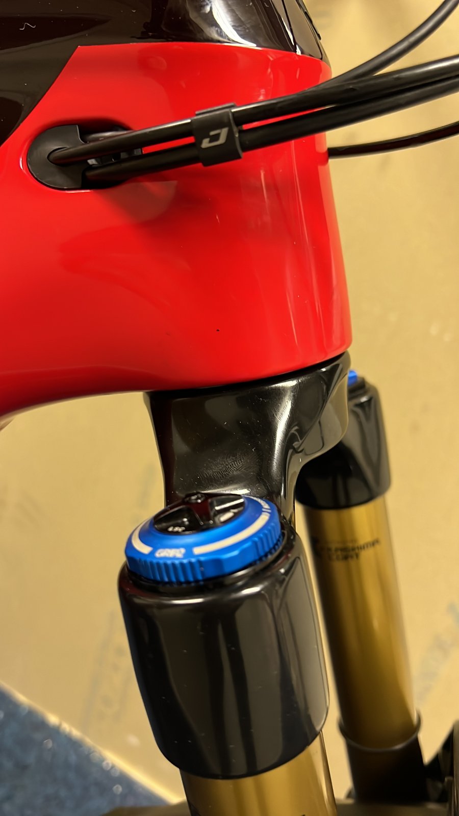

@Rob, how did you get your Fox forks to fit with the 1.8 steer tube? My Fox 38’s are 1.5. I was told Fox doesn’t have a 1.8 available yet.
This is correct. Which is massively annoying. I actually purchased the 58HT version and sent them to Fox for them to fit a 68HT CSU. (At my own cost).
Actually, it still has a 1.5” steerer, it just has the replacement CSU that has a fatter crown so matches aesthetically.
The part number is 820-12-484-KIT

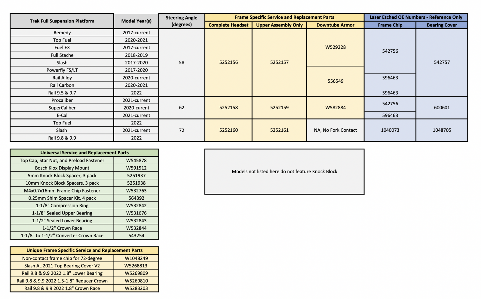

This parts information chart may be of future use to anyone looking for parts. I'm deleting the knock block with the delete chip and a new top bearing cover Trek Knock Block 72-Degree Headset Non-Block Frame Chip | Trek Bikes
Should totally delete the knock block (which is pretty useless on a Large frame as there seems to be a load of bar / fork clearance!)
Great resource, thanks!
According to the description on the Trek site, it looks like that the replacement part you linked comes with the bearing cover as well??
